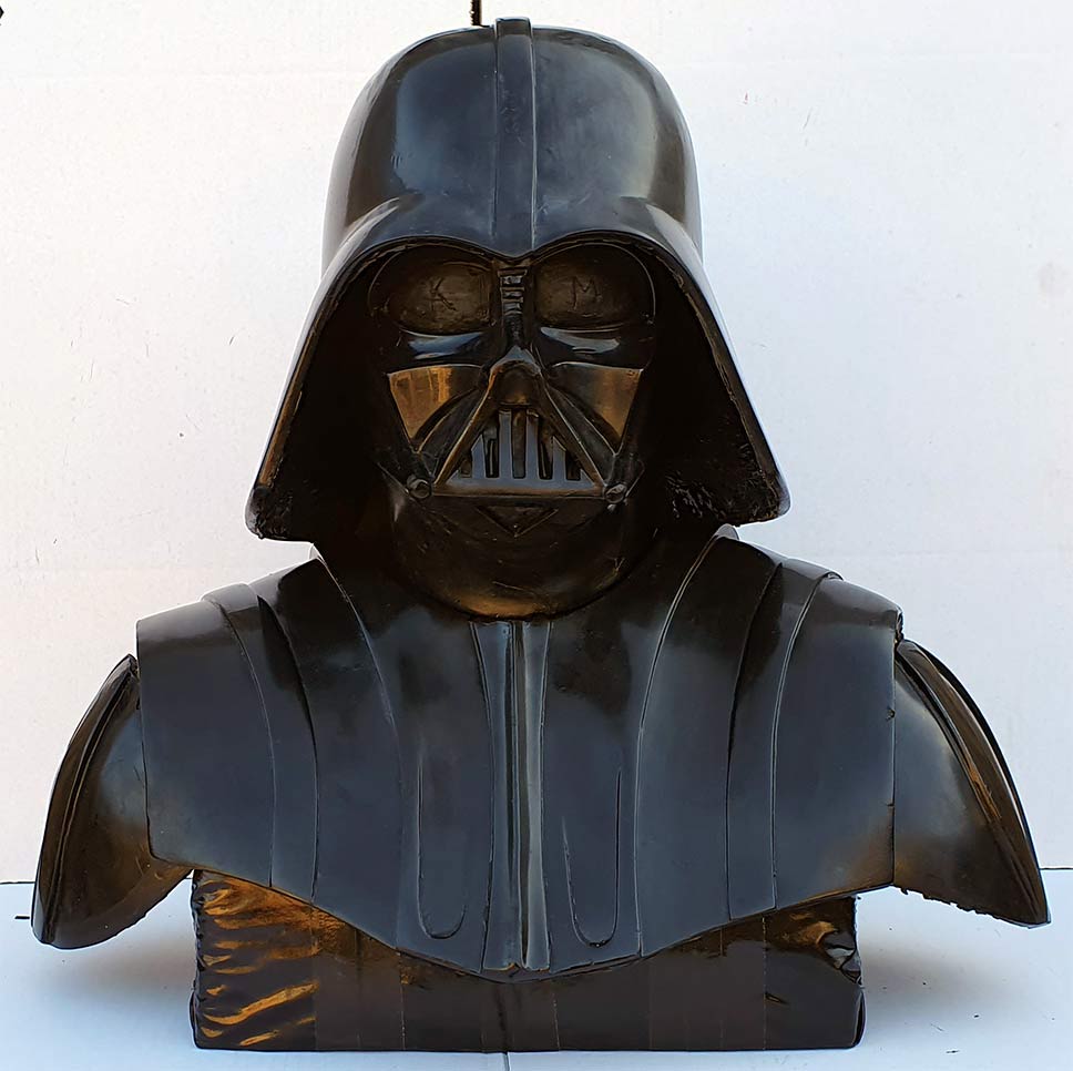

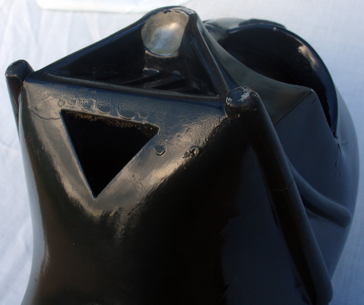

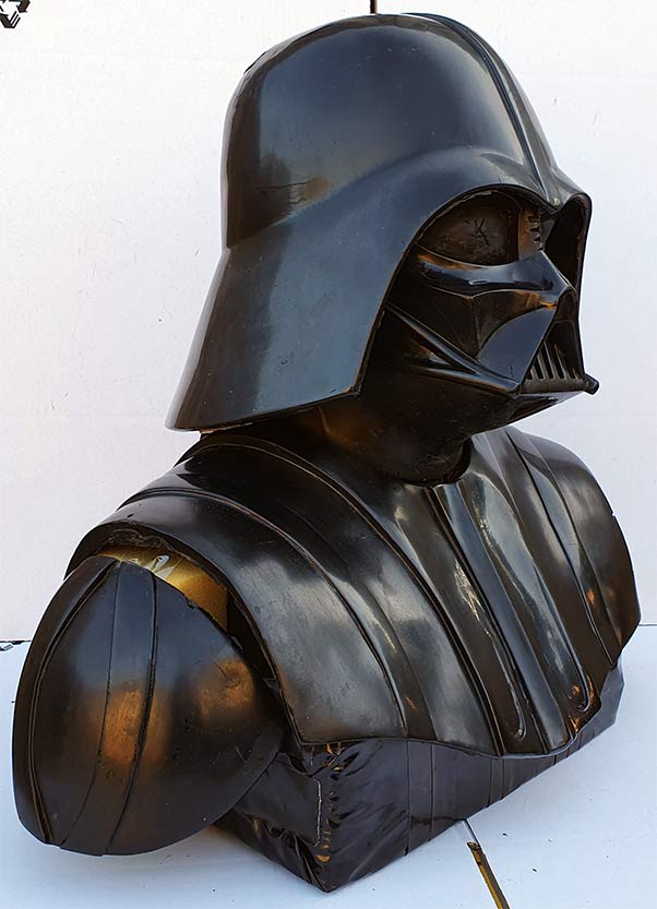

He was sent to Aus in the late 70’s between Star Wars and Empire. He did a lot of promo work and was then retired to a hot shed in Melbourne for a few decades. He surfaced again in 2008 after a long slumber, maybe he should’ve been called Rumple StiltVader. During his time touring, he’s been dropped, banged etc, so he’s really showing the hard life he had. One of the things that happened was a repaint. Well, that seemed to go OK, until they hit him with what looked like varnish as a clear coat. They sprayed on varnish you say? No, no, no, they brushed it on with a paintbrush, drips and all...
Heathans!
As we know, varnish can be quite yellow, so with the bluish tinge of the gunmetal, he turned quite green and still is to this day. You can see the green in the top pic.

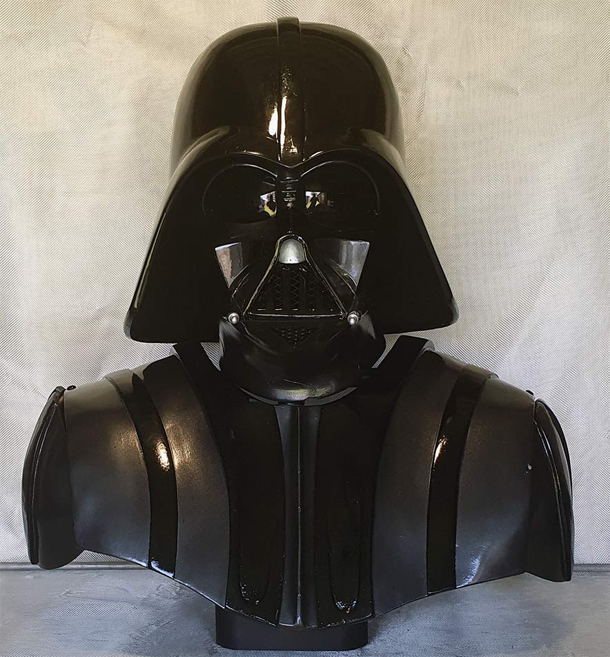

Luckily when I had him in my possession, I was able to make moulds of him and I was able to roughly colour match the gunmetal hue that was under his helmet latch on the top of his face. So I thought I would try and do him justice by painting him the way he should’ve been in the first place.
OK, that doesn't look good, lets try that outside... Partly cloudy and 40c (104f)
Right, it turns out that I suck at photographing Vader. How about B&W?
Nope :(
Being an ANH Vader fan, I had to try one of him too...
Still my fave. Nothing different in the castings, just different positioning and paintjob. The ANH is brushed on Gunmetal and raw gelcoat to help with the vintage look. The Shiny Vader is on a WIP stand that I'm still trying to perfect.

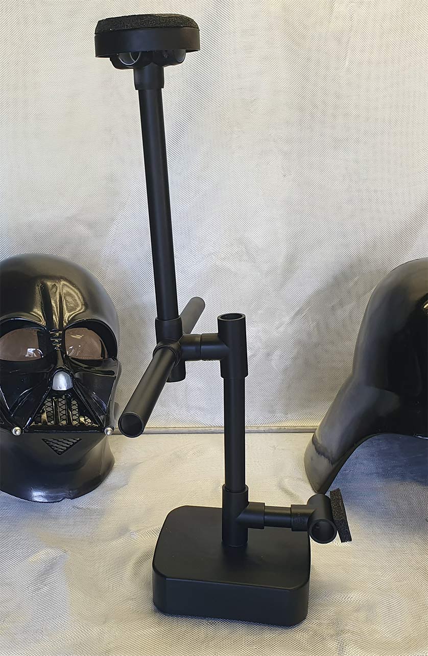

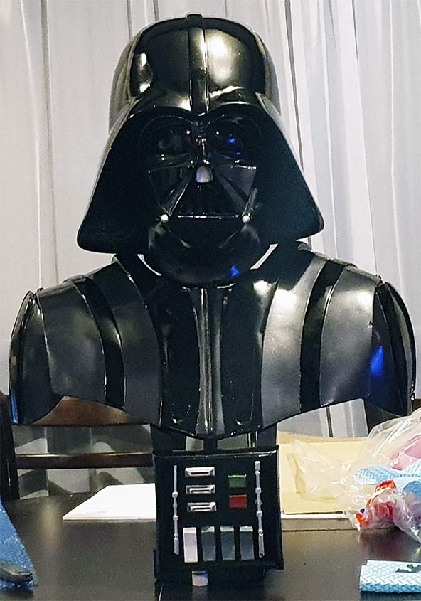

The shiny one's sitting on a prototype stand that one of the cast owners asked me to come up with for them to display theirs nicely in their office.
Basically it's a hardware build using pvc pipe and fittings. The base is some heavy duty galvenized chain I had embedded in resin with a pvc connector pipe in an old Tupperware container for the mould. I think it came out pretty well.
I made it to be able to add an extension to display the chestbox too. Grainy photo alert...
or if on the edge of a shelf.
When I get a chance over the next couple of days, I'll do a list of parts and measurements.

Hey folks, I said that I’d give a more detailed description of the stand I made, so here goes. I know it’s a bit agricultural and you can probably buy stands now, so this is for those that may like to make their own. There will be trial and error as I used foam in the build too, it’s 10mm thick adhesive backed firm foam, it’s the same stuff I used in the helmet and face.
What you’ll need...
1x connector for 20mm PVC pipe for the base to slip the pipe into.
The base is the inside of a 170mmx170mm Tupperware container. I hot glued the connector to the centre of the base and taped over the end with tape. I made up enough resin to cover the bottom enough that when cured the chain wouldn’t show through. I laid some old galvanised chain in and poured the resin in until I had a 50mm high base. Then I stuck some thin leather squares in each corner for feet to protect the furniture.
3x T pieces.
2x 5way pieces.
1x 90mm stormwater cap for the top.
20mm PVC pipe (external diameter is 26.8mm).
Lengths are...
2x 30mm for the base to butt up against the front facing vertical T and top vertical T to vertical 5way.
1x 190mm For the base to butt up against the front facing vertical T if adding the chest box.
1x 45mm to attach the horizontal T to support the armour to the front facing vertical T which supports the neck (see foam).
1x 145mm to attach to the top vertical rear facing T to the vertical 5way.
2x 180mm the shoulders attached to the vertical 5way.
1x 240mm From the top of the vertical 5way to the top, which his a horizontal 5way hot glued into the 90mm stormwater cap 2 layers of foam on top.
Also note that there’s 2 layers of foam in the face to fit the wearer.
I hope that made sense.
