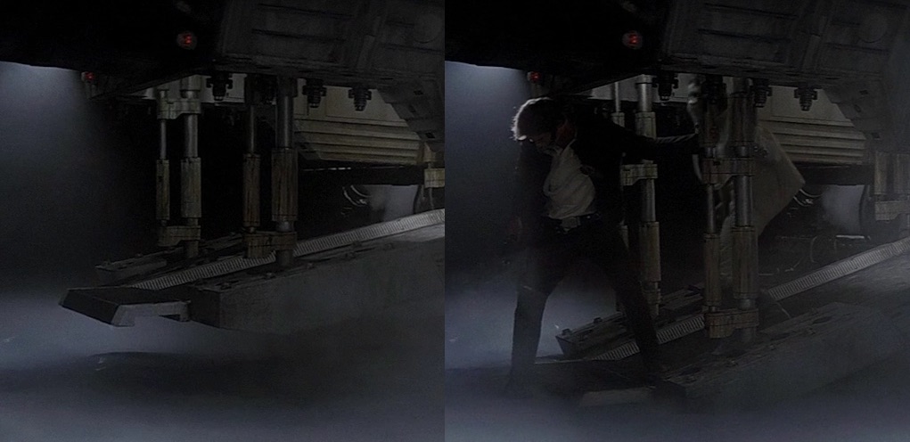

Yes, it's true there is an open area around the base of the frontmost pair of piston rods in the ESB and ROTJ versions of the ship (but not ANH) - something that hardly any model correctly replicates. You'd need a bit of open space if you had a pivot, but not as much as what they actually built. It's very difficult to see in the actual film footage owing to shadows, blowing smoke, etc. The best view I've seen of it is in a set photo from the unused Tatooine sandstorm scene from ROTJ, assuming the ramp base design is the same as ESB's.
However, I don't think that this opening was designed for a mechanism for lateral movement of the rods. The space slug scene in ESB clearly shows lateral movement of the piston rods inwards as the ramp descends, which wouldn't happen if you displaced the rod motion at the ramp connection point.
- nkg
I’ve never discerned lateral movement of the rods, but then I wasn’t really looking for it. If you say you see it, I’ll take your word, as you seem to be a fellow rivet counter. They most certainly could have done it that way, and probably did. Next time I watch TESB, I’ll look for the lateral motion.

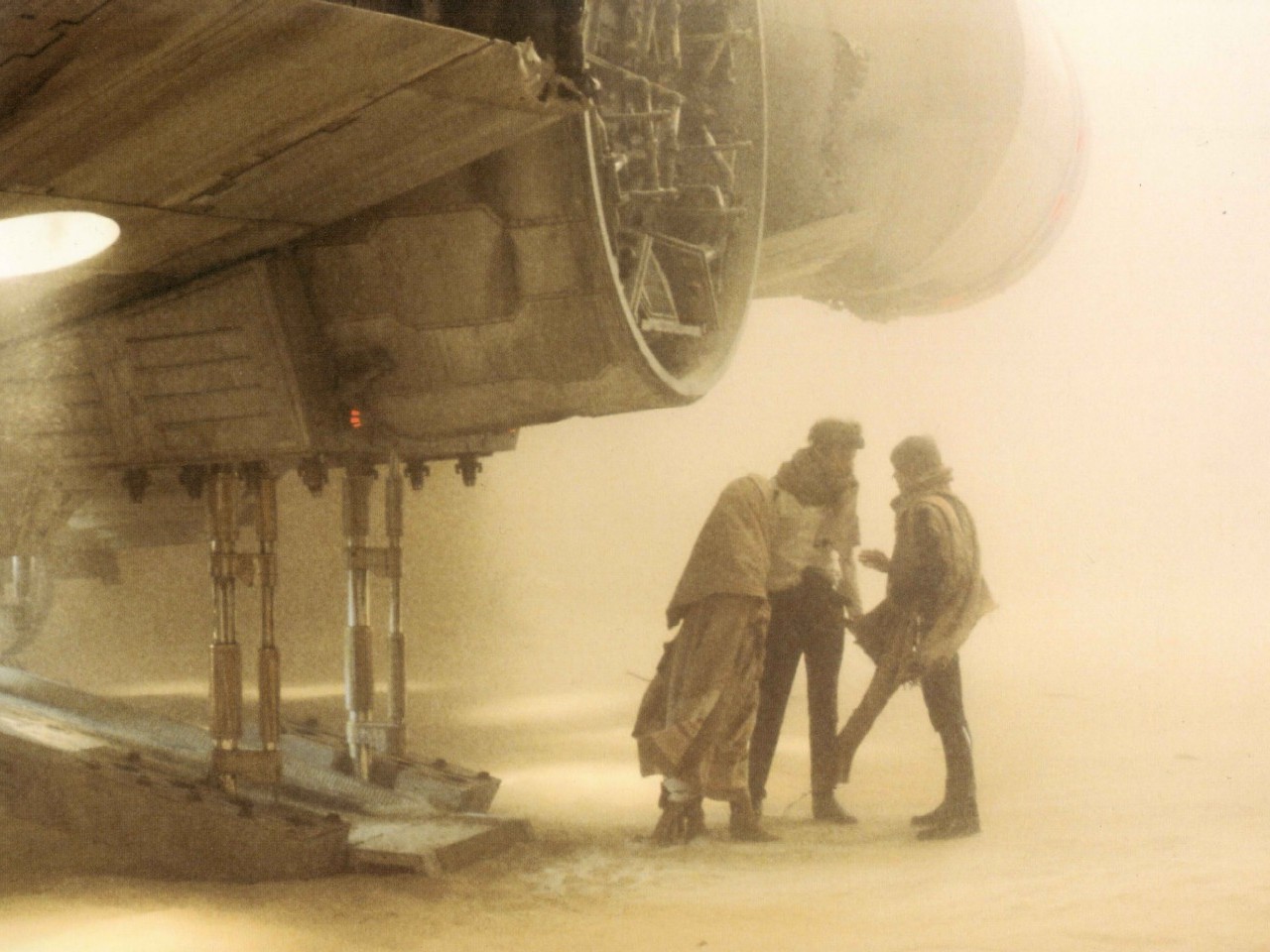

In ANH the ramp obviously never moves, and so the bottom step is always permanently extended. In fact, it's a bit too wide, so it doesn't make much sense in terms of its design - how could it flip back on its simulated hinges given its excessive width?
In ESB the ramp moves but is never shown closed, and in fact always shown at least 2/3 of the way down already. And so the bottom step, though a more logical width, is always sticking out - on Hoth or the space slug. Or flipped up, as in the Bespin arrival scene.

Well, at SOME point, SOMEONE had to fold it and unfold it because we see it unfolded when down on Bespin. Had it not been done, the actors would have stumbled over it on their way down the ramp onto the landing platform. But I know you are right in spirit. For example, they never bothered to close the belly blaster door after it was used when our heroes were trying to leave Hoth. And there it was, wide open inside the space slug.
