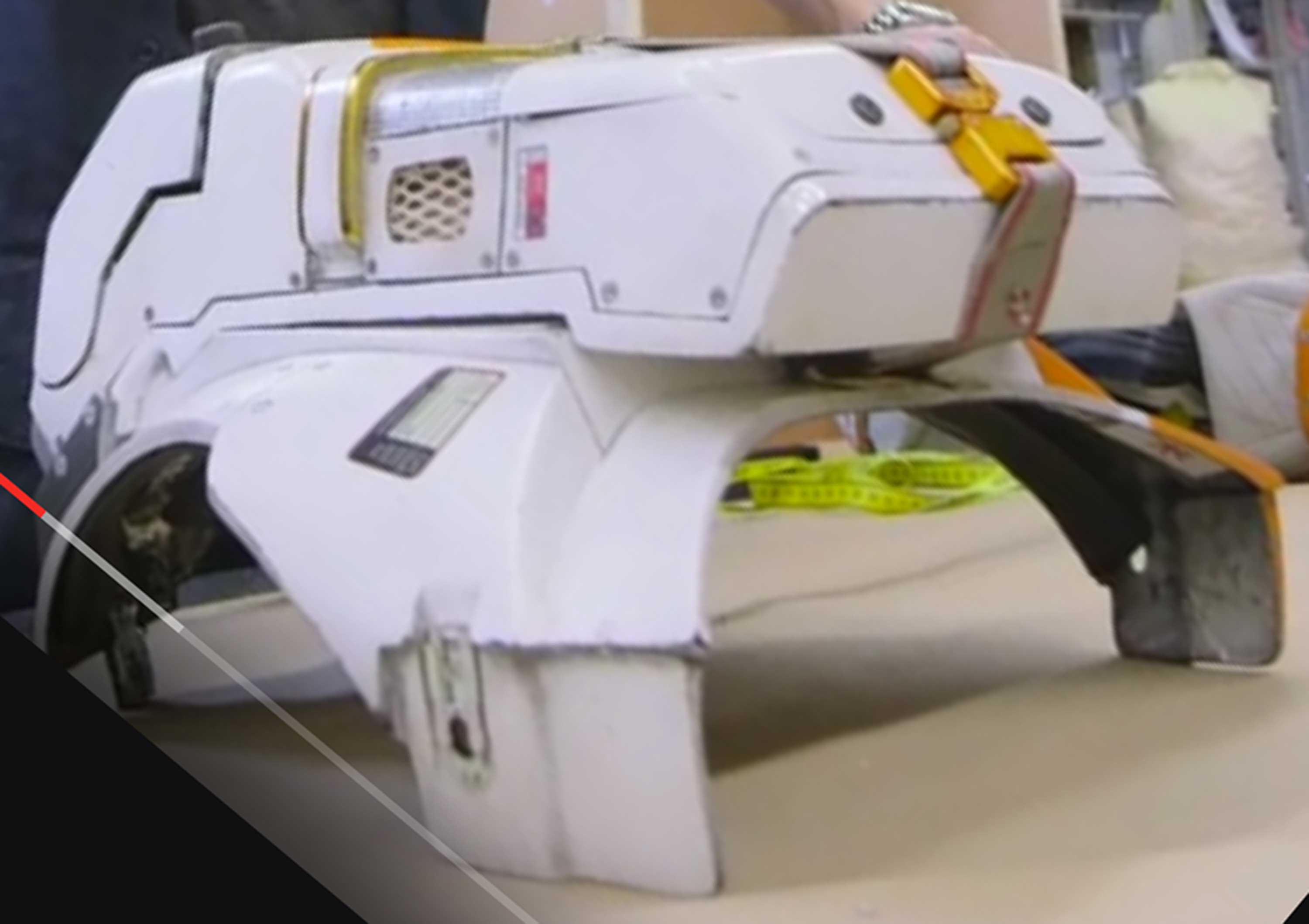

I'm so jealous!!! I did notice in one of the shots you get to see them taking it all apart and as suspected there is an extra nautic cobra at the back connecting the harness to the chest piece.

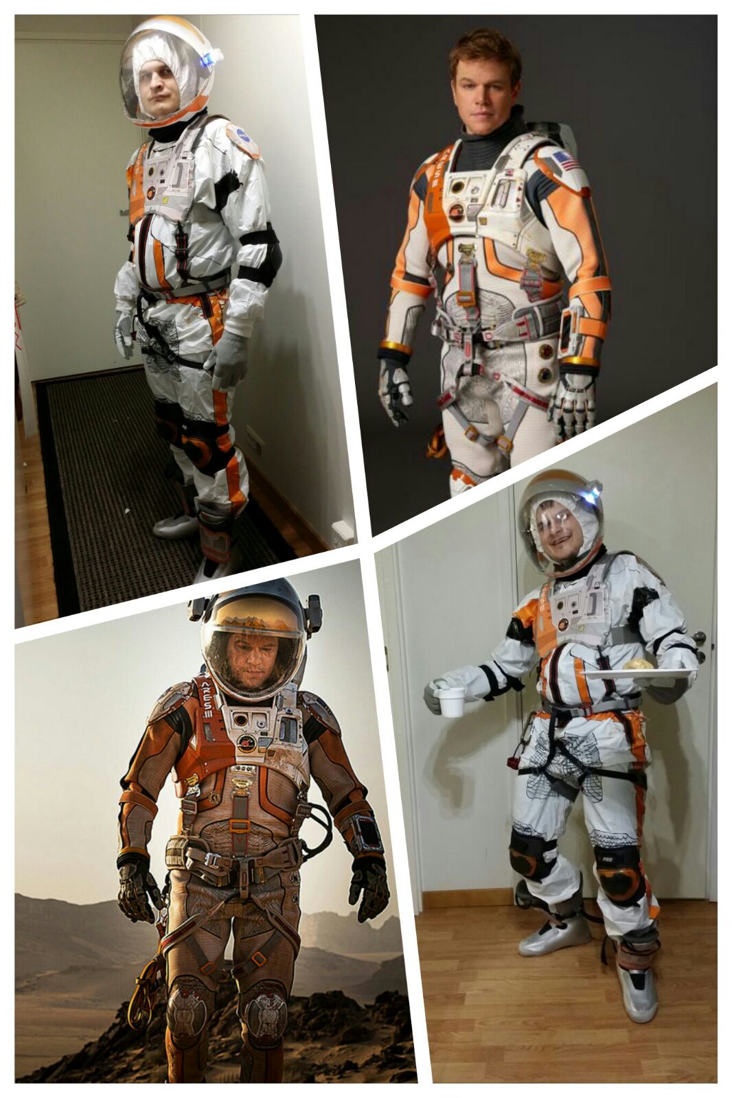

I managed to build it in time for the oscar party, had to cut a lot of corners but its alright for what it was for :)
What I would do differently:
1. Buy 2-3mm PETG only.
2. For a fast build like this, use tape instead of spray paint. (or have more time to let the previous coats dry. -_- )
Lots of cheating going on, but it was quite nice :D I forgot my 2 blood pressure meter air pumps at work so I couldnt get a supply of air going into the helmet, therefore I didnt build a neckring at all. Needed more lights :(

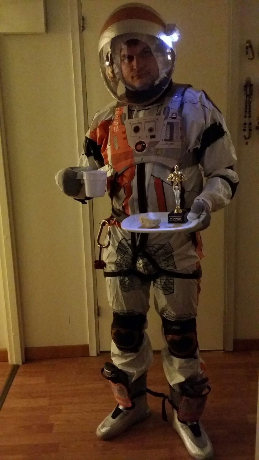

View attachment 598302View attachment 598301View attachment 598300
