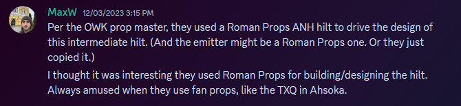

Wouldn't be surprised if that's the case. Apparently, they used his Inception Elite for OWK's Belt-Hanger

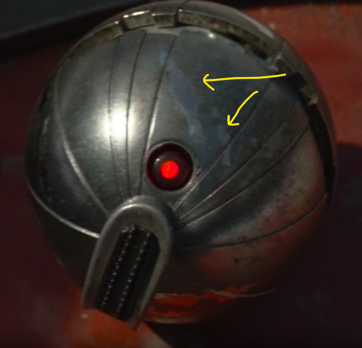

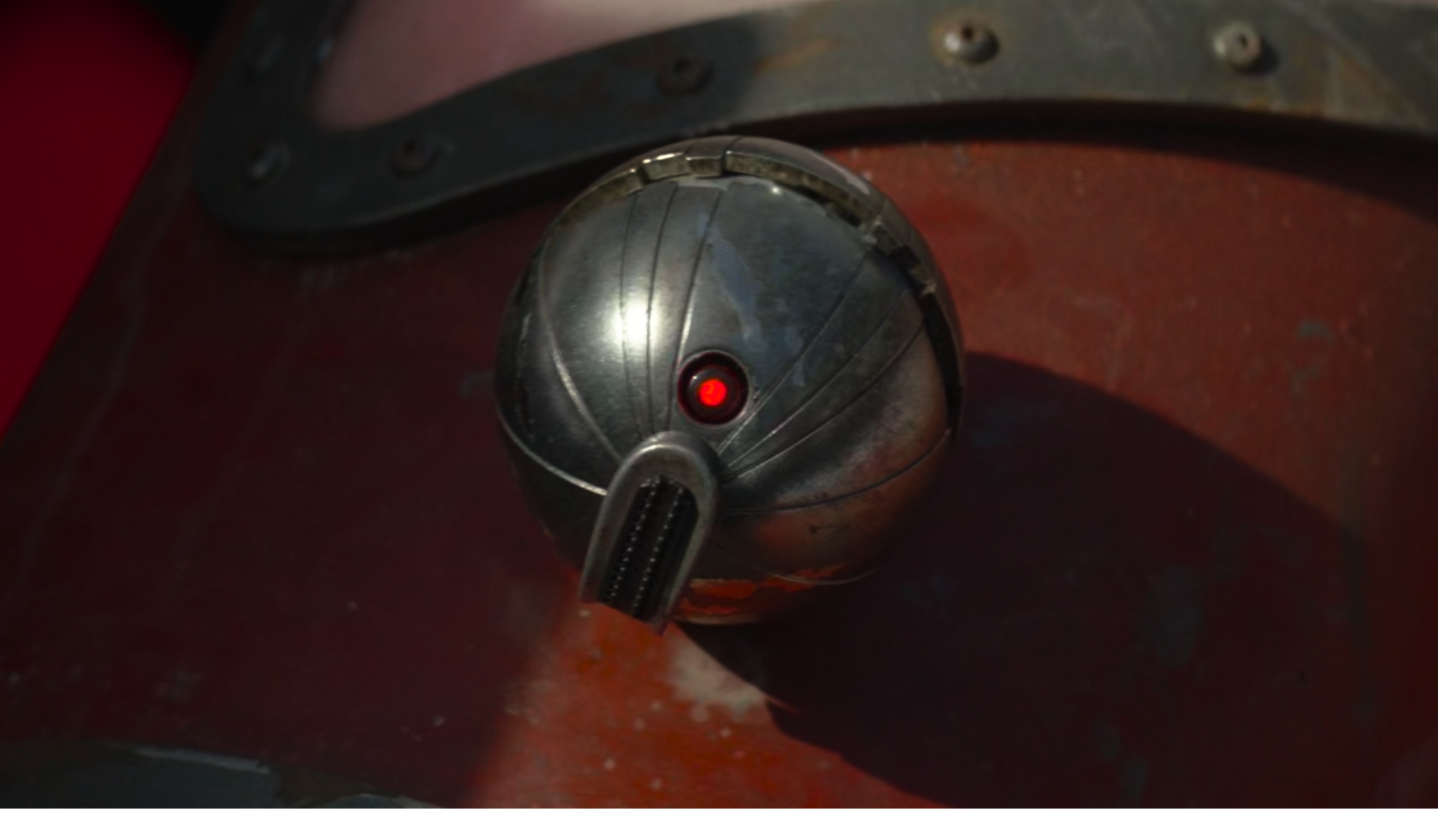

im hesitant to believe because if you check a screen shot of the thermal detonator used in the madalorian s2 e7 the texture seems different to the clean version or even the weathered version on roman's website.
maybe the production team for the mandalorian s2 weathered... or painted the detonator, but, is there any confirmation on that?

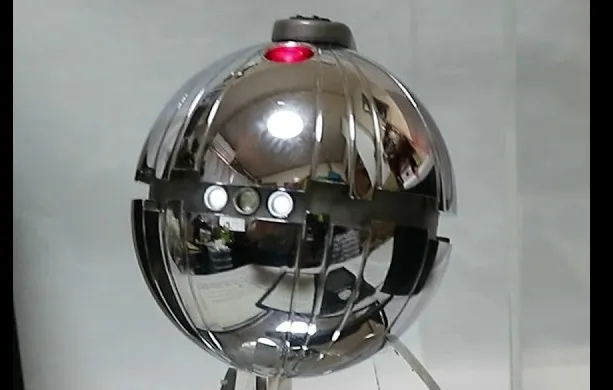

here are a screenshot and the roman clean version

100% true, whether you chose to believe that is up to you..
That’s not the only props Roman has supplied to production ;)
well... what i want is irrelevant, i'm ok with either truth.
so, definetely he was the provider for the ep7 in madalorian season 2, TD that's big.
Halliwax what do you think they used on the prop for the scene?, it does not look shiny like in the roman's site, the texture seems dull...
A satin clearcoat is all it would take. Even a couple layers of a wash weathering would make it less shiny.
Yeah... I thought something like that could have been done to the prop by the production team.
But i would like some more insight, im parciallly colourblind, so i might get wrong some aspects of a prop on screen.
To me, it seems like there is some colour added to the props, its nott only the dullness, it seems to be some slight texture, probable by the coating or whatever they did to the piece.

Sure, here's what it looks like to me, and the steps I would go through to reproduce it:
  1. I would paint liquid latex masking with a small paintbrush directly on the shiny surface in these spots (and others as needed):
    By "as needed", I mean that I would also hit some high points and edges with the latex masking liquid to simulate a finish being rubbed or scuffed off.
  2. I would clearcoat the entire thing with satin, and let it dry 24-48 hours.
  3. I would rub off the latex masks with a finger.
  4. I would weather the whole thing in a layer of watered-down dark brown acrylic paint, applied with a paintbrush and a little sloppy, and then picking up most of it with wet and dry cotton balls, dabbing irregularly. And then let it dry.
  5. I would weather all recessed surfaces in a layer of watered-down black acrylic paint with a paintbrush, and then try to pick up as much as possible, this time dabbing with only wet cotton balls. I'd want the black only in the deepest recesses. And then let it dry.
  6. If I had trouble with the weathering after it's all dry, I'd rub off any excess with a wet cotton swab and/or cotton ball. This gives me a "caked-on" effect for the over-weathered bits of paint that will "break off."
I do not believe any other colors were used in the final finishing...The lighting that's used can make a difference too.
Hope that helps!
