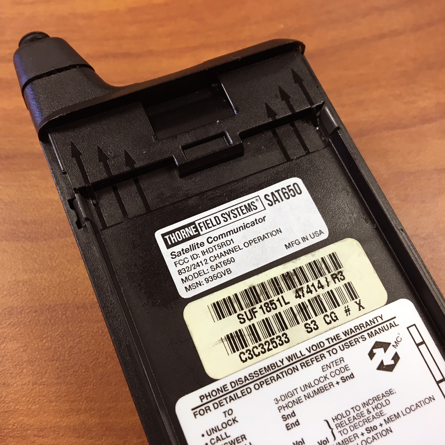

Here is what I came up with. Because the novel was published in 1995, I used a vintage Motorola cell phone from 1995. I re-branded it with "Thorne Field Systems" branding and logos that I created in Photoshop.

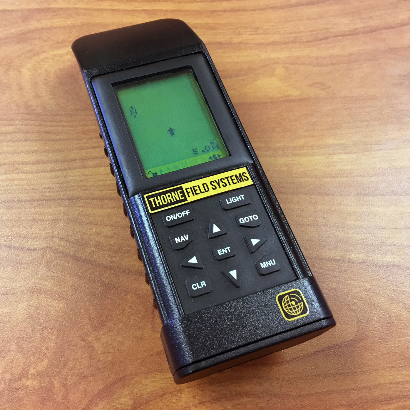

“Thorne unclipped a small [GPS] receiver from his belt. It looked like an oversized pager. He stared at the liquid-crystal readout. "I'm not getting any signal....'” -Excerpt from The Lost World by Michael Crichton (1995)
My interpretation of the device is made from a vintage Magellan 3000 GPS receiver from 1995. I removed the Magellan branding and replaced it with "Thorne Field Systems" branding. I painted the LCD bezel and I also added a belt clip to the back of the device as the original Magellan device did not have a belt clip on it.

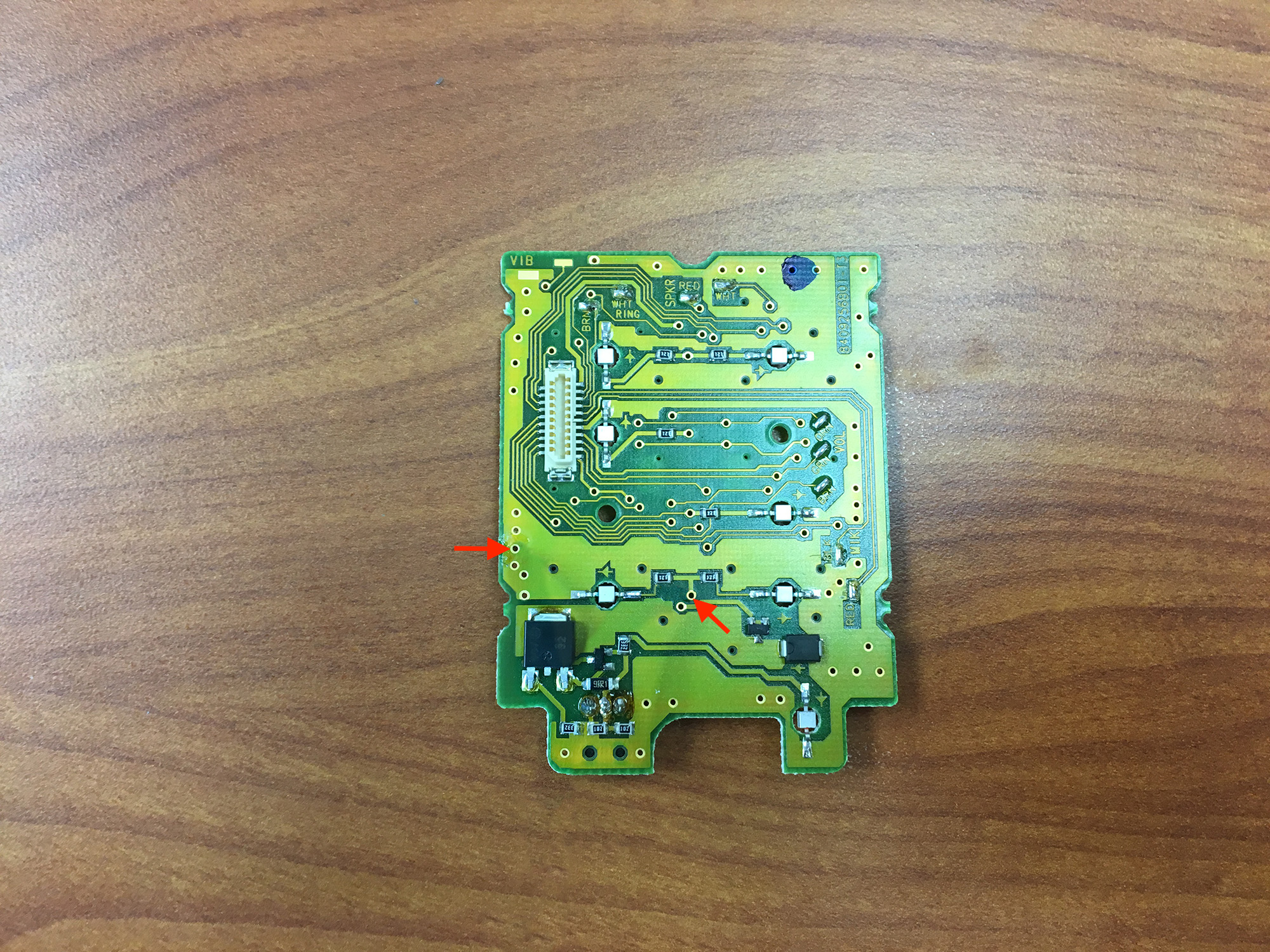

SATELLITE PHONE KEYPAD BACK LIGHT

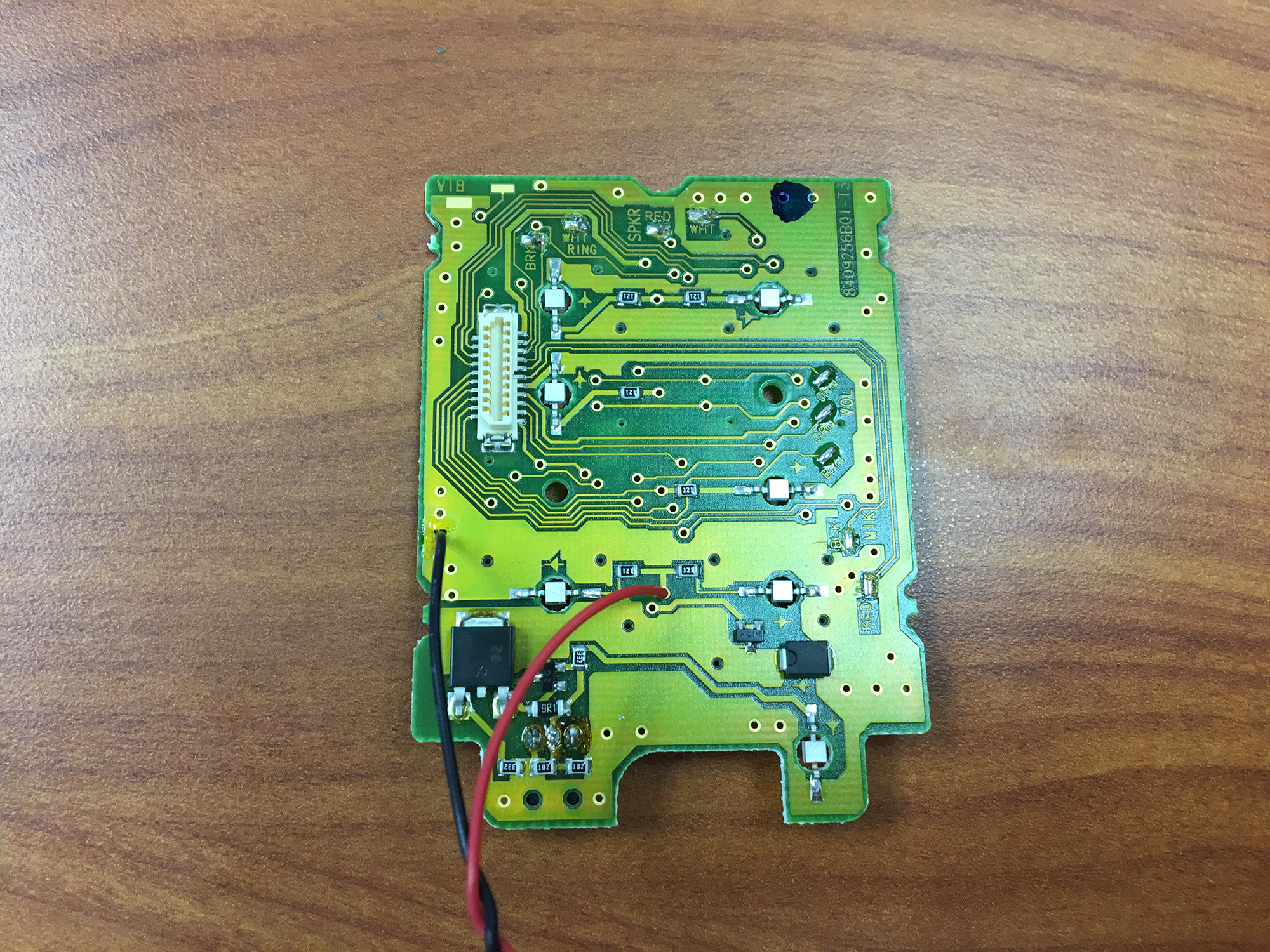

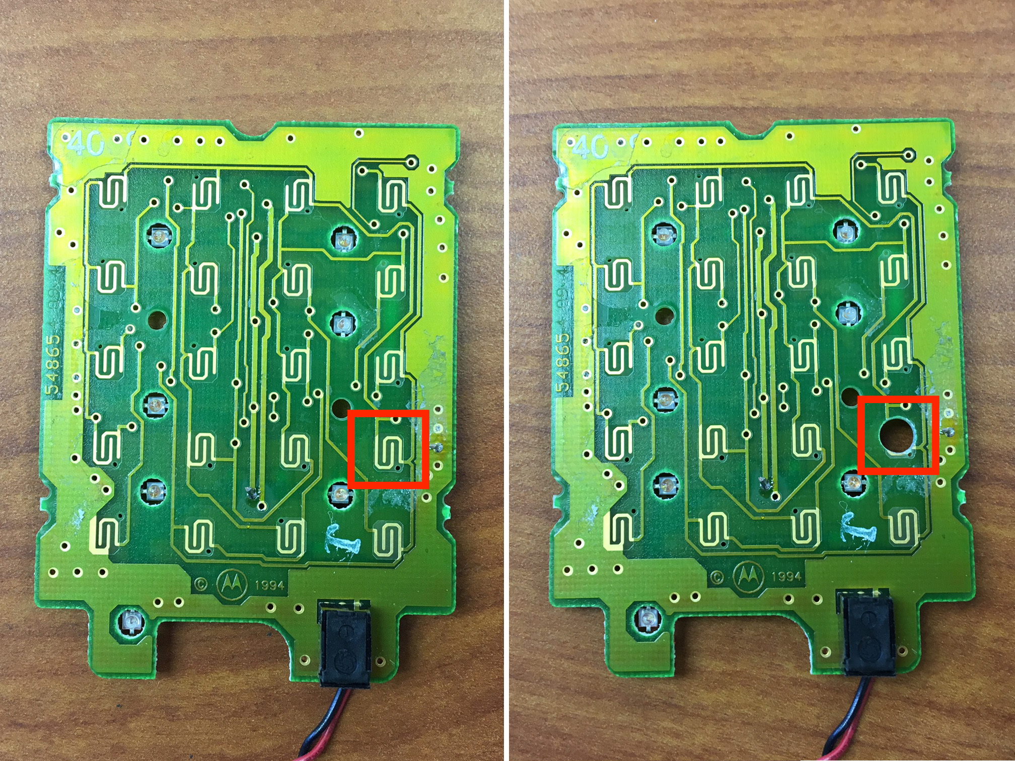

I worked on the Sat Phone electronics a little today. I decided to start with the keypad. It doesn't necessarily need to be fully functional, but I do want the keys to be back lit. Instead of wiring up a whole brand new set of LED's, I decided to see if I could get the original LEDs inside the phone working. I began by taking apart the phone to see if there are any parts I can re-use inside.
Luckily, I found that the keypad circuit board is a separate piece from the main phone circuit board. Here is the keypad circuit board. It has the keypad button contacts as well as 6 tiny green LED's which function as the keypad back light.

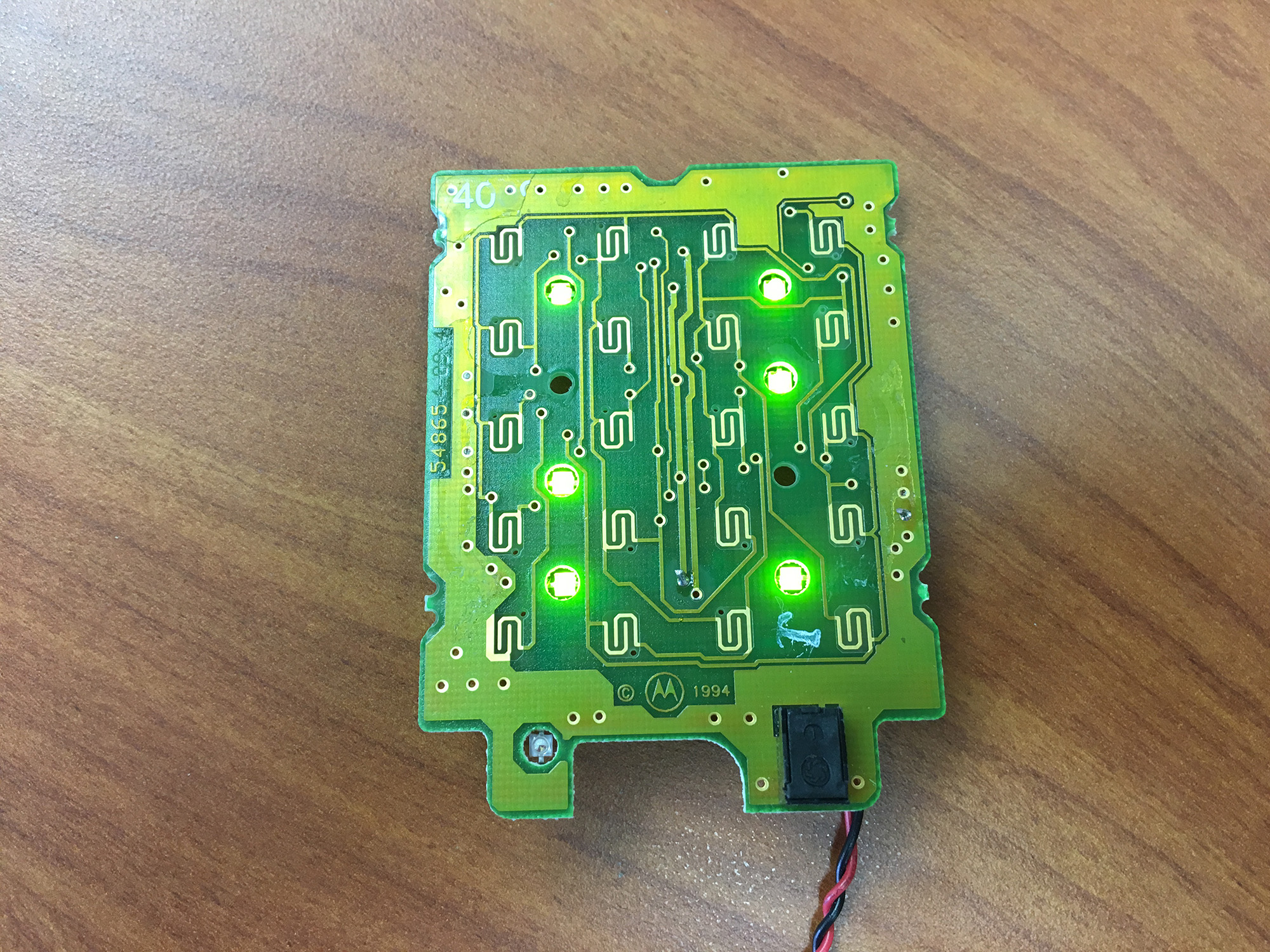

I poked around a bit on the back side of the circuit board with a 5V power supply and I found some empty solder points that made the green LED's light up. Perfect! So, I soldered some wires to those two points.

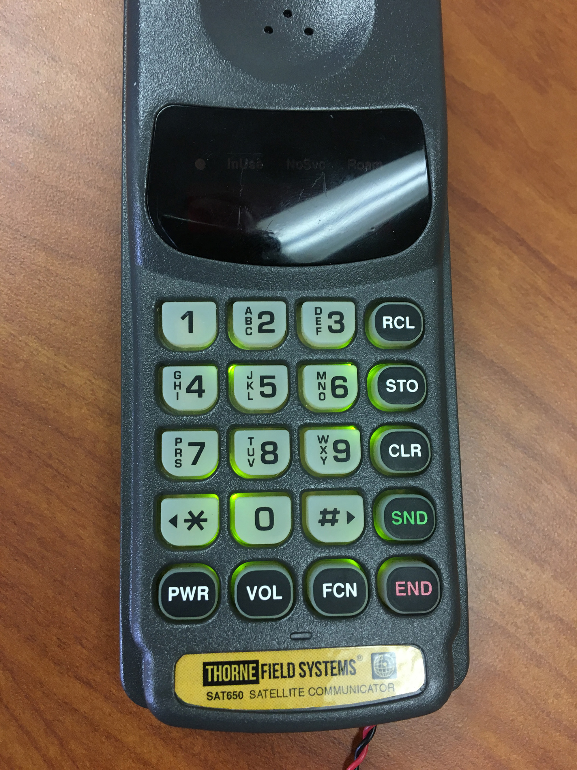

Here is what the LED's look like when lit. They don't illuminate the keypad very evenly, but this is the way it would have originally looked in 1995 when the phone was new. That small detail keeps it looking like a vintage device, which I like.

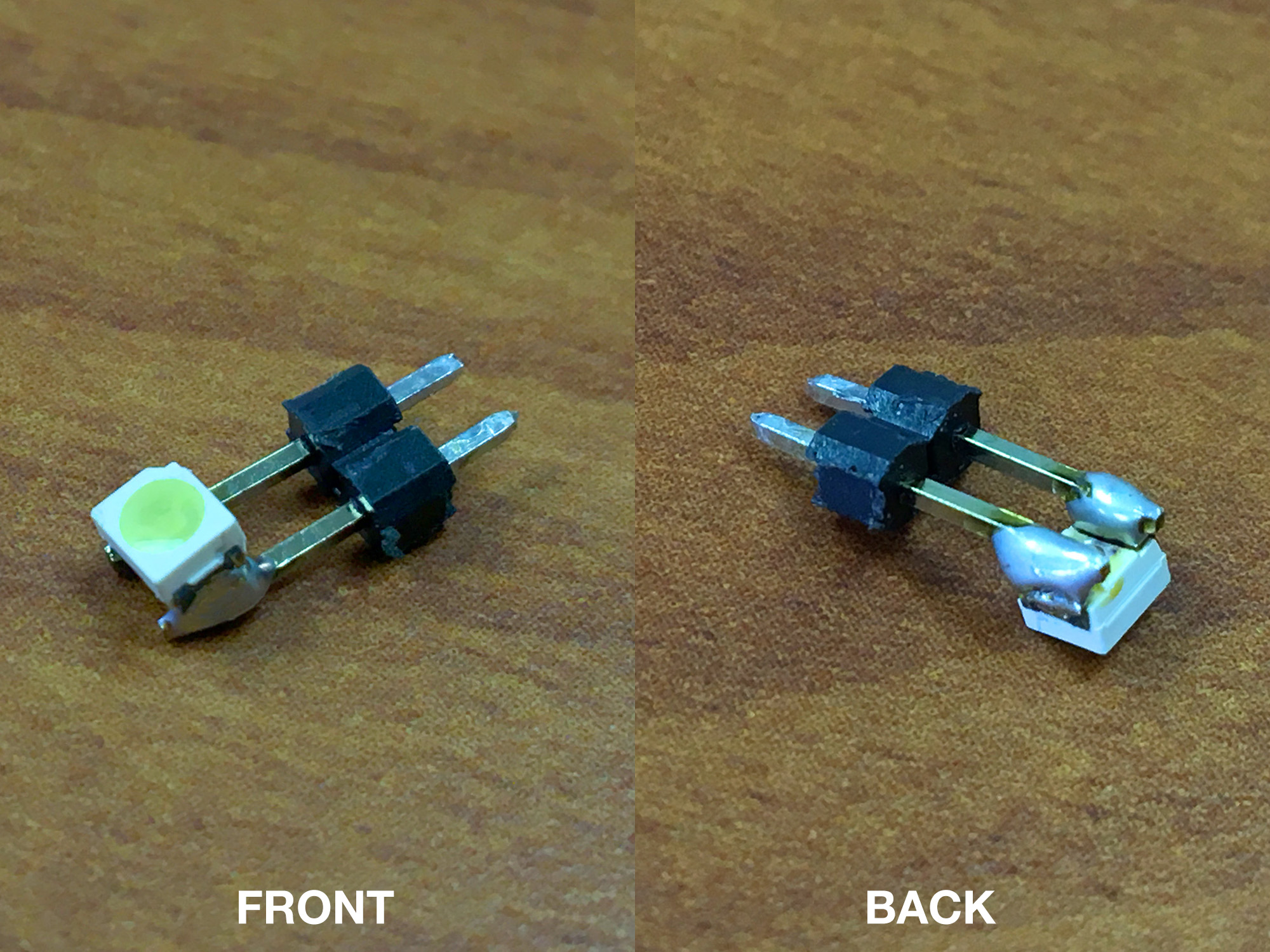

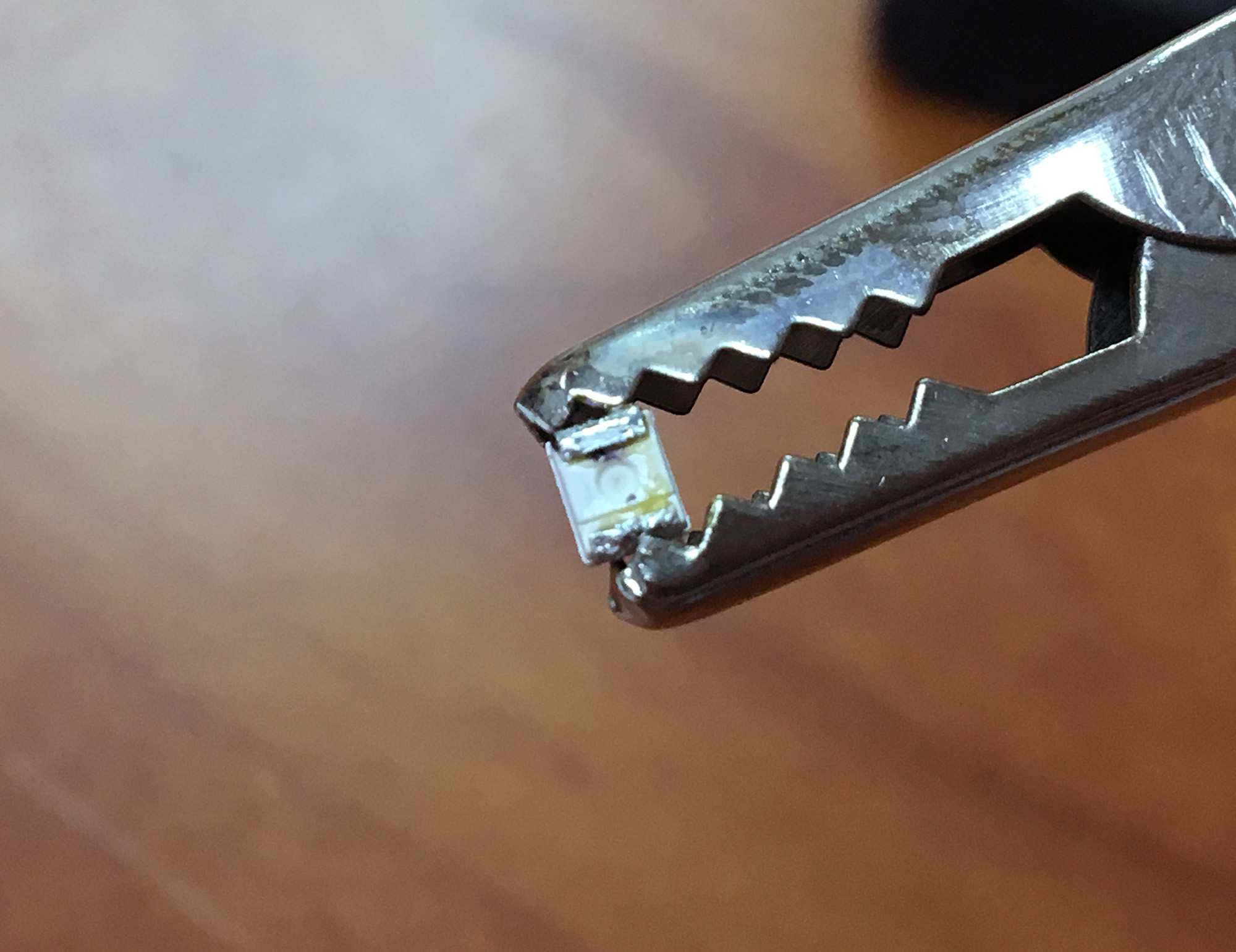

Here's a closeup look at how tiny each individual LED is after being de-soldered from the part.

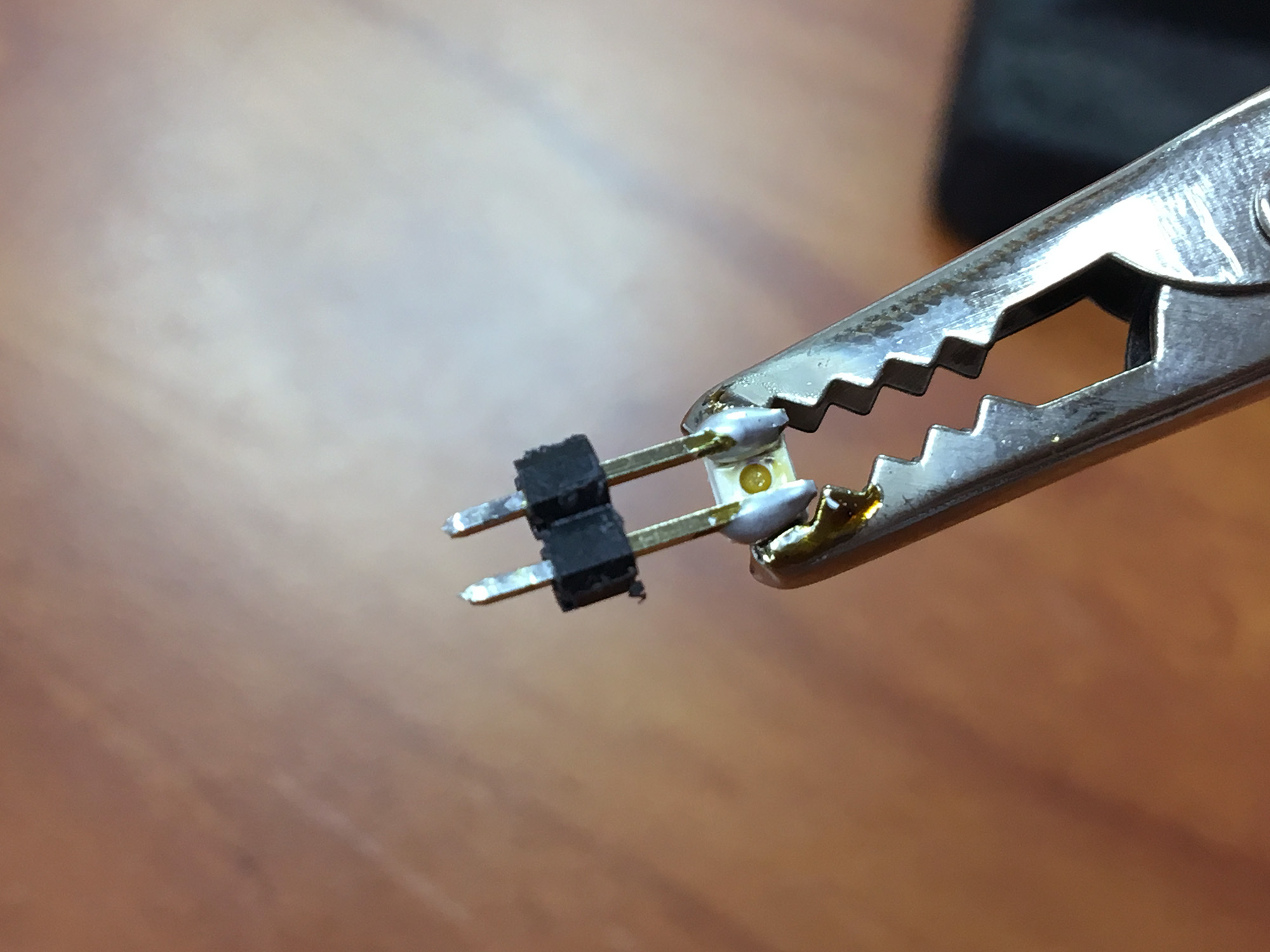

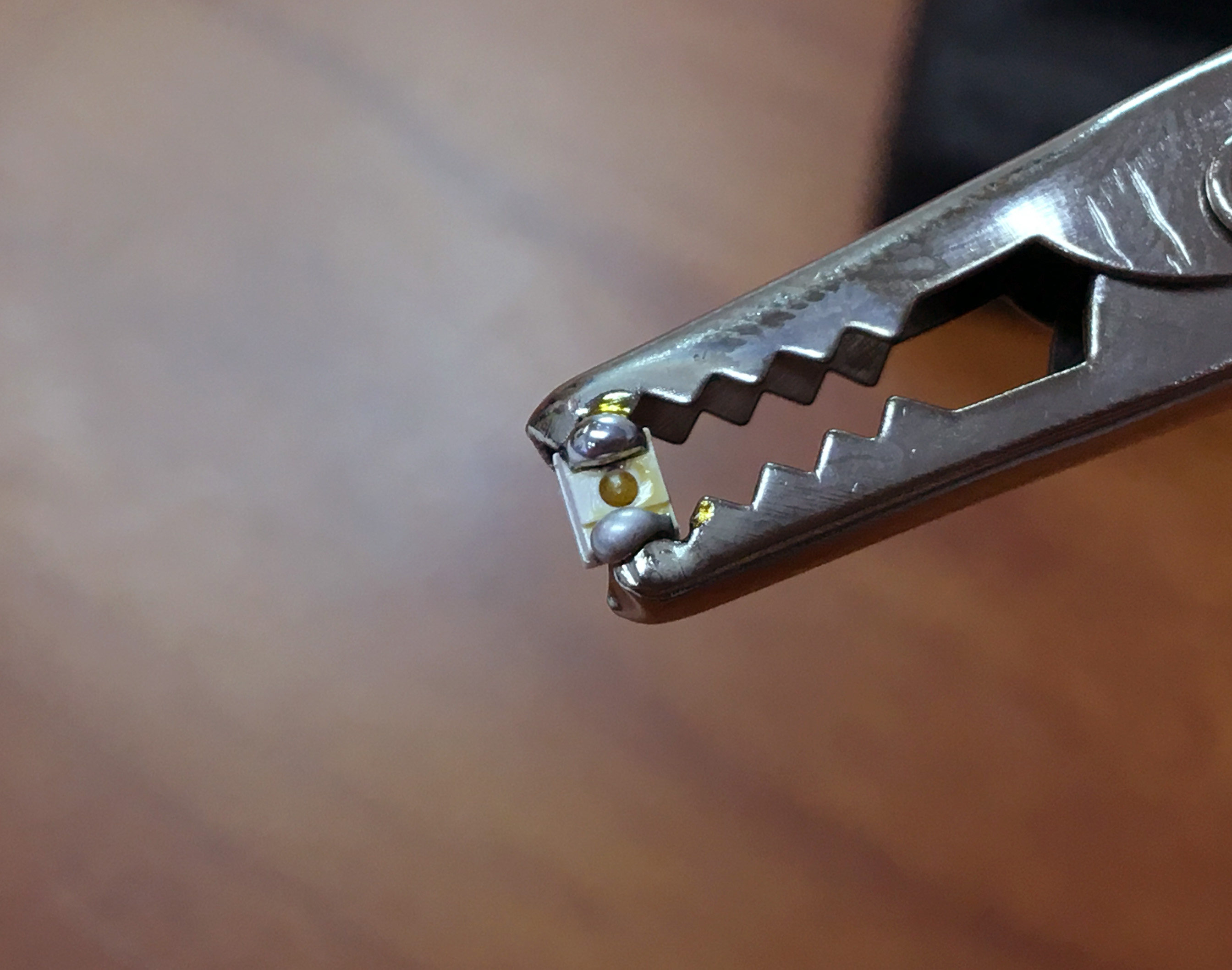

The two solder contacts on each LED are pretty small, so I decided to solder some connection pins to each one so that it will be easier for me to connect wires to them. First, I clamped the LEDs in my "helping hands" alligator clip thingy. I then added a bit of extra solder to each LED contact. This made it easier to solder on the connection pins.
And, here is what the final individual LED assemblies look like.

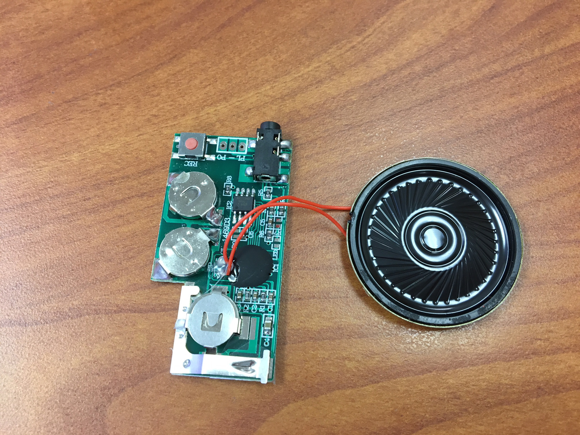

SATELLITE PHONE SOUND MODULE
The display and backlit keypad aren't the only modifications I want to do to the sat phone. I also want to incorporate a sound module and speaker so that the phone sounds like it's making a speakerphone call, complete with ringing and dialogue.

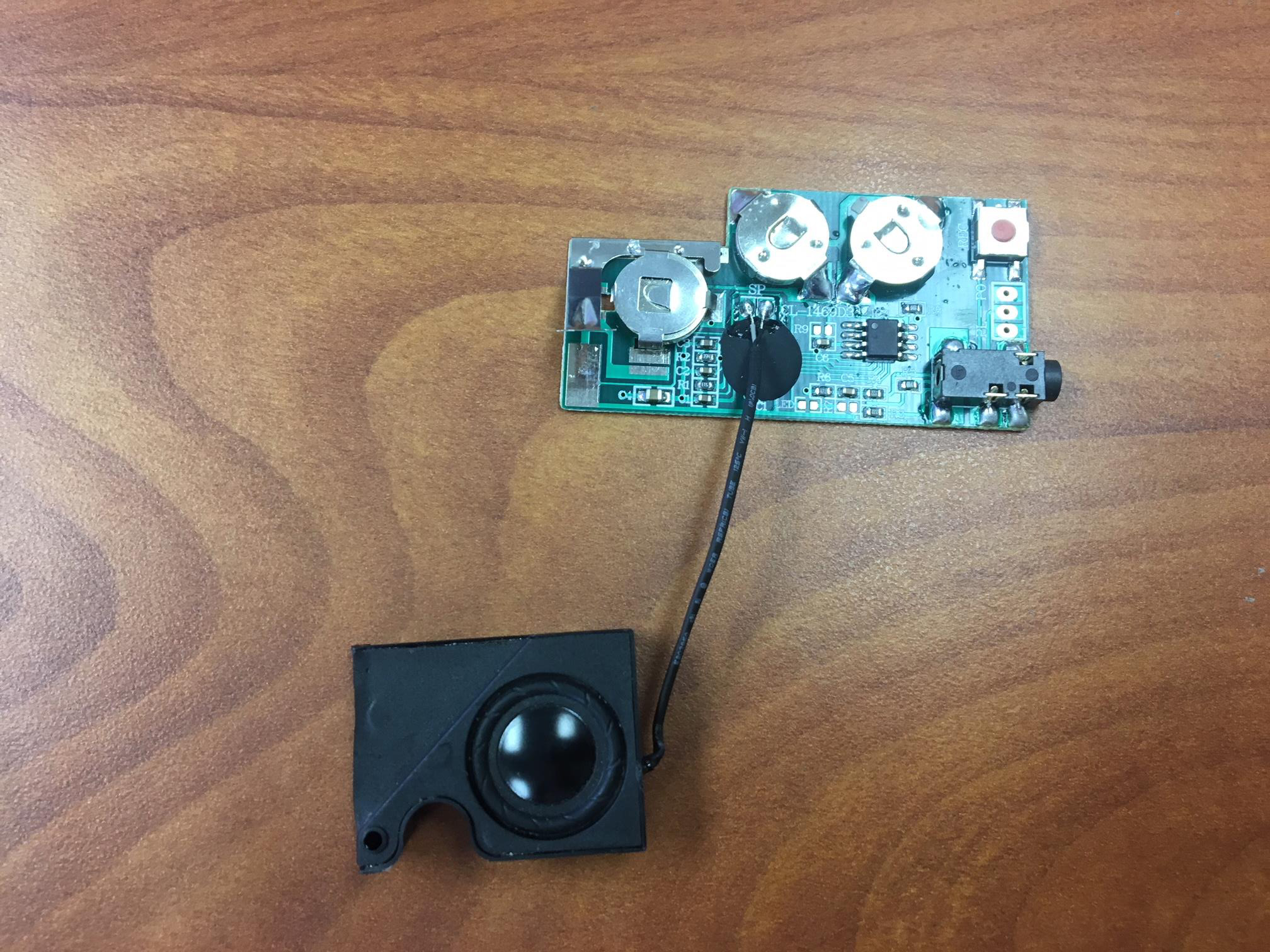

I found a small , simple sound module that can record and playback a 120 second audio clip. It's designed for "talking" greeting cards. I got this one on Amazon for around $10.
After some initial testing, I realized that the small speaker that came with the module was not going to be loud enough to mimic the sound of a speakerphone call. So, I salvaged a small speaker out of an old laptop, and replaced the stock speaker with it. It is noticeably louder and the sound quality is much better. The laptop speaker is also slightly smaller than the stock speaker, so that is a plus since space inside the phone is very limited.

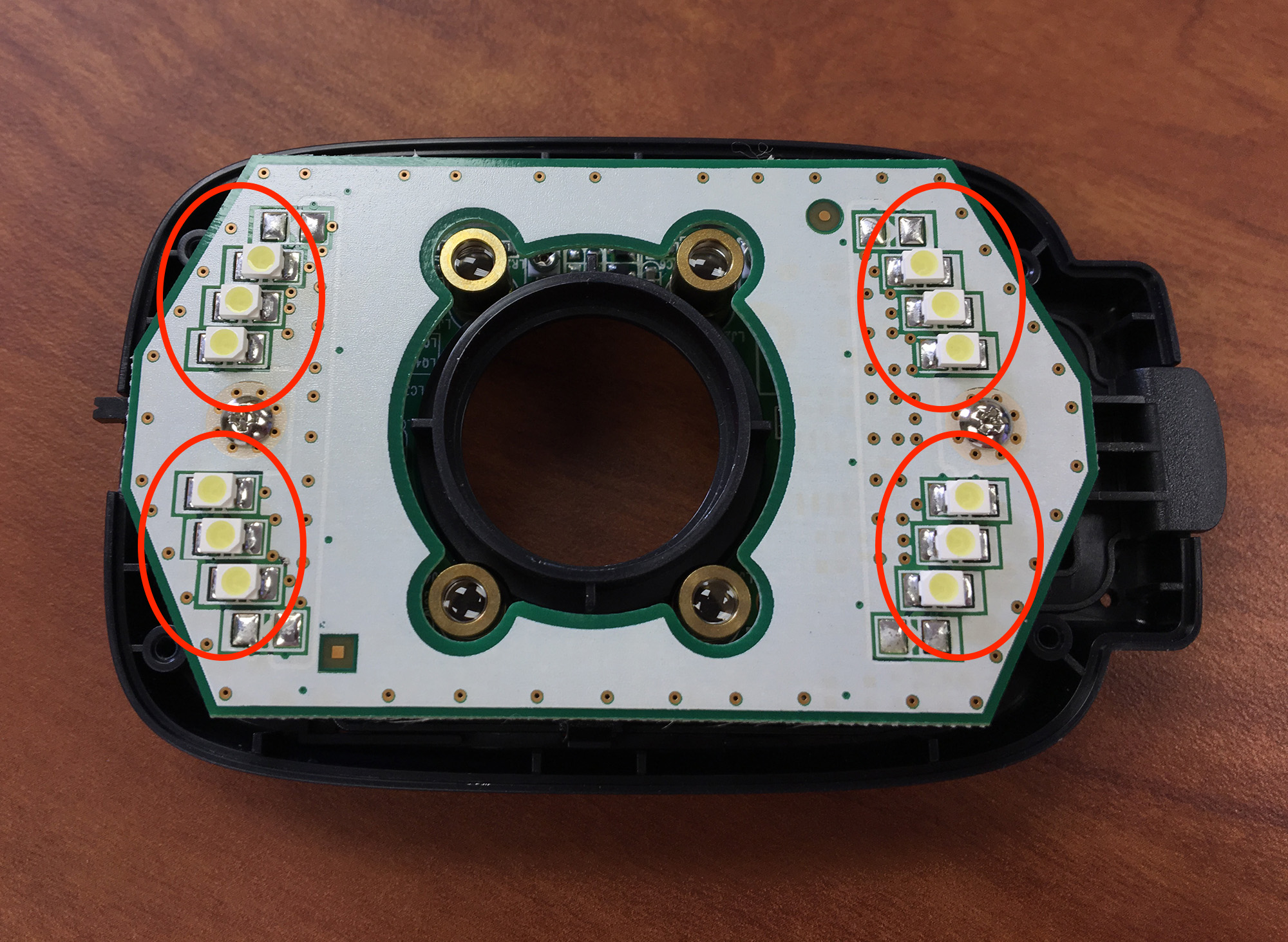

SATELLITE PHONE LCD DISPLAY - "DISPLAY" BACKLIGHT - PART 2

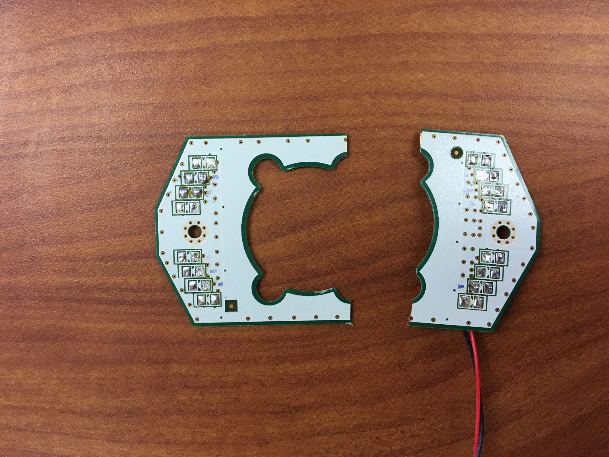

I have the tiny LED assemblies built for my display back light, so now I have to figure out how I'm going to power the LEDs. I decided to use the original circuit board that the LEDs were originally salvaged from. I figured this would be the easiest way to go since the board is already configured for those specific LEDs.
I plan on using a total of 8 LEDs. The original LED circuit board had plenty of places to connect LEDs, but I noticed that it looked like there were some un-used LED connection points that may be of some use to me. If I utilize those empty LED connections, in addition to the other 6 LED connections next to them, this would allow me to keep all 8 of my LEDs connected to one side of the circuit board. The importance of this connection method will make more sense later on.

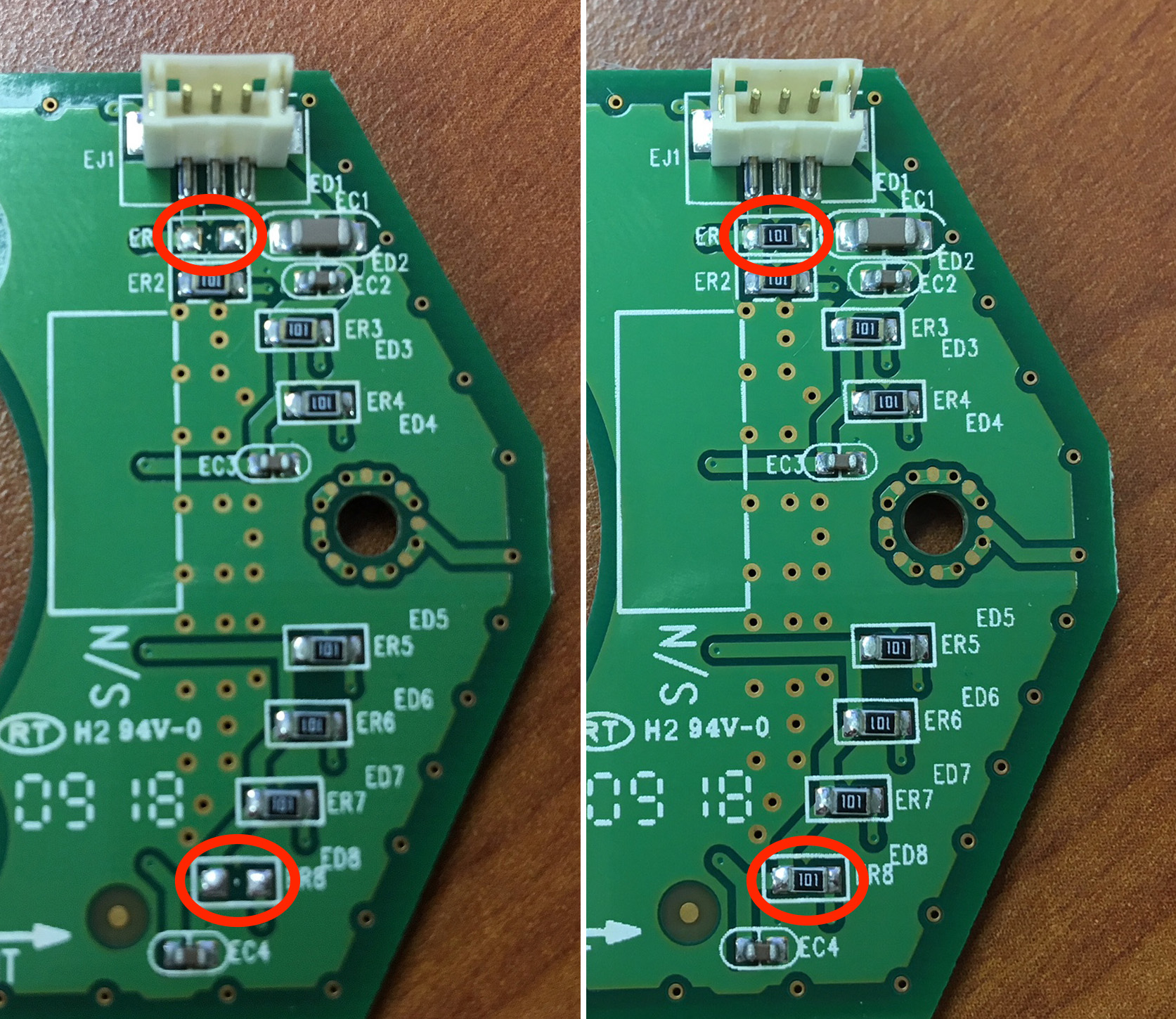

In order to use those empty LED connection points, I needed to make sure they are receiving the proper power. On the flip-side of the circuit board, you can see that the surface mount resistors that would power those LEDs connections are missing. So, I soldered in some tiny surface mount resistors in those locations. Those previously un-used LED connections can now be used. And, those resistors are TINY! It took some patience and a steady hand to solder them on, but I was finally able to get them connected.

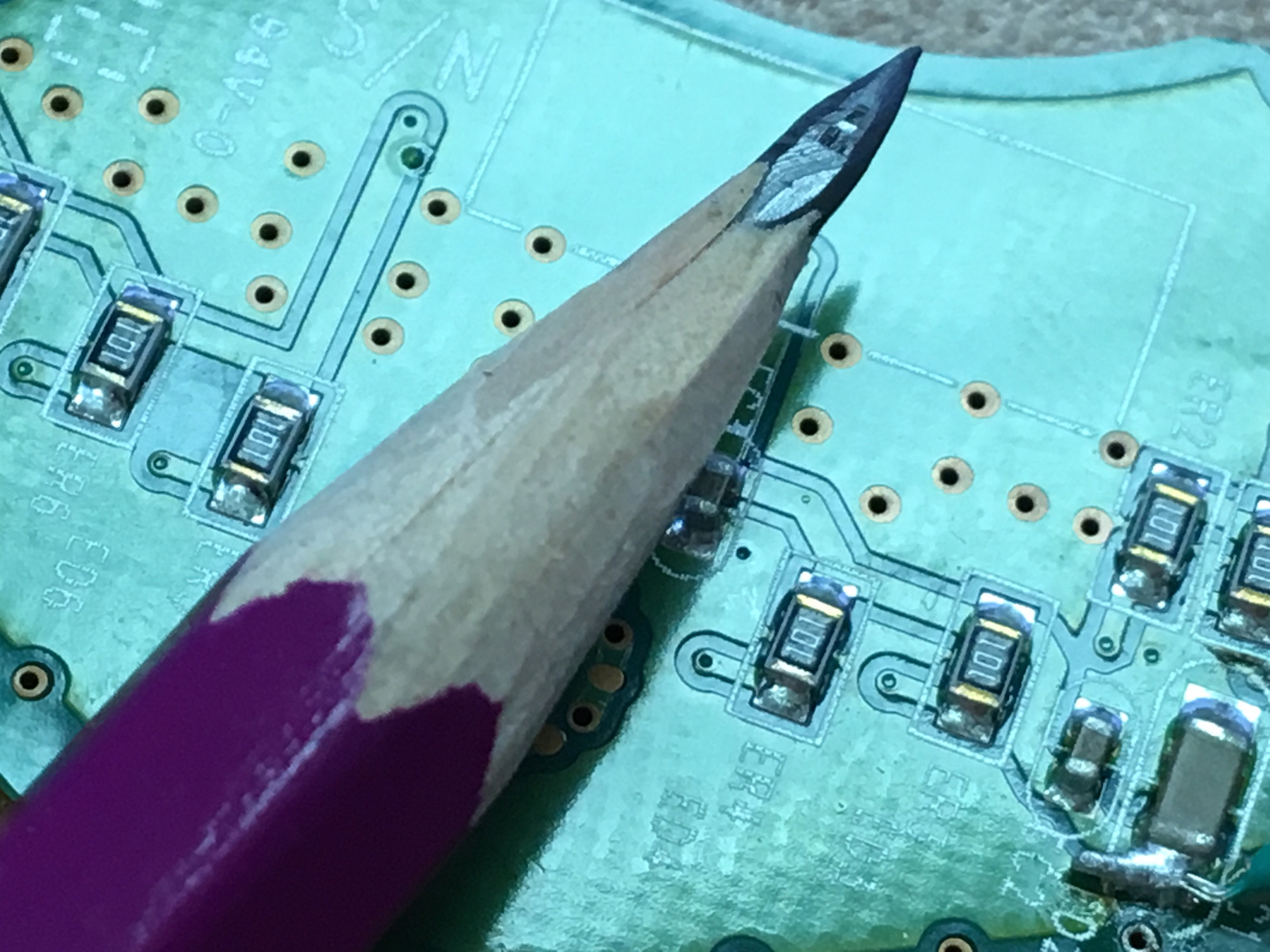

Here's a look at just how small those surface mount resistors are!
SPACE CONSIDERATIONS INSIDE THE PHONE
As I mentioned before, there is very limited space inside the phone shell for electronics. So, if I could get the LED circuit board reduced in size somehow, then this would allow for more space to mount the other electronics. "How can you reduce the size of a circuit board?" you might be asking. Well, that's simple. Just cut off the part you're not using!
Now you can see why I wanted to limit my LEDs to just one side of the circuit board. By doing that, I was able to then use my Dremel to cut off the other side of the circuit board where the extraneous LED connections were located. This left me with a circuit board with a much smaller footprint that still has the 8 LED connections that I need. No more, no less.
Yes, the board still works. The board layout is very simple. The traces I cut through only supplied power to the section of board that was not needed. All circuitry on the side I kept is still intact.
I finished up the LED assemblies that are going to be used as the display backlight. I first removed the plastic piece off of the header pins since I'm not going to be mounting the LEDs directly to a circuit board. I then soldered on the wires and finished them off with some heat shrink tubing.
I will be soldering the wires from each LED assembly onto the connection points on the LED circuit board I worked on in my last post.

SATELLITE PHONE - LCD DISPLAY INSTALLATION AND TESTING
I installed my fake LCD display into the phone shell using copious amounts of hot glue. That was about the only reliable way to secure it in place.
And here is a test run of the fake LCD display and the keypad back light. These components are being powered by the on/off switch I installed earlier. I'm happy with the results so far.
