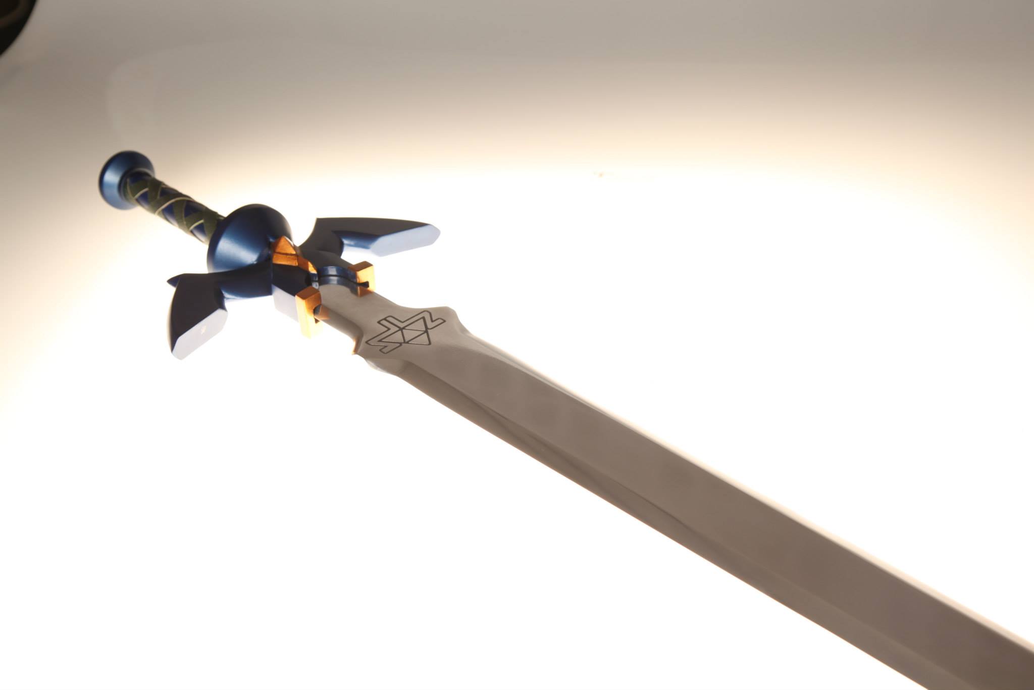

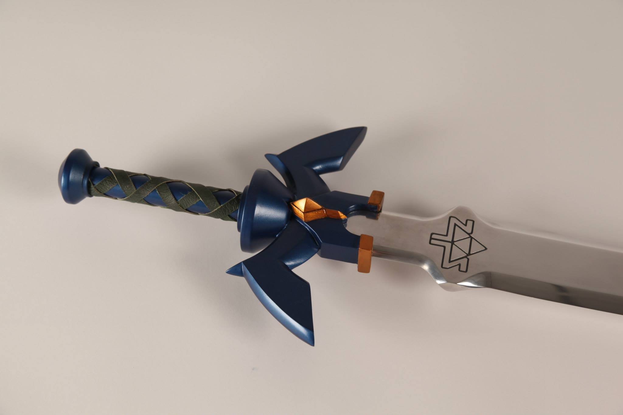

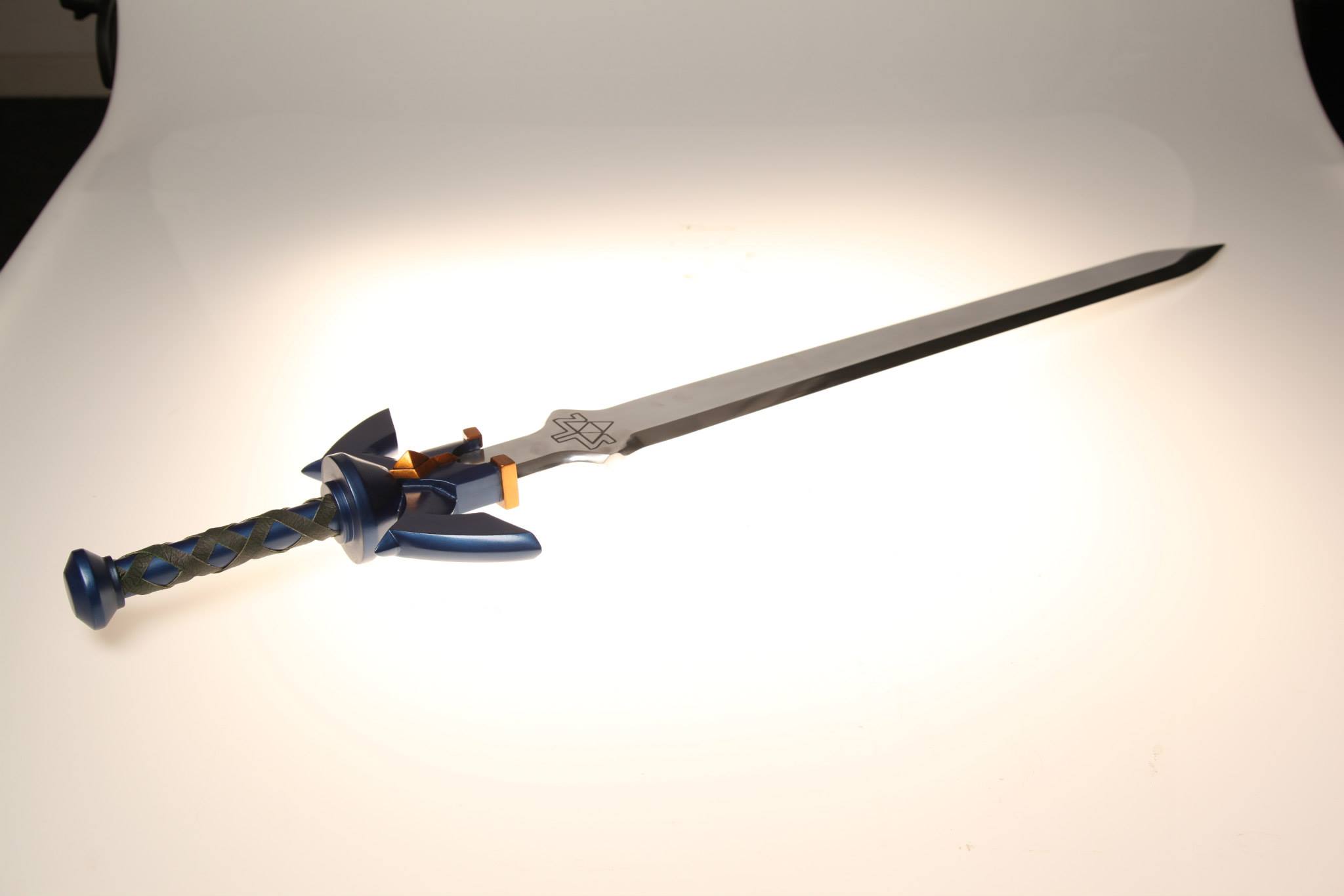

Hi there guys, long time lurker, first time poster.
Last year for my final year of university, one of my main projects I created was the Master Sword from the Legend of Zelda game series. The Sword is composed of a full aluminum blade shaped my milling machine and hand (for the tip and the curved sections). The Triforce symbol on the rain guard section of the blade was etched using Saline Sulphate. The grip is composed itself of Aluminum tubing, with the rest of the cross guard and pommel being a mix of chemi wood and polyurethane resin. Finally the grip was wrapped in faux leather. It is roughly 1m/39" long.

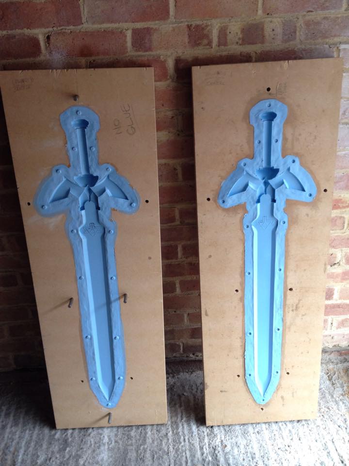

And recently I finally got around to moulding the beast (I personally love the mould)

It is some of the old Citadel/Games Workshop metallic paints, with some cheap gold rub and buff on top.

Looks amazing! The mould caught my eye as well, is the jacket all wood? I have been looking into a larger mould jacket for a dagger I am working on and would love to see more of your process or just the mould itself. Also, I am curious how successful the pours are, as getting a good pour in a long thin blade can be quite tricky. Love the work.

the finish on the aluminium is impressive, getting such a shine is hard work (or I'm just doing it wrong). Shows a great variety of techniques, hope it got you a good grade :thumbsup

I recently started cast swords again from my original mould and wasn't happy with the quality produced. So this last week I have remoulded the original master and now brilliant casts come out that require minimal clean up...
Below is a picture of the new mould and the first swords to be cast out of it. They are cold cast polyurethane resin with carbon fibre armature for strength (and straightness)

If you go on facebook, search 'Mould Makers Guild' and click on the photos > albums > Prop Mould Process. You should be able to see it because it is public access
With the Carbon Fibre, you pour both sides whilst the mould is still open below where the seem line would be, so that the armature will be locked in place, then put the mould together, clamp it up and pour the amount neccessary to join the pieces :) On the next time I cast one I will take pictures to help explain
