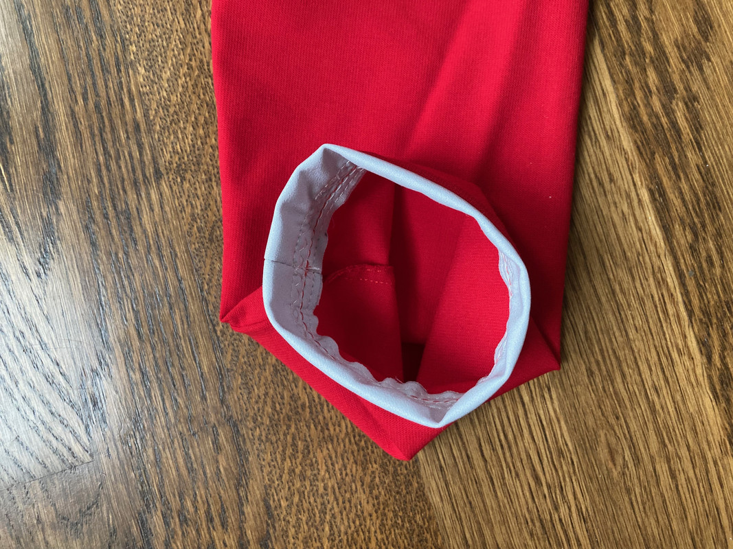

After getting the arms closed up and the shirt given a more tailored fit, I added the decorative grey cuffs.
Let’s address the grey trim. Clearly, there was more than one shirt. In the pilot episode, the grey trim seems lighter than the belt and the collar is also grey. The difference in color is probably due more to the varying reflective nature of the fabrics in camera under bright lighting vs. the color seen by the eye. Greys will appear white while whites will completely wash out and overexpose. In episode 2, the grey collar is present in some scenes and absent in others, eventually disappearing entirely. At some future point, the grey trim gets darker, more closely matched to the belt. So we have options.
As there is no right or wrong here, I’m opting for the lighter trim as it is what this old man remembers from the promotional shots and earliest episodes. I’m also eliminating the grey for a red collar, probably for the same reason the production did so. The grey collar stands out against the red & black cape and just doesn’t look right.
I wanted to use a fabric similar to the shirt but in light grey. Unfortunately, nothing like that was in stock so I opted for some athleisure fabric that had the contrast I was looking for.
The cuff is simply the fabric folded in half, stitched together and then attached to the inside end of the sleeve. Tutorial videos were again helpful here and I created cuffs that extended about 1/2”. I will add the lower waist trim after the pants are finished and I determine the final length of the shirt.
Mistakes Made: The althleisure fabric doesn’t have much stretch after it is doubled. It does fit over the wrist but I would have preferred something with a bit more stretch that could have resulted in a slightly tighter fit.

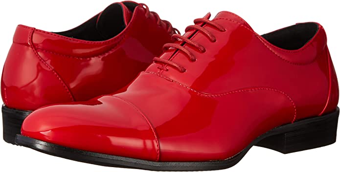

But which shoes? The production seems to have used several different pairs. They may have been painted, or at the very least treated with a matte coating to dull the shine. But I’d rather get something off the shelf so I am eliminating those possibilities as options.
You might be surprised to learn that there are shockingly few bright red oxfords available for purchase. There are exactly two options on the big internet warehouse I use… glossy patent leather and suede. Both could fill the role, and while I’m partial to the suede because it has no shine and might match the fabric better, my wife tells me that she would have zero complaints if I were to wear the glossy red ones out for an evening dinner some time. So this decision is an easy one. Click-click. Thanks to the magic of the internet, they arrive within 2 days.
I have two things to say about these shoes. First, damn!!! Second, they are surprisingly comfortable and seem true-to-size. Good choice.
Mistakes Made: Not buying these shoes sooner.

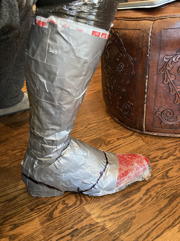

The moment I have been dreading has arrived and I really have no idea what to do. I thought the spats might be “faux” and the piping simply sewed onto the legs of the costume. I say this because of the promotional photo of Ralph holding the suit... the spats just hang there looking well connected. While I had some ideas on how I might do that, it seemed way beyond my abilities at this point. Looking closer at the reference photos, maybe the little hidden zippers on the inside leg do something. No idea what that might be, but something.
A choice must be made now so... separate spats with no zipper.
To accomplish this, I will utilize the magical mystery product called “duct tape.” No one knows what planet it originated from, but it works for everything.
I’m most of you know this process as duct tape casting. It’s new to me but sounds fun. Let’s do it!

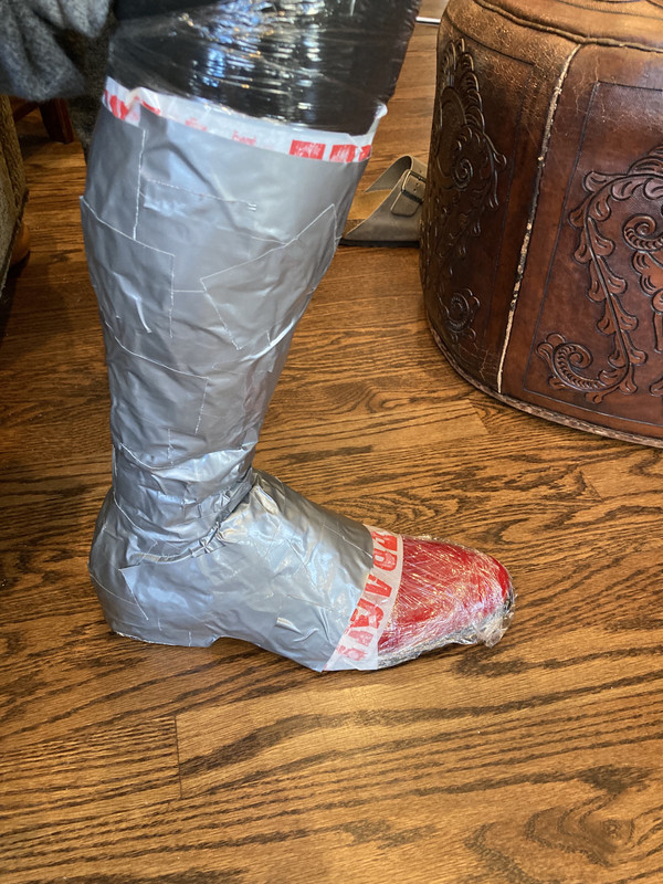

I applied a base layer of Saran Wrap to prevent the duct tape from sticking to important things and reinforced it a bit with packing tape. Using 6” strips of duct tape, I covered my lower leg and shoe top. I couldn’t stand while doing this so I sat down but held my lower leg and ankle similar to that of a standing posture. I took care not to wrap long strips of tape around the leg. I wanted to follow the curvatures and the shorter lengths seem do that better.
When finished, I drew some curved lines around the upper calf and the front/back of the shoes. These will be the edges of the material with the grey piping. I also added straight lines from top-to-bottom on the front, back and sides. These will be the seam lines.
I carefully cut the front seam line with scissors, taking care not to cut the underlying clothing or shoes. After removing the template, I numbered the quadrant pieces counter-clockwise so I will know what order to reassemble. I cut the curved lines and remaining seam lines.
I pressed each template flat on contractor’s paper and traced. After that, I added a 3/8” seam allowance and cut. I almost forget to number the templates on the right side. This is important because I will be using the same templates to create a mirror fabric set for the other foot.
For my first duct tape adventure, not terrible.
Mistakes Made: The seam allowance should have been smaller or perhaps none at all since this is stretch material. The overall fit was good but I would prefer tighter.
