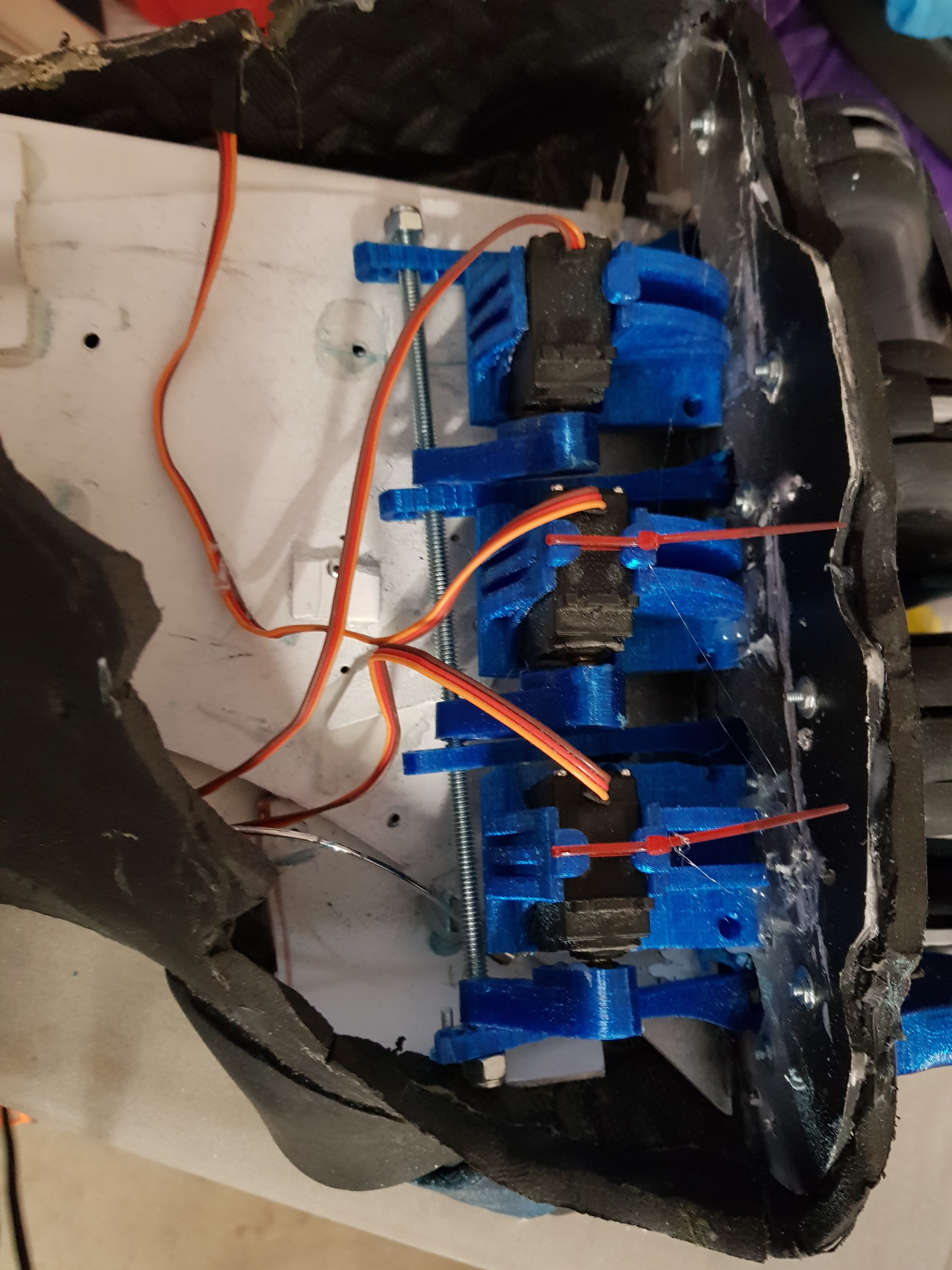

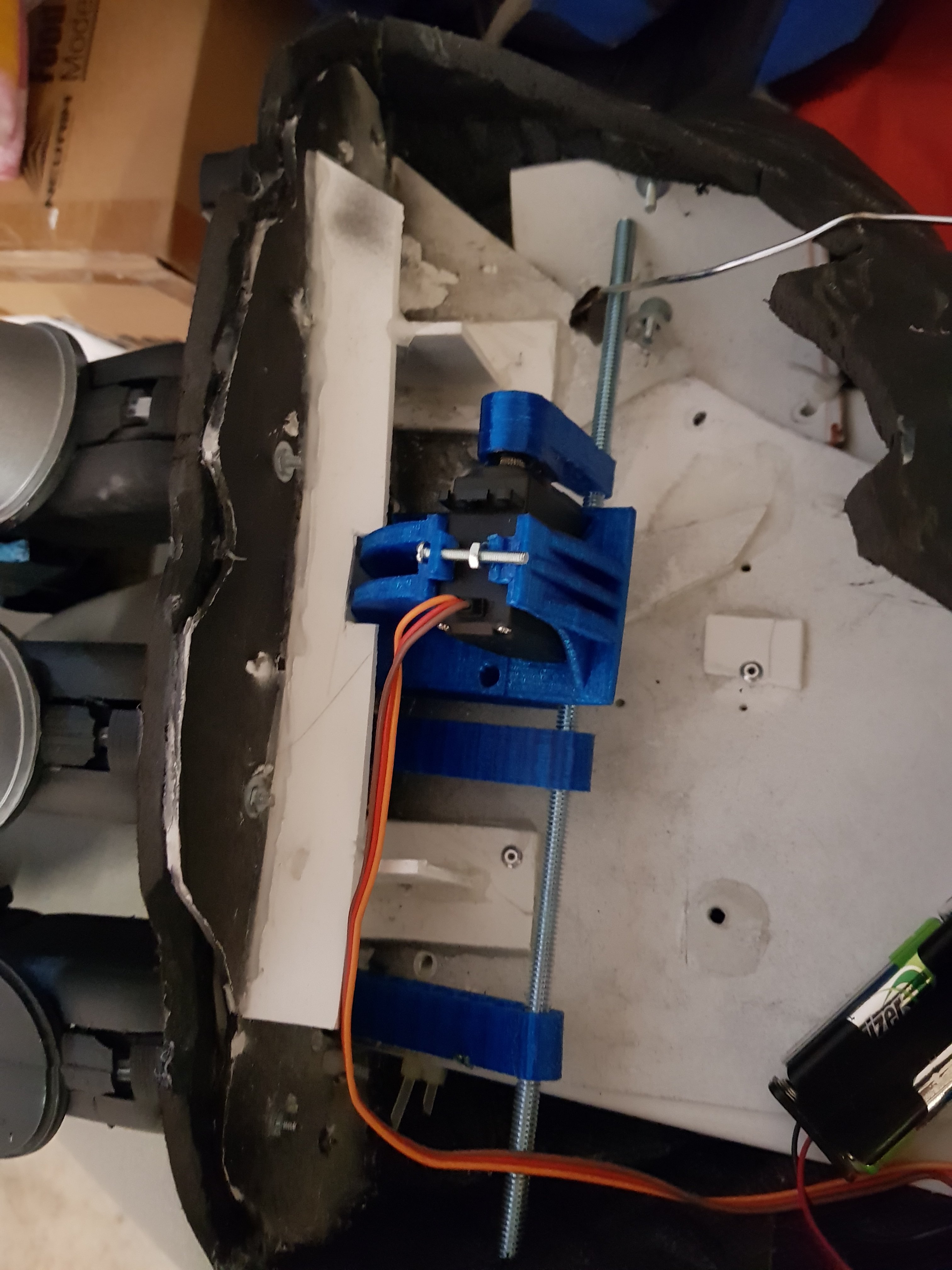

So, that said one hand still has the old system of wooden rods while I attempted to move over to servos in the left hand.

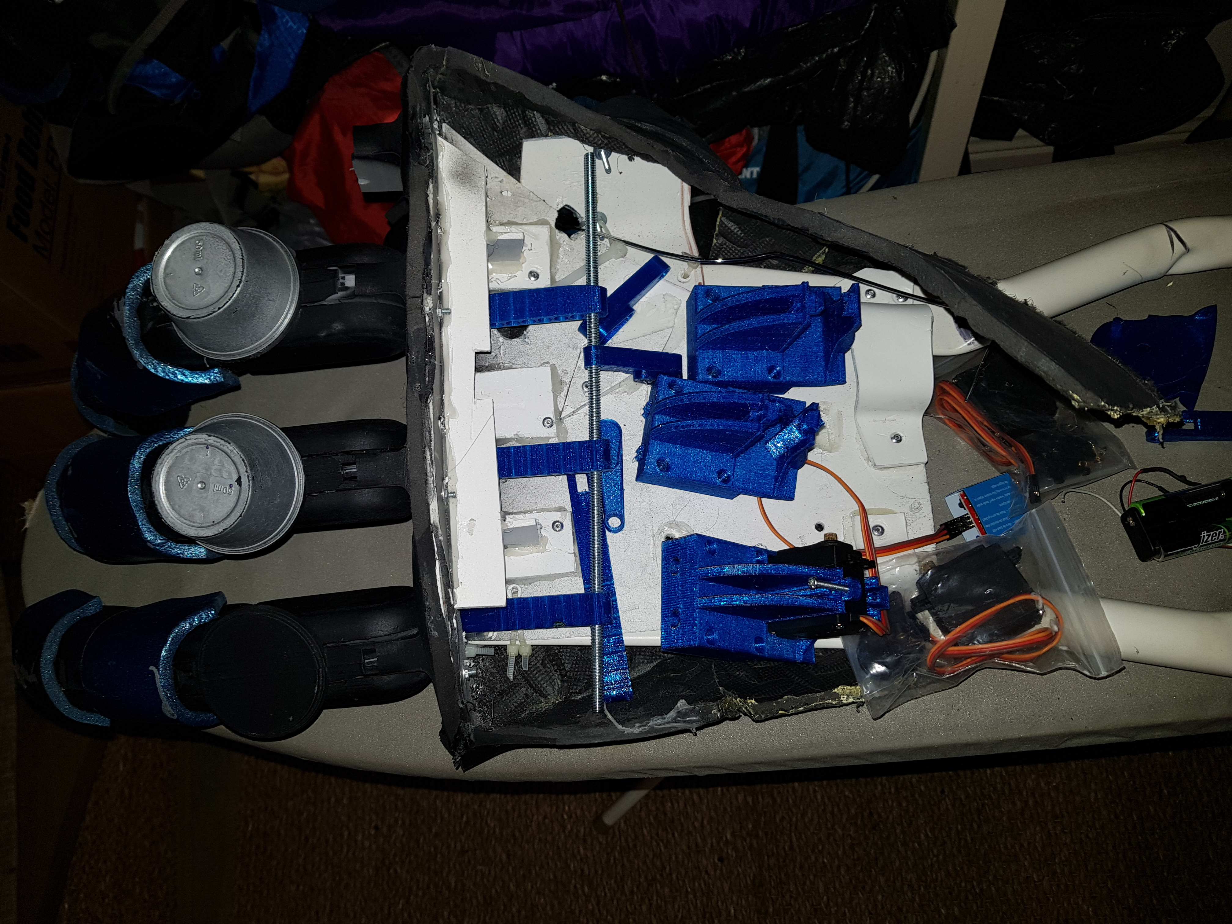

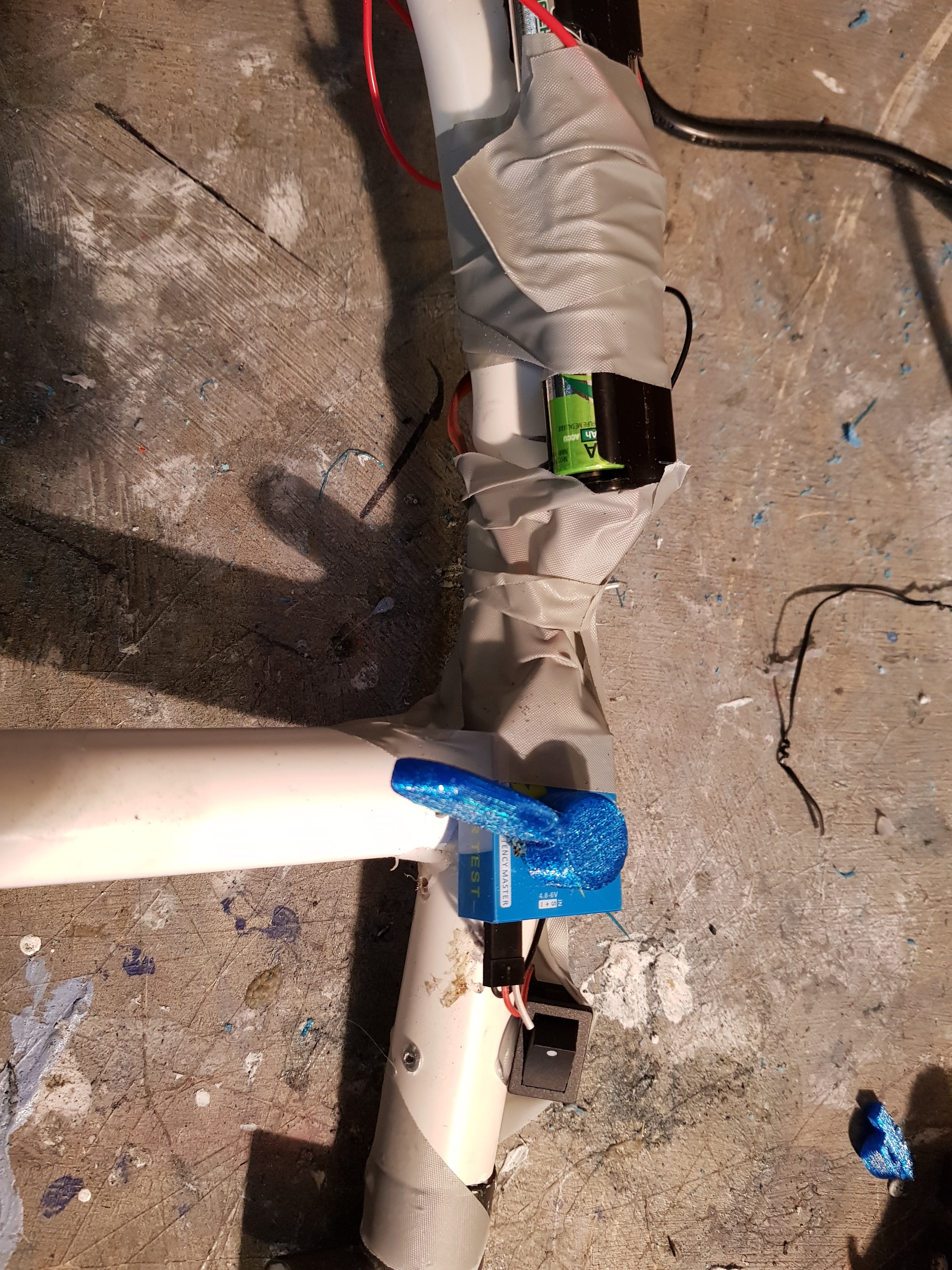

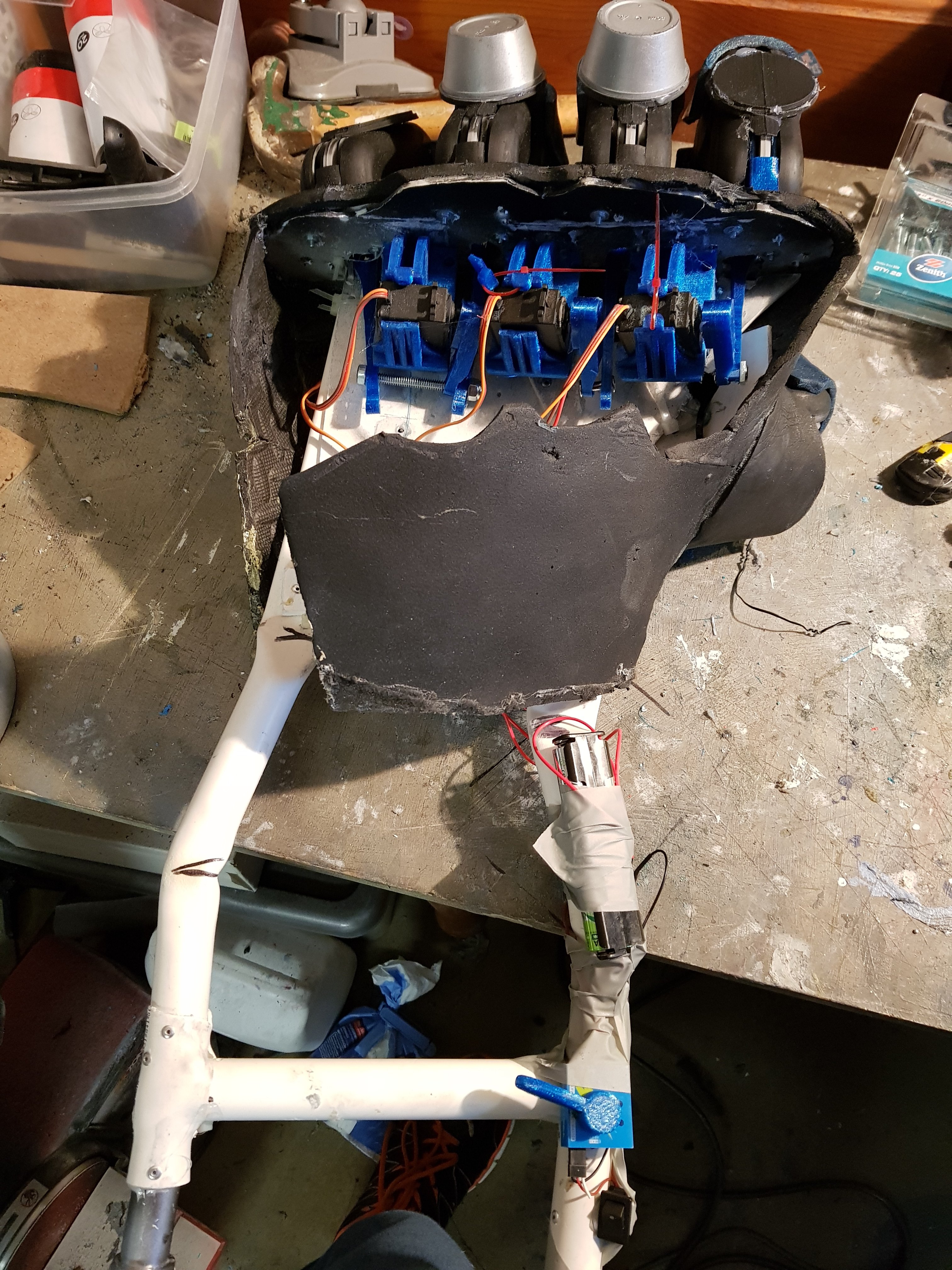

So, i'm trying not to repeat to much from my original thread but here are some shots of me trying to retrofit 3 servos into the hand.
20180514_140254.jpg20180516_103901.jpg20180518_113441.jpg20180518_122613.jpg20180518_122630.jpg
In case it's not clear there is a 3d printed rod that attaches to the finger and then is looped over the threaded rod. 3 strong servos also have an arm connected to the rod and the combined strength of the 3 servos pull the rod back closing the entire hand (i'd given up on indicidually controlling them at this point, i was in a hurry and just wanted closure lol).
So, the servos are only controlled by a servo tester with 3 outputs
Near where my thumb sits in the suit I put a power button, and then i made a sort of bike bell thumb switch that i can easily swivel with my thumb that turns the servo controller nob that in turn turns the servos.
Because this is retro fitted into a handmade scratch built hand nothing even remotely lined up and activating it does nothing but you can feel it almost wants to rips the hand apart from the force. So at this point it was con day and i had to smile and leave it.

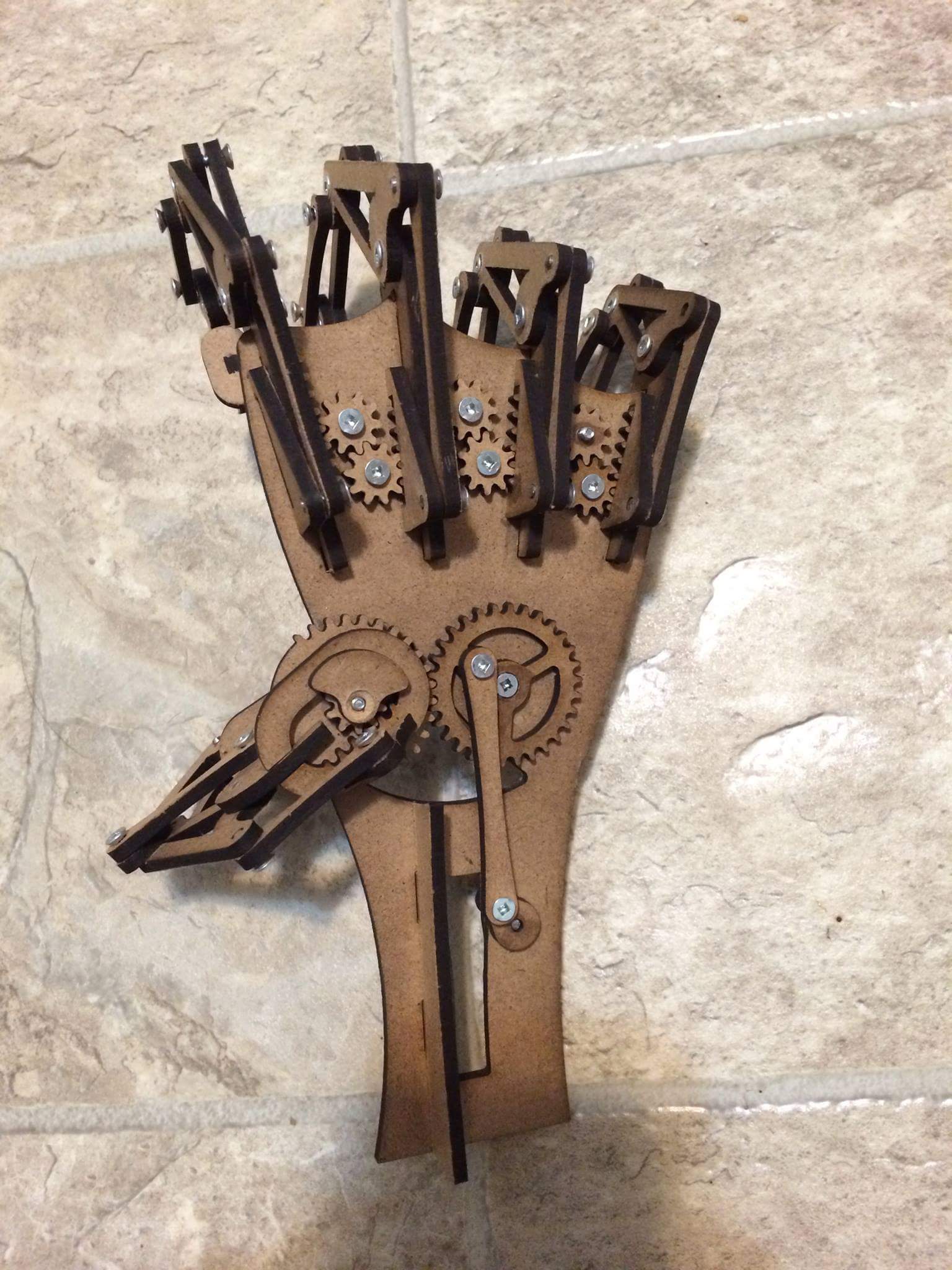

I think, if we could create a rock solid 3D printable module of one mechanical finger (with the middle of the digit being able to be shortened for different finger lengths) that can be controlled either manually or by servo's no matter how far up the arm the user's hand was then i think that's the goal of this thread.
So, if you see a thread here with awesome hand designs, please link, if you come across something beautiful on the net i'd love to see it. Thanks :)

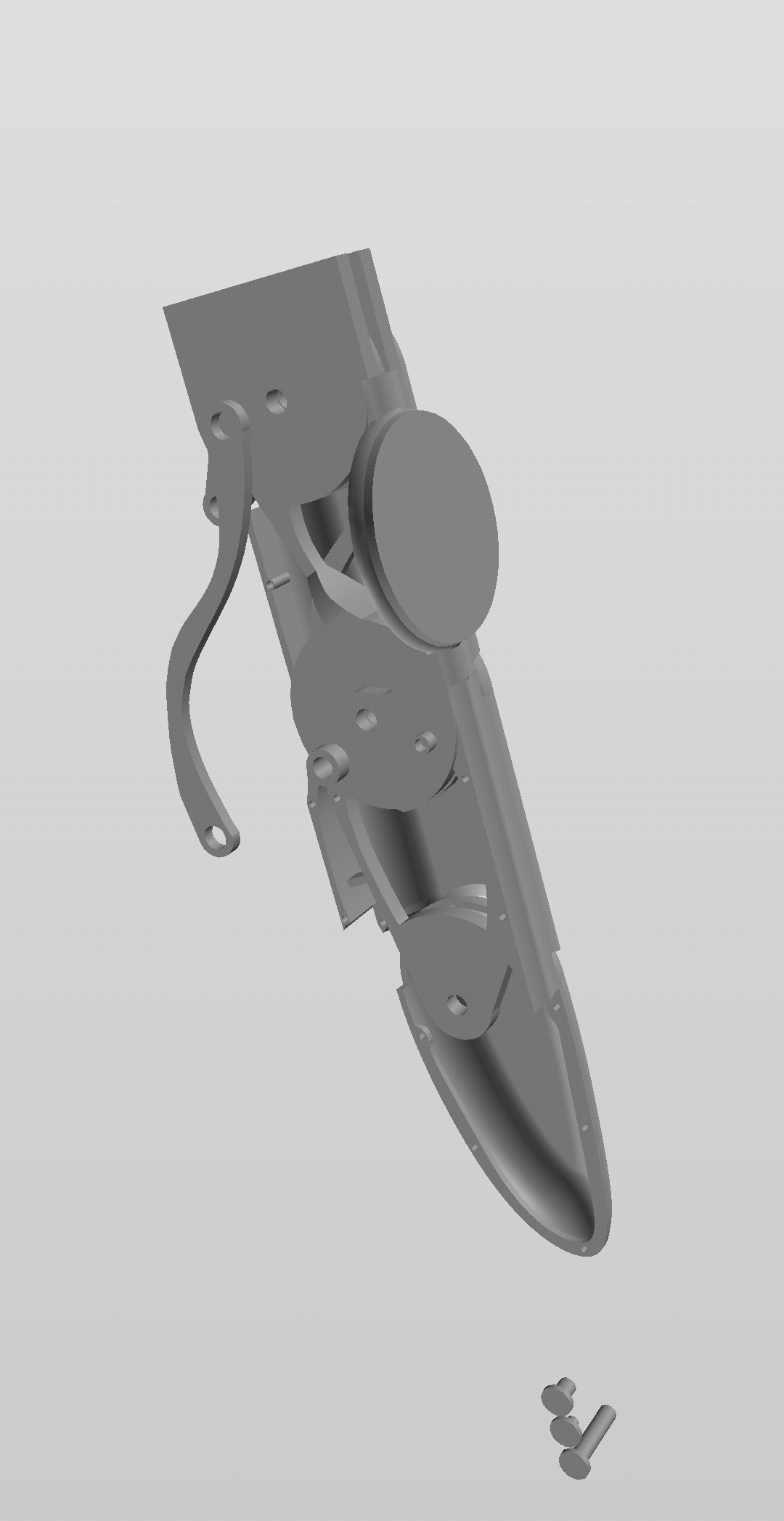

Firstly, here is the link to the file in the video below https://a360.co/2wTt6ro
The file in the video above is the master version of my fingers, I haven't touched it since October 2017 so it's as is, but these are all the individual components that I printed to make the fingers... it's not perfect though, some of the pivot points need to be changed for the middle phalanx.

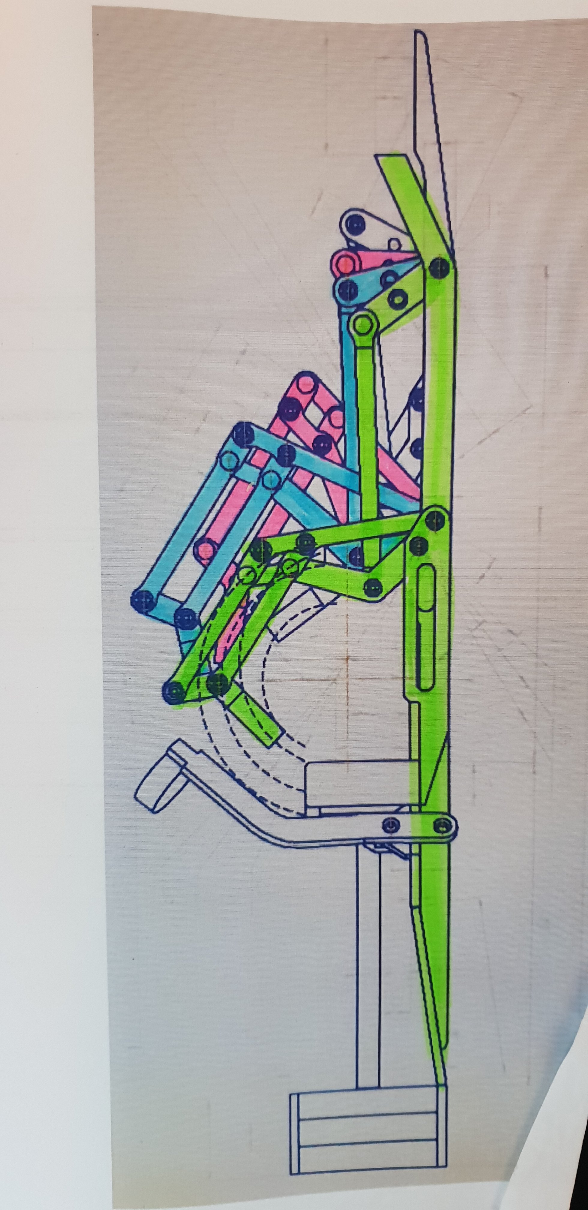

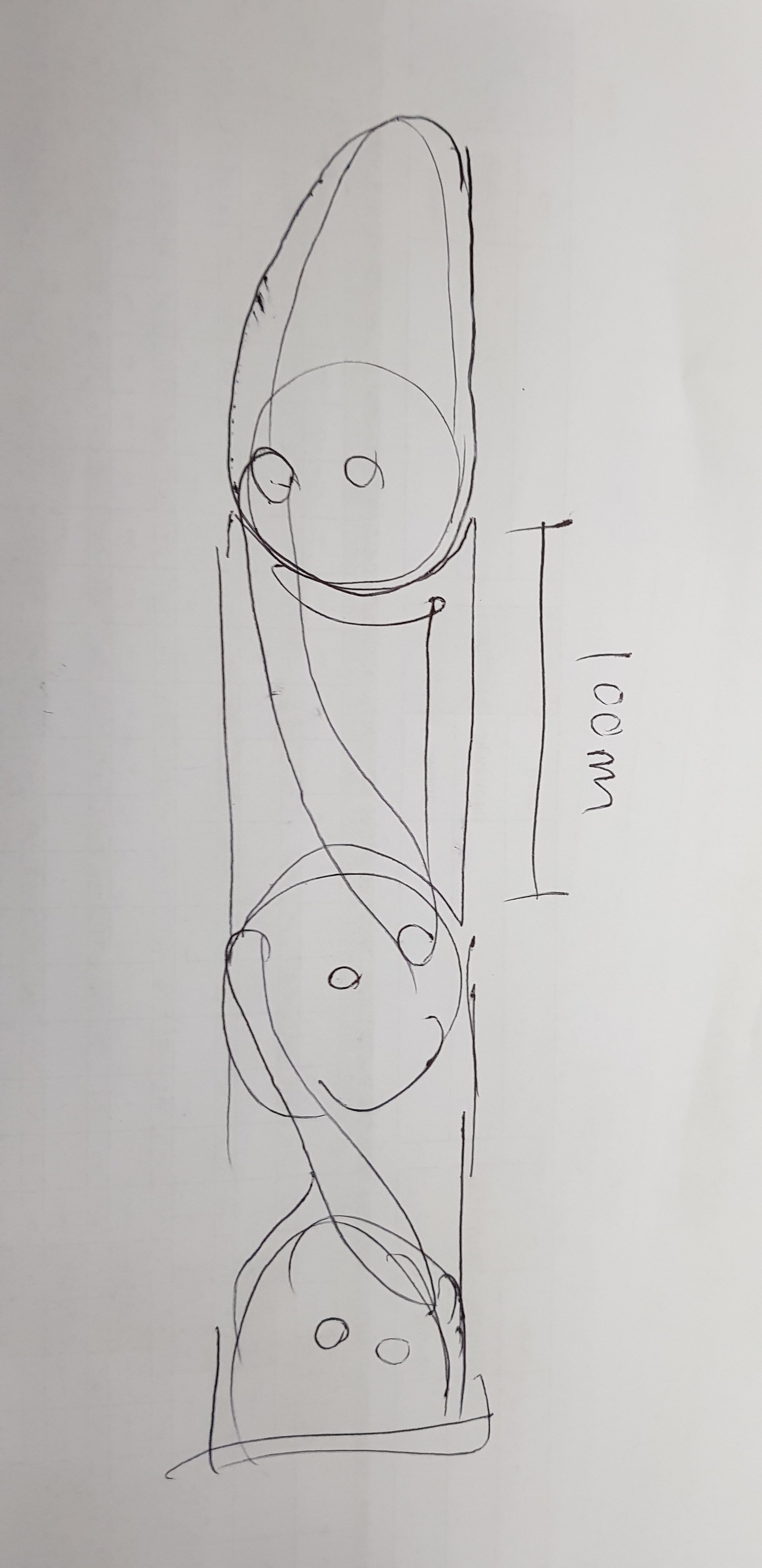

Where the 'tendons' attach for the middle phalanx, points 3 and 4 in red in the image should be more in line vertically with the chicago screws that form the joints.
Technically, the 1 in green would be better over the chicago screw over the knuckle as well however, it seems to still work fine for the first joint it just seems to have trouble for the second movement so that's what i'm working on at the moment.
Thanks to @HulKhokie on instagram for helping me pinpoint the spot causing me issues and taking the time and effort to show me in diagrams the basic mechanics. I've pointed out this thread to him and with any luck he'll add his considerable knowledge on the topic of mechanical hands here, and if not there's still alot you can learn from having a look at all the awesome images on his insta.

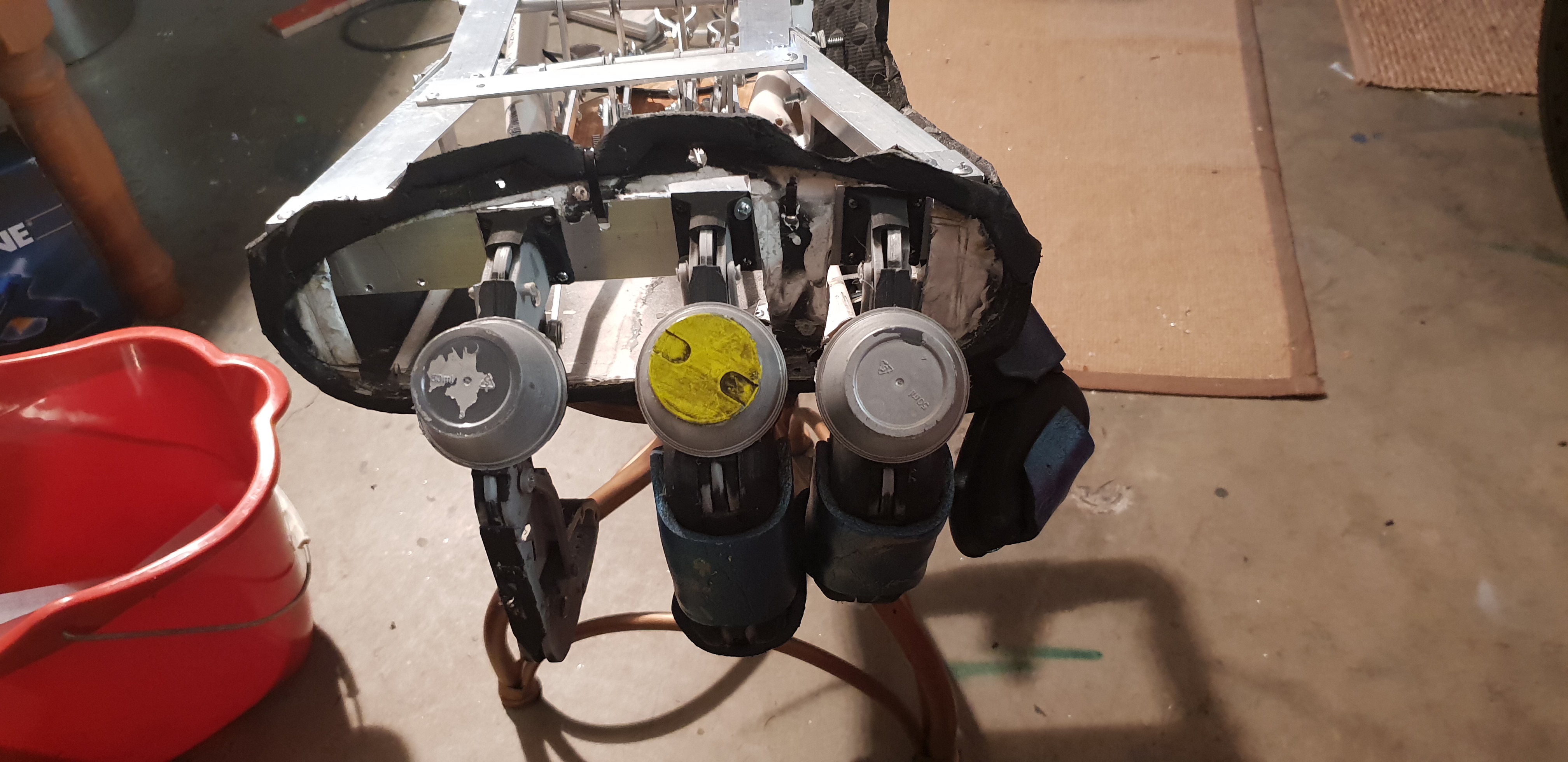

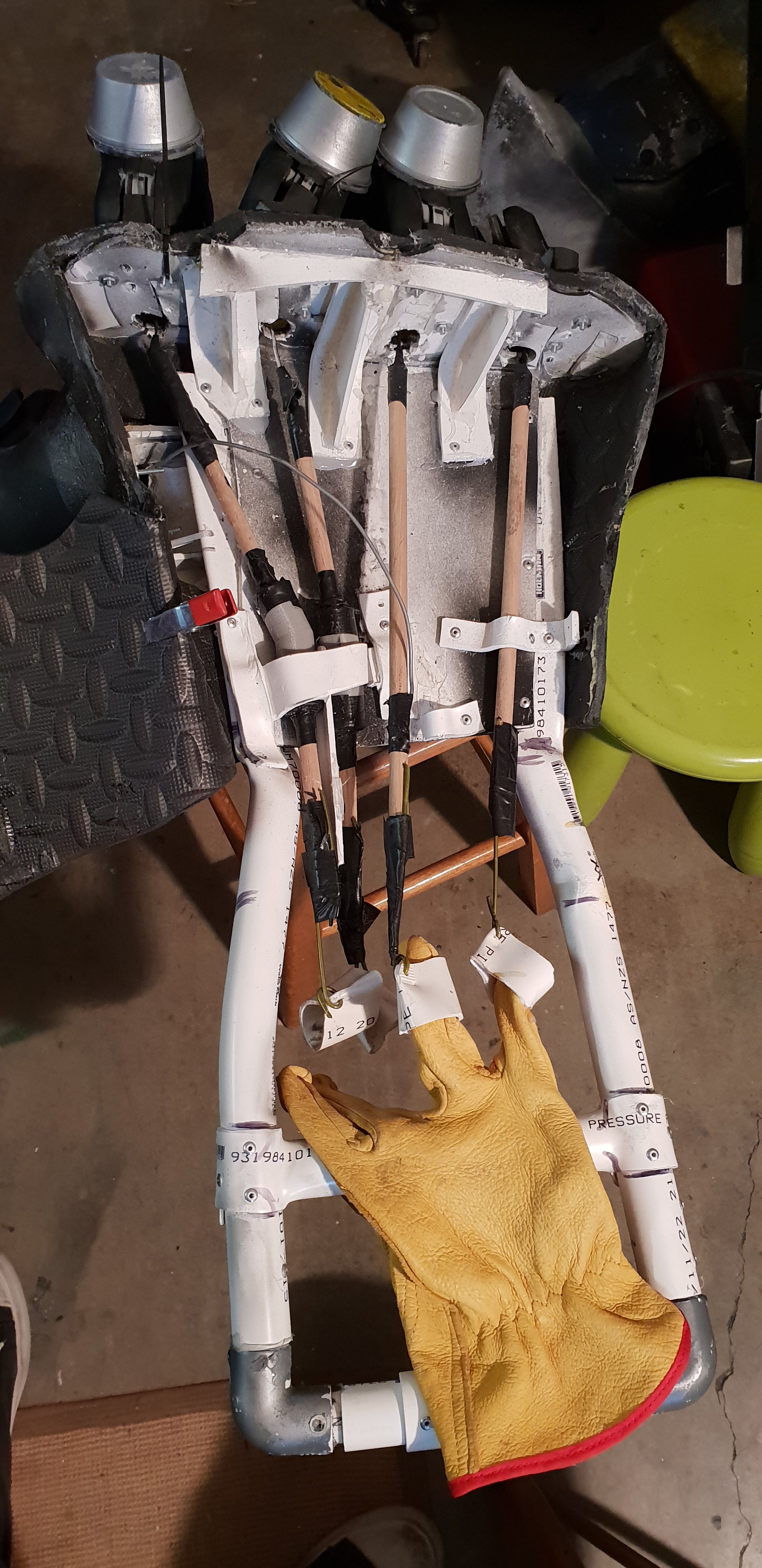

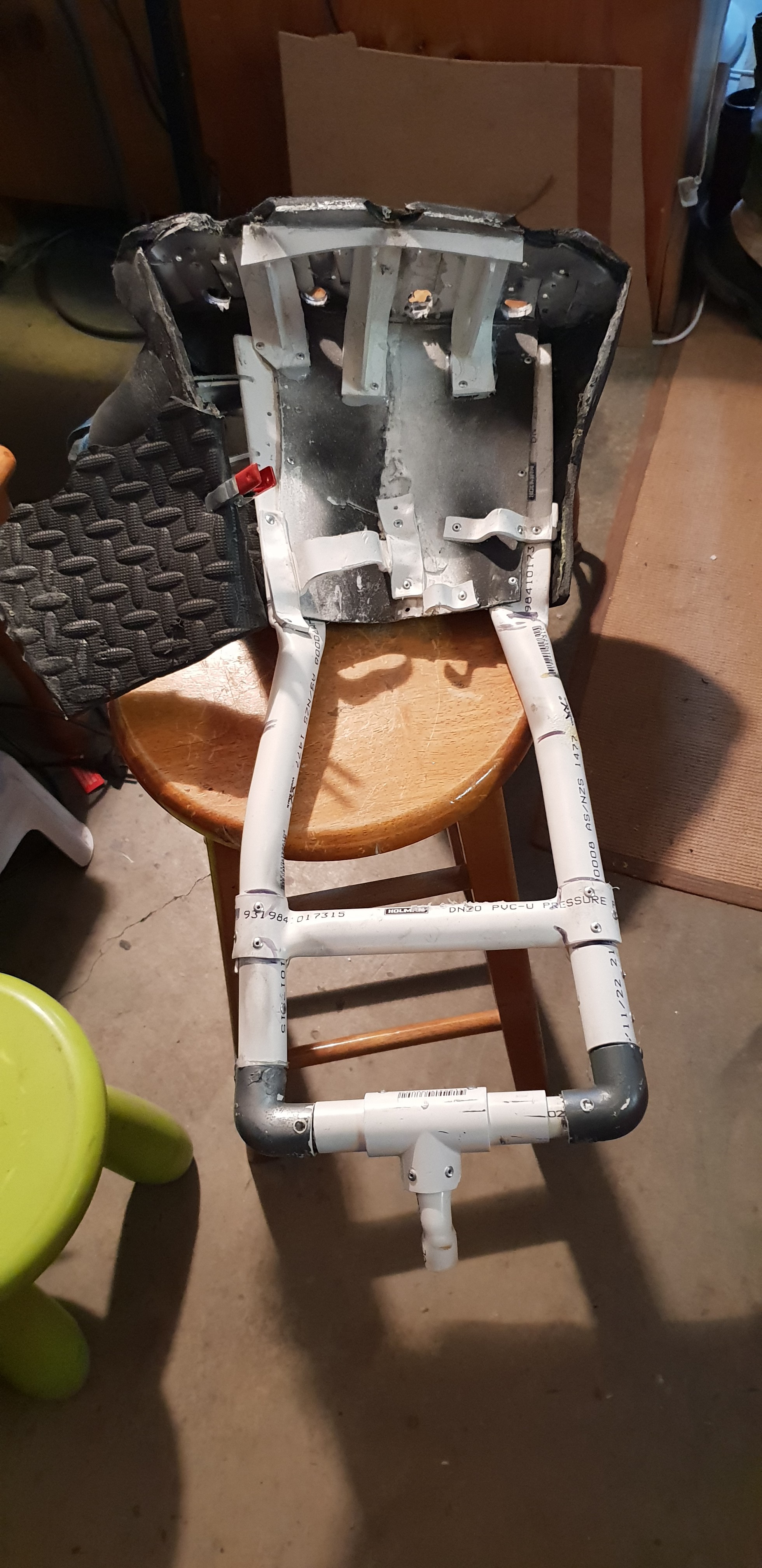

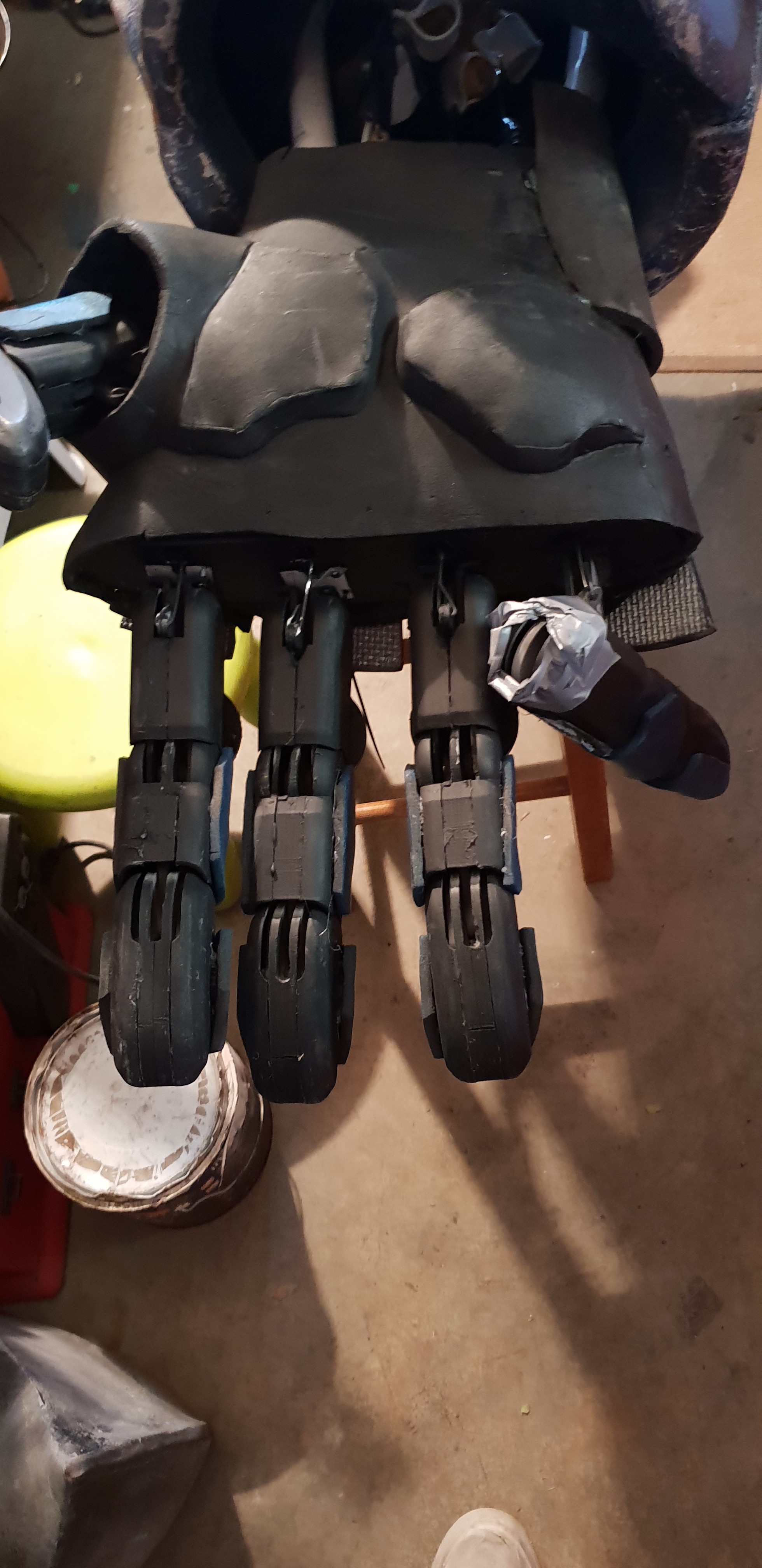

So, here's where the hands were.
The fingers were either broken, or non functional, i had stopped reaching for them and they were held on mostly by tape and cable ties for the last few photo shoots still poseable but not moveable.

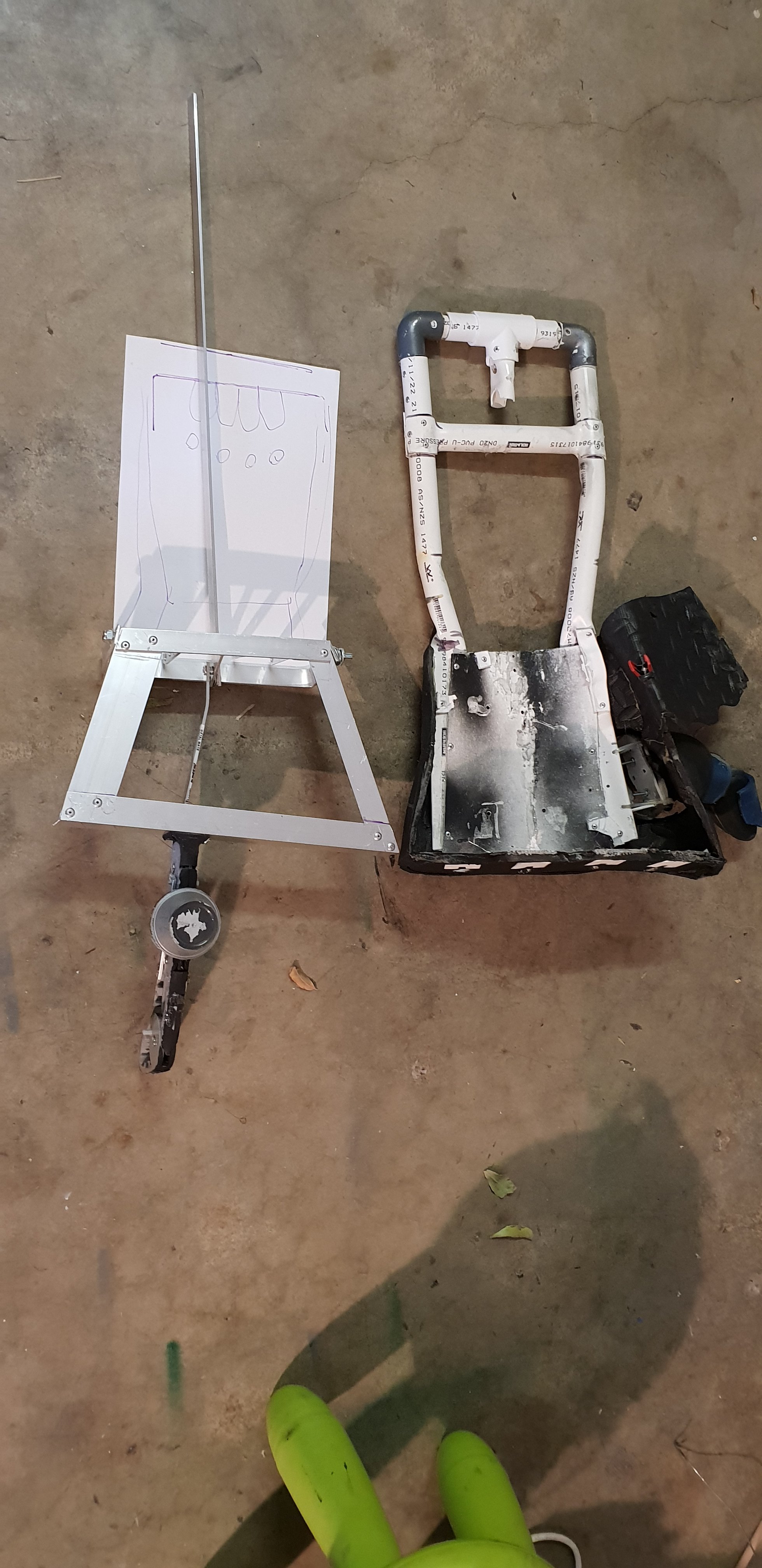

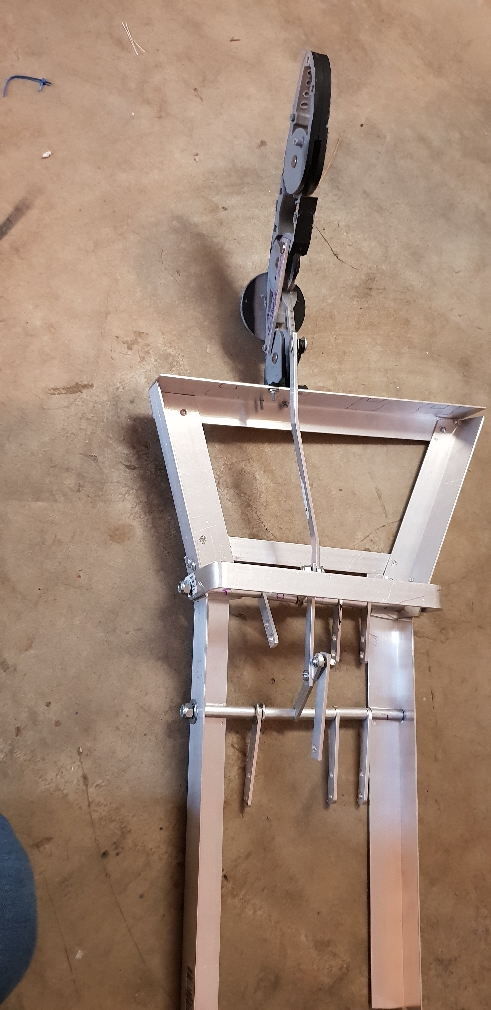

So i ripped them off in tact, stripped out my awful attempt at running struts up the arms and got out the aluminium.
I'd never really thought about this part which may have been a major error, making the fingers is one thing, transferring that 80cm or so up an arm that you only grip just above the elbow is something else.

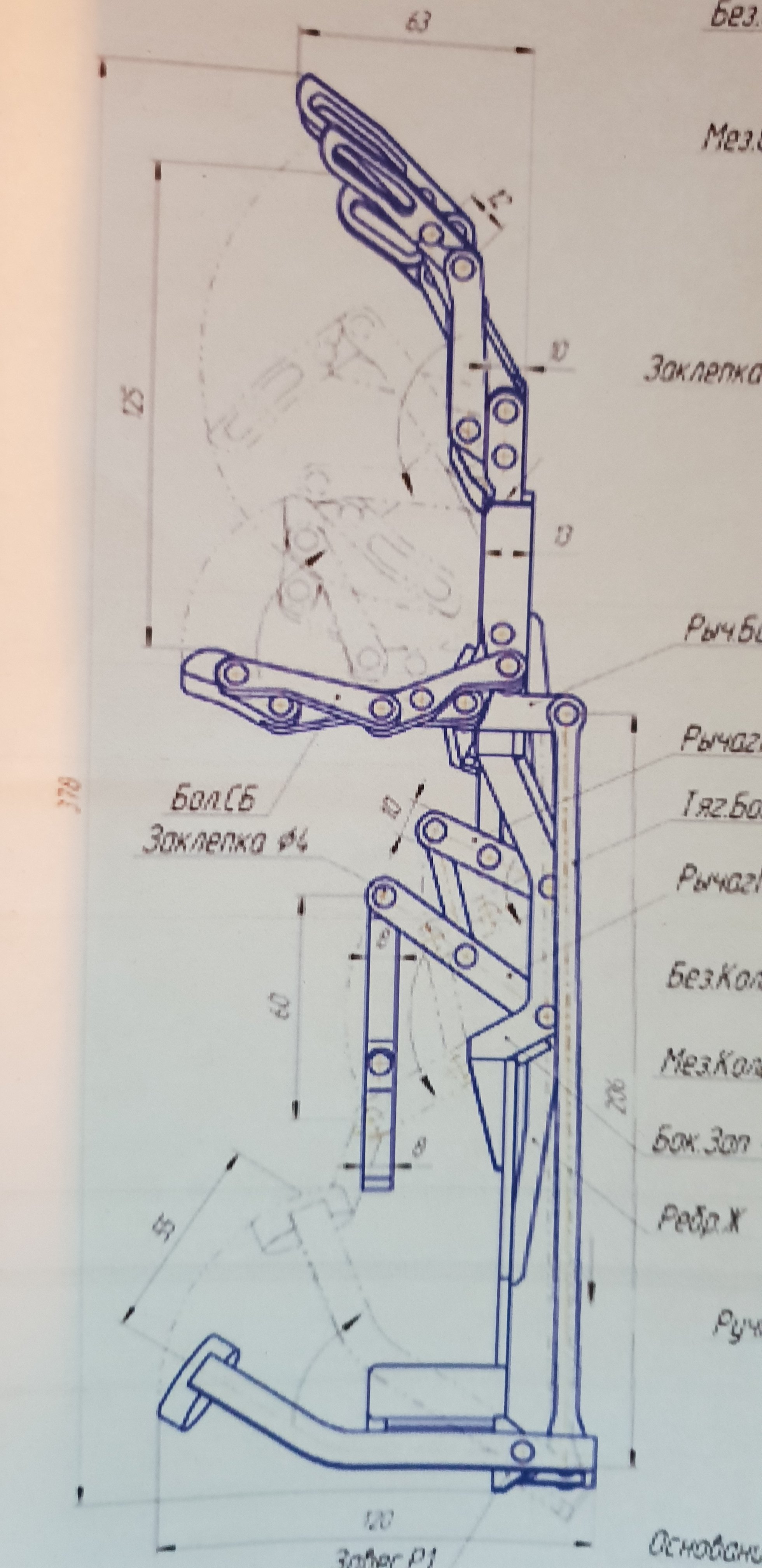

So i took 2 screenshots from the video linked in previous posts to help me think about how I should tackle it.
This is 2 different version of the hand system both very different but both very good. The first one is simpler and i understand the 'why's' of it better than the second one so i'll use that as my inspiration.
One of the reasons, among many, that my hands have never worked properly is that there has been too much lateral movement and in having that it lost alot of the direct transfer of the movement..so they sucked.

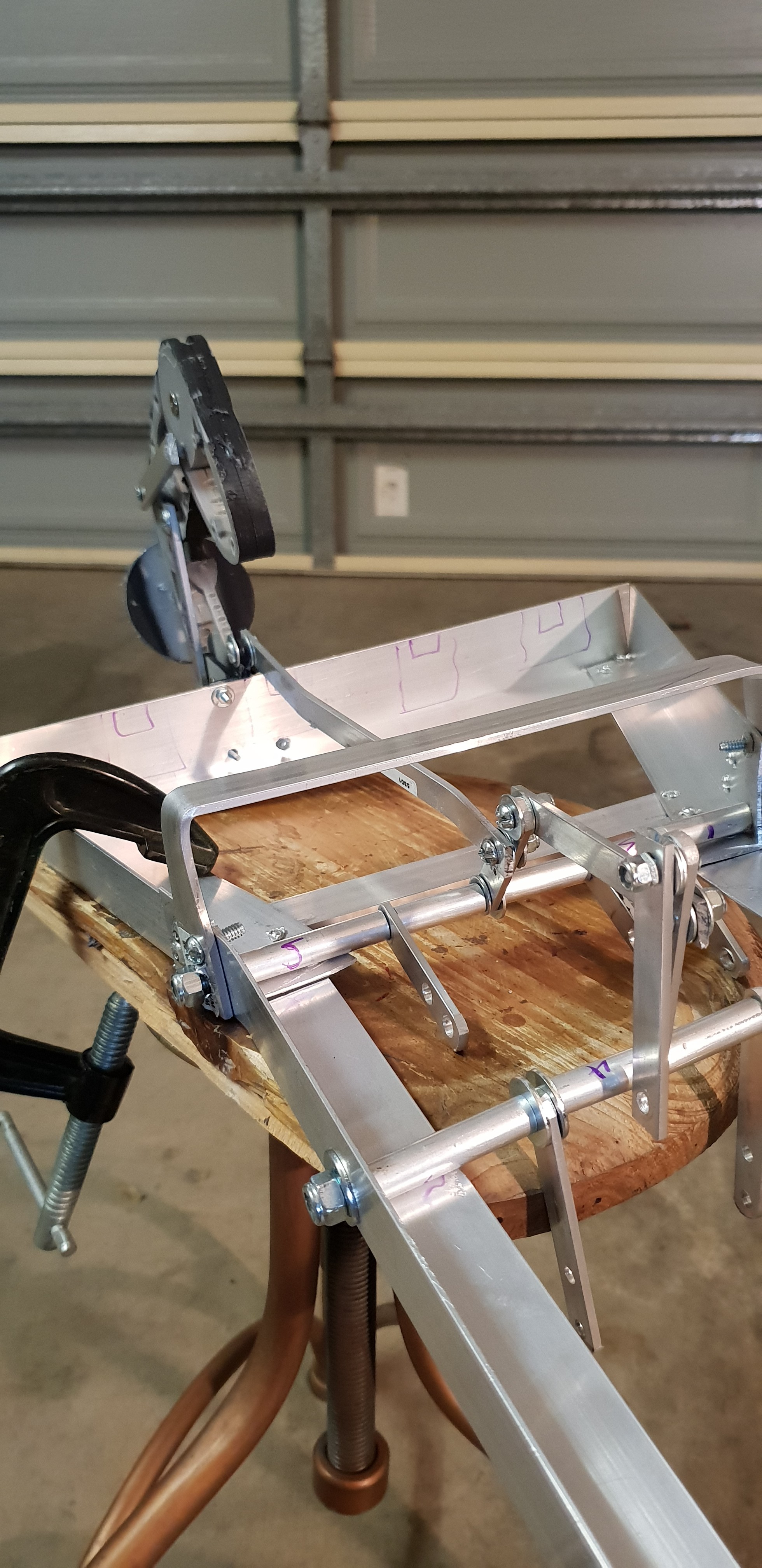

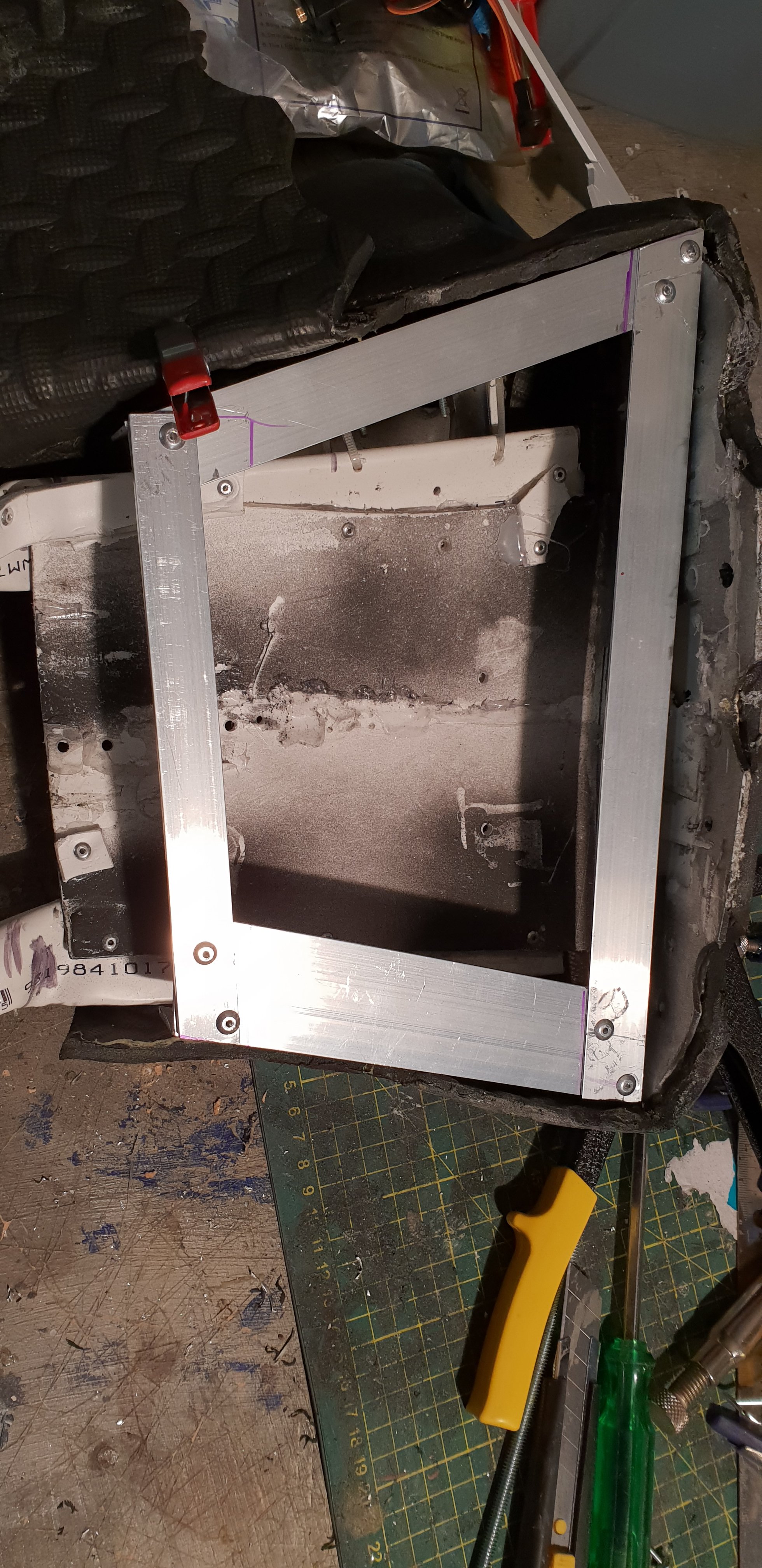

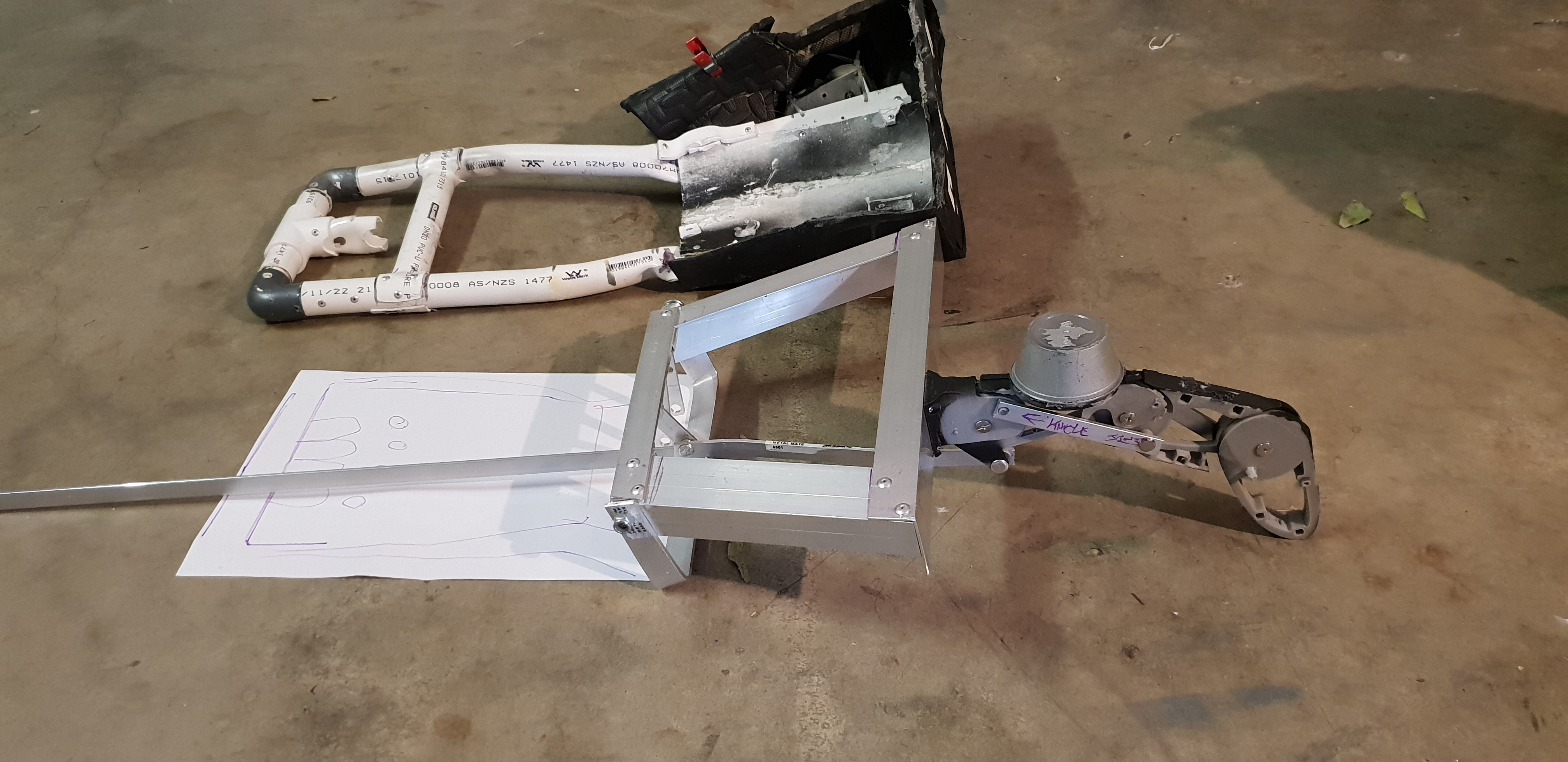

I have no special tools, no CNC machine or anything fancy so i'm just doing this with a normal drill, a hacksaw and a rivet gun from the dollar shop.

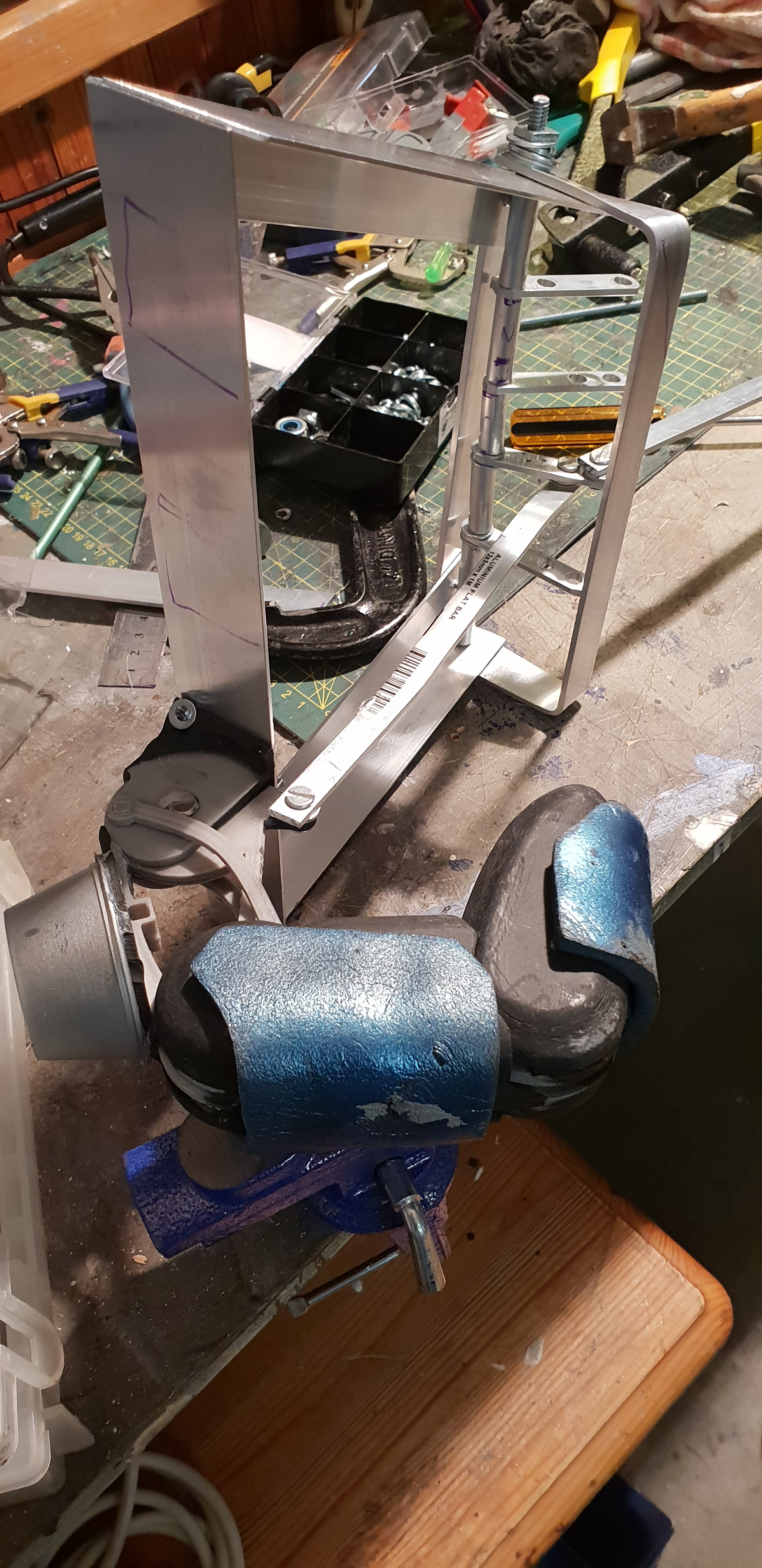

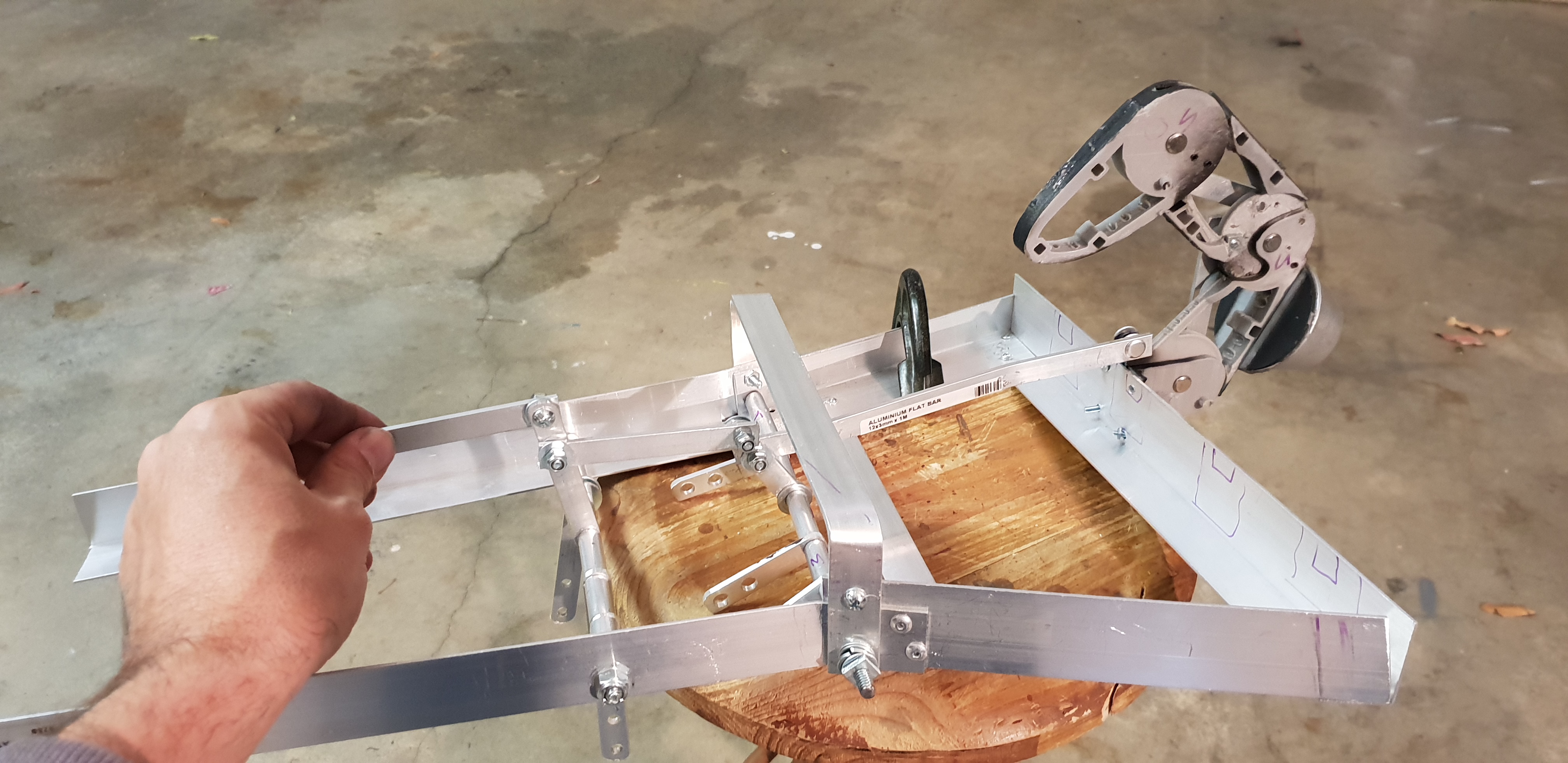

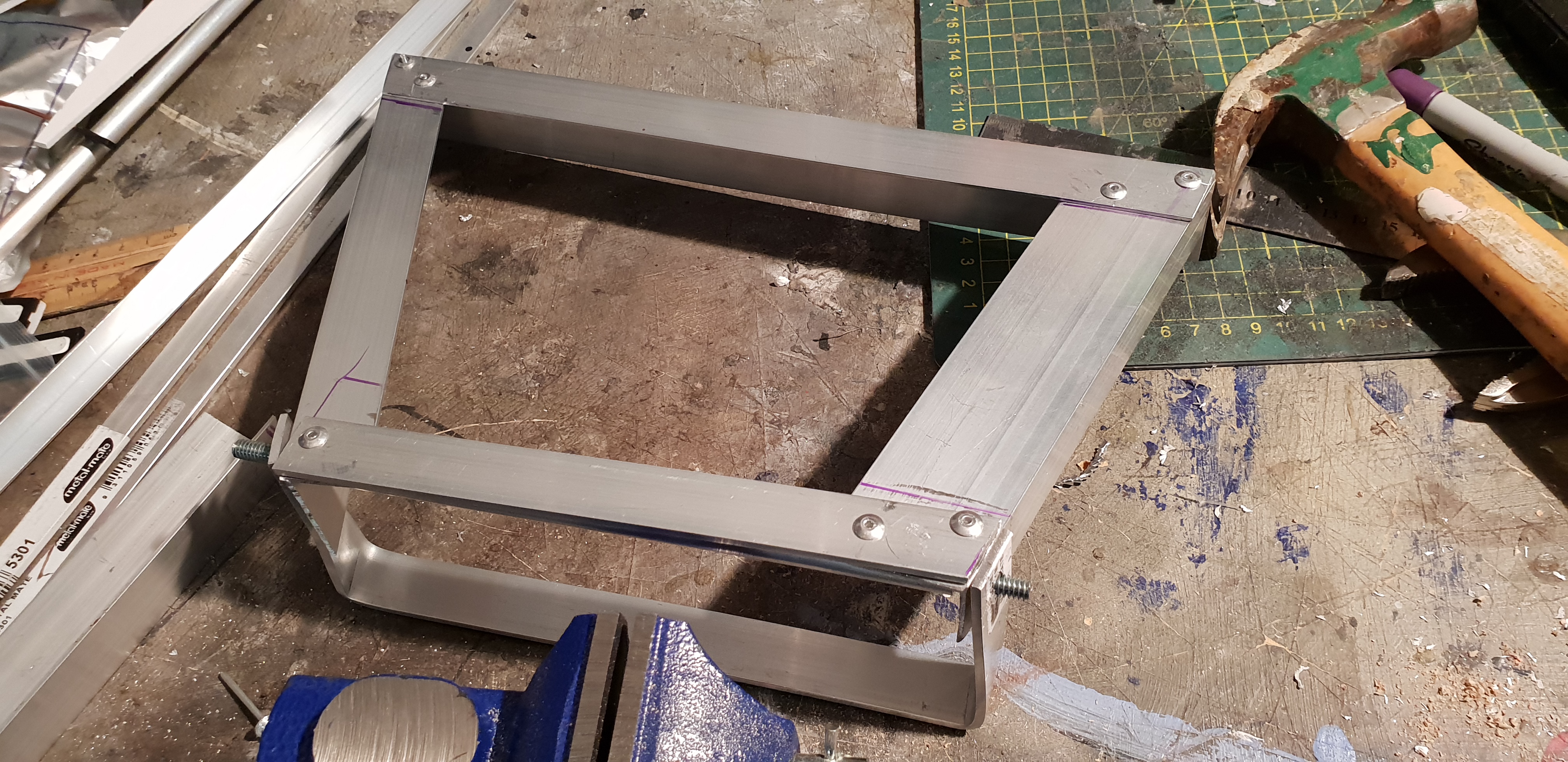

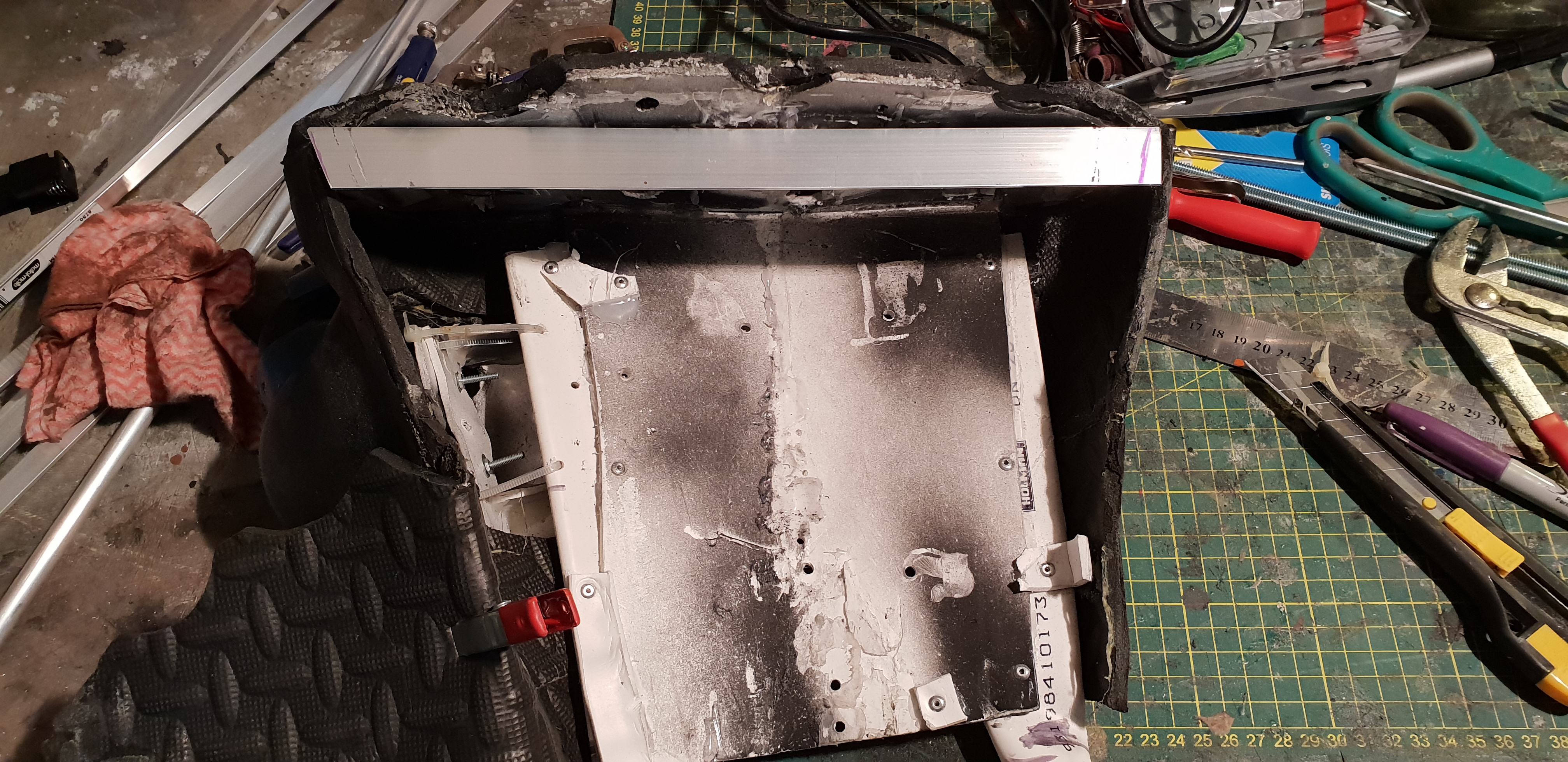

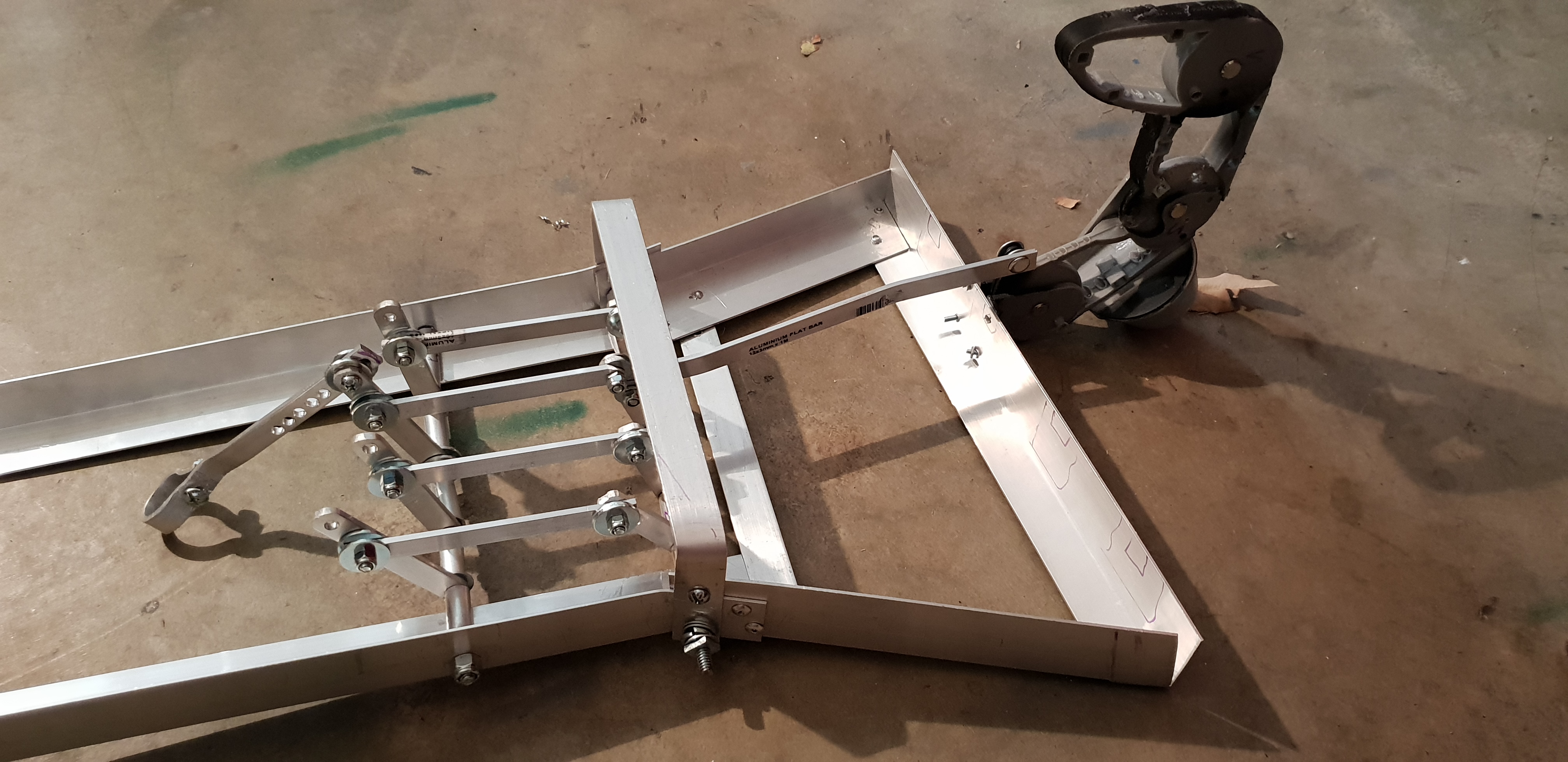

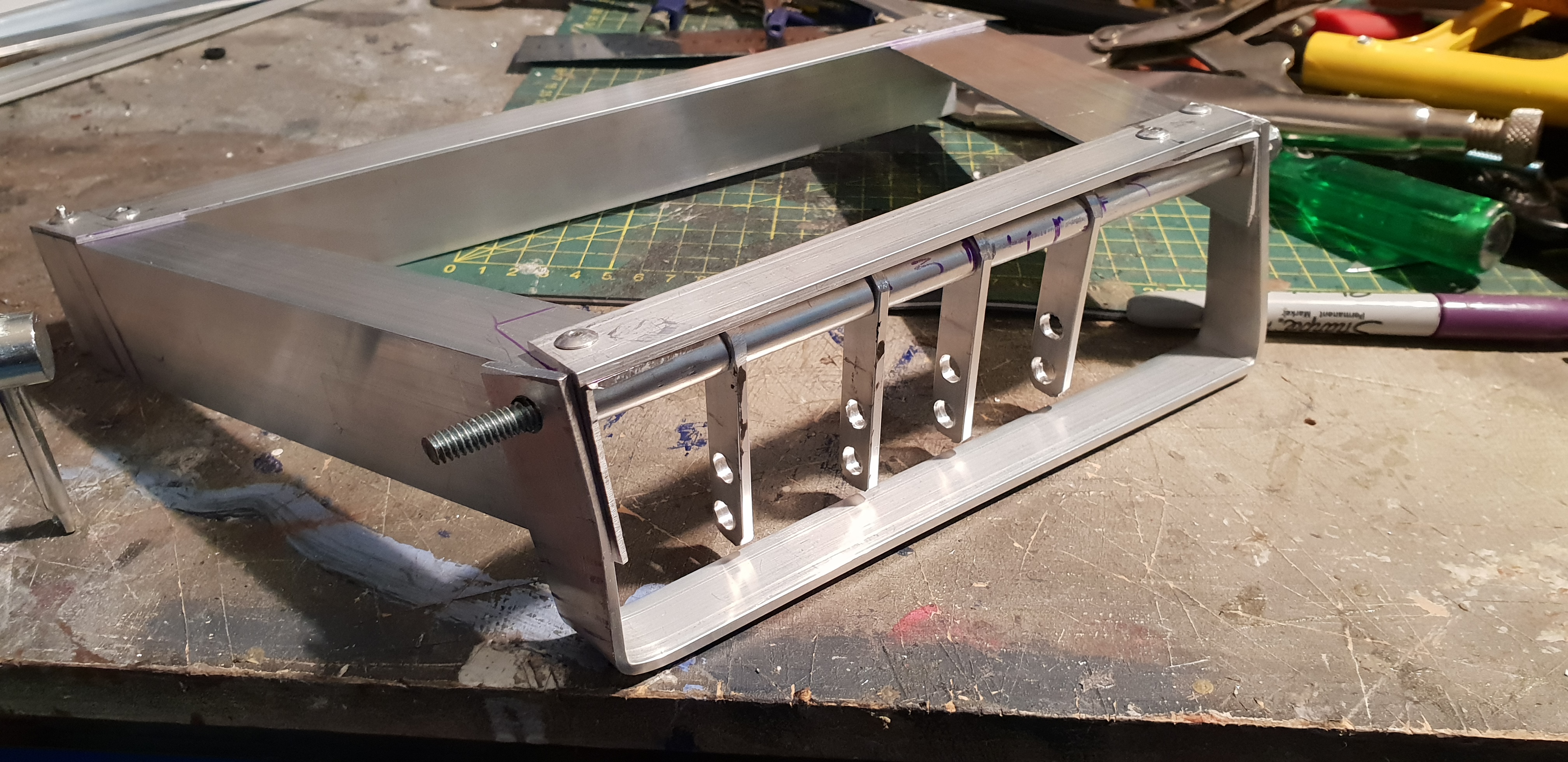

So i made an aluminium frame that will slot into the hand casing.
I put a threaded bar through and bolted it either side then cut some strips and drilled some holes through. I then slid a pipe onto the thread and measured across it and cut it into sections to use as spacers to divide up the linkages. I then took one of the fingers to get right and started to work on this one before moving on to the rest.
This is where I came across the problems with my initial design, I knew they were there I just needed the courage to peel off the cosplay parts and get back to the mechanics.

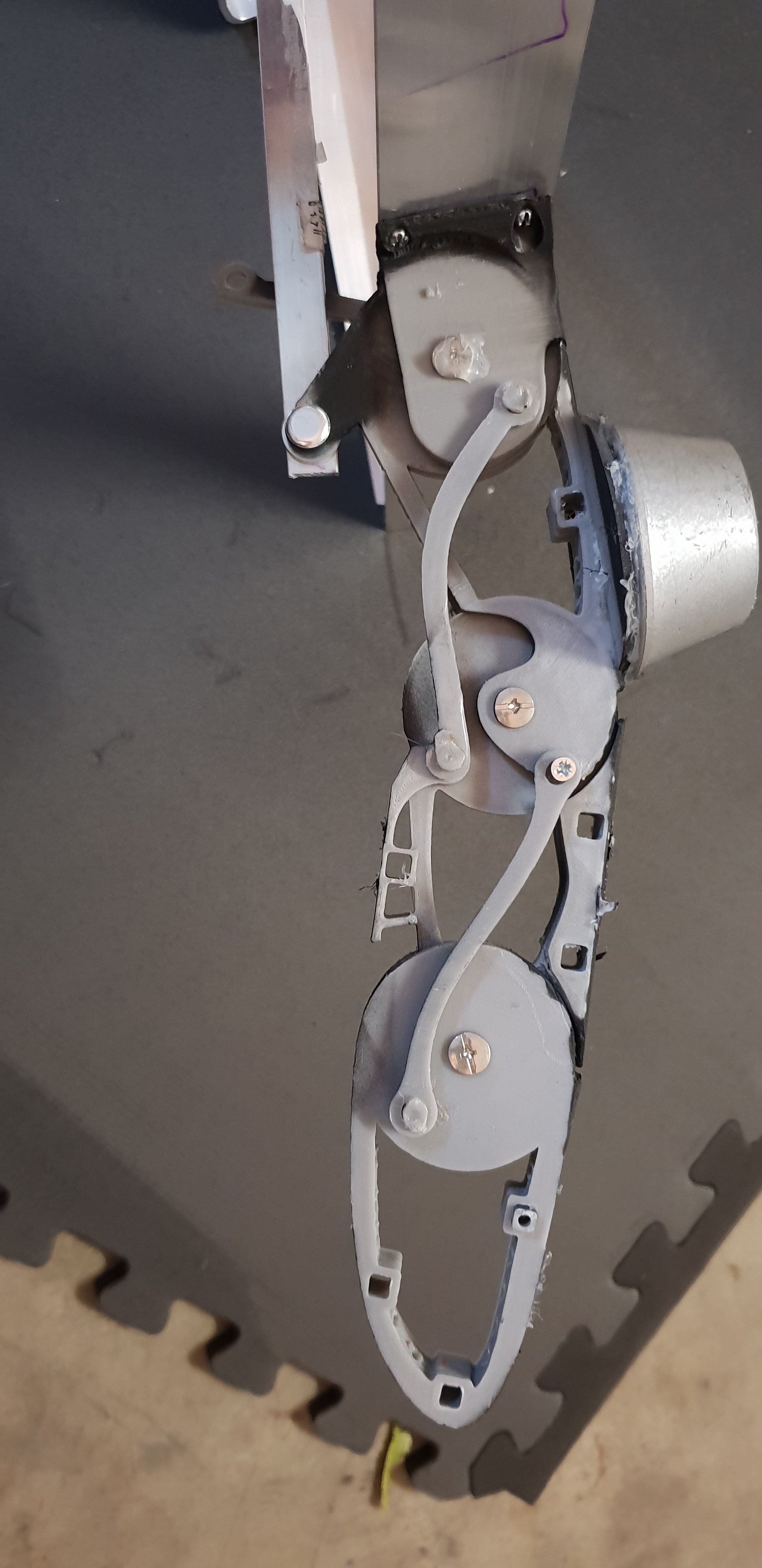

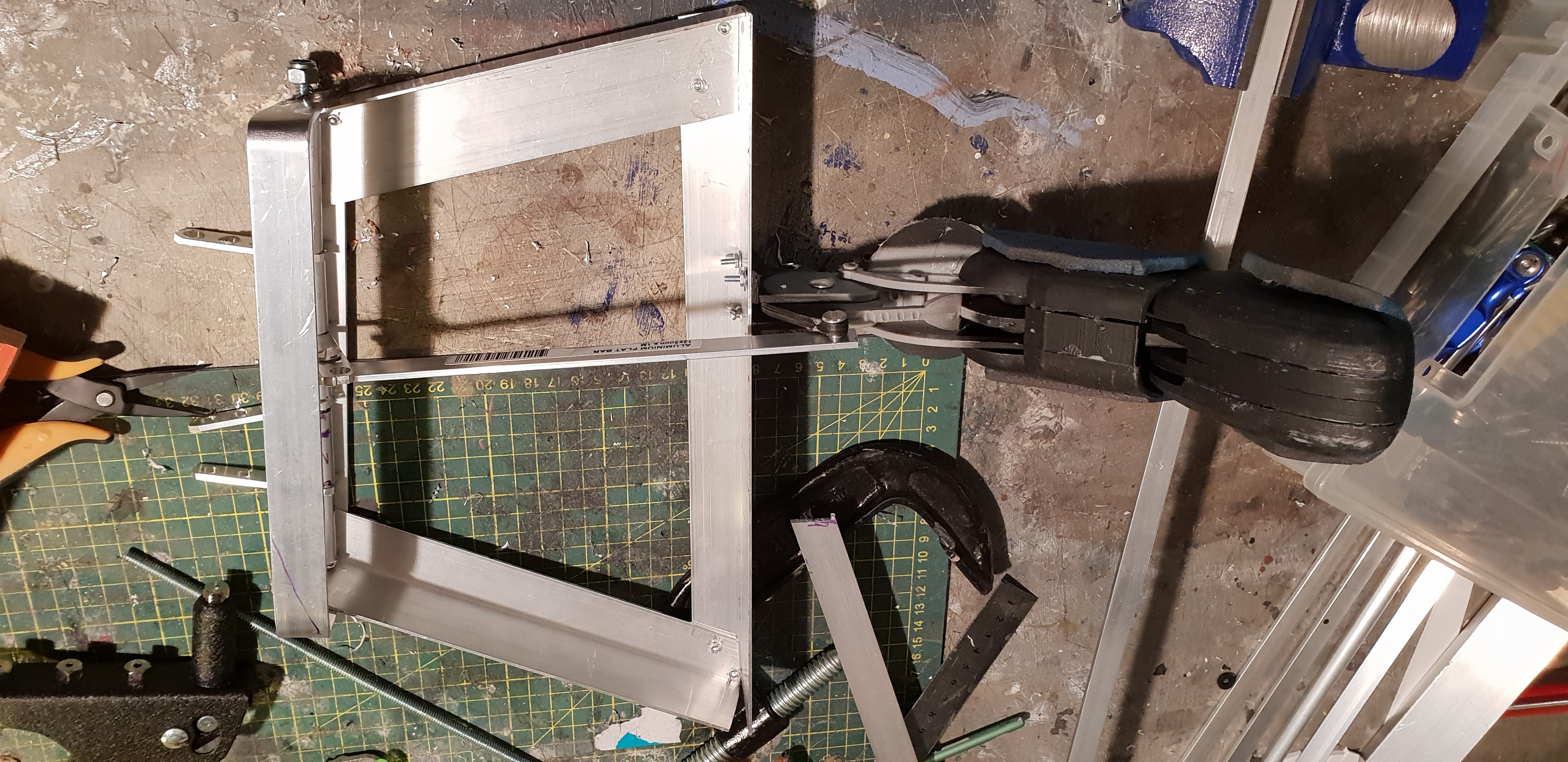

This is the fingers still intact, I took off the tendons and replaced the first one with an aluminium strut.

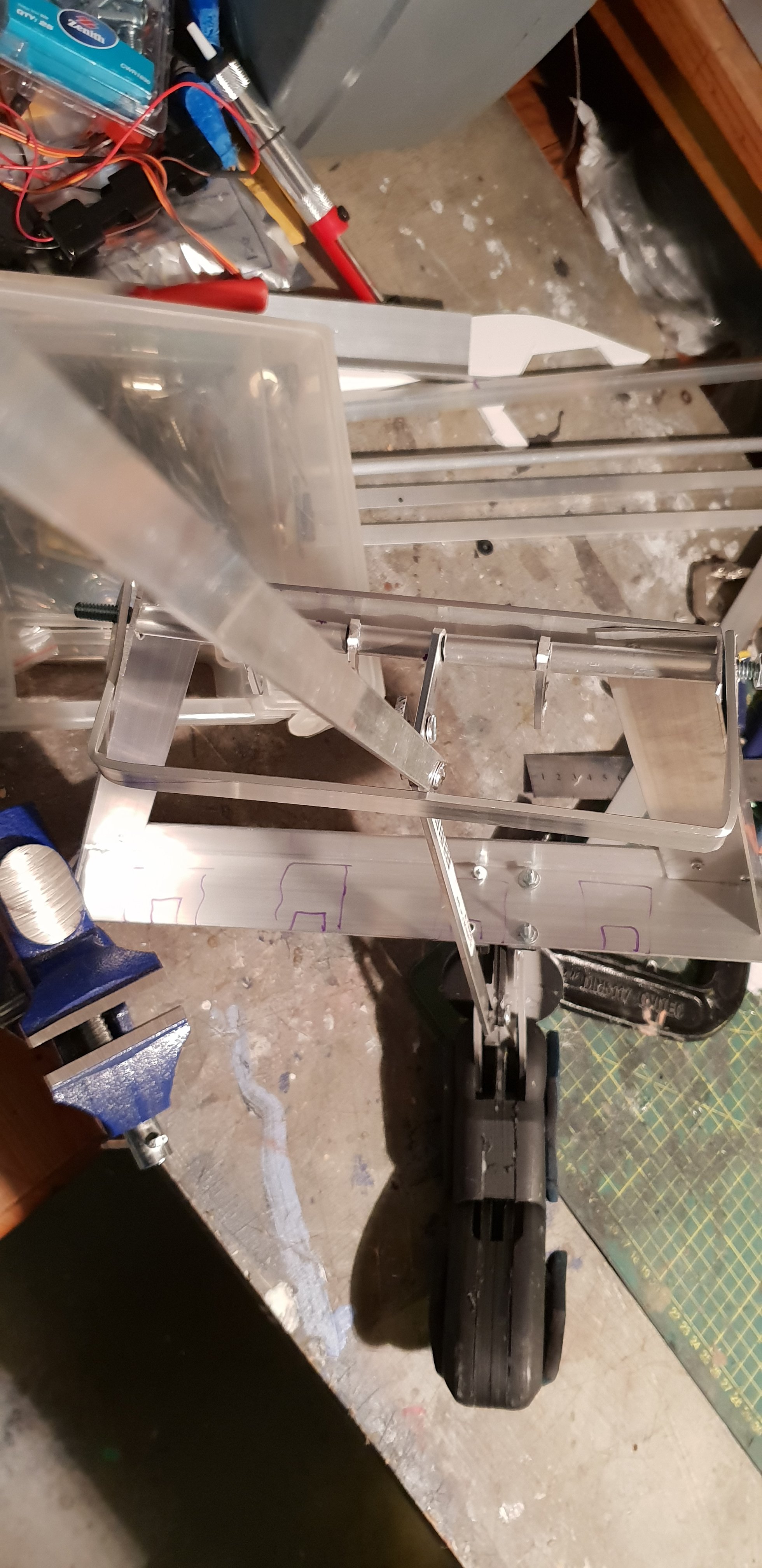

Here's the older PVC frame and i'm measuring where to put the second stage of the mechanism, the aluminium section will sit on top of the pvc frame, there's plenty of room in the arm.

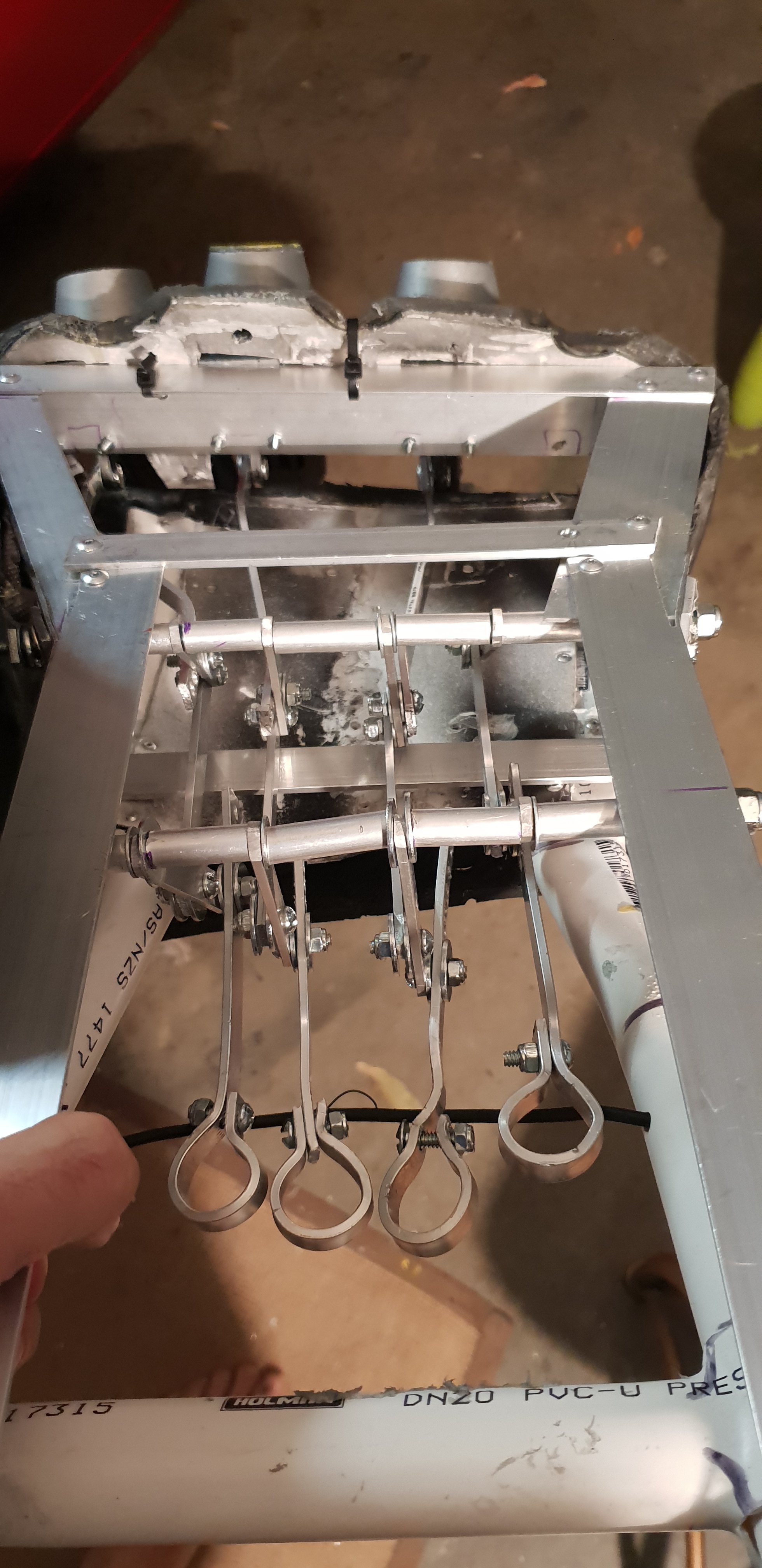

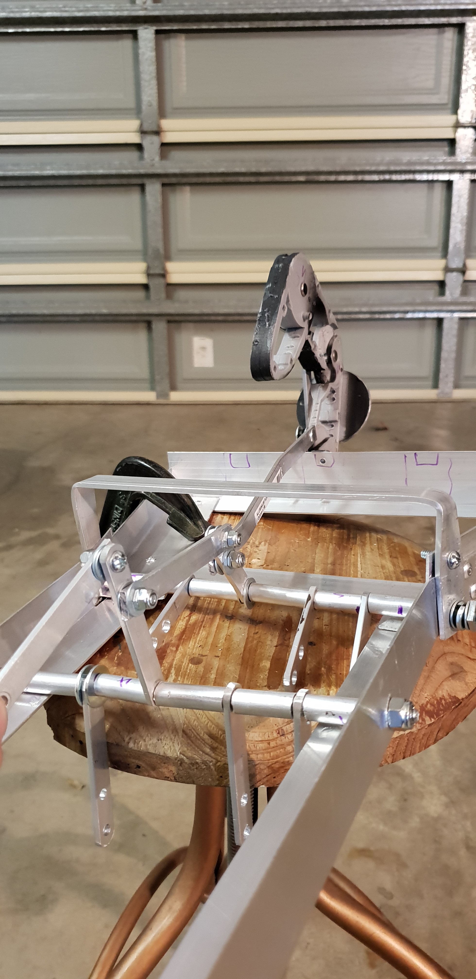

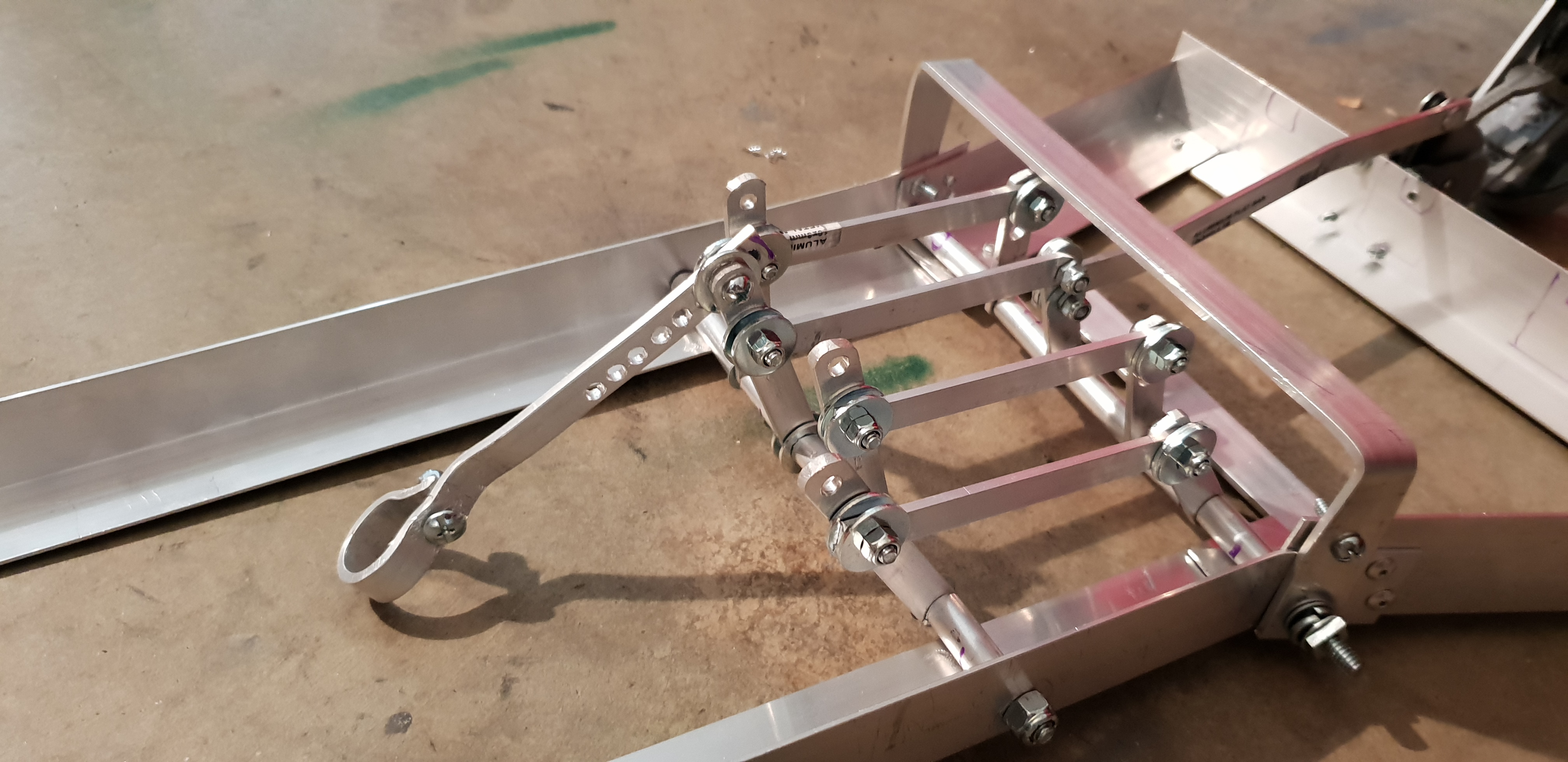

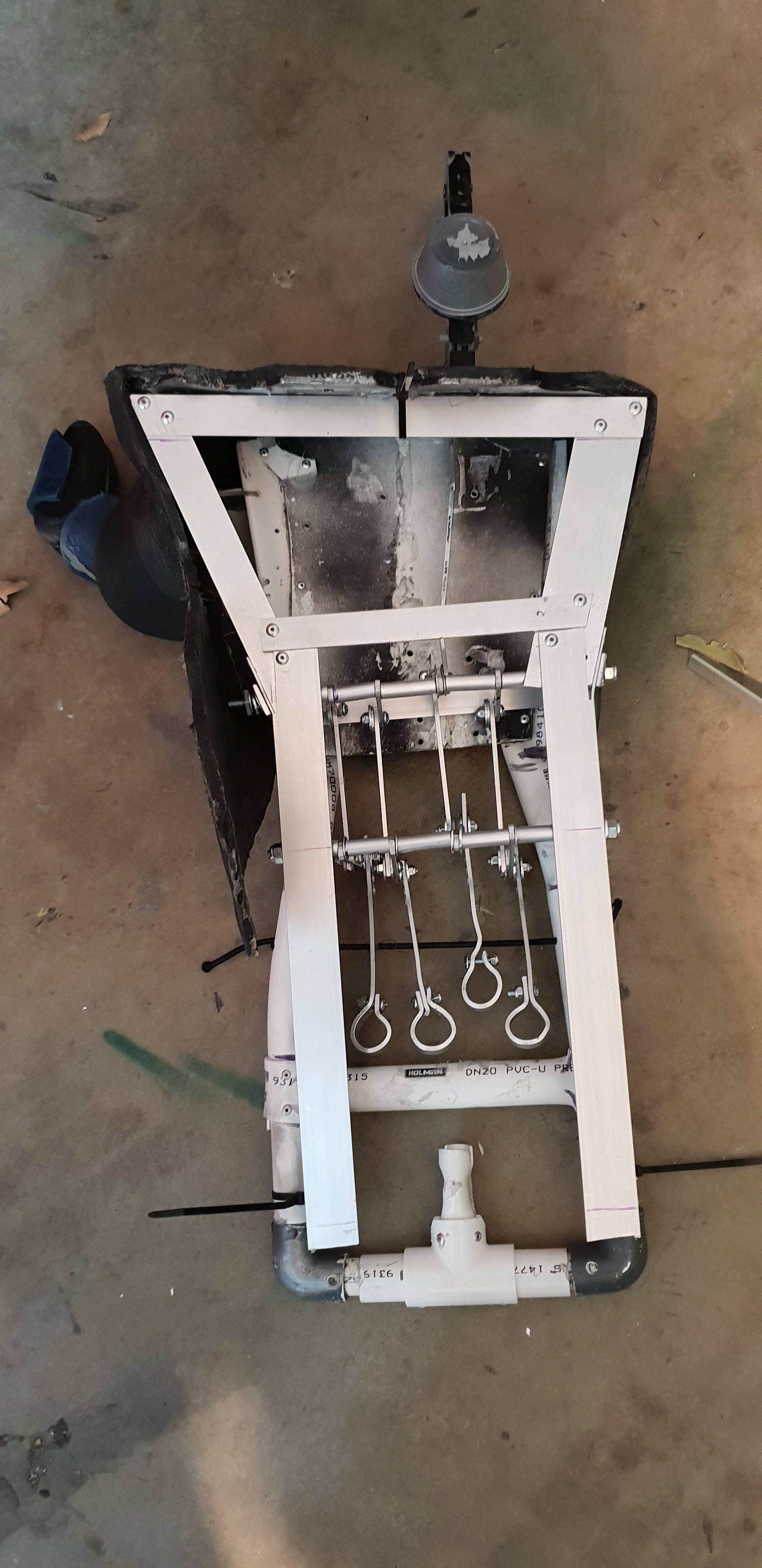

Here's the second stage with one finger connected
So far the aluminium has been pretty easy to work with, there was probably a better way to make a loop on the end but i put it in a vice and wrapped it round a crowbar with my pliers, nothing fancy and it's far from perfect but it'll do the job. I then added the rest of the struts to stage 2.
Next i'll connect this structure to the pvc and from there i'll measure out the lengths of the finger pulleys properly and fingers crossed it'll function correctly.

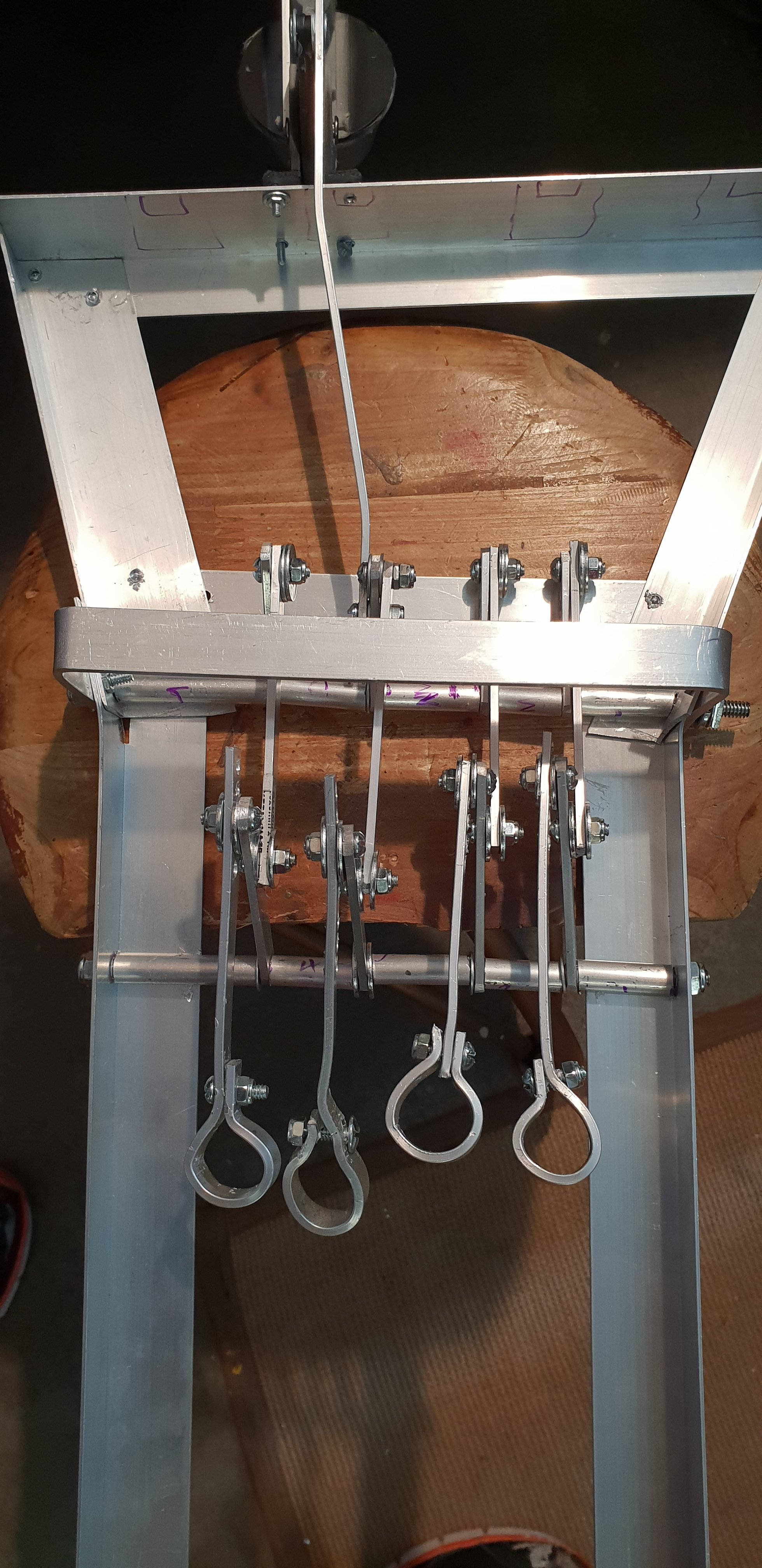

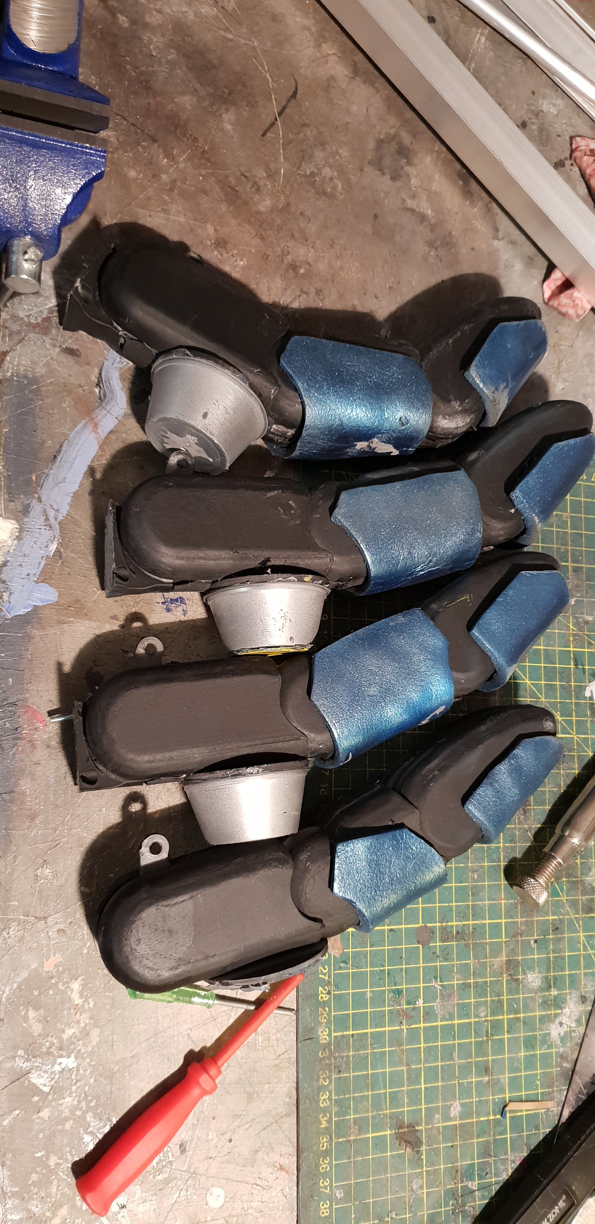

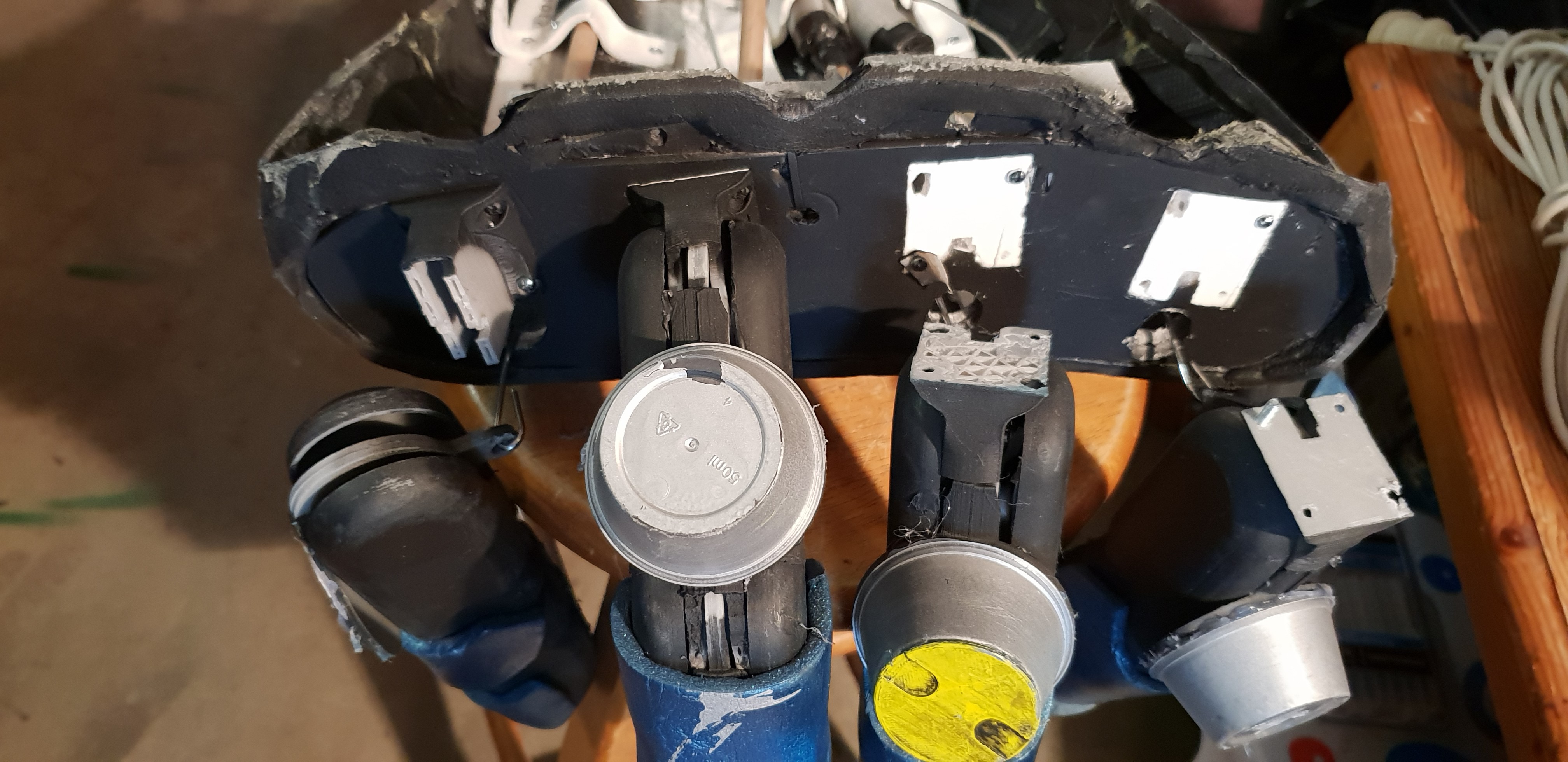

Did a little bit more...
I made 4 more loops for the fingers, i bent the aluminium around a crowbar then adjusted it with pliers. I've got 3 out of 4 fingers re-attached now, they need some steadying, there's too much lateral movement here and there but nothing a few washers won't fix. The fourth finger needs a new knuckle which i'm going to try to make out of aluminium instead of 3d printing it. Quicker and stronger.
