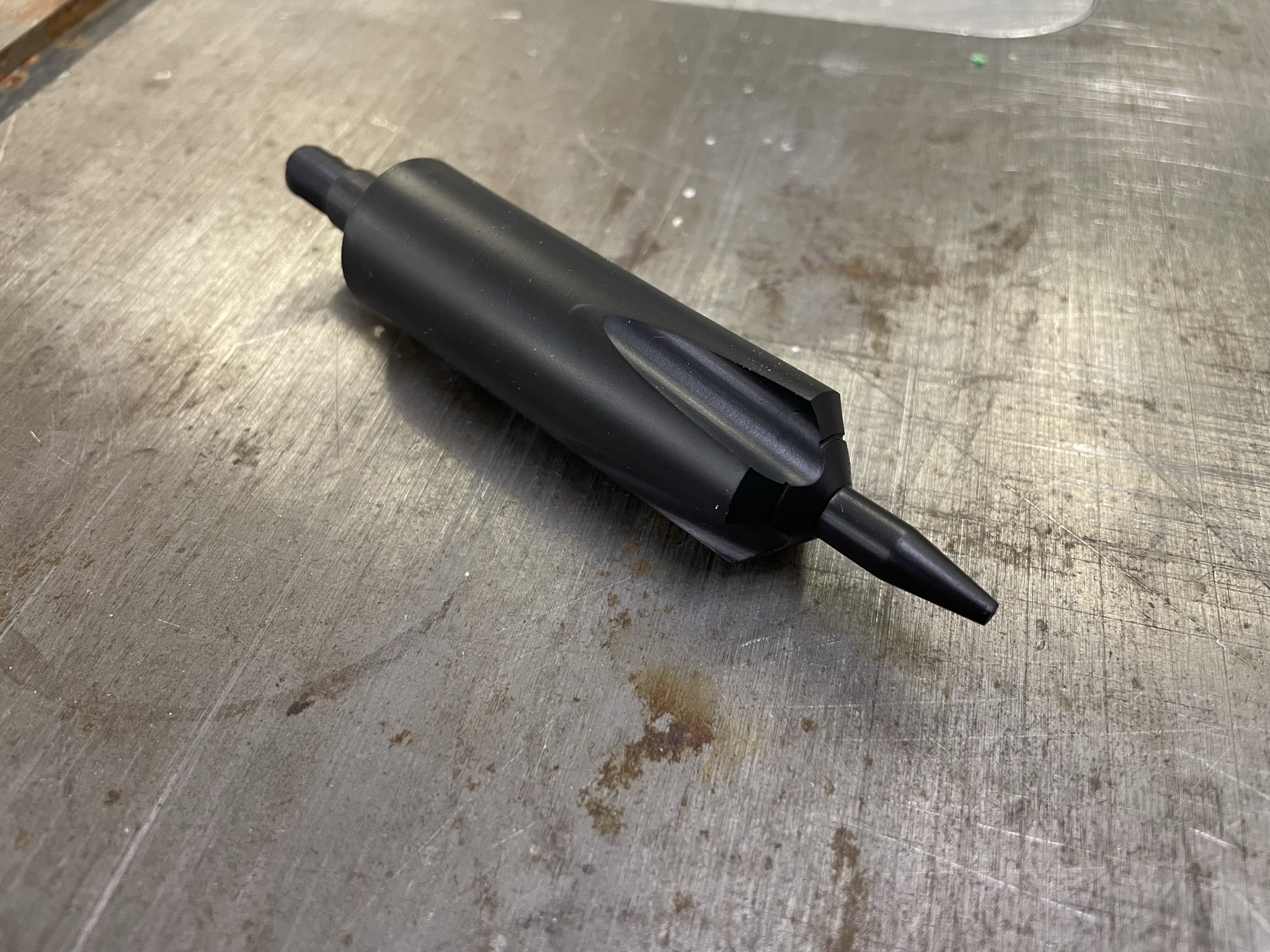

I will have more pictures of complete kits up soon as I finish casting them but for the time being here are some pictures of some of the metal turned components and metal barrel pistons complete with proper rod-ends.
There are a number of parts that are easier to SLA print then mould and cast. The rocket bodies (black objects to the left of this picture) and the scope 'voyager hull' bodies are good examples.
This is one of the barrel pistons. I have included the rod ends in the DX kit as an extra bonus for you guys as I think they elevate the whole thing just that bit more.

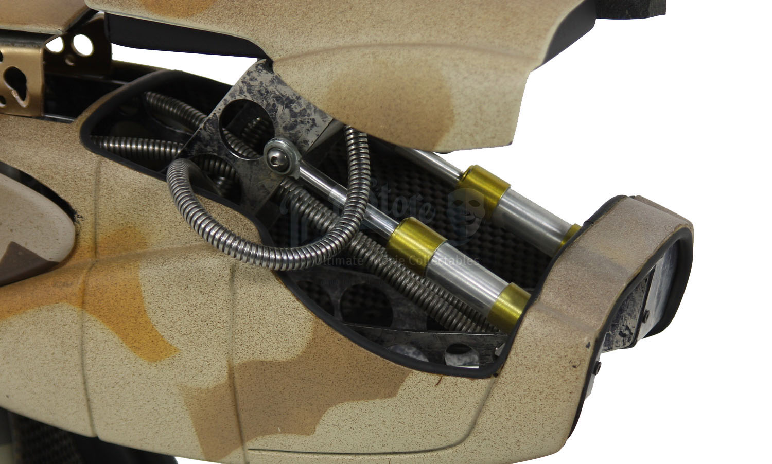

Generalurko
Does anyone (Jake or other viewers) know how to get that spattering/dotted effect for the shell? It's not just a little spatter, like you might do with flickering of a brush... it's a lot and VERY uniform (see attached photo of original ZF1).
There used to be some spray paint (and maybe still is) that gave you a spattering effect, but it was very bumpy, where this seems very smooth. Anyone who's seen the original in person, please let us know if you remember it the spatter being "even" or smooth with the base paint, or more textural/3D.
Appreciate any insight on this. :)

JakeySnakey630
Hey,
Yes it's called a 'speckle' and I've used it usually on architectural models to create texture in the finish (great for simulating concrete for example).
It's easy to create, you just want to have a piece of scrap material nearby to practice on first before starting.
With a spray gun, you lower the air pressure almost until it stops completely, then set your trigger so it barely releases any paint. The lower the pressure, the bigger/coarser the spots will appear (until the gun is literally just spitting out globs of paint); the higher the pressure, the smaller/finer the spots become. You have to adjust the spray gun's air and paint feed to get the desired effect.
You can also achieve a similar effect with aerosol paints, but you do this by misting the the object from far away, and adjusting the paint flow to get the effect.
A nice speckle effect is usually achieved with 3-4 different colours of paint, and built up in layers. There's the base colour, which is not a speckle, and usually a lighter colour and a darker colour which are speckles, or maybe two lighter colours - it's up to you to achieve the desired effect.
In the case of the ZF1 shell, there is the base tan colour, a medium brown speckle, dark brown speckle and then the base tan colour speckle (this pulls everything together and can help dilute some of the other camoflage colours)
