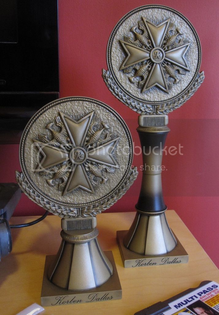

    [​IMG]
    [​IMG]
    [​IMG]

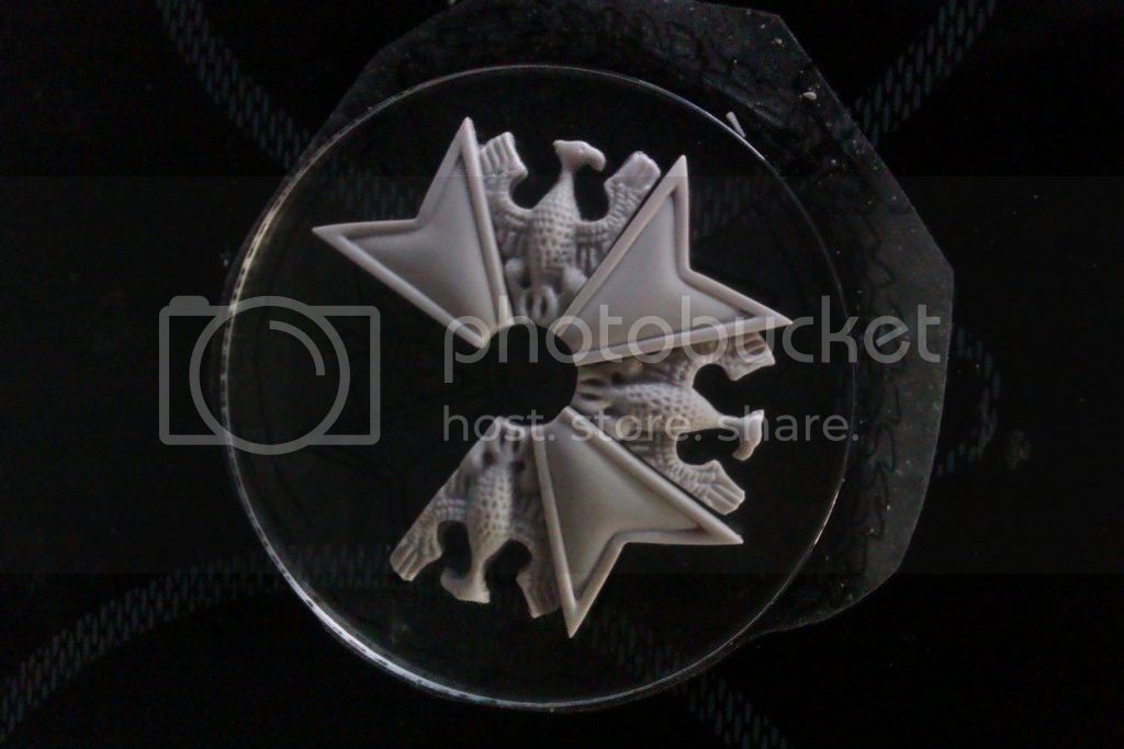

    i started off with a clear acrylic disk and i sculpted a 1/4 of the cross and bird and then made 4 from a mold
    a combination of pasticard, sculpey and apoxie sculpt.

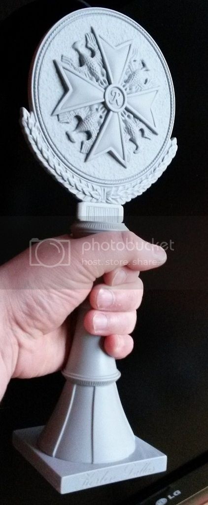

    the bottom base part was turned in wood with the 4 raised panels vac formed over a buck and glued on. the yellow piece was also turned on my lathe, it took forever to get rid of the wood grain. the oak leaves were made with sculpey individually and attached one at a time.:cry
    the 'medallion' head pieces were cast separately as the point where it joins the shaft part is very thin, there was no way resin was going to support that lump without snapping off at some point. i embedded a metal bar into the heads which extend a couple of inches into the medallion. once they are slotted into the base pieces they are VERY solid.
    the rough texture around the birds was done with that aerosol stone effect spray, left to dry properly then thick layers of paint over it to smooth it out a bit.
    the finished pieces in the first post were given a satin clear coat which really dulled down the gold which i was a bit annoyed at but you get the idea.
