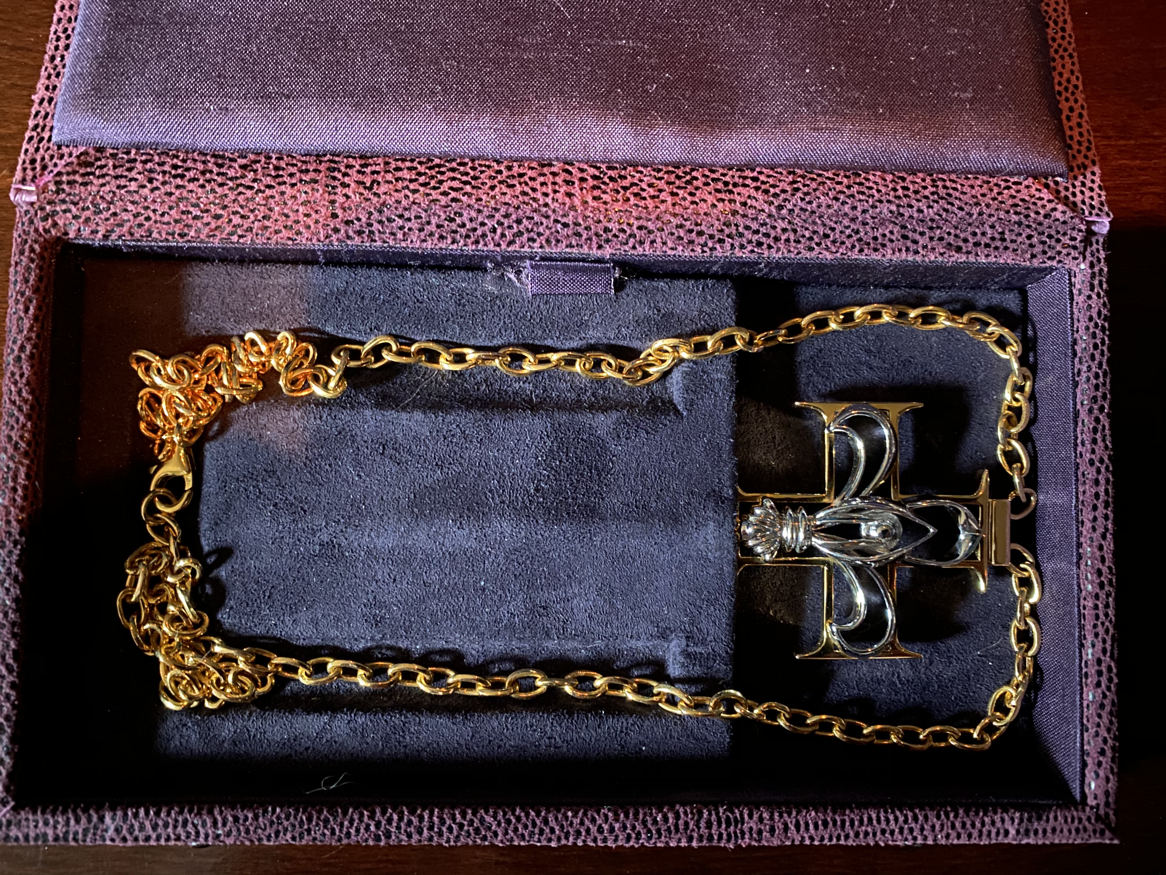

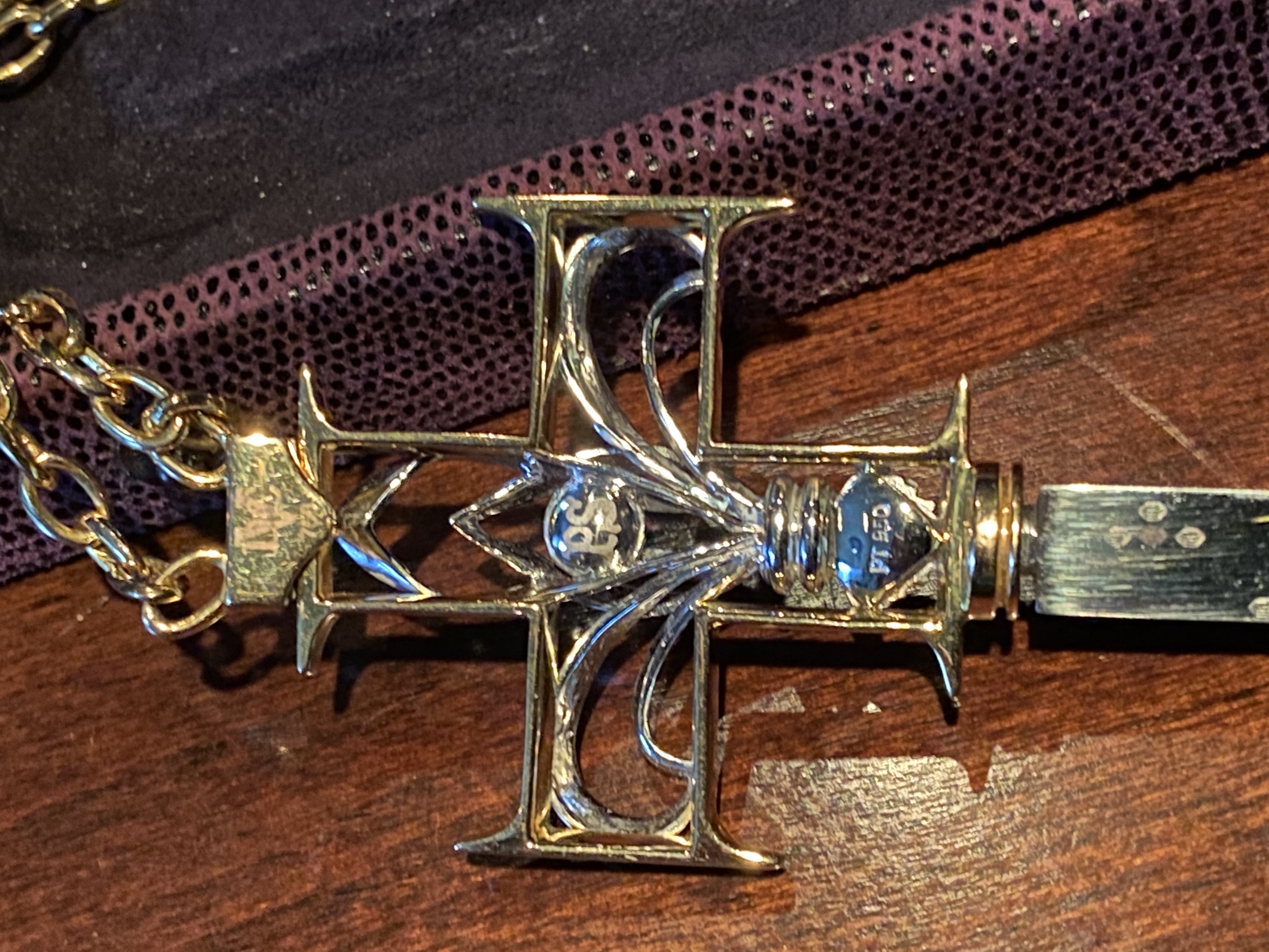

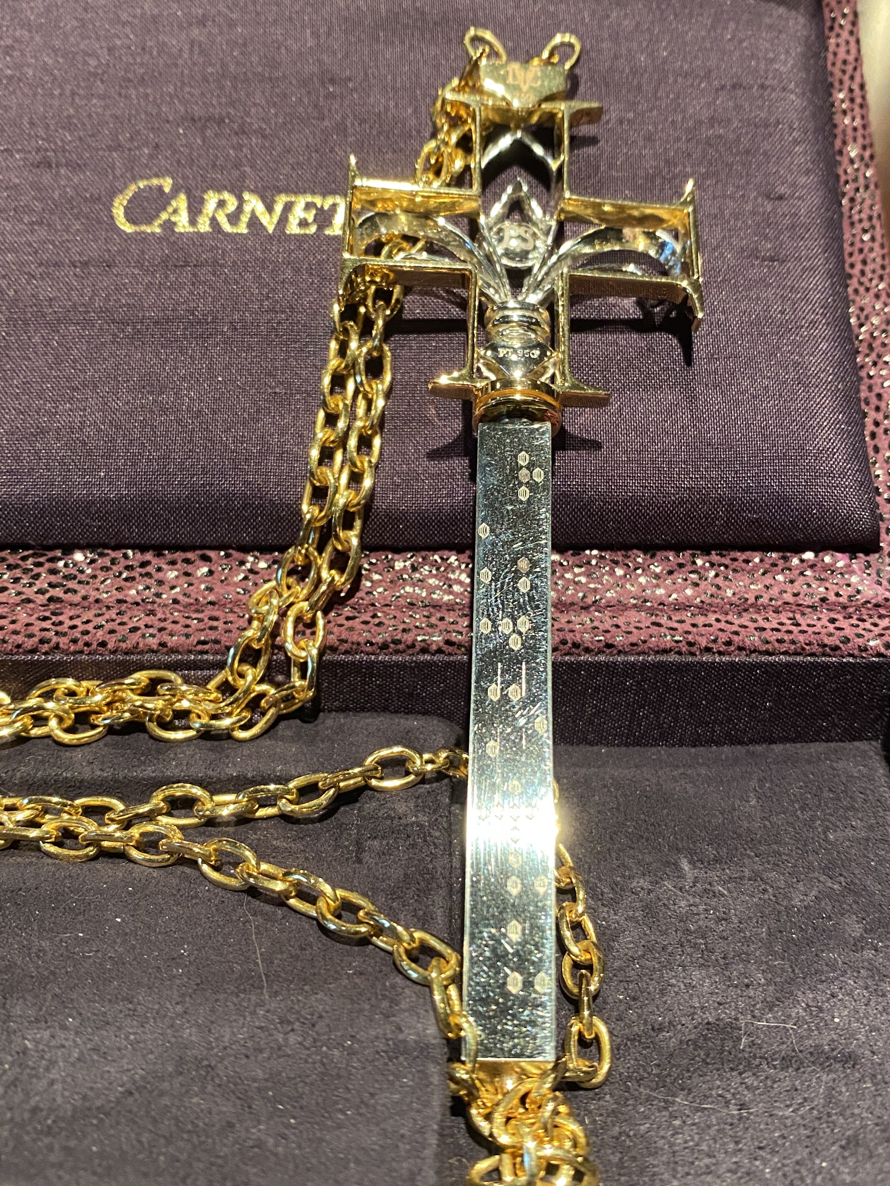

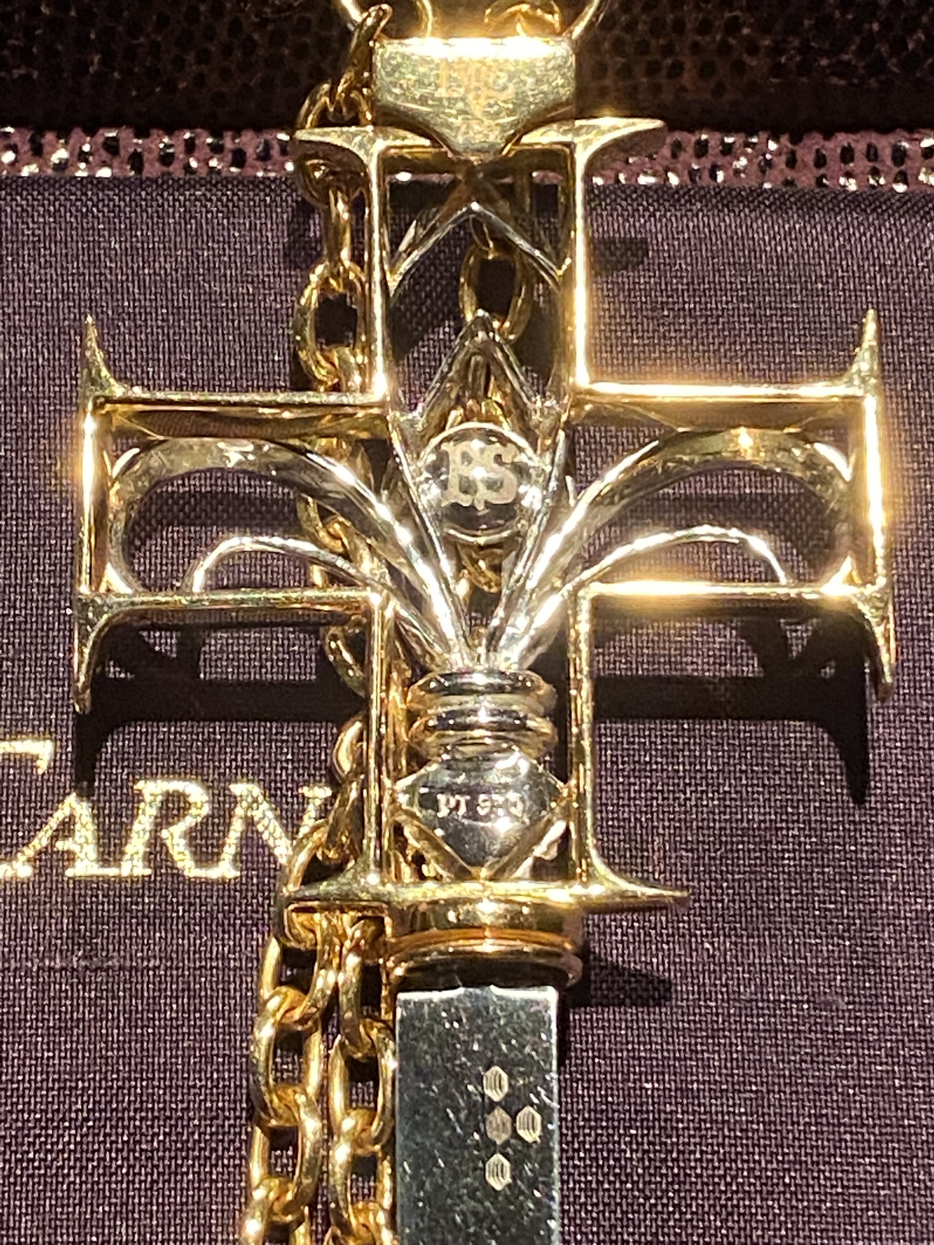

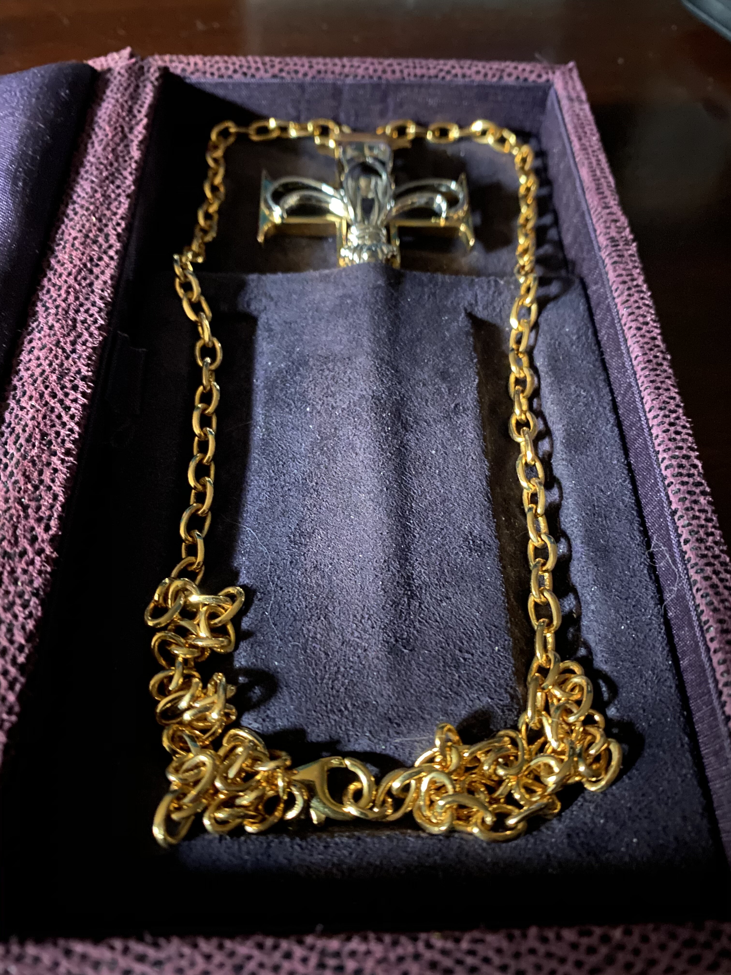

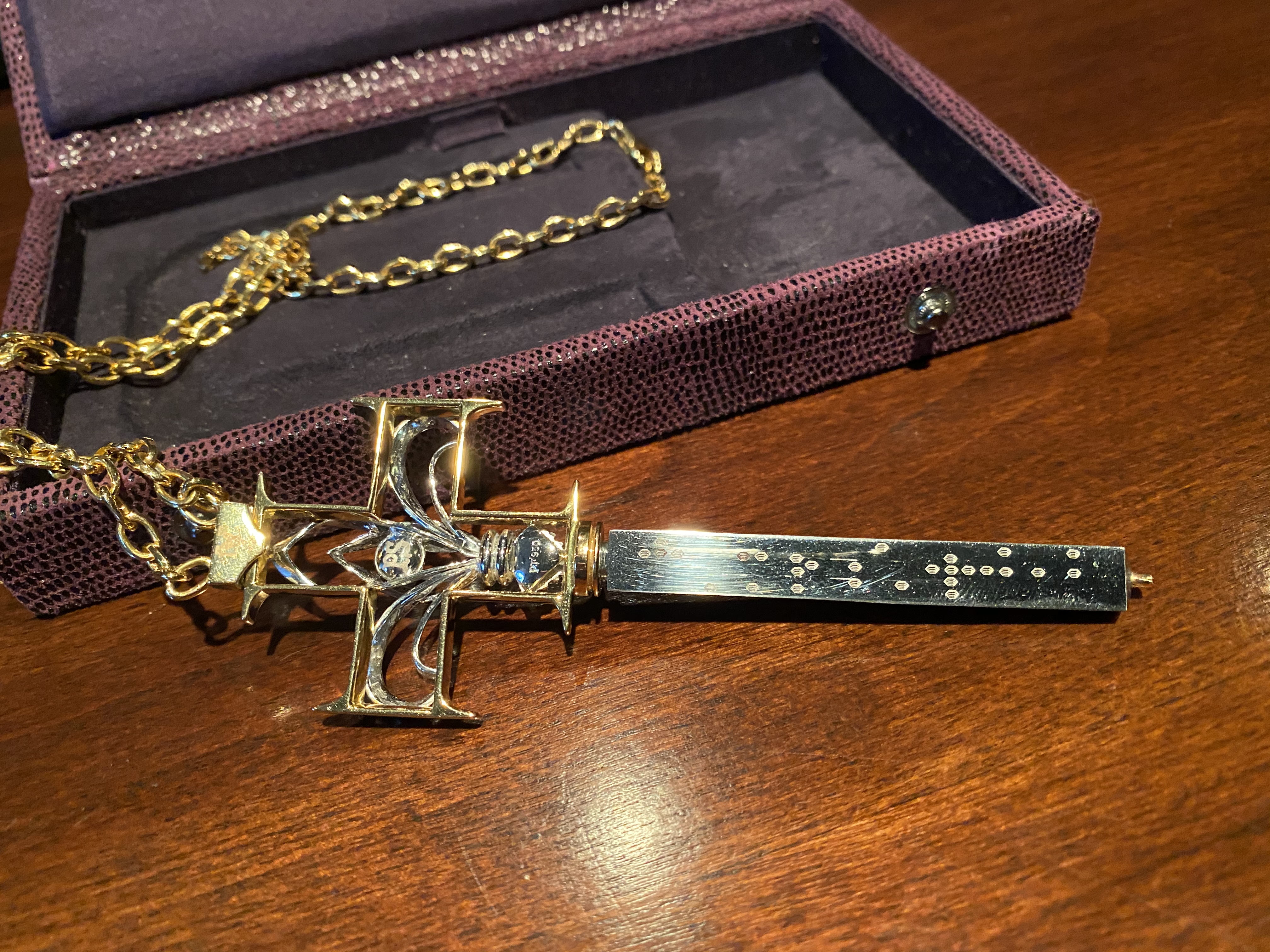

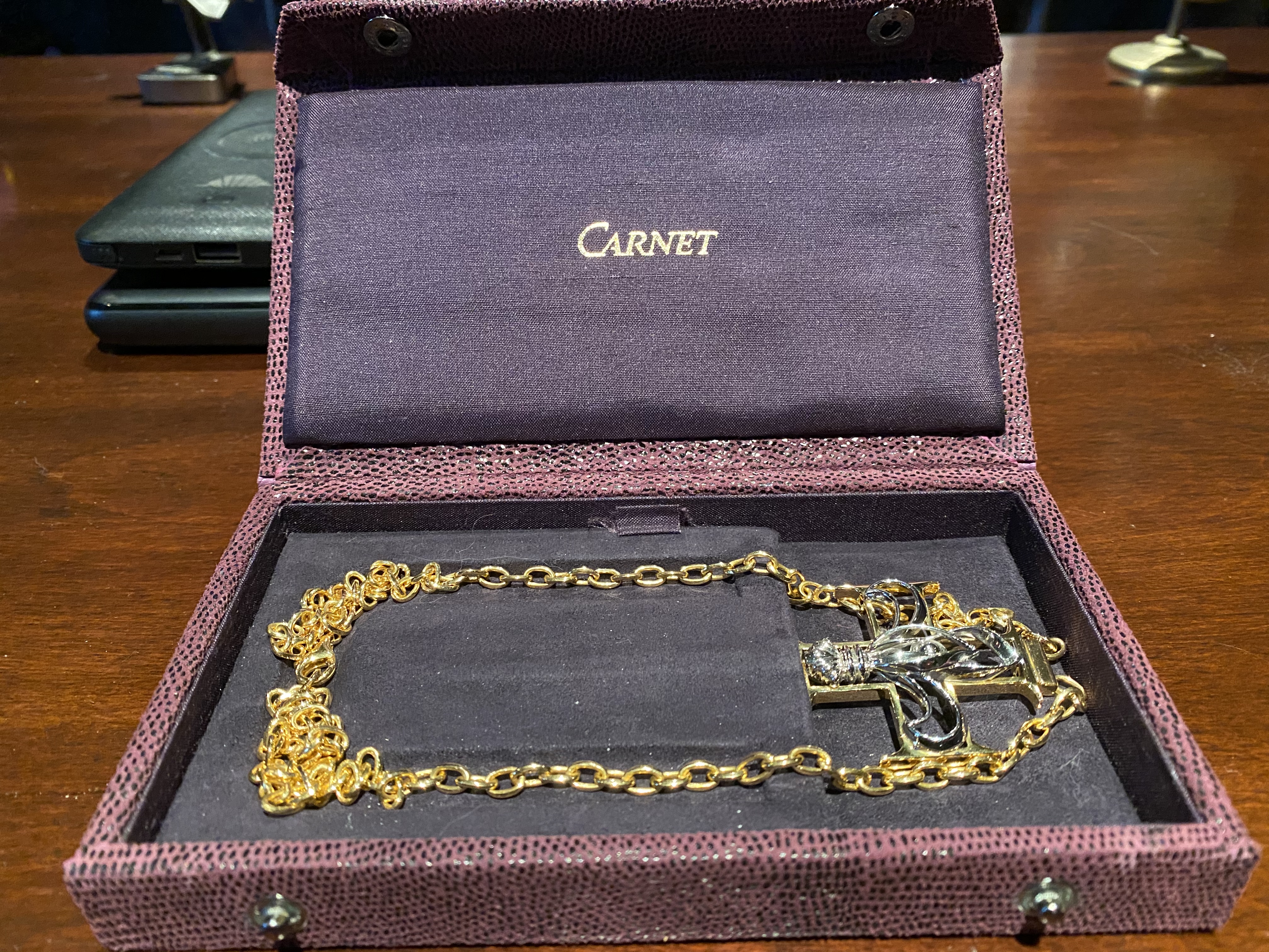

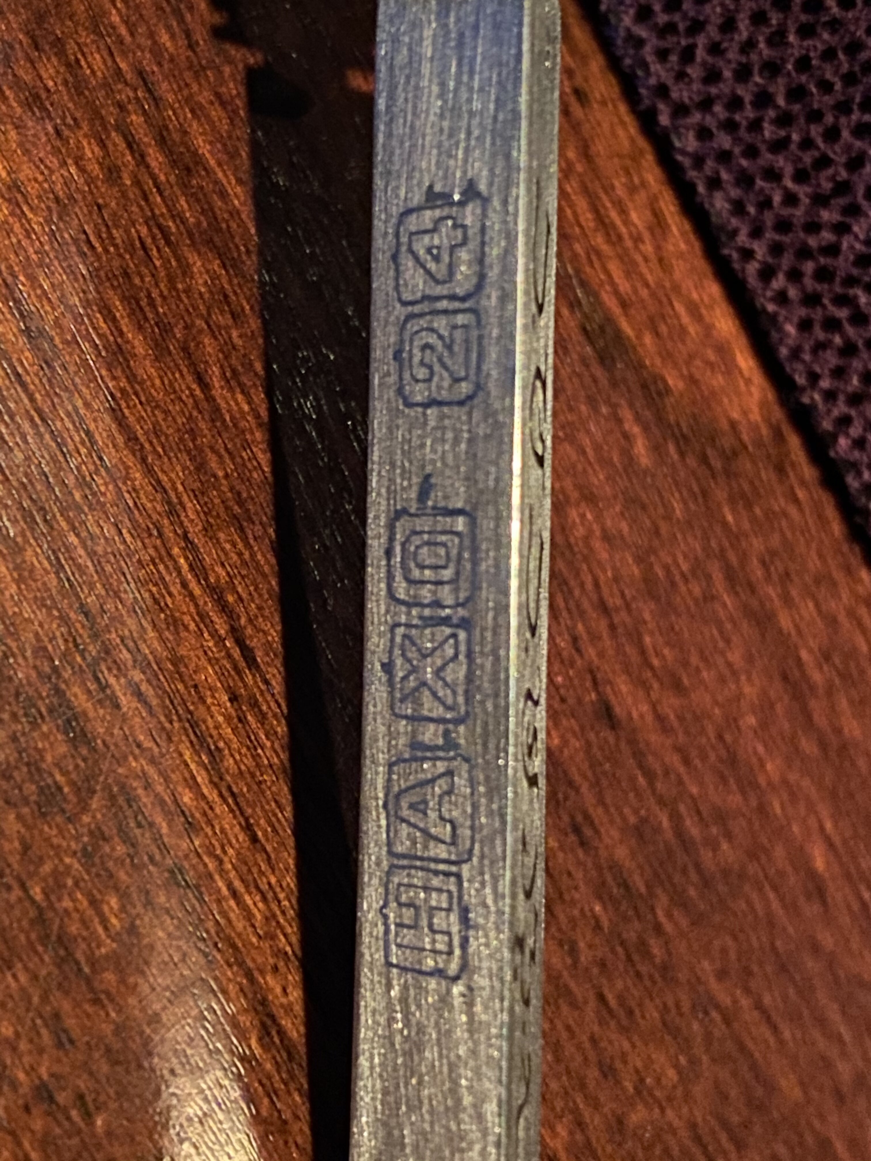

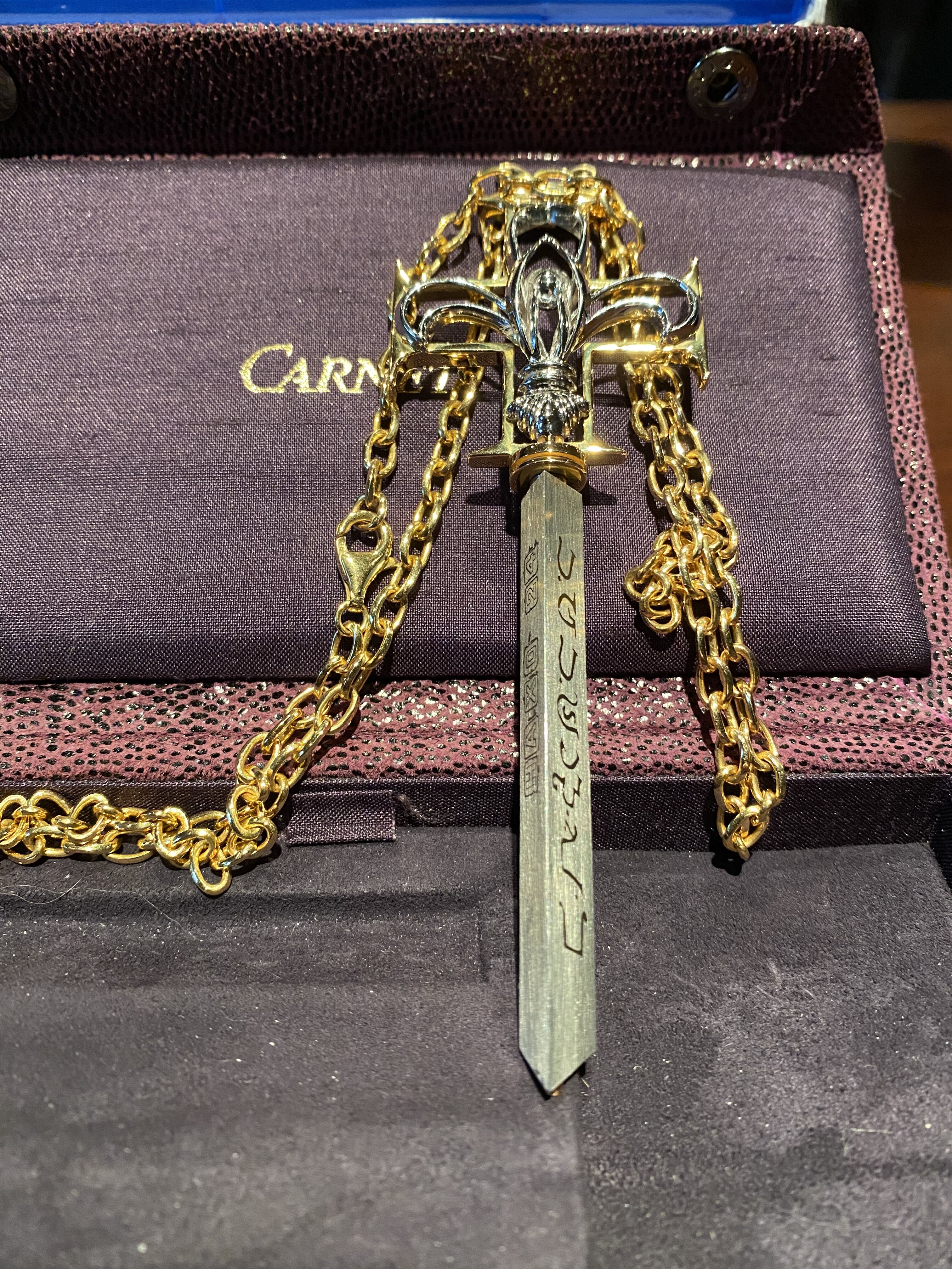

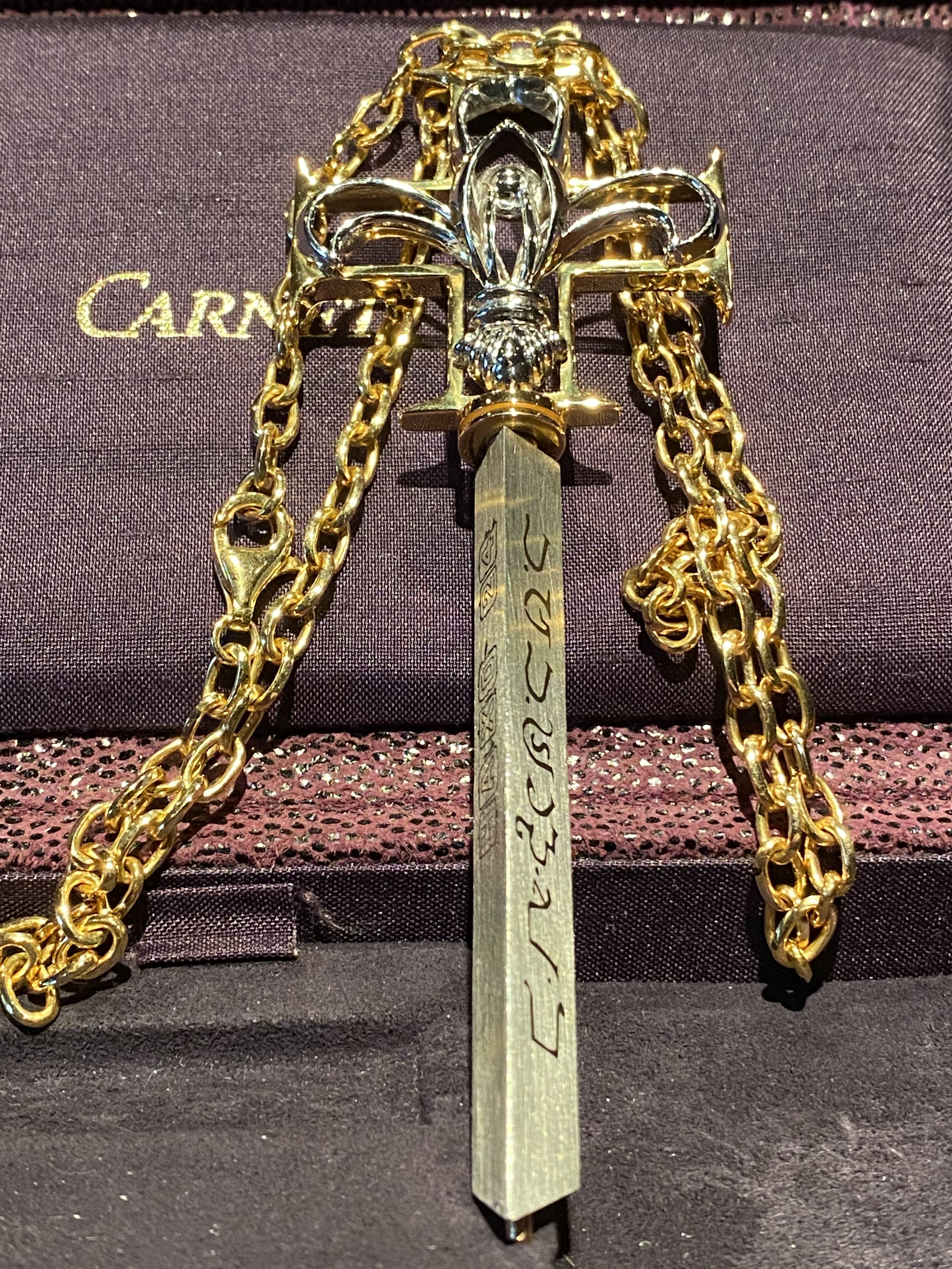

This replica prop of the Swiss Bank Key came into my possession in 2006 a few months after the movie was released. This piece of jewelry was created by the jeweler Michelle Ong of Carnet Jewelers, the same jeweler used to create the bank key for the film.
The key is made of platinum, gold, and steel. The fleur-de-lis, which is the centerpiece at the top portion, is made of solid platinum as marked by the PT 950 on the rear and clearly indicated in the photos. Also, the large letters PS (Princess Sophie) are visible on the center of the reverse. The cross surrounding the fleur-de-lis and the chain are made of solid 18 karat gold as indicated on the rear top below the DVC symbol by the mark 750. The shaft is made of steel. The back of the shaft contains the dots which are read by the laser. On one side of the shaft is seen the Depository Bank of Zurich’s street address, “HAXO 24” and on the other side a series of symbols.
This key was not used in the film but rather is an exact duplicate of the screen used version. It comes with a custom made case made exclusively and marked by Carnet Jewelers.
Mother. Of. God. That is amazing. I had no idea this (these?) were produced.
Wow, that must be the ultimate replica of this prop... Any idea if the jeweler would make these on order?
The film set required a few of these be made, some modified some which looked like this one. The story behind this one is that in order to promote the film they had an extra one made and auctioned it off. Michelle Ong from Carnet Jewelers who produced these for the film is located in Hong Kong, I don’t know if she produced, or would produce, any others.
