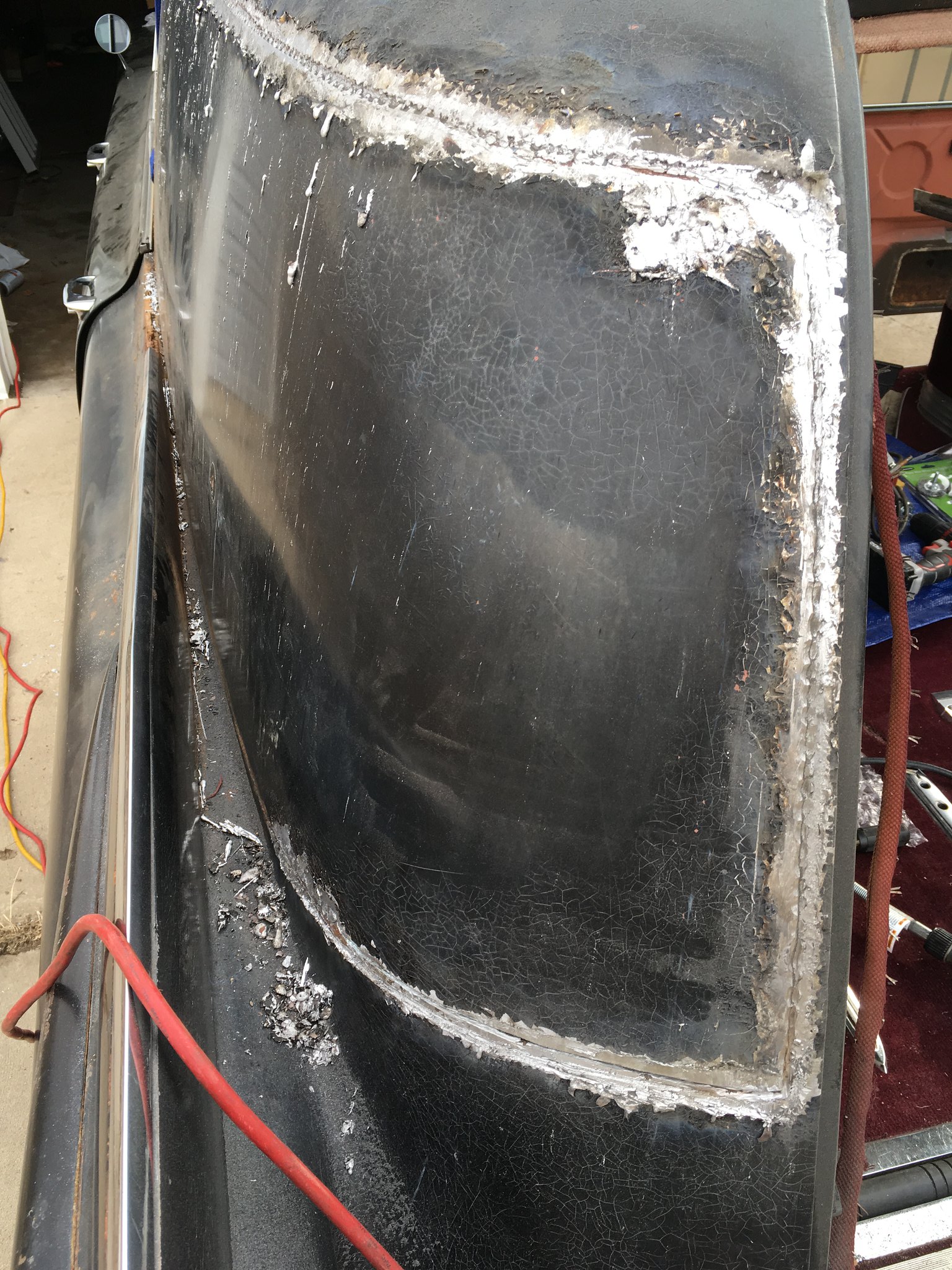

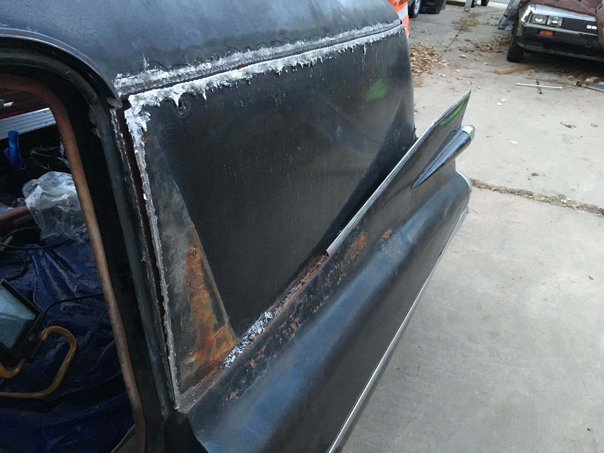

And because you didn't ask for it, here you go. This is probably something you'll never see done again with one of these cars. As I said previously, most builders just cut these panels out and off they go. No, no, not this guy.
You can see where I had melted the lead, so it would expose all the spot welds underneath. Then it was just a matter of grinding each individual spot weld with the Dremel. Popping the occasional weld on both the inside, and the outside. Then removing the panel entirely. And as I also said previously, these panels are ridiculously heavy.
Everything on this car is fine, 100%, American steel, baby!
Then lastly, just ground out that cross member piece to open the window area completely up.

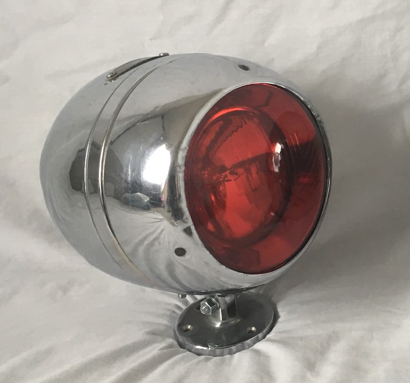

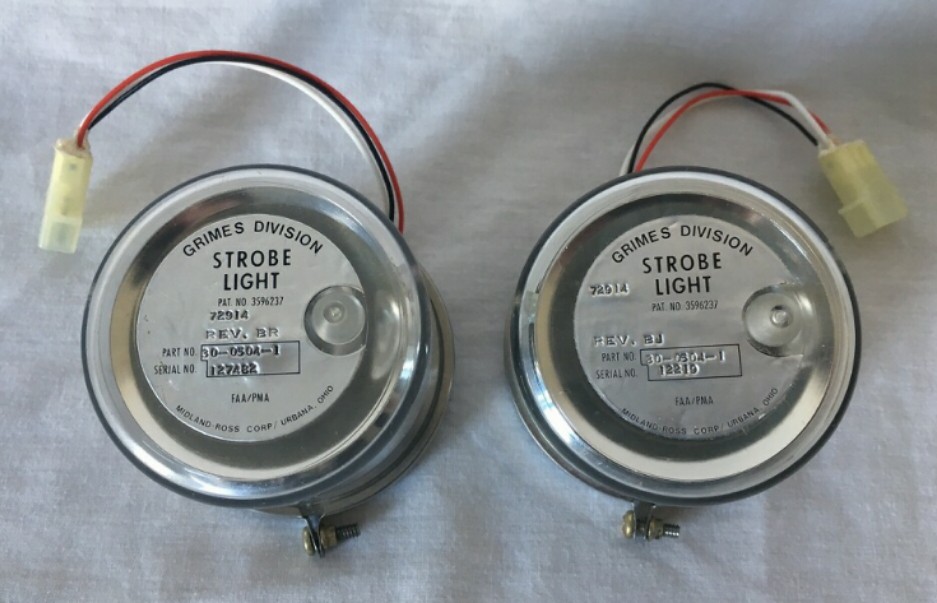

Grimes Bumper Strobes:

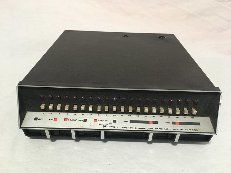

Regency Scanner:

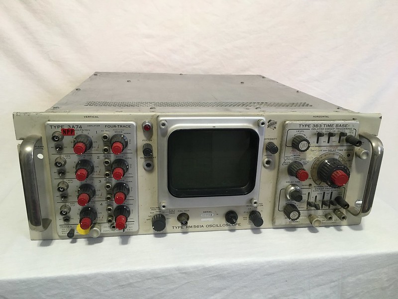

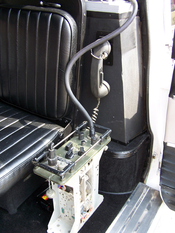

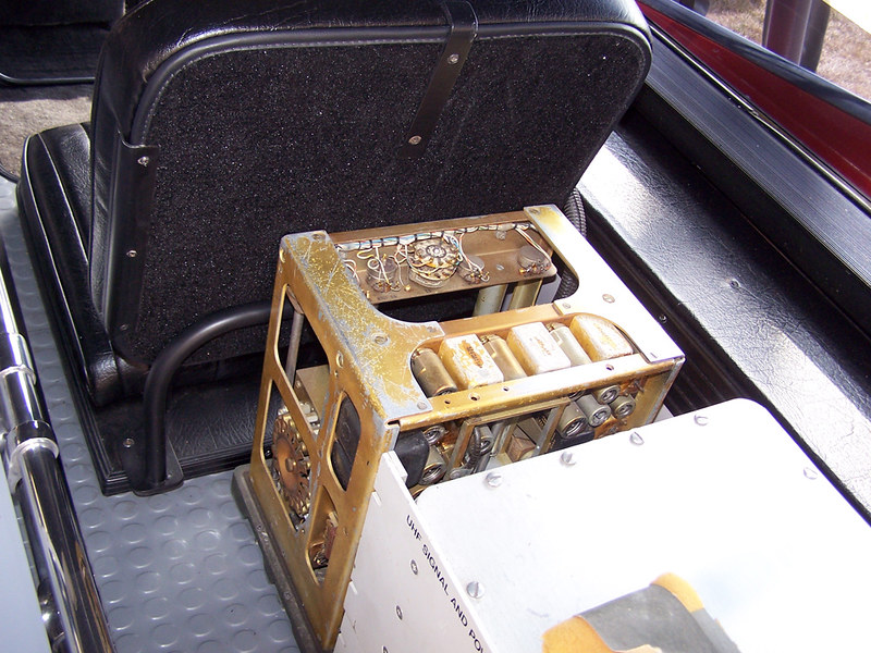

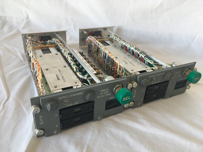

Tektronix Oscilloscope & Correct Time Bases:

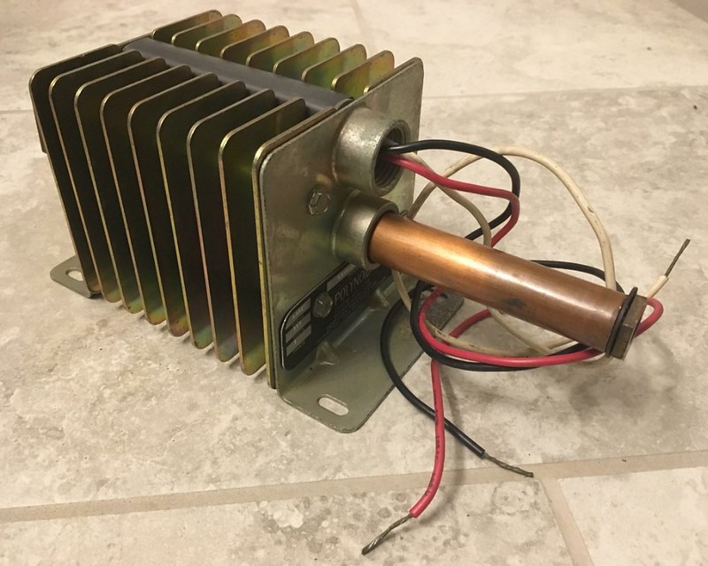

Polynoid:

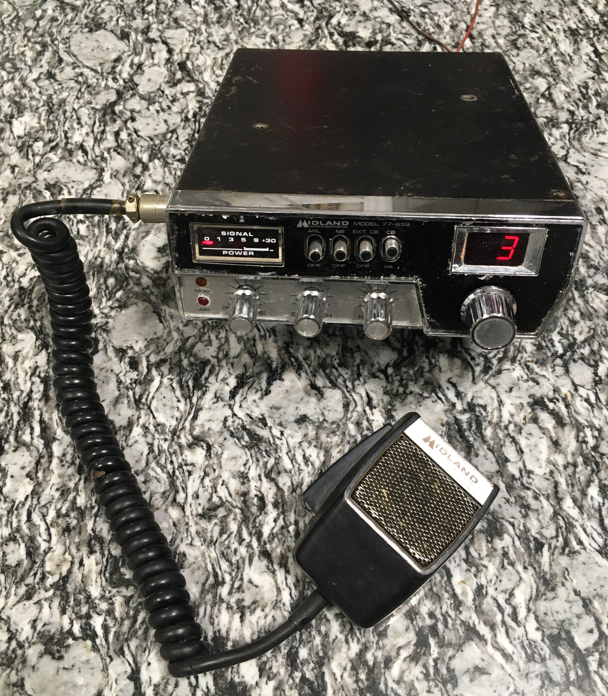

Midland Radio:

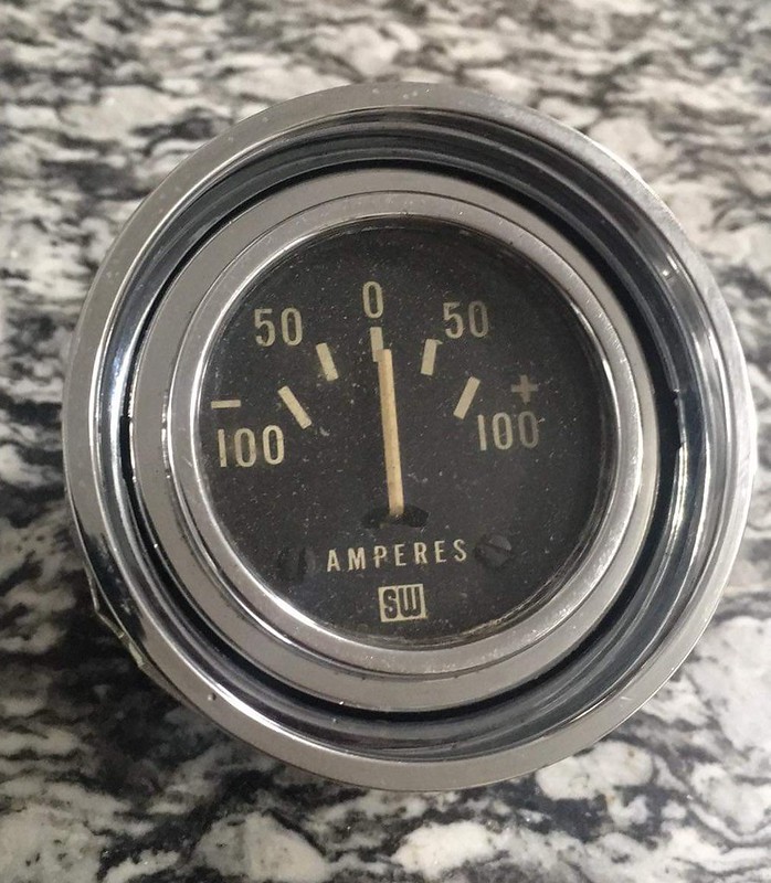

Under Dash AMP Meter:
In Dash AMP Meter:

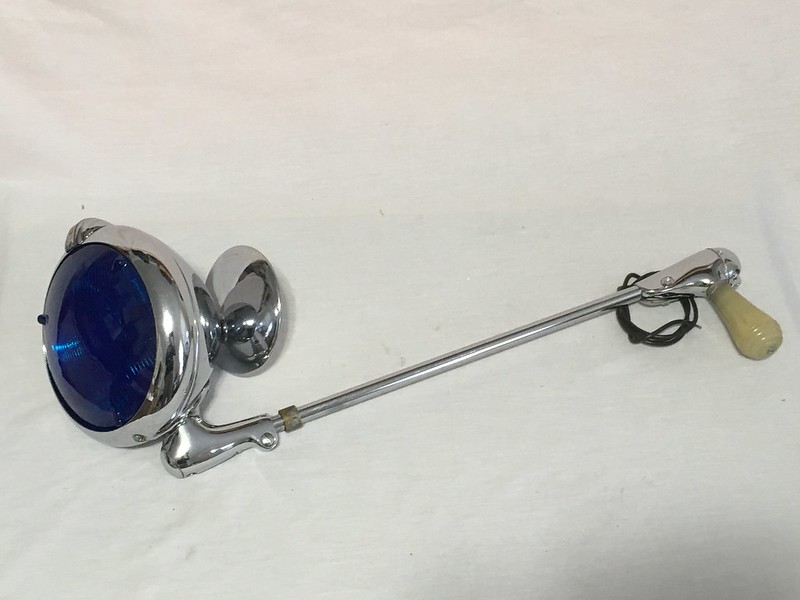

Unity Spot Light:

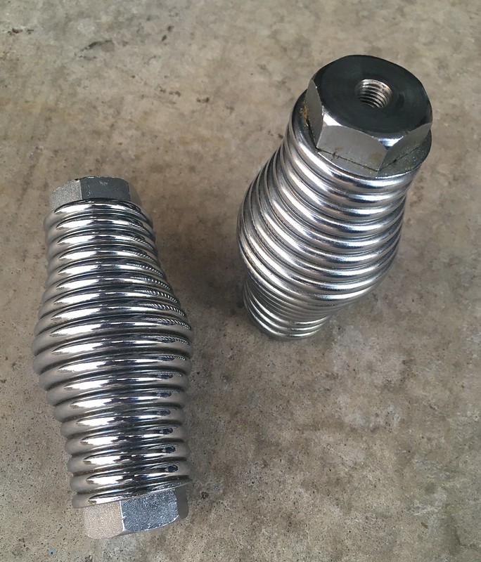

Whip Antenna Springs:
