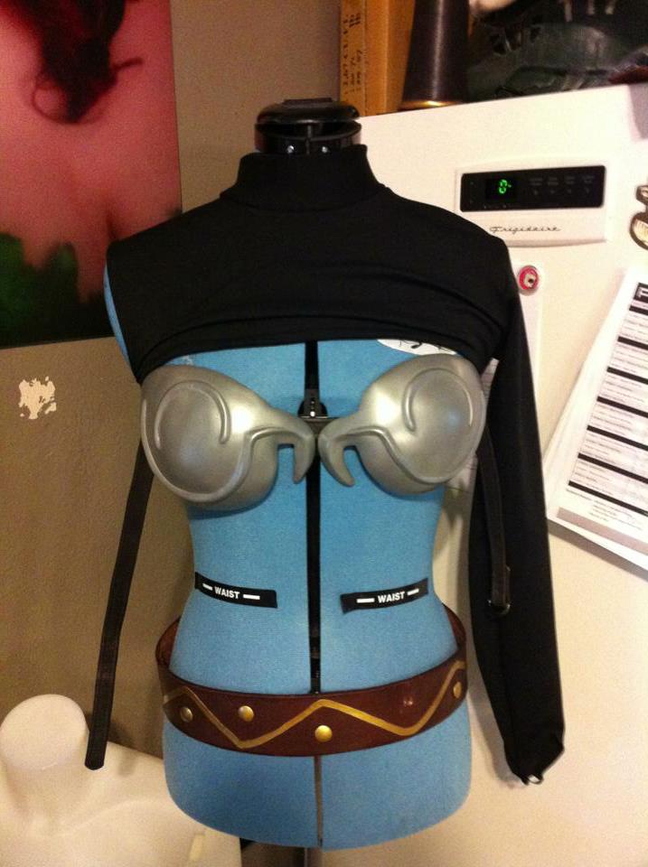

Bra Top:
Bra top tests (done on my chest cast): First done in epoxy sculpt, tested in worbla, which didn't give the curve we were looking for, decided to complete in epoxy sculpt to use for a mold.
The mold was then done in Rebound 25 silicone, and backed with plasti-paste for strength.
The resin used was Smooth Cast 325 with aluminum poweder mixed in for cold cast.
Bra being reinforced with fiber glass, lined with leather and straps resined into it.

Belt was cut on the curve into heavy leather, then patterned the design for the belt onto a lighter leather, painted it and then glued to the leather belt.

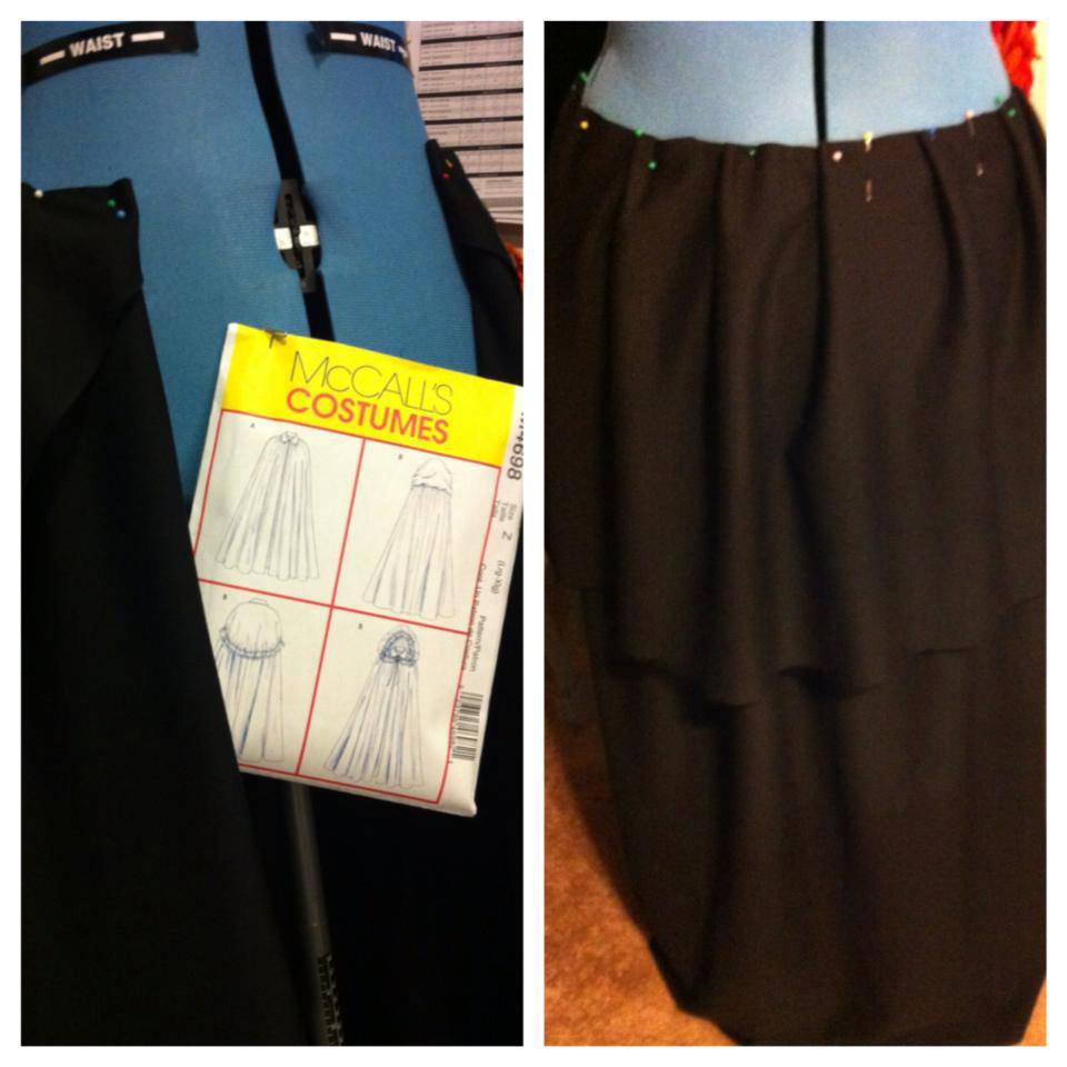

The "butt cape" was made in a wool, using one panel of a cape pattern, which then I sliced the top off to use for the ruffle for the top (hand pleated), Horse hair hem for the flow of the bottom.

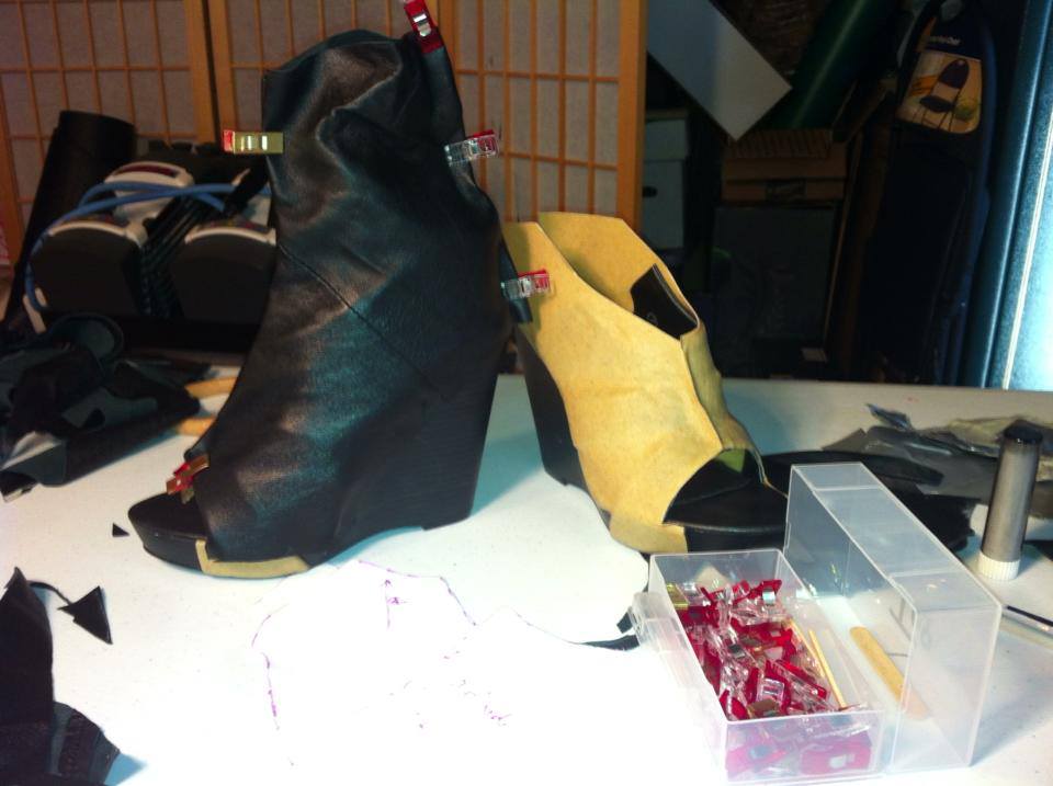

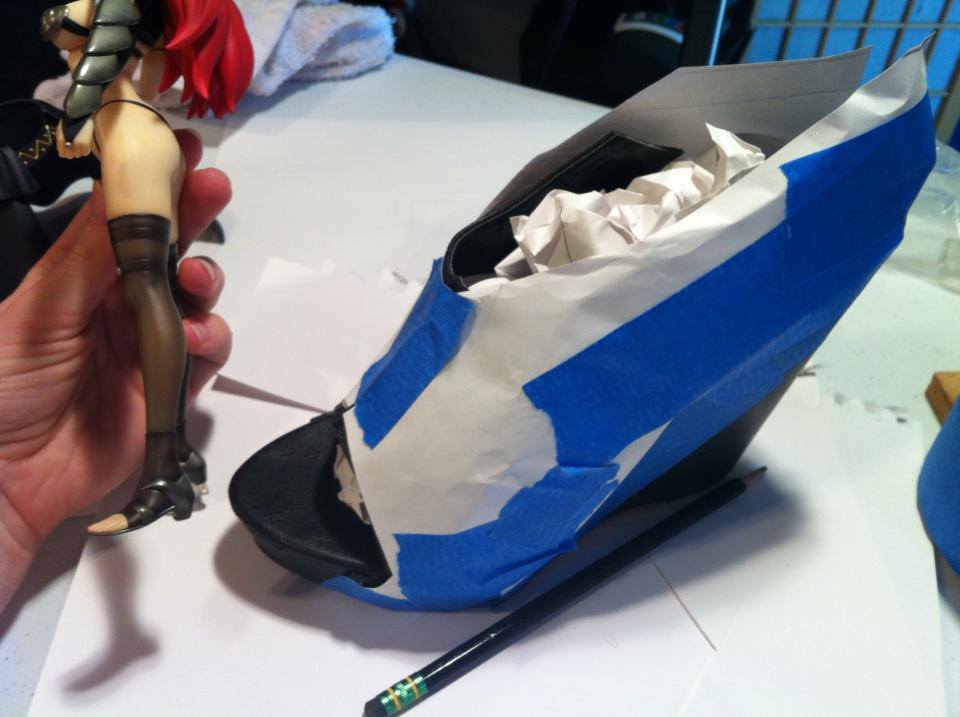

The shoes were my crowning achievement: I used a base shoe, cut away from the toe, and then covered it in worbla. I then made a leather shoe cover and adhered it to the shoe. I did a test piece in leather before using the actual brown leather that we bought at tandy. I (no pic) used snaps on the back so I could get into the shoe easily.
shoe prgress.jpgshoe template.jpgthe shoes.jpgworbla base shoe with leather pattern.jpg
Using worbla, the shoe armor was made.
