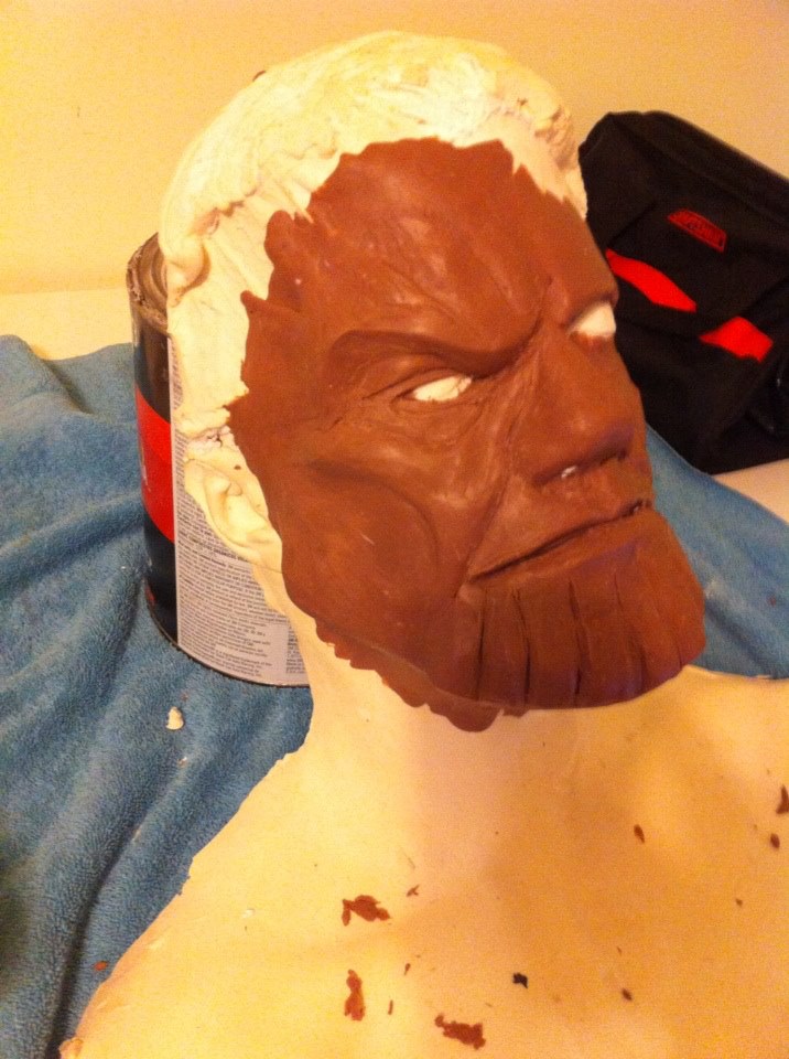

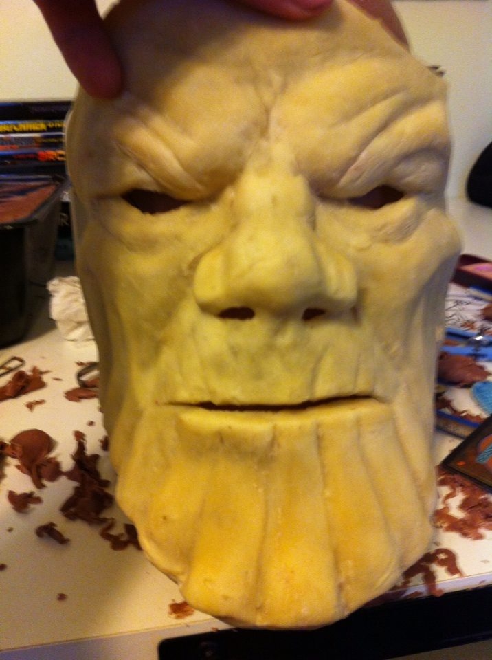

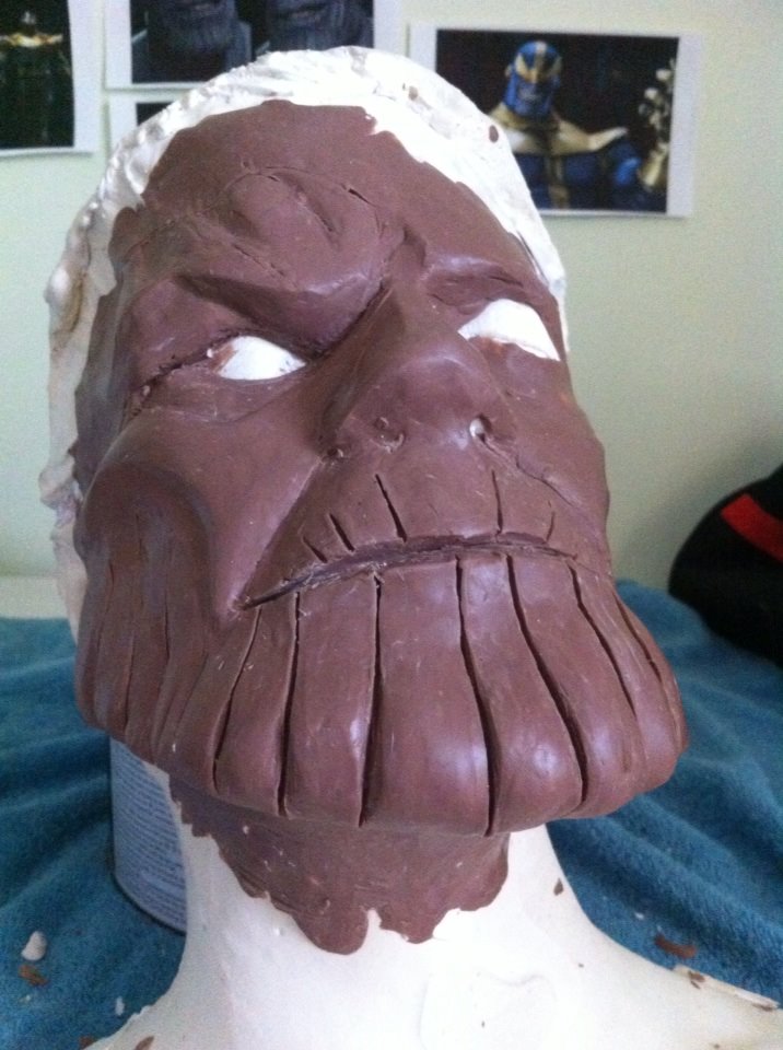

Hello, KWMarvel here. I just recently finished up a Nova Prime helmet (http://www.therpf.com/f9/nova-prime-helmet-wip-pics-189873/#post2985800) and I figured "wh why not?" and make a Thanos mask from foam latex. I dont have any experience with sculpting, but I have read up a lot on it and this is my first attempt at something like this. I made a bust of my head so it will fit pretty well. I dunno if I should go foam latex or silicone or what. Here are some WIP pics. Will be updating frequently.
1173759_10201405521313262_1307016723_n.jpg1231124_10201385071002017_748140111_n.jpg1236415_10201407335838624_1665995828_n.jpg

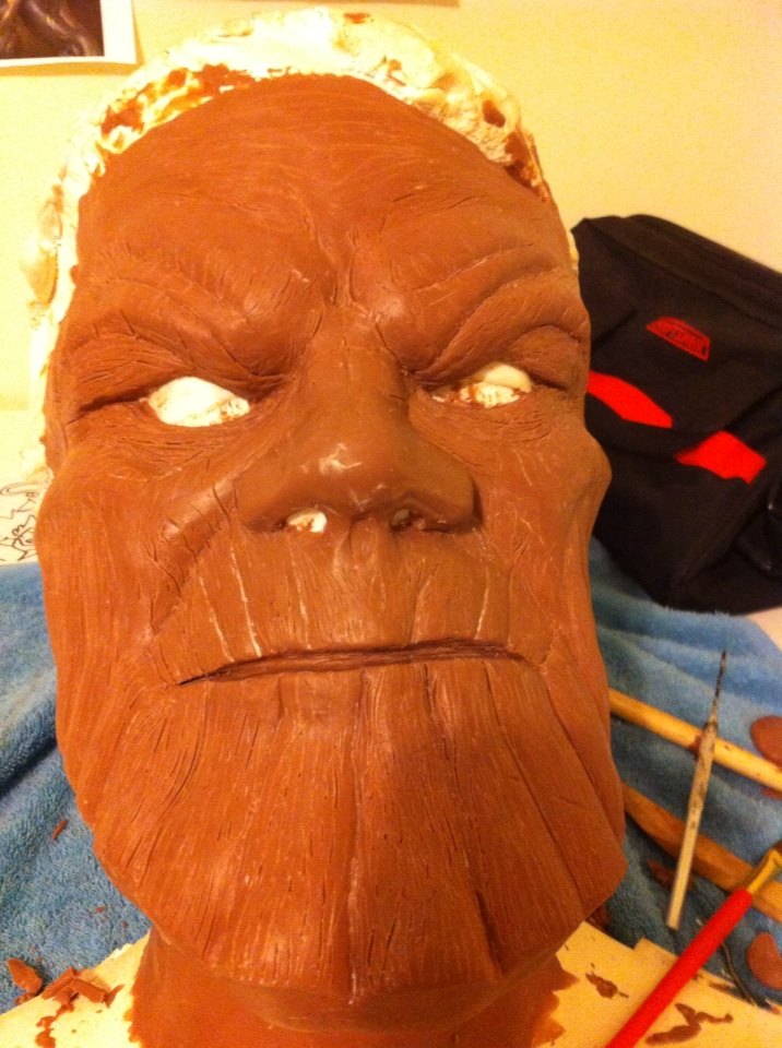

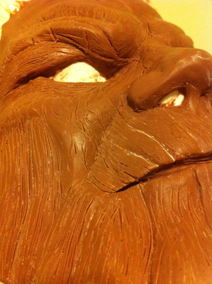

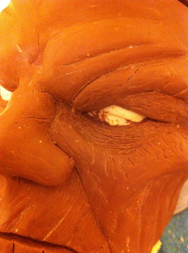

Added a bunch more details. Made some grooves and wrinkles in his skin and I kind of like of where this is going. Here are some pics.
971288_10201451716428111_1992292757_n.jpg1175079_10201451177174630_192704078_n.jpg1235459_10201451701827746_823162618_n.jpg
I have a question though. With the isopropyl alcohol, there is some white residue. How do I go about removing it from the sculpt?

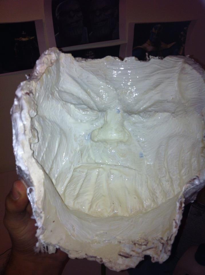

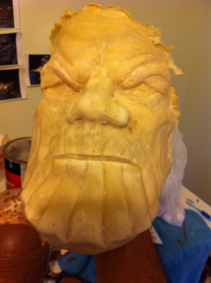

Ok update!! Made a mother mold and pulled the plaster off the sculpt. Spent an hour or THREE cleaning it out with acetone and an old toothbrush. Already on a few coats of latex, and here it is at its current status:
Ok update!!! pulled the latex from the mold and it came out pretty good. Been trimming and getting rid of any bumps I find. Here are some pics of its current status.
I will be painting this thing later today. More pics to follow
