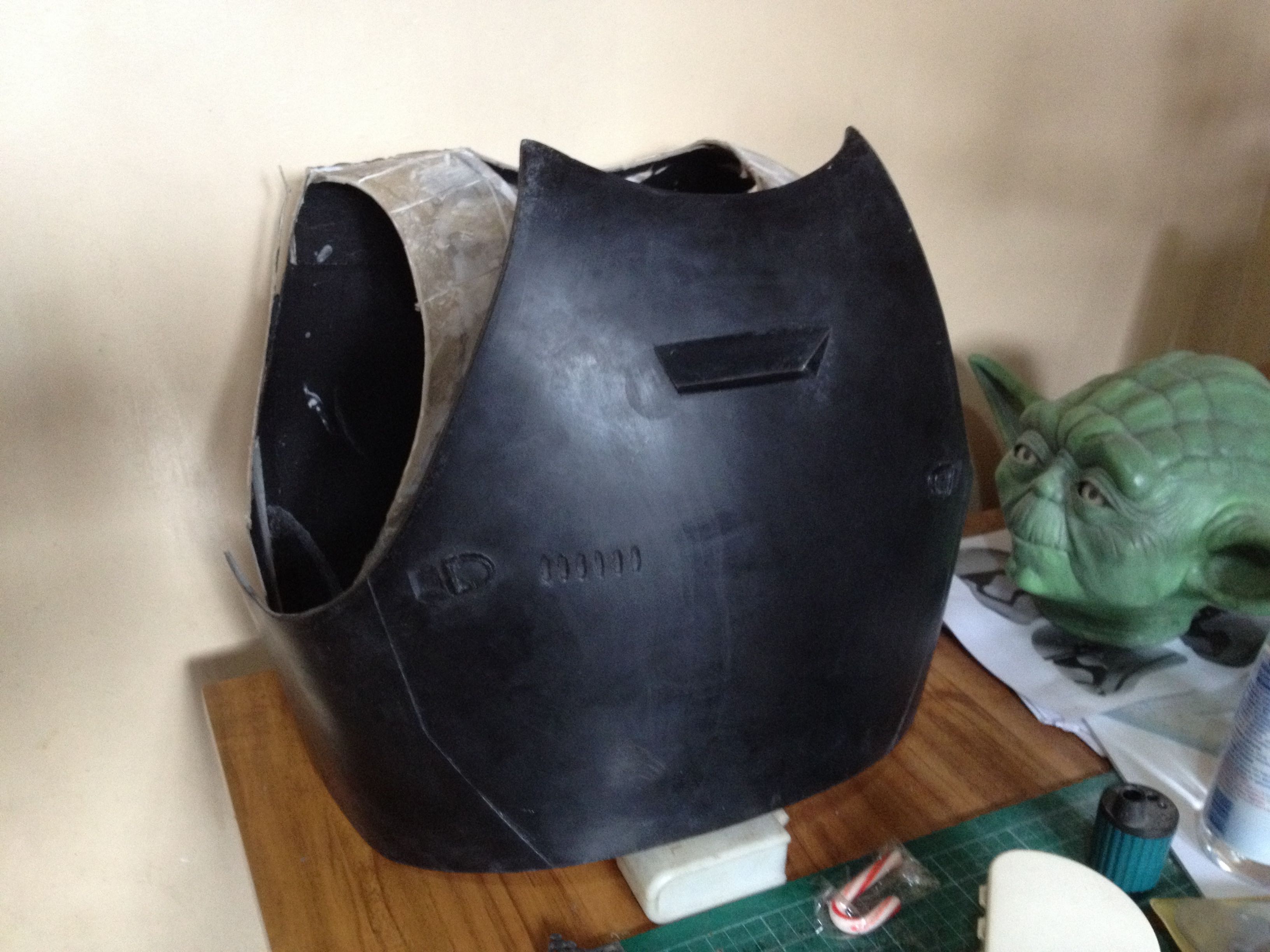

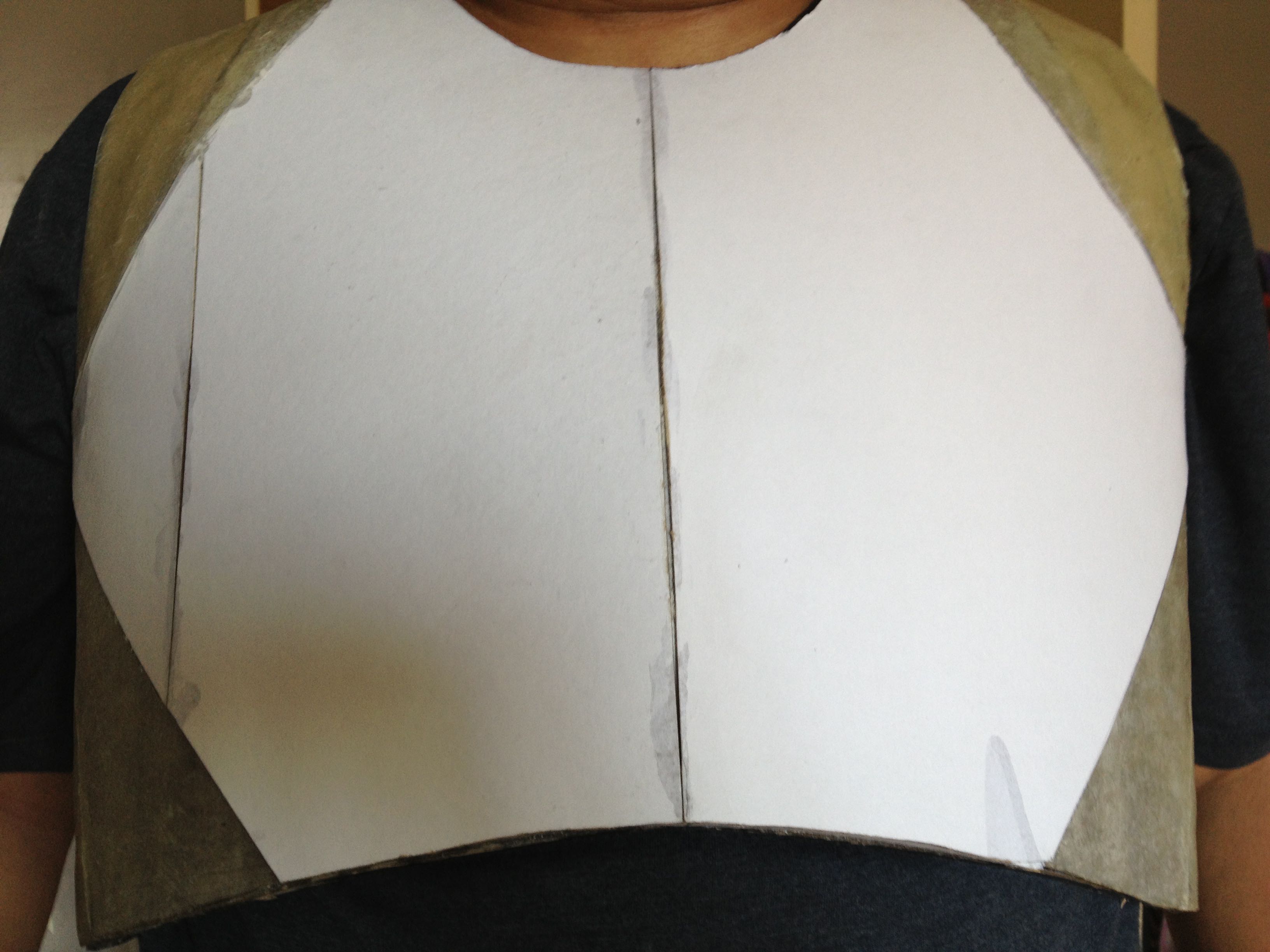

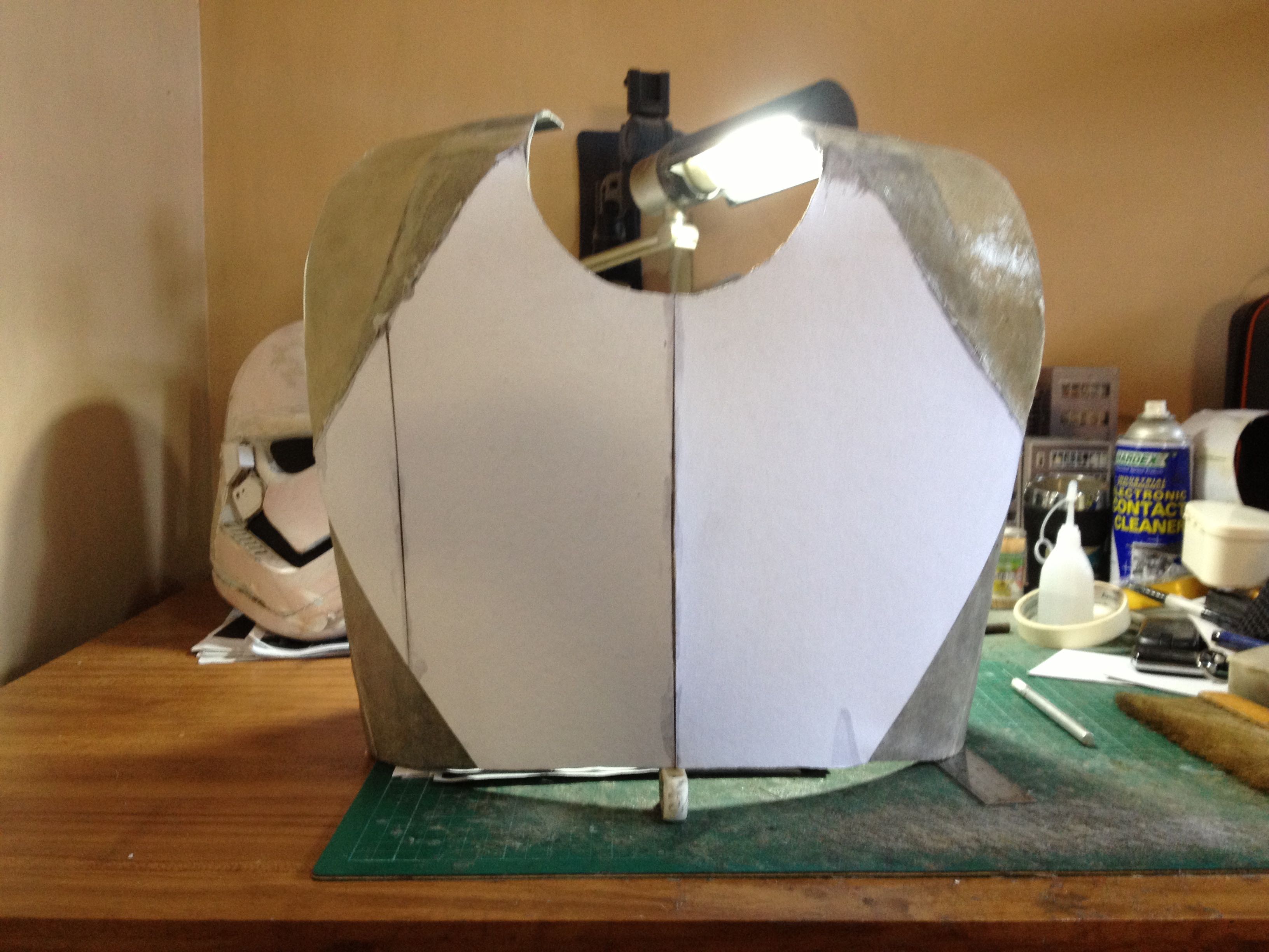

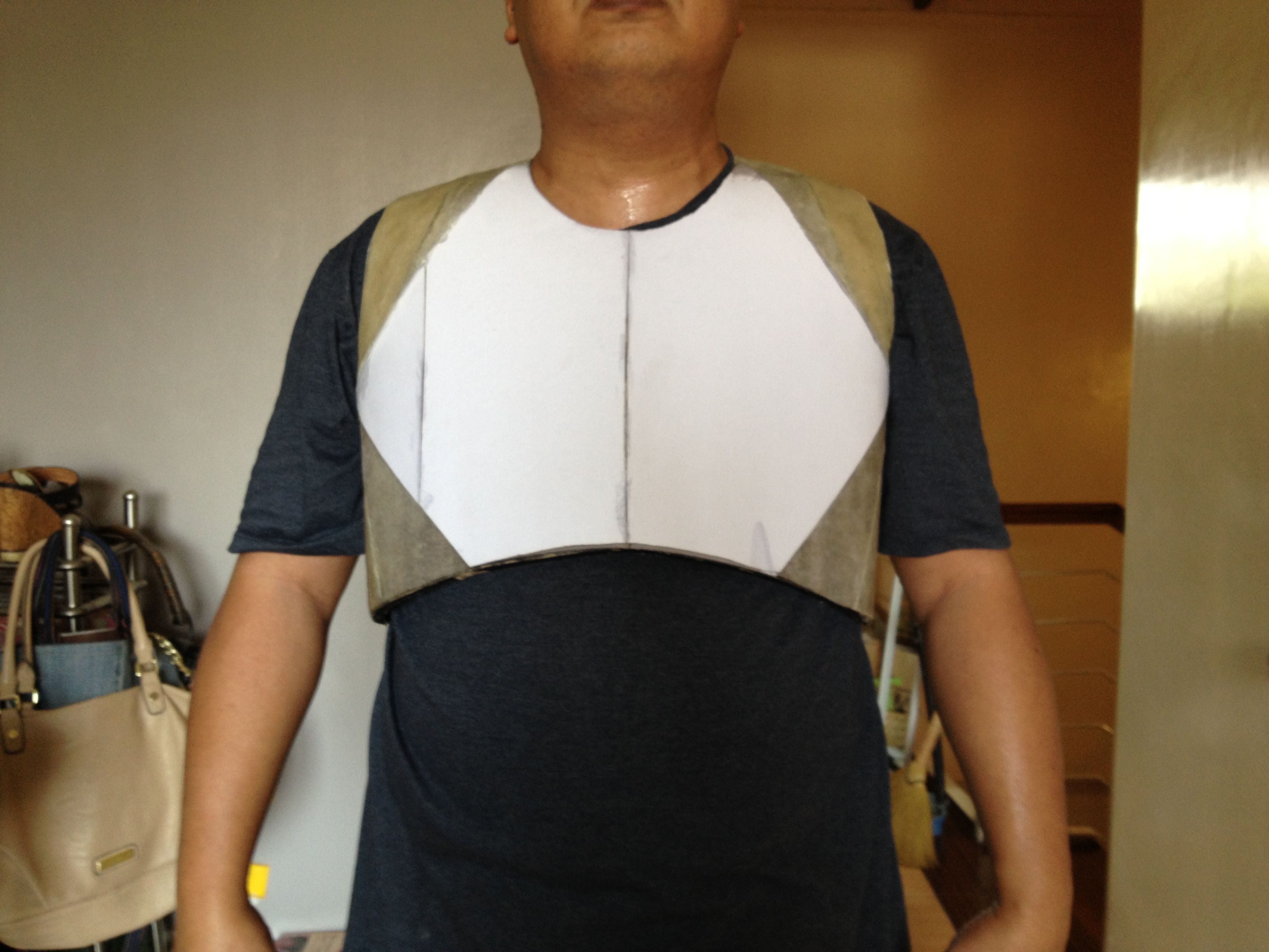

    Having constructed the helmet, I thought I'd try and venture into making the armors......
    I started off with thin card (illustration board) and fashioned it around my chest. Measured, cut and applied thin fiberglass to hopefully hold its shape. When dry and hardened a bit, I added thin card to make details and will add bondo when done.
    As a base for the back plate, I plan to use a Boba Fett back plate armor and will add card to that for the stormie details.

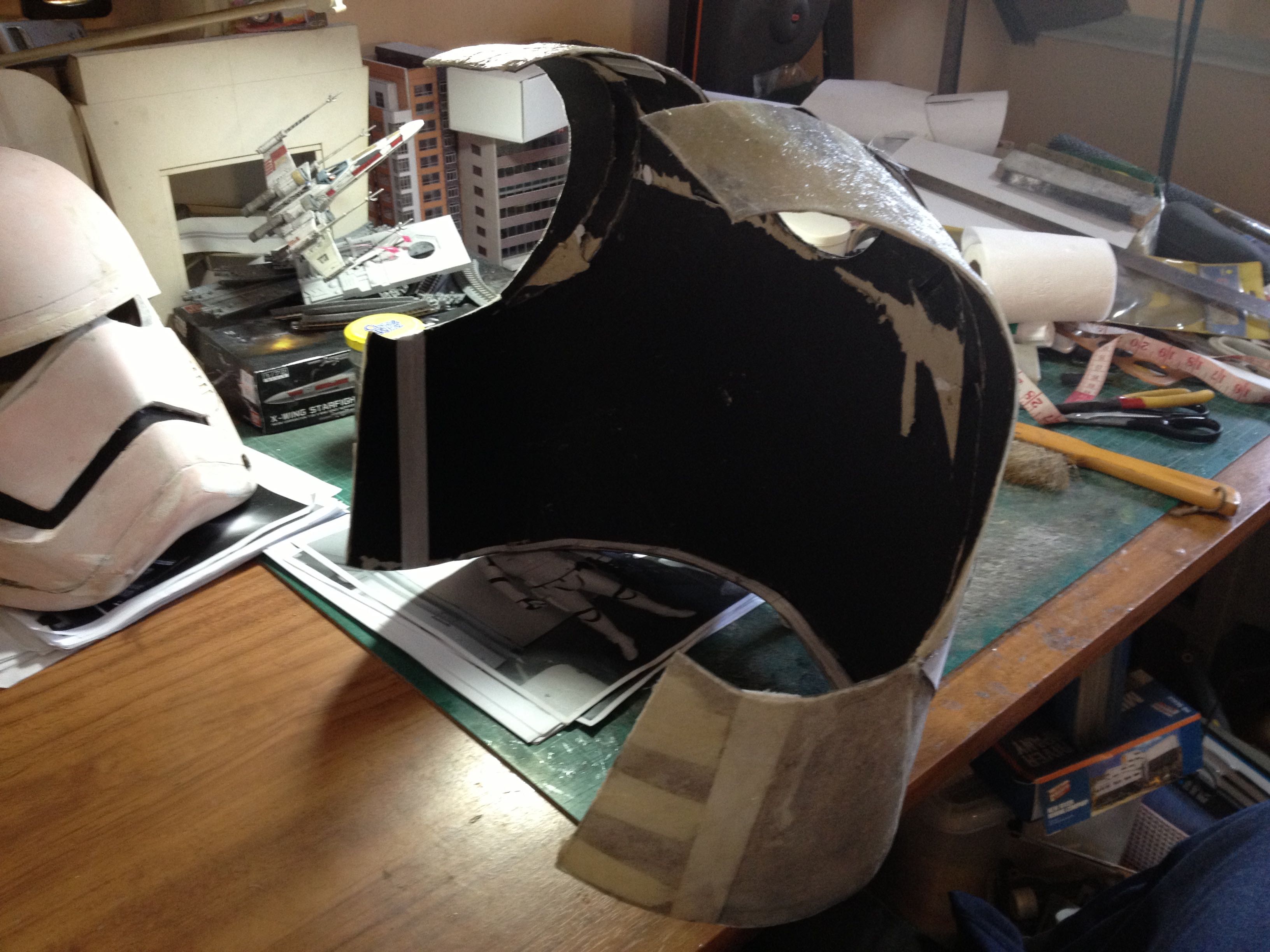

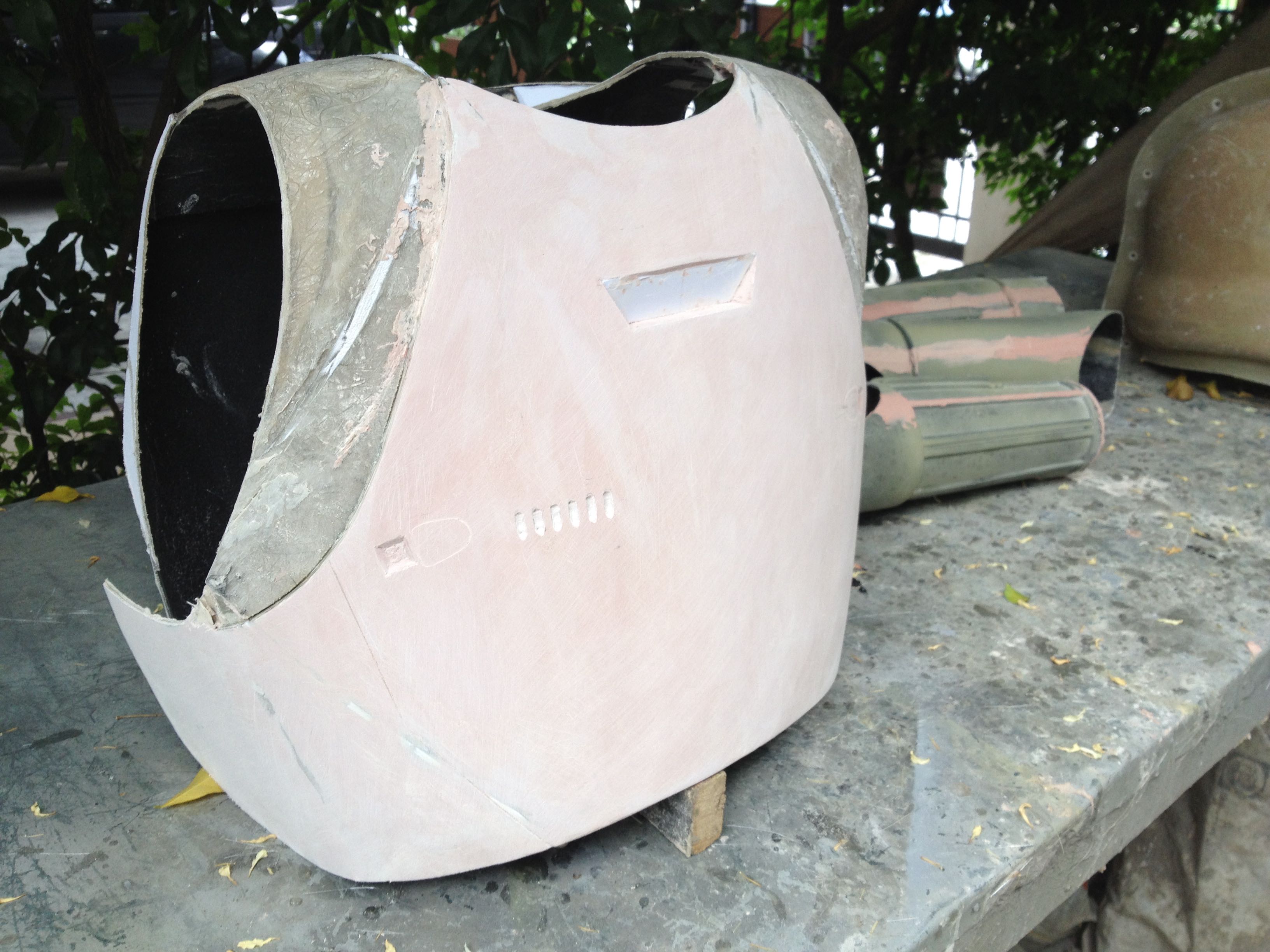

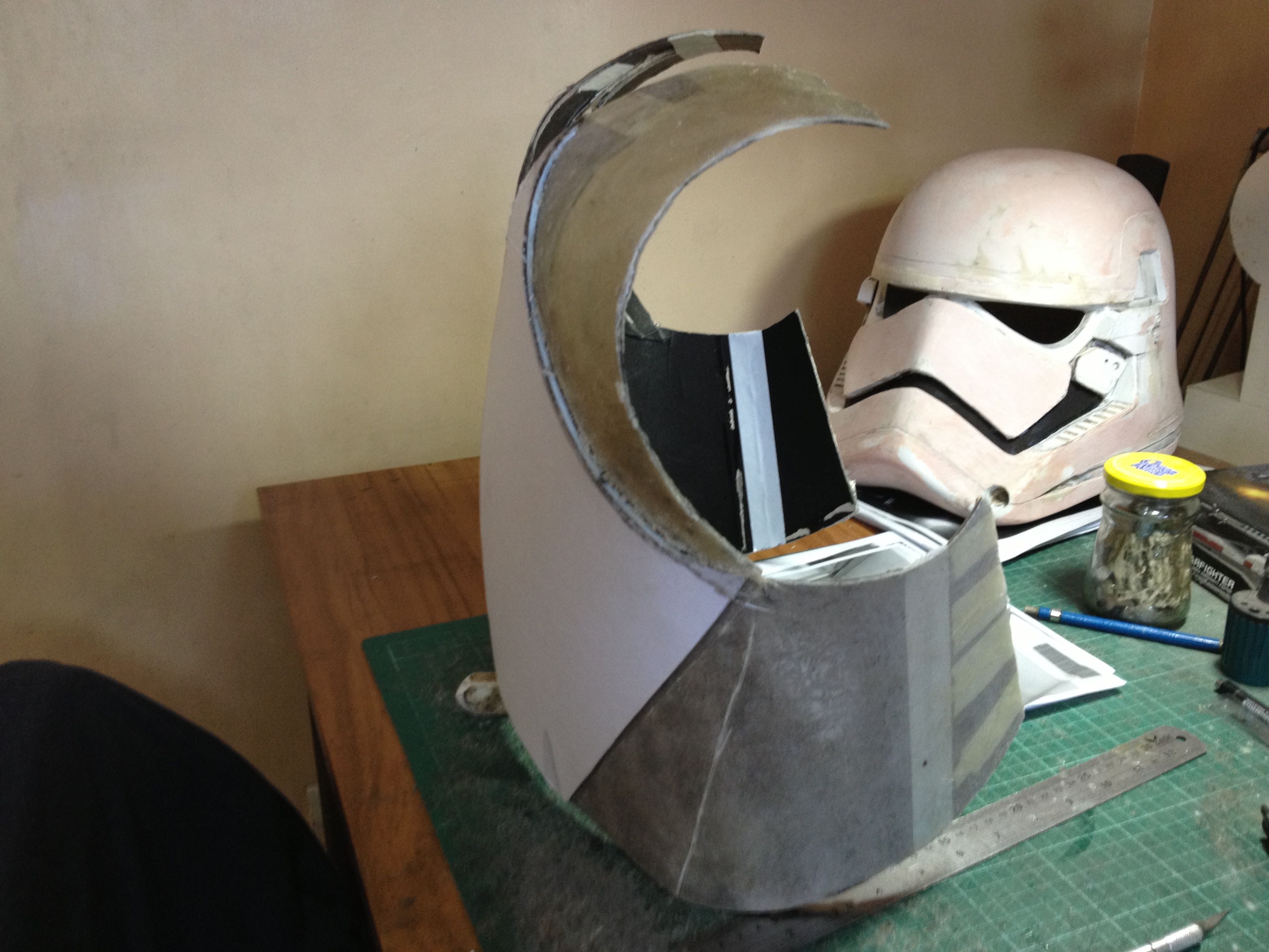

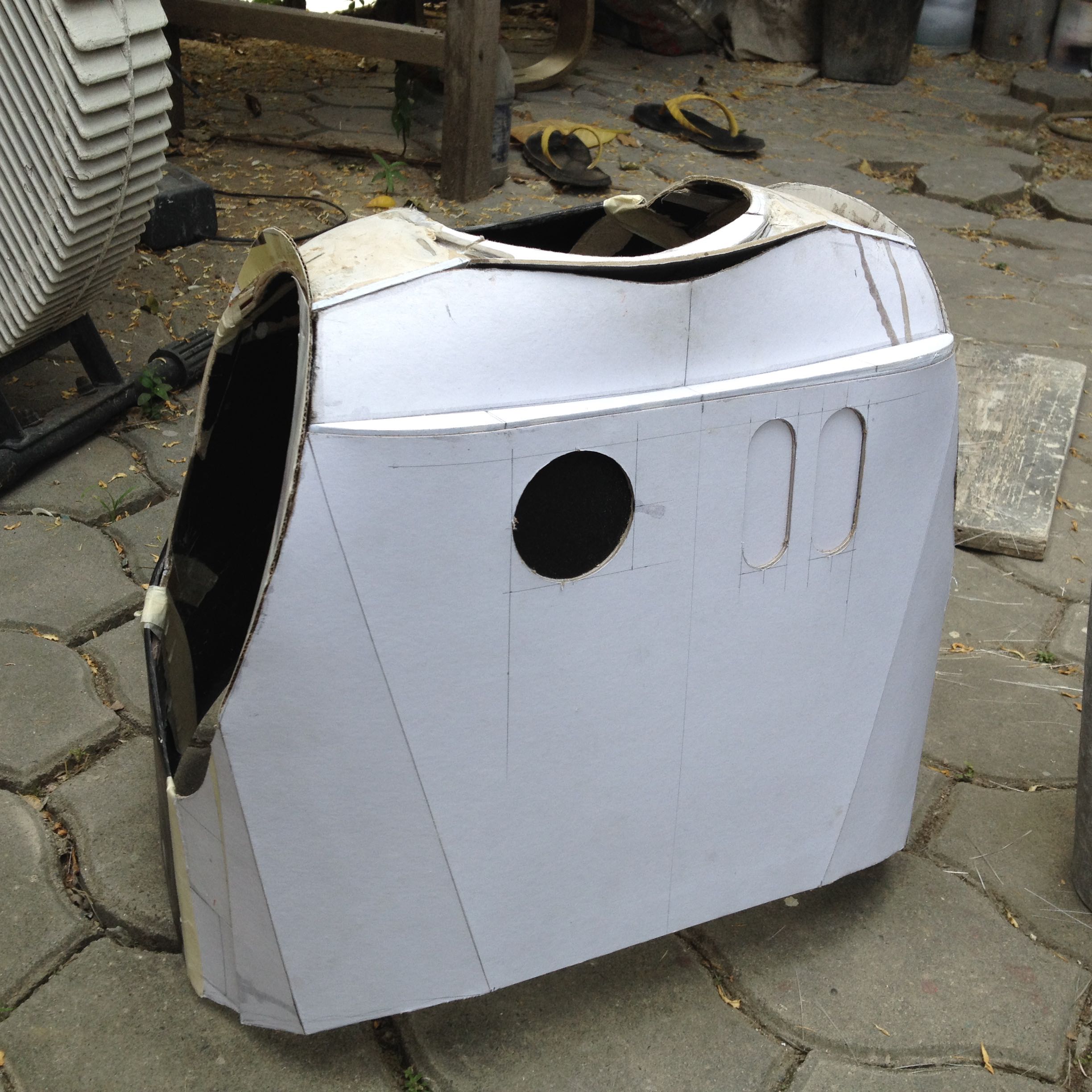

    Slow on progress but here's some WIP pics...........
    IMG_2476.jpg IMG_2484.jpg IMG_2483.jpg IMG_2482.jpg IMG_2481.jpg IMG_2480.jpg IMG_2479.jpg IMG_2477.jpg IMG_2485.jpg
    All upper body armors for now. Im trying to have the front chest armor done so it could be separated from the back armor. Once separated, I could then built-up the back portion sides to meet up with the front. With consideration to the ab armor and thermal det naturally.
    Does anyone know how both the front chest armor and back sides connect? Is it same with the previous tk ab armor of shim/* with velcro?

    I believe the front and the back are one piece, here's a photo with the Anovos casting

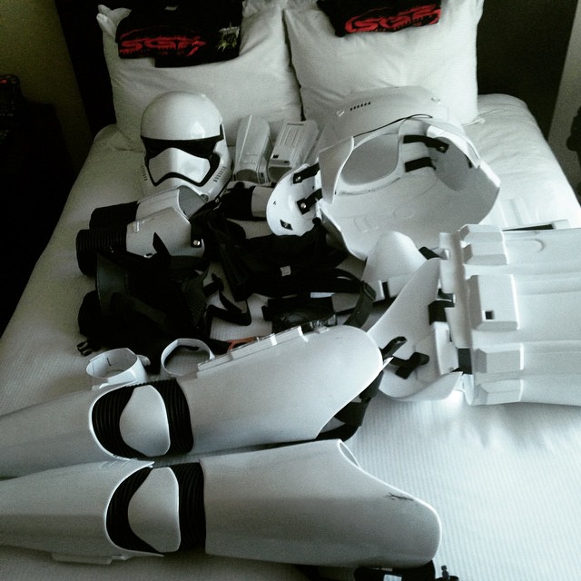

    Thanks for sharing Steve. However, these 2 pics I got from whitearmor.net suggests both as separate pieces.
    18805_1811570095735012_8711779318945694700_n.jpg post-22799-0-04751600-1430288206_thumb.jpg

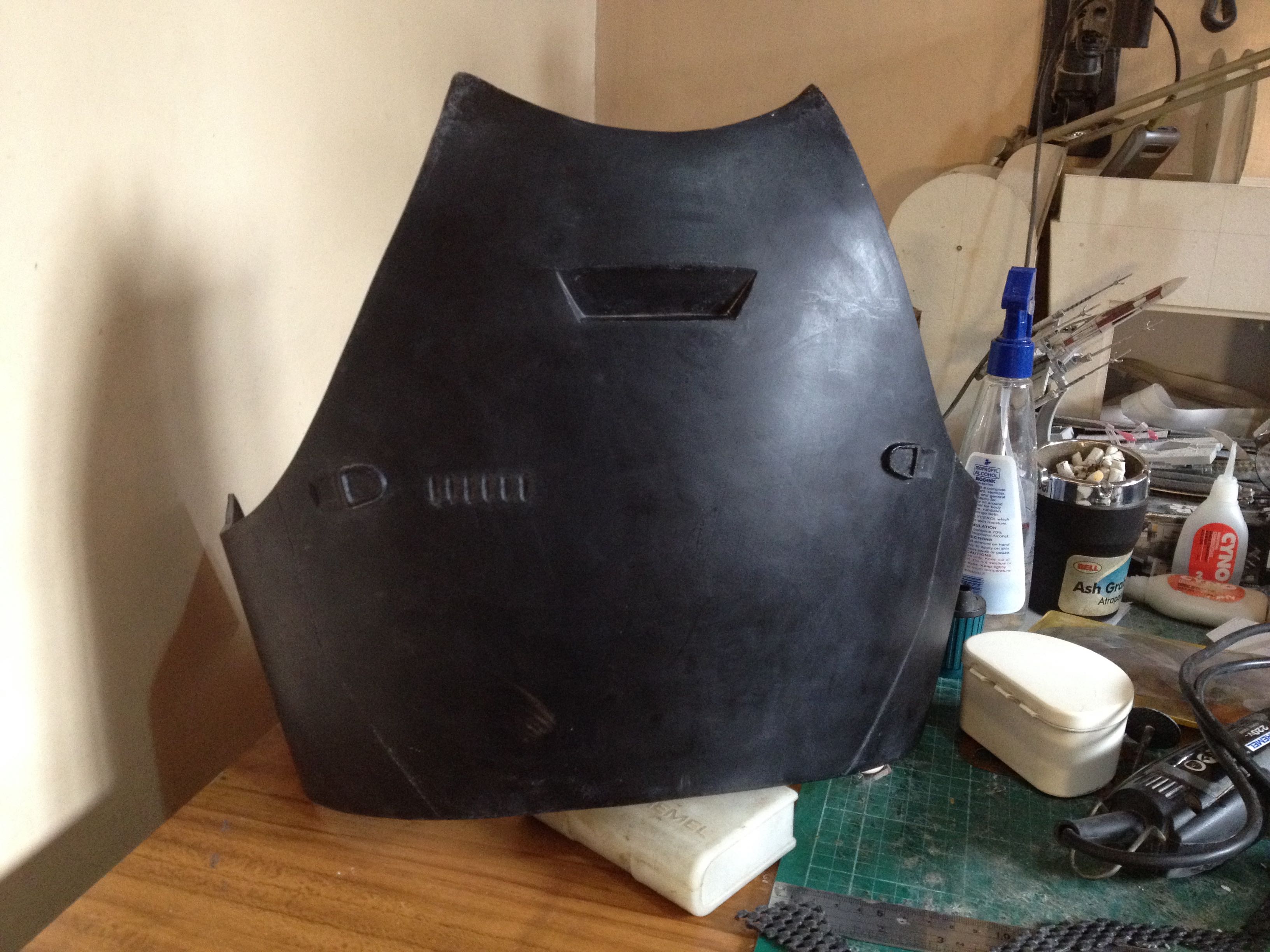

    I could be enticed :)
    I finally had the front chest piece molded and have pulled a fiberglass copy off it. From there, I could slowly build up the back armor and check the alignment for mating front & back armors.

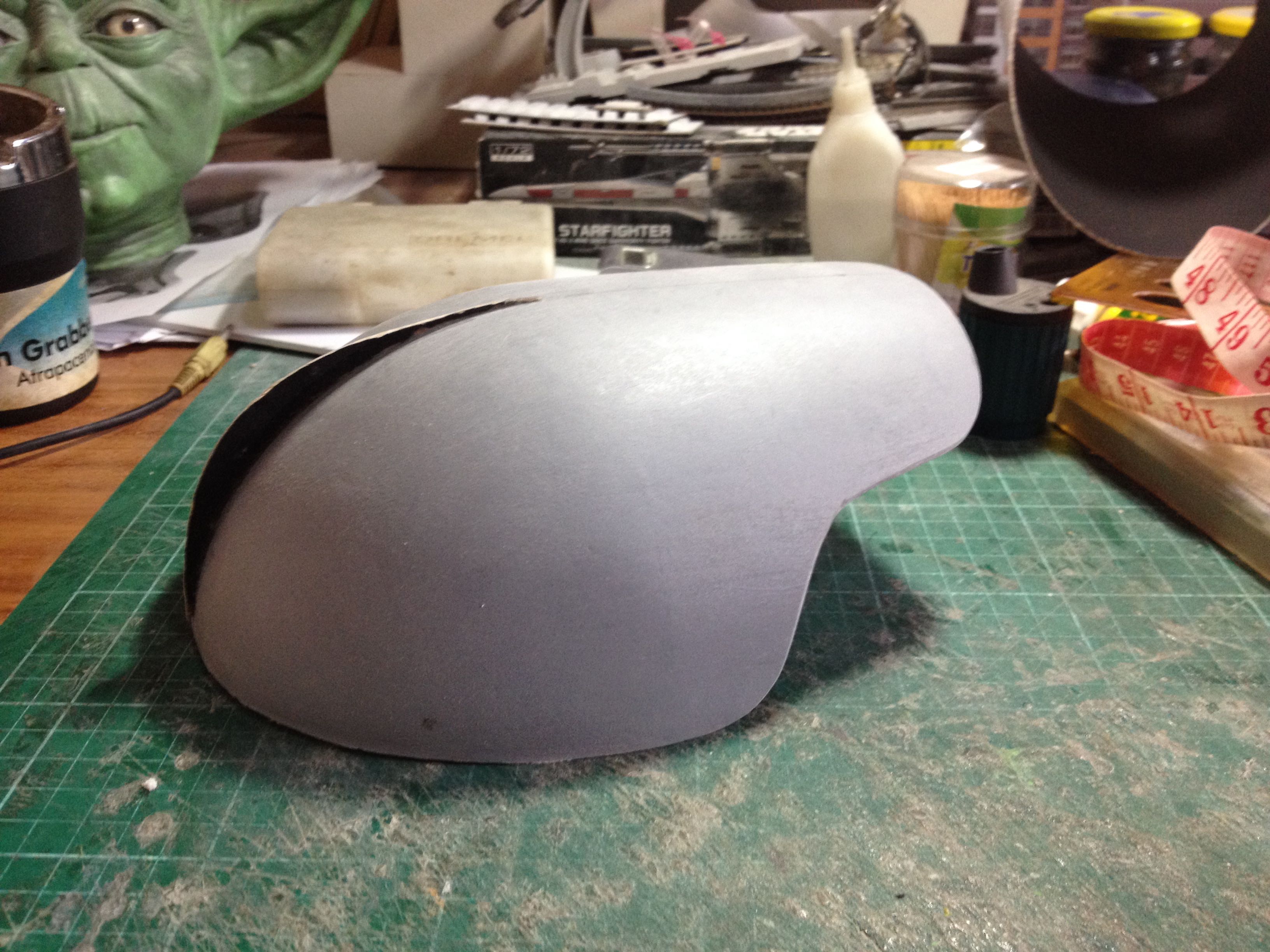

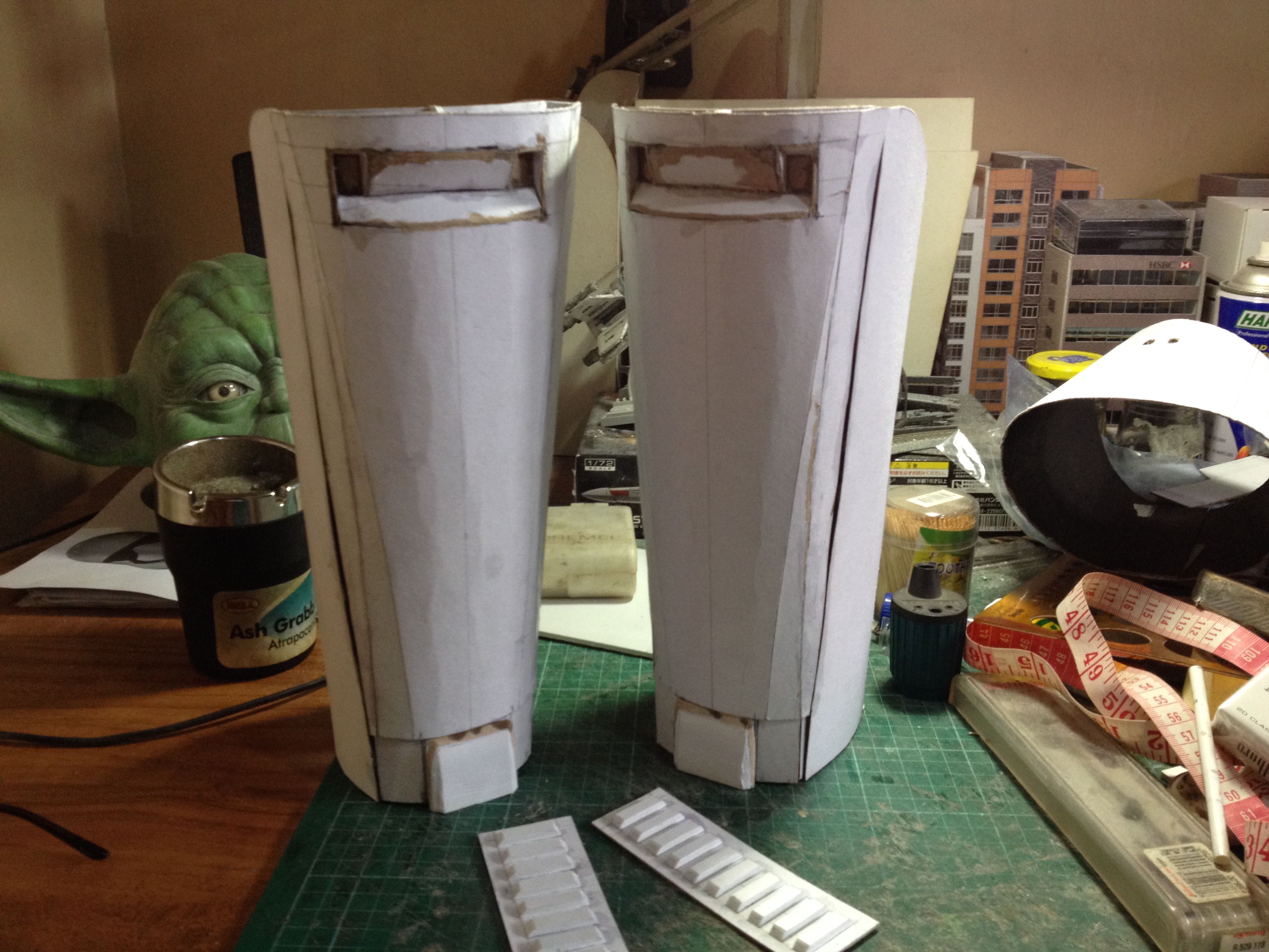

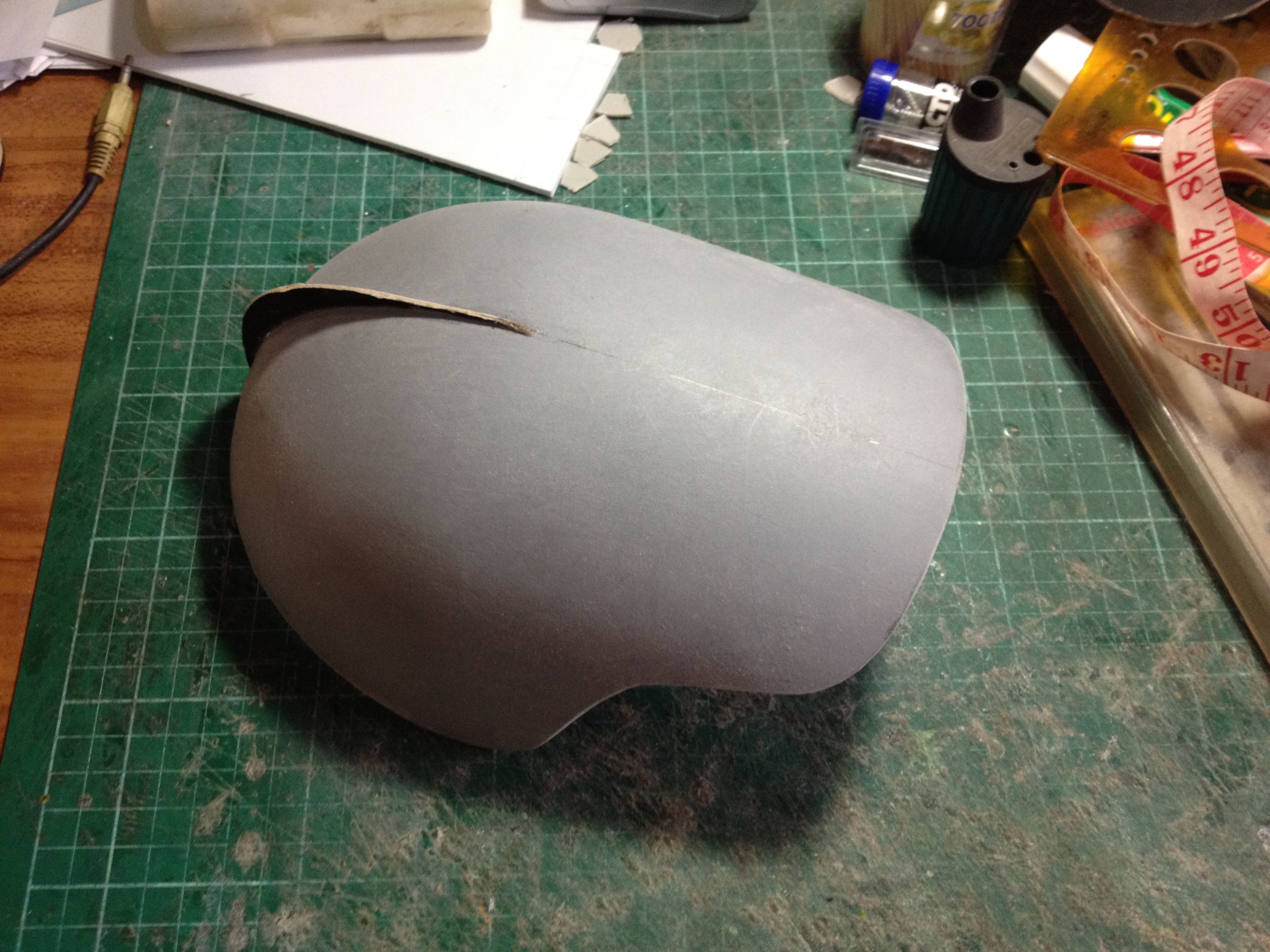

    Small update........

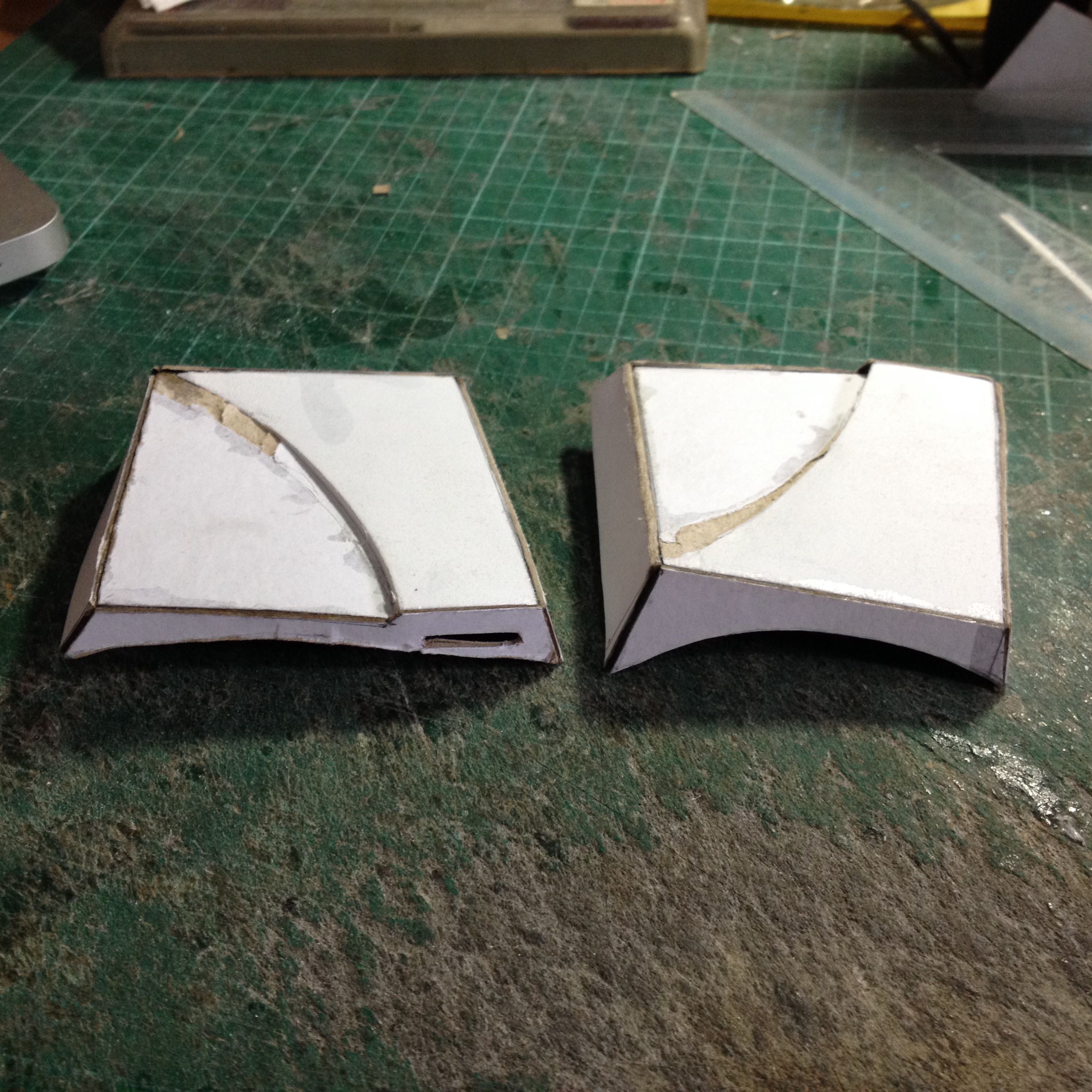

    Shoulder bell mold done and pulled off 2 fiberglass bells. Card handplates and card thermal detonator done.

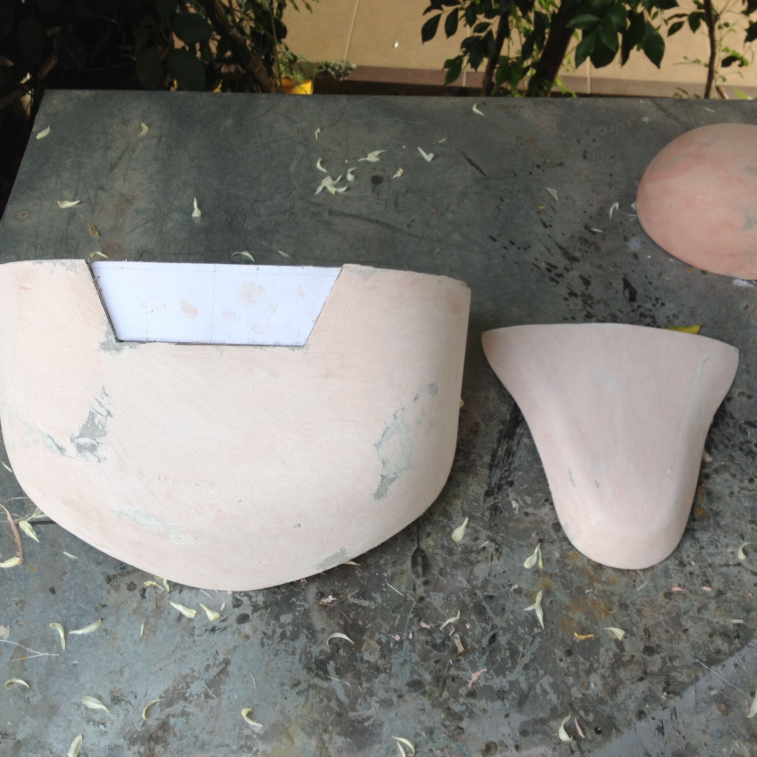

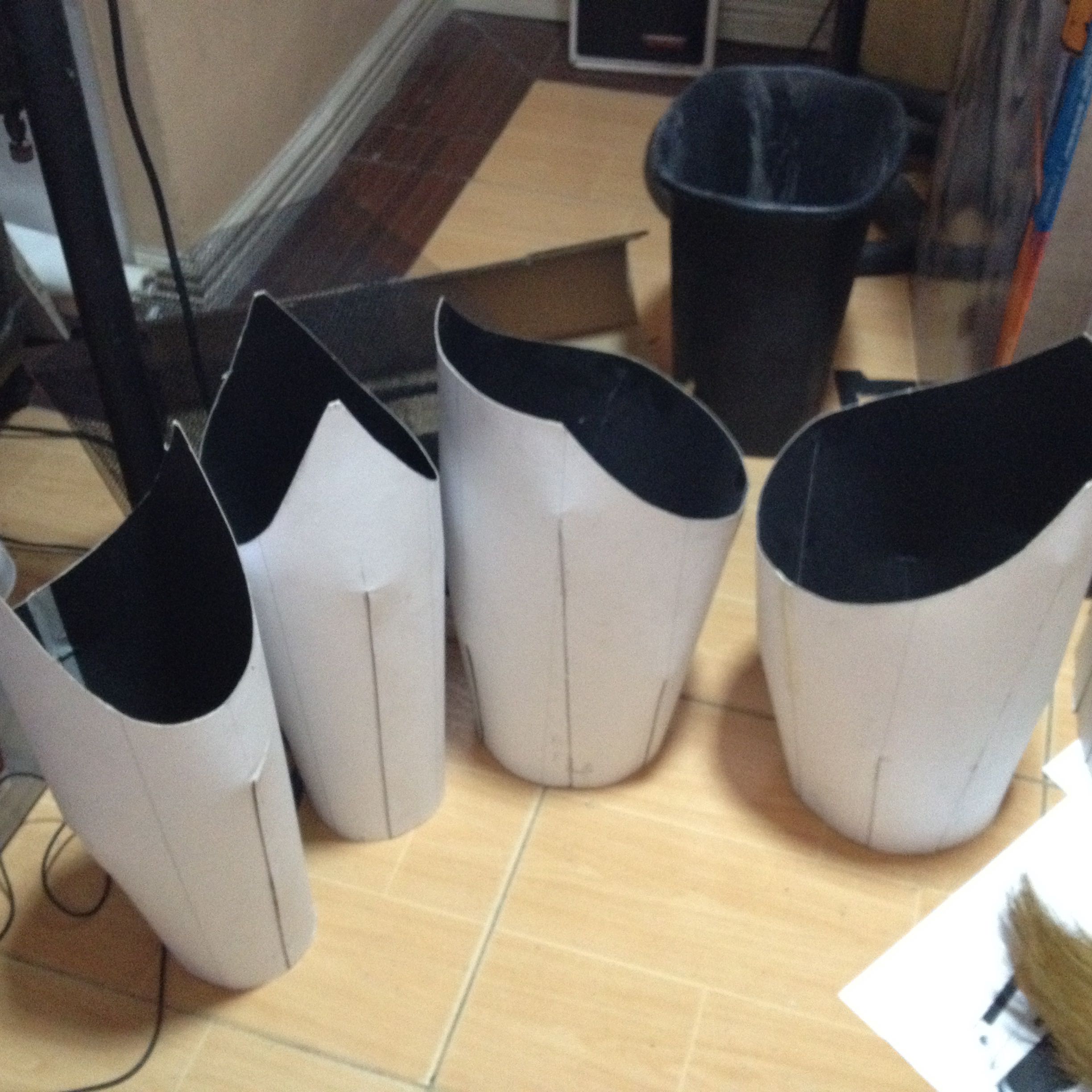

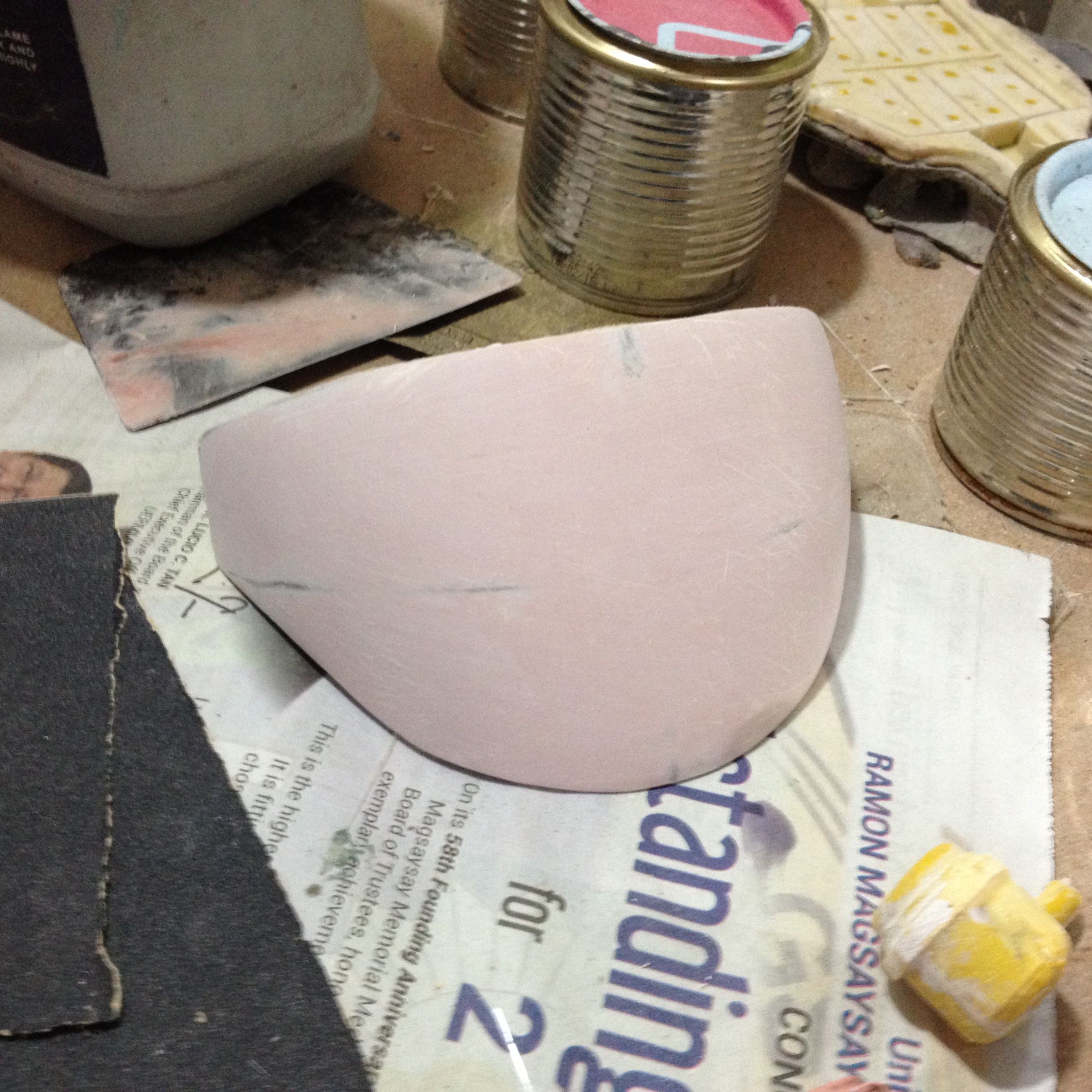

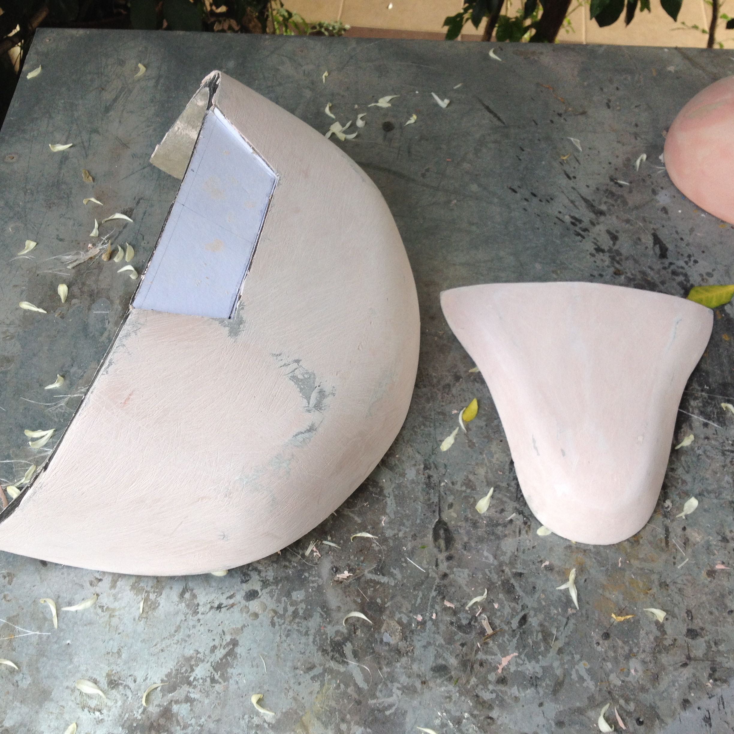

    small WIP pics.......

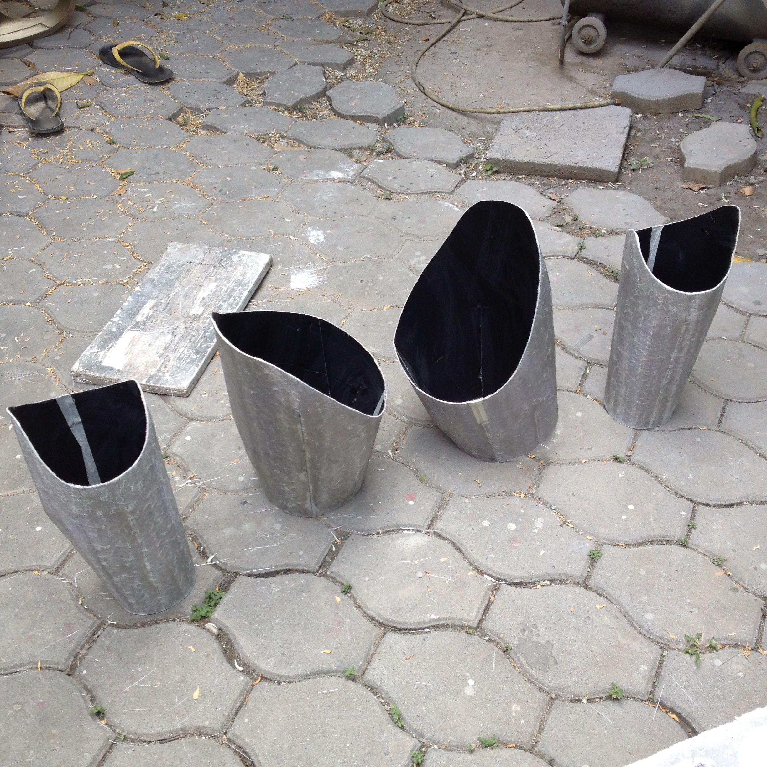

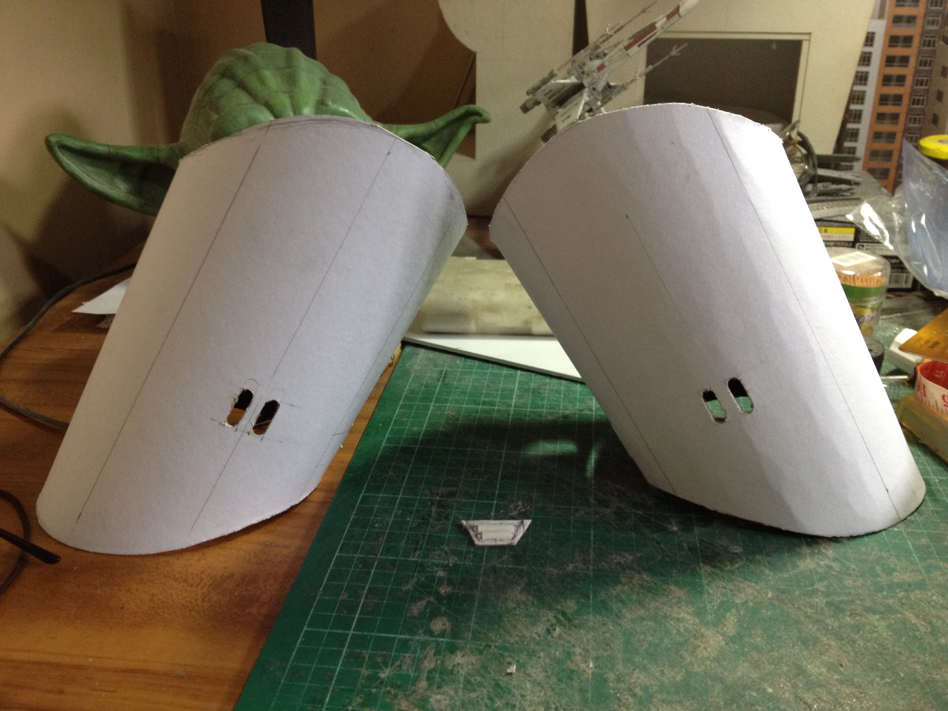

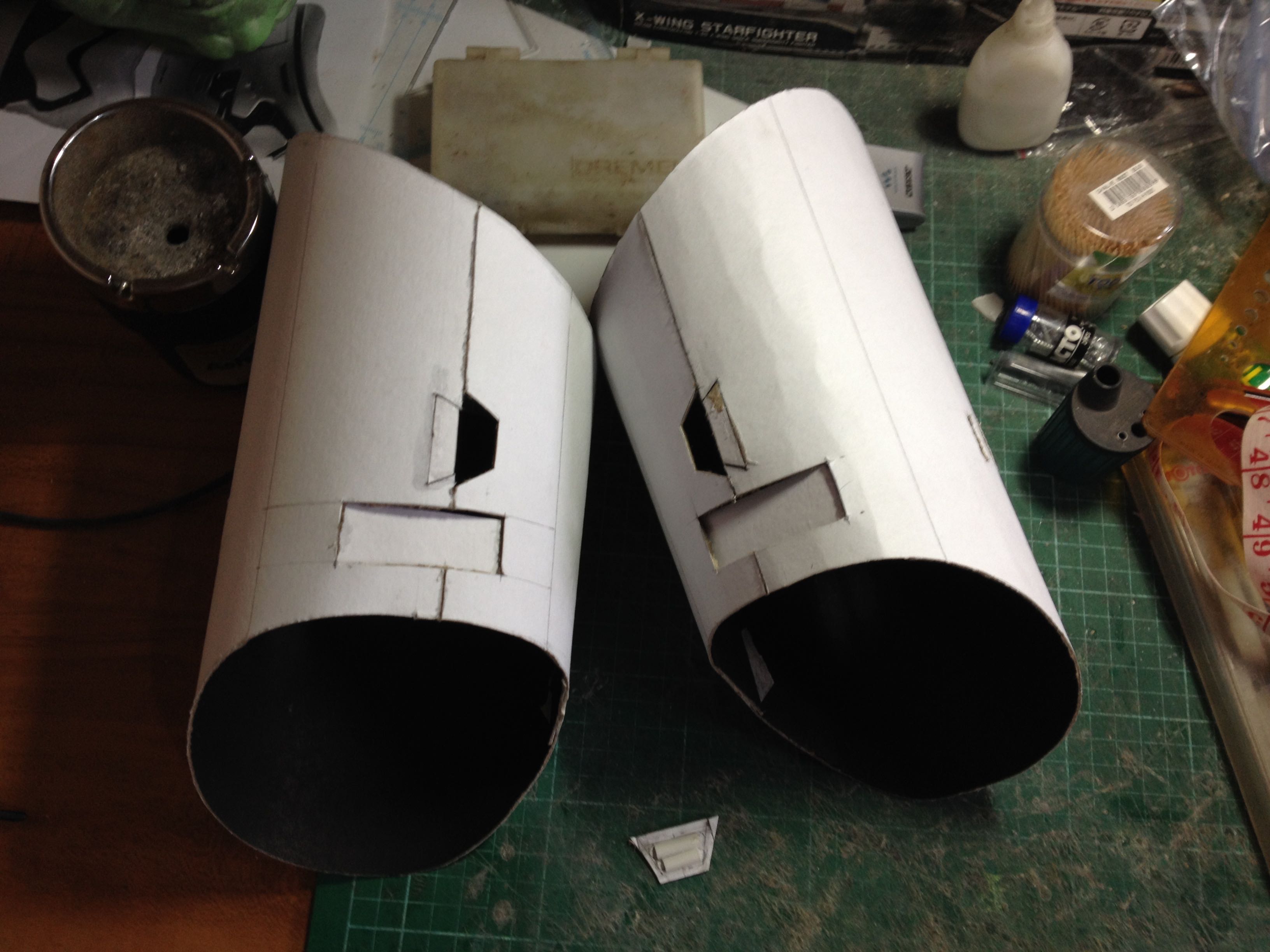

    Butt and Cod getting bondo work. Thighs and shin cardboard shells done.

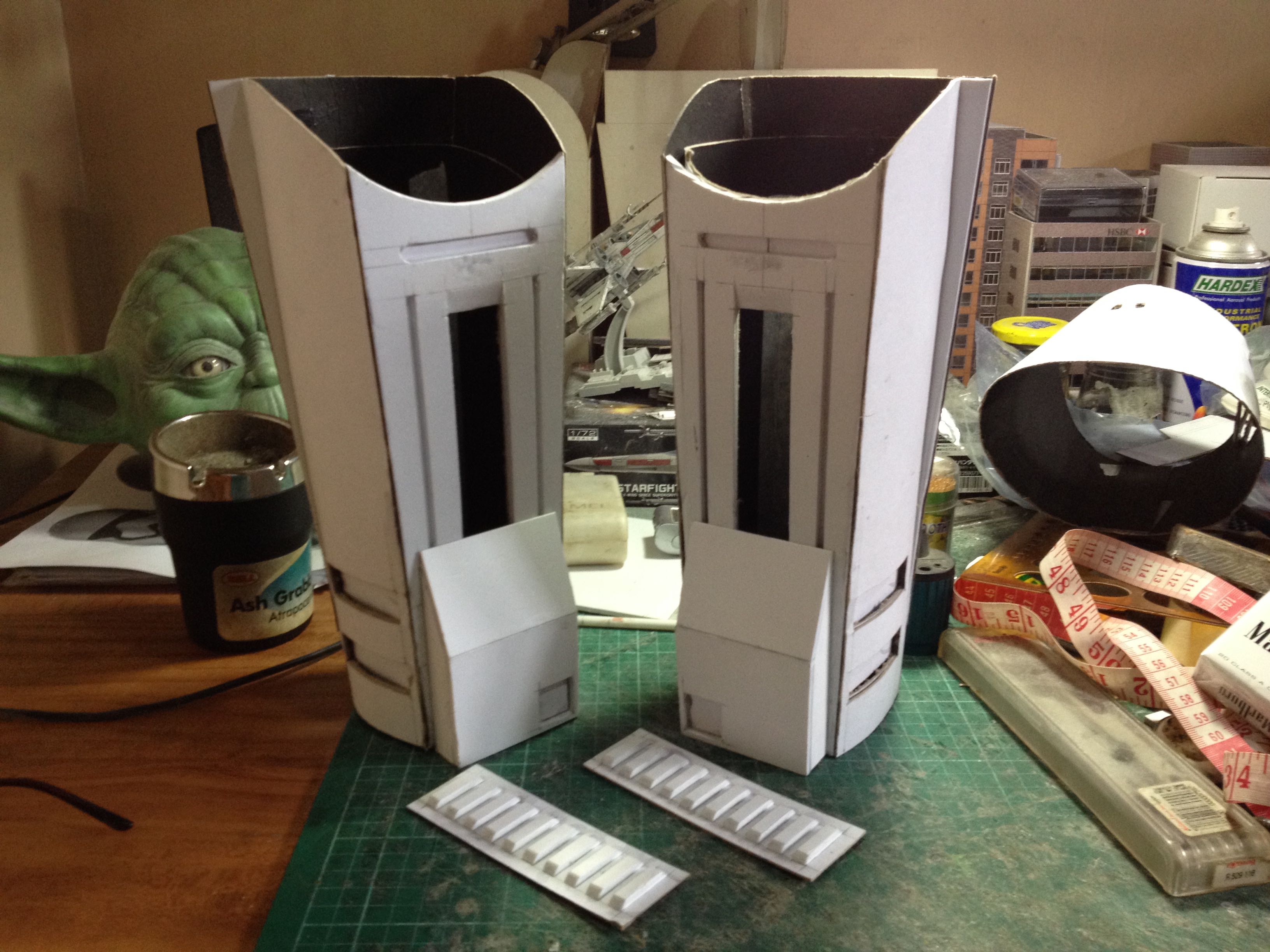

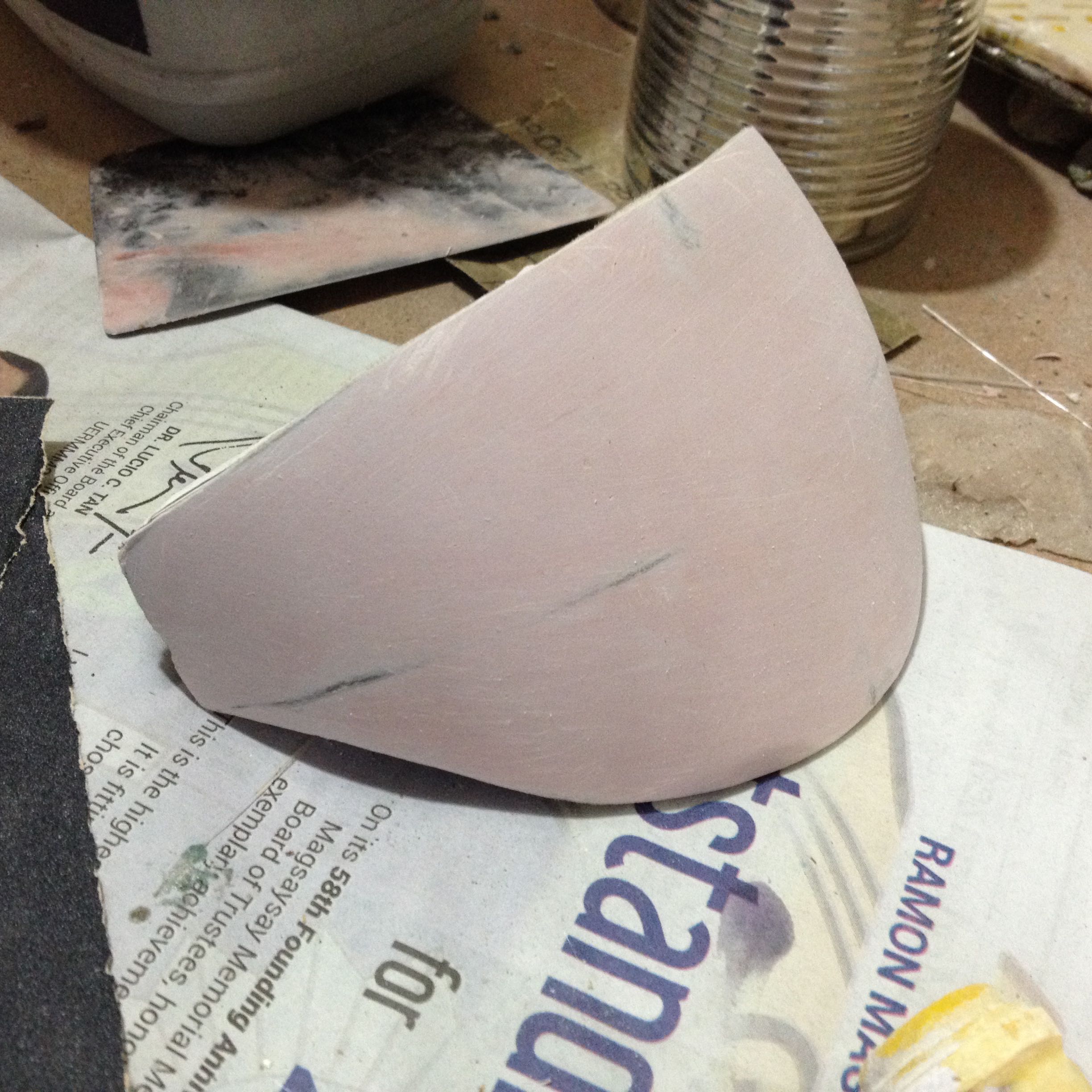

    Toddo - Thanks! Remind me and I'll weigh it. Im actually curious too and in the 12yrs of doing props never did I get the chance of weight except for the helmets.
    Dave - sure! Just let me know what you need later on once the forearms and the handplates are ready for bondo then it will be molded.
    Small update.........
    Knee plate done and ready for molding. Card thighs and shins have been fiberglassed over to hold its shape and bondo begins by next week. Back torso armor will get some fiberglass as well to retain shape then bondo. I was thinking of making the ankle spats, but thought I'd wait for the shins to be bondoed to get an accurate circumference.
    Mardon (MLC)

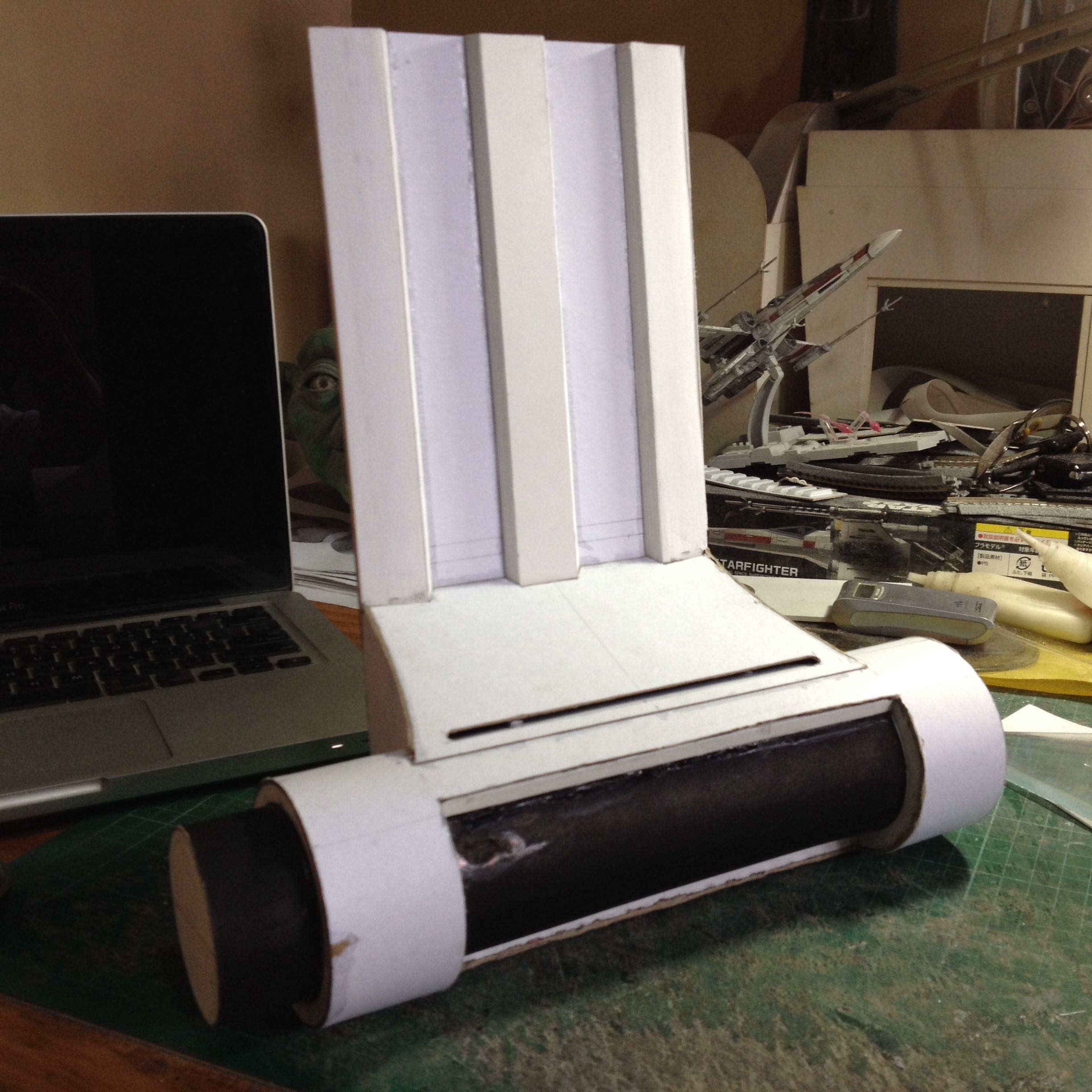

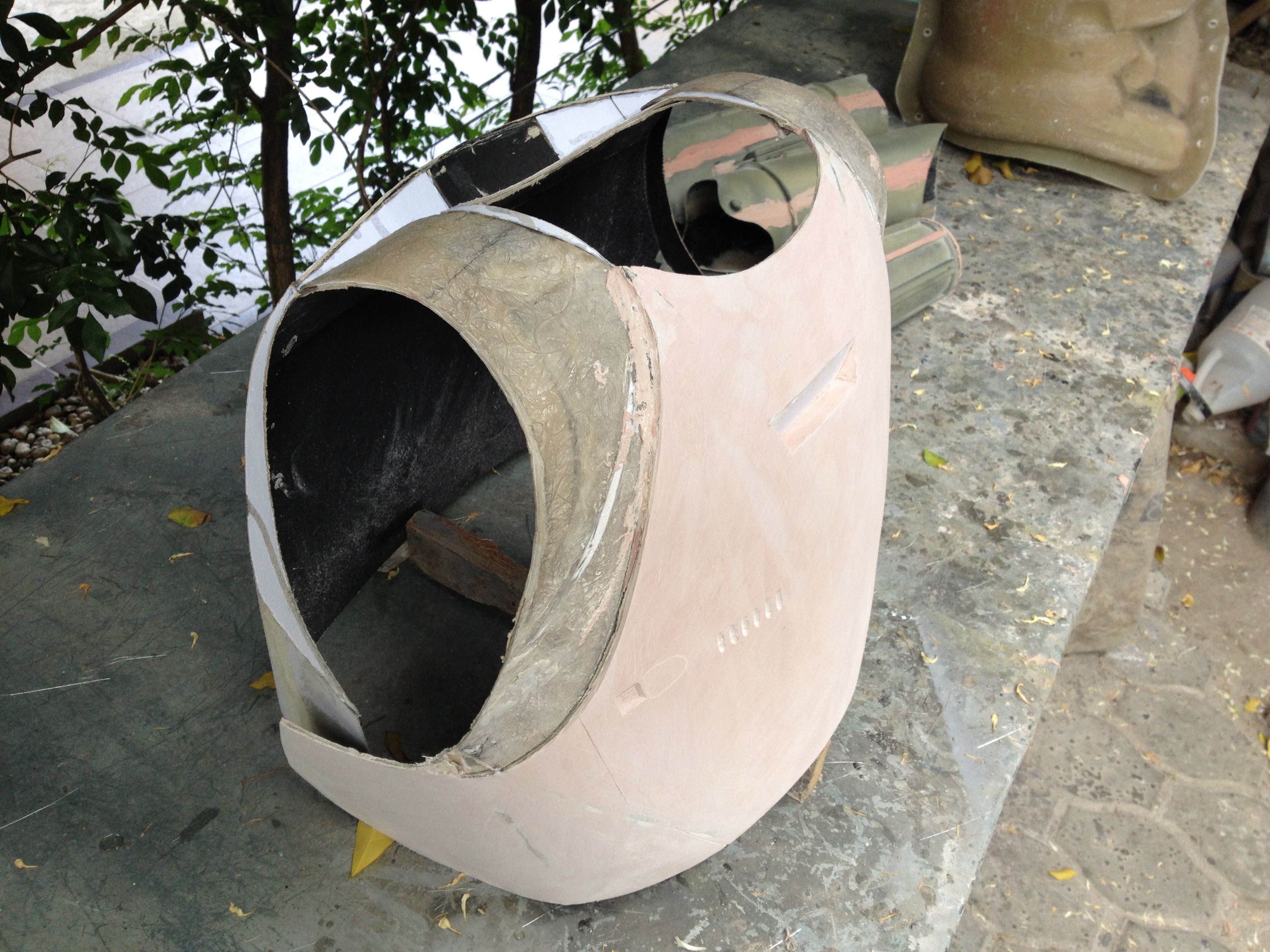

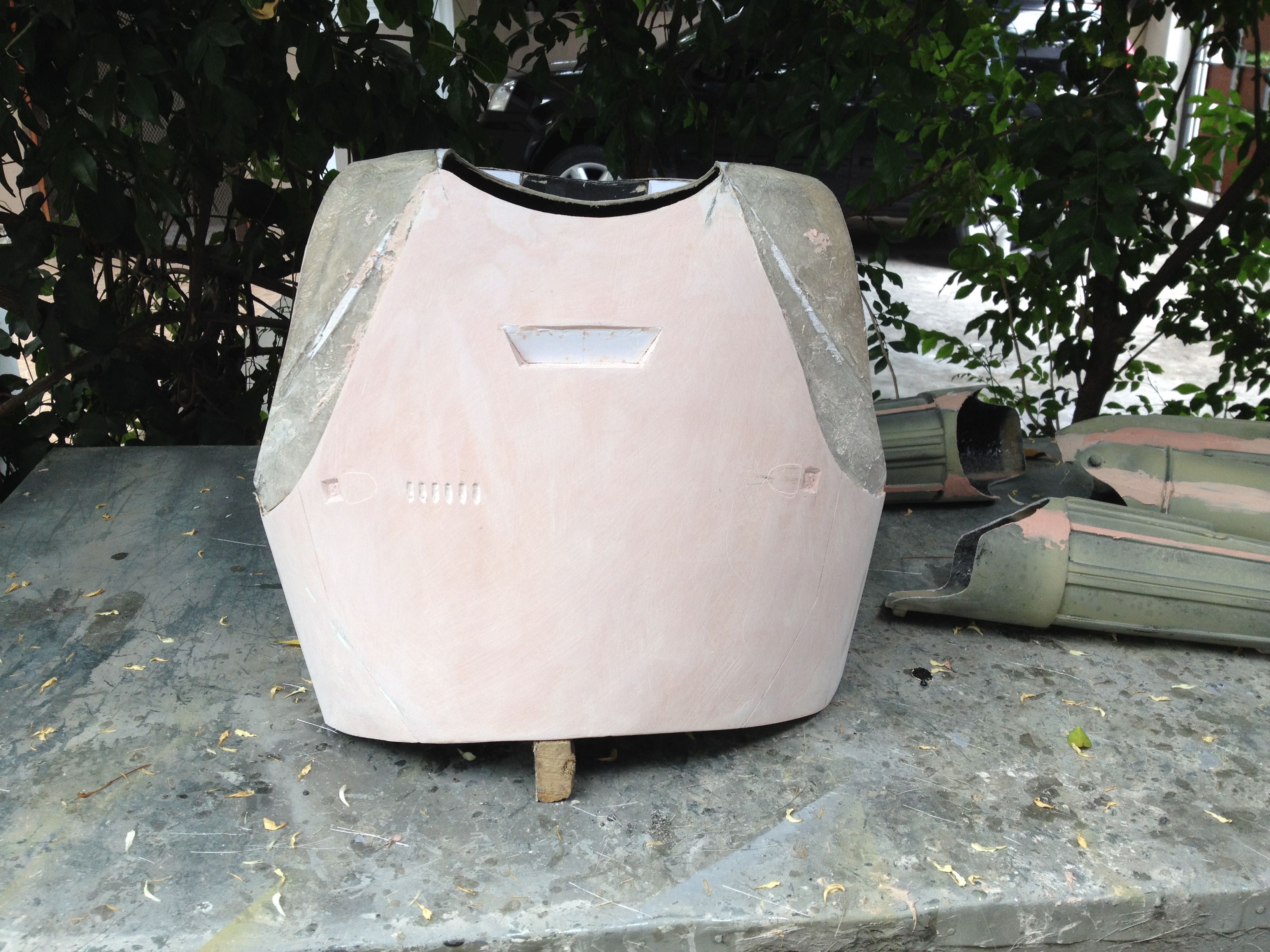

    We just finished sanding the bondo work on the yoke/back armor. We're now adding bondo to the thighs and next would be the shins. I also started on making the blaster holster(?) plate that would be added to the right thigh. I'll be in 2 parts - main bottom plate and top plate. Im still deliberating whether the main plate should be added to the thigh before molding so its part of the thigh or leave it separate. The top plate could either be screwed down or glued down but with screw heads cutoff.

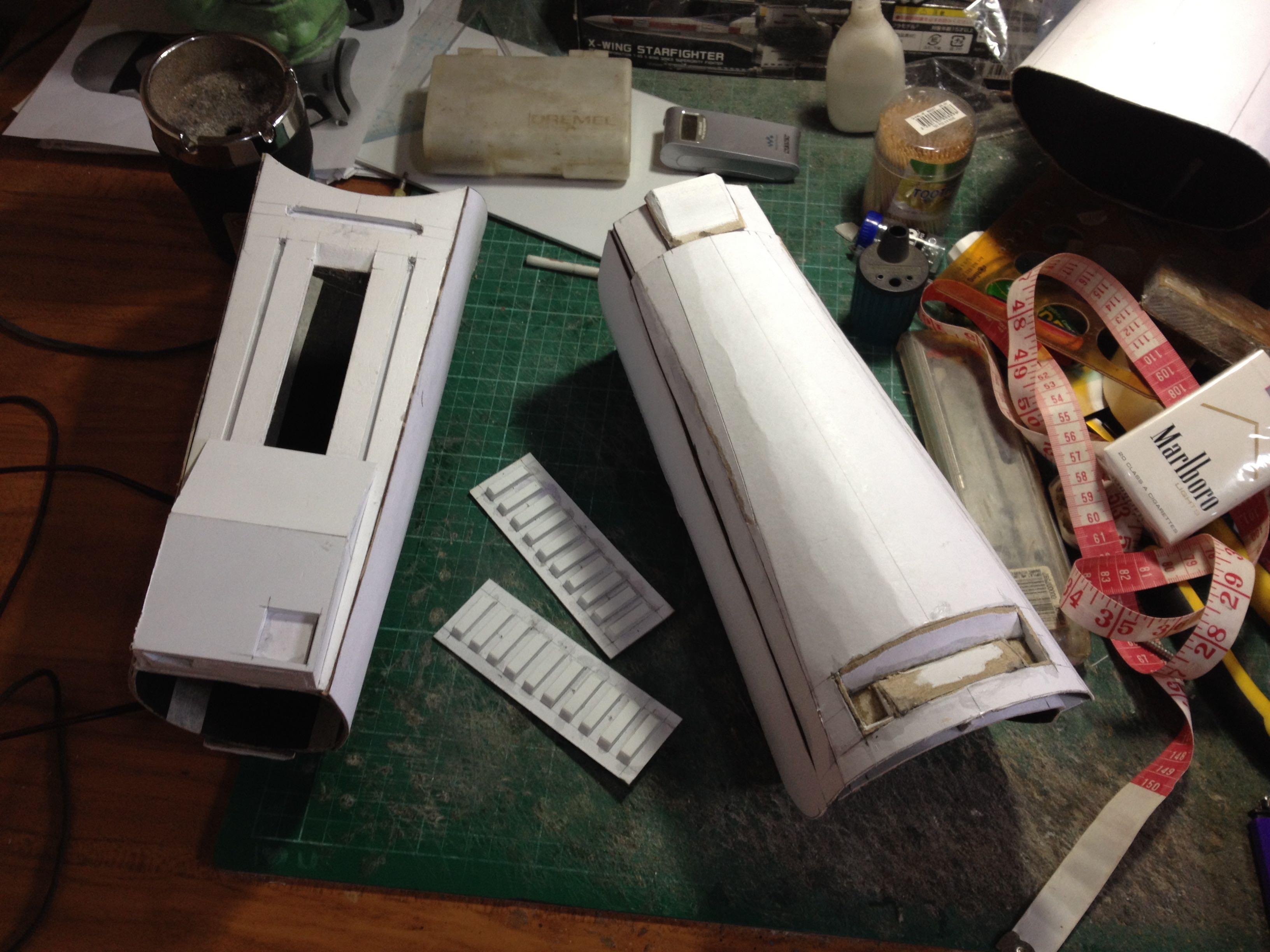

    Thanks guys!
    The thighs and the shins have been bondoed to shape and holster platform on the right thigh have been incorporated. Nothing much on the blaster except making the scope mount.
