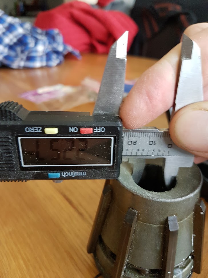

do you need any reference from the real one? Happy to send some pics and dimensions :)

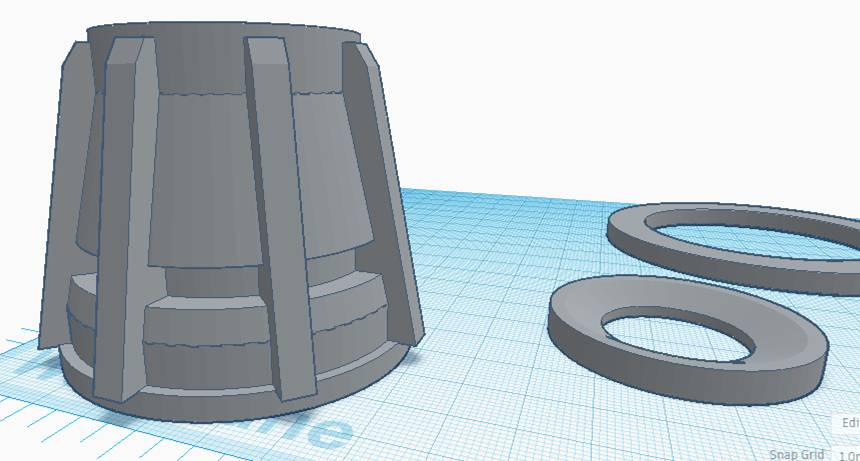

I actually finished the 3D model a few minutes ago,but whatever photos or measurements you could provide would be greatly appreciated for double-checking the model before I get it printed. :)
Kind regards, The14thDr
EDIT: Here's a screenshot of the completed model for visual reference:

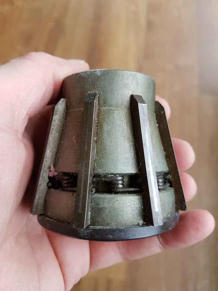

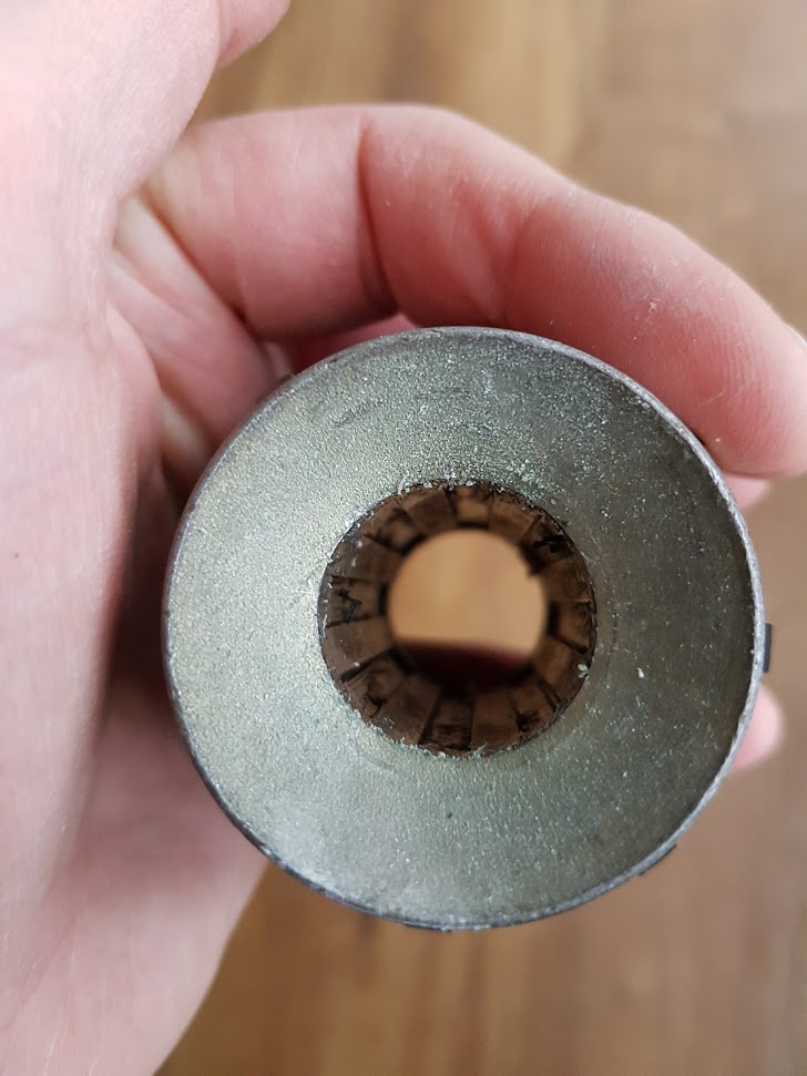

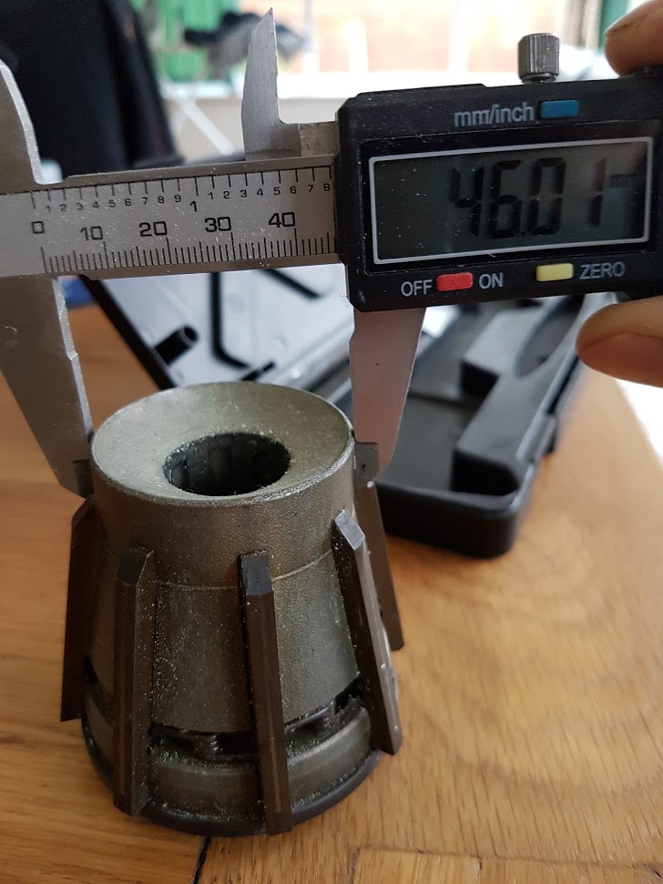

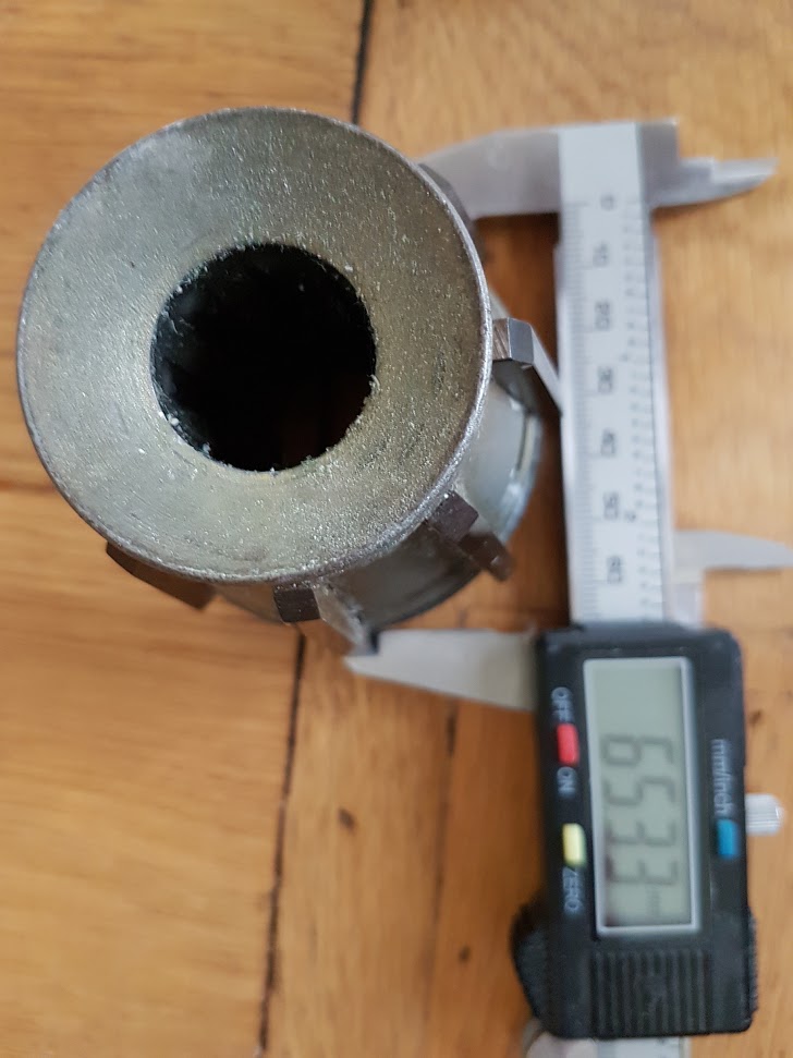

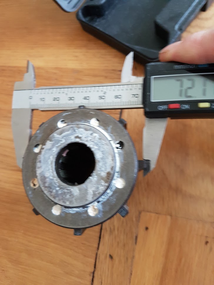

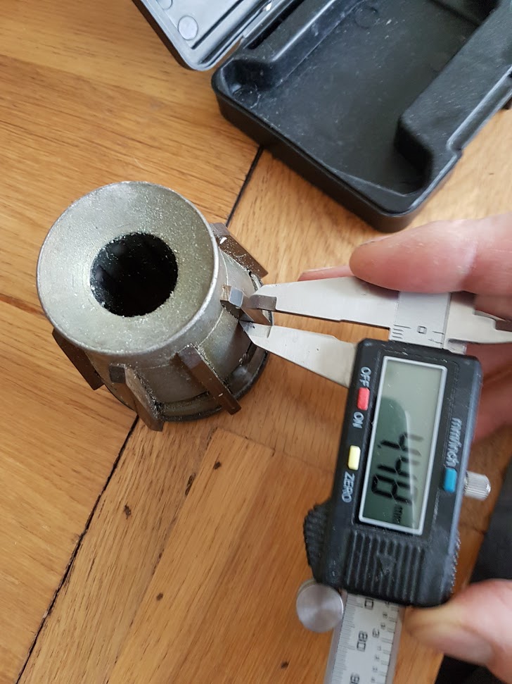

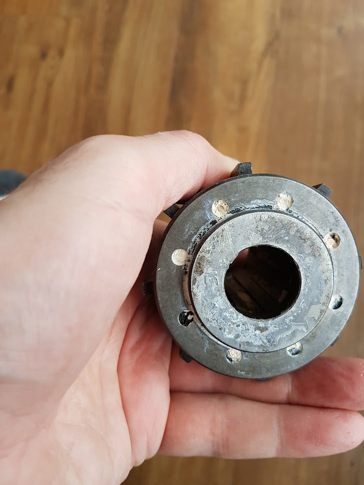

Here you go interested in a copy of the file if your sharing ? :) might adapt it to use on a staff
20161230_123707.jpg20161230_123736.jpg20161230_123754.jpg20161230_123805.jpg20161230_123824.jpg20161230_123843.jpg20161230_123846.jpg20161230_123848.jpg
Thanks judgedredd, these are fantastic! Amazingly, it turns out I was only 1mm out with most of my measurements, so I'm counting this as a win.
I'll be uploading the files to Thingiverse very soon, and I'll share a link once I do.

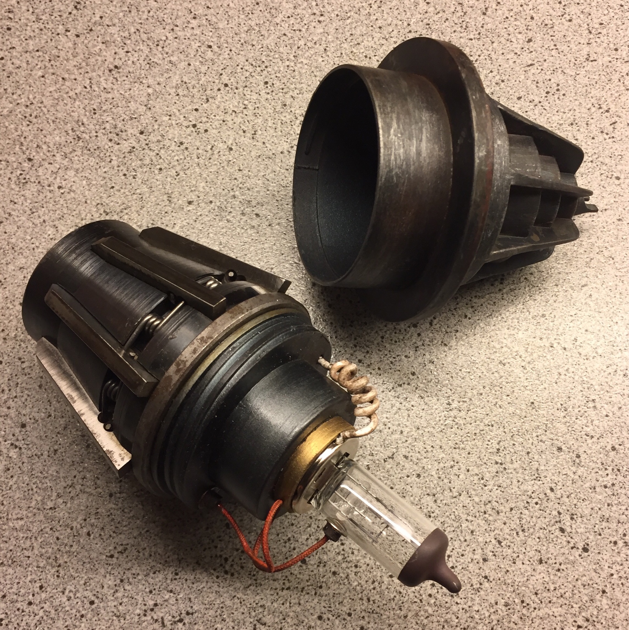

first i gently sanded the surface, going round, so that I got a texture that looks kinda like made on a lathe. I gave it silver first and Citadel Chaos black on top. I then gently went over the surface with a cleaning sponge working my way down to reveal some of the silver. I also added a very light coat of transparent blue. and finishing with some dry brush silver and two different dirt layers, yellow brown and red brown.

Nice build up, I wondered the method you used for the grime, I'm looking at something like this for another prop I'm doing and can't find a lot of reference on how to achieve it :) thanks P
To be honest, I totally cheated just mixed up an oily colour paint using acrylics, then while it was still wet, chucked fine sand over it - sort of did a few layers of that till i was happy and then a final coat of oily paint.
Years ago my wife took me to Tunisia and I brought home a pot of sand, so finally found a use for it, and thought that's pretty authentic. it is really fine though.
I THINK I added some 'smoke' acrylic ink too - just kept adding till I was satisfied.

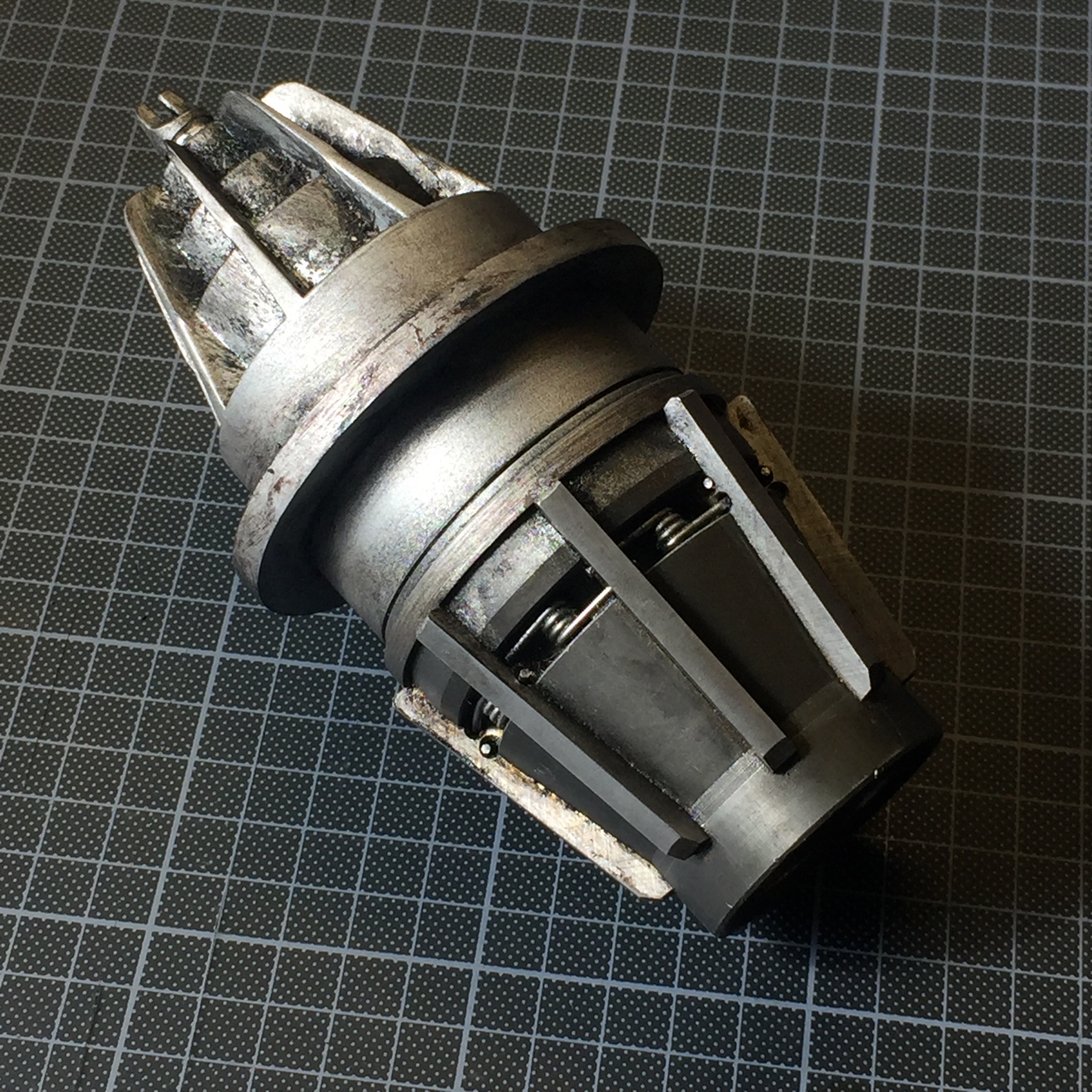

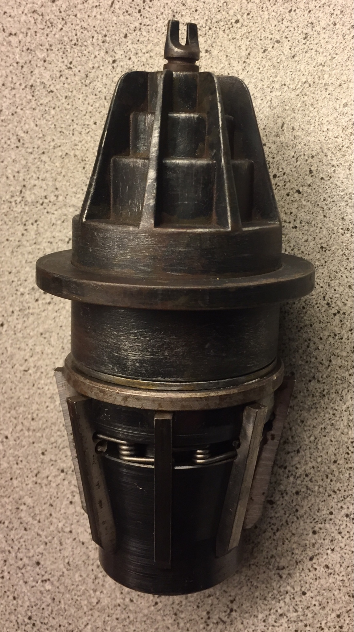

I finally finished mine today.
Thanks to R2Dan for the collet and the other parts!
Now, let's hope Unkar is in a generous mood.
