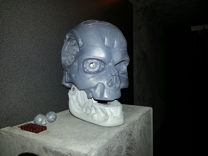

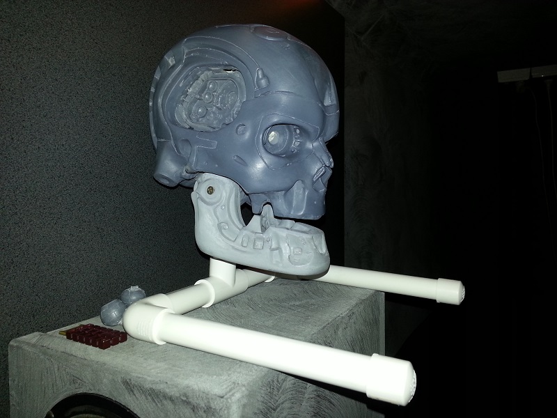

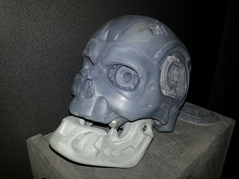

I started work on this yesterday getting the fitted and sat it on a surround speaker where it will reside when finished.
attachment.php

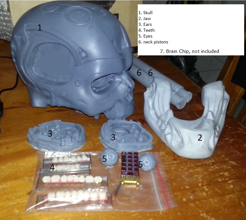

The KIT came with all the parts I need except jaw pistons. I am sure I can make them, but what I want to do is keep the jaw movable, as it is now.
attachment.php

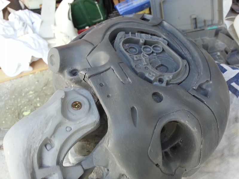

A close up of the ear greebs. There is some good details here.
attachment.php
I was taken aback when I found the kit had real dentures. They look white here, but are very ivory and realistic looking, false teeth.
attachment.php
The Brain Chip. This is di-cast metal key-ring that cost me a whopping $8 delivered. I've removed the chain and will bog the hole.

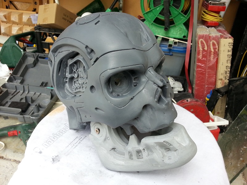

So yesterday was about the jaw aligned and fitting the ears.
attachment.php
attachment.php
attachment.php
attachment.php
I think I got the jaw on nice and straight. It was three attempts to do this so will have fill in the other 4 unwanted holes. I am also going to see if I can track down the proper dome head bolts used. If not, then stainless steel dome socket heads will have to do.

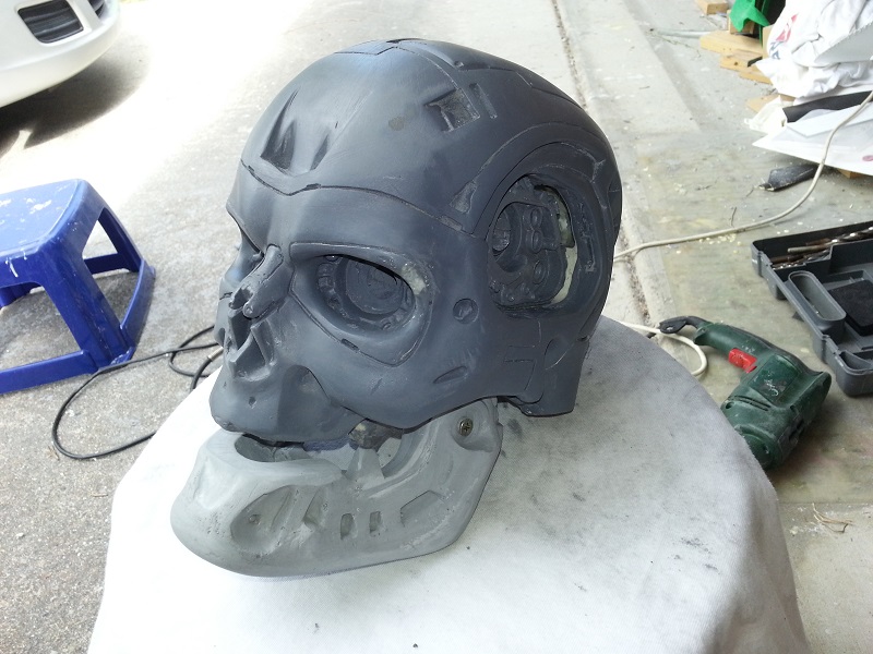

So today will require a heap more cutting as I need to recess the ear parts well into the head. By the look images including @Adam Savages video, the flat bed (the fill in on the skull kit) is about where the details need to sit.
You might notice a small chip near the eye. That happened yesterday. Because this is a slush cast, there was a bubble trapped just below the surface and just the pressure of my hand moving the skull around cracked the outer skin. I have contacted the seller to find out what resin it is made from and it seems to be D65, so I should be able to patch this with little issue.

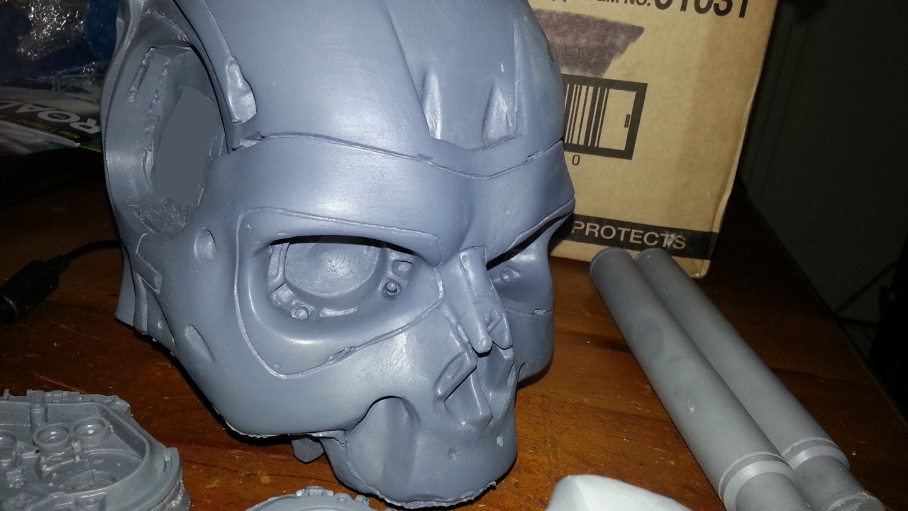

So end of day 2 and the ears are recessed, the eye socket is repaired along a few other little hollow I found as the skin gave way under hand. I ended just using good old Zappa Gap (the medium CA ) with the kicker, then sanded it back. Apart from a colour difference, it looks pretty good.
attachment.php
attachment.php

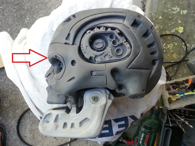

See the small crack above my repair? Well that was all hollow too and has all been fixed. The only issue was of course that the super glue spreads and fills in those groves, which I then had scribe back out.
I also drilled the neck and inserted a section of PVC pipe to support the back of the skull. I think for the stand, I am just going a use a disc cut from some plastic and I'll set it so the jaw is about 1/4" up off the deck. Should look good.

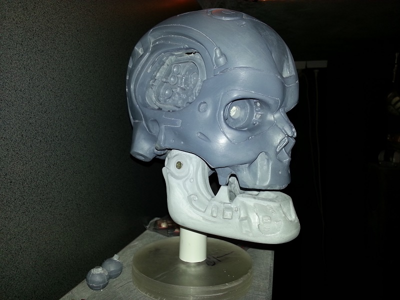

Yeah, definitely needs a stand, I just can't do the whole bust shoulders thing. The display area is 330mm x 210mm.
attachment.php
attachment.php
This is NOT the stand (stand is my PVC smart phone stand) it is going to get. I am just testing the idea of elevating the head to get the jaw up and it looks much better.

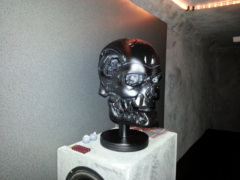

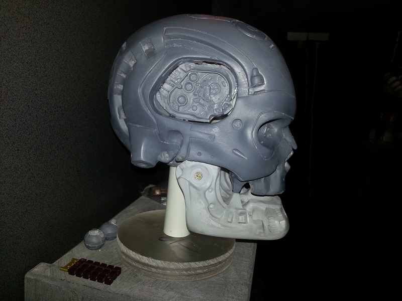

So I made a start on my new stand today. I just wanted something simple that would raise the head enough to keep the jaw clear of the display area.
attachment.php
attachment.php
First version of pole was the skull rest I made yesterday and was not tall enough at about 150mm or about 6". So I made a 200mm (about 8") version. The stand itself is a bit rough, but that is OK. I wanted thick plastic base, so I used 4 layers of 4.5mm clear Perspex that I fused together using #3 Weldon, then sanded the edges.
attachment.php

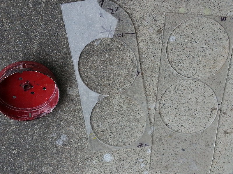

The 4 discs were cut out using this massive hole saw which is 146mm (OD). I bought this years ago when was making my own loud speakers. The size was perfect for a VIFA P17 woofer including using a 1/2 rebate bit to countersink the driver into the baffle. It cost a lot at the time, but has cut so many holes, it more than paid for itself. Now I am lazy for those projects and get everything laser cut.

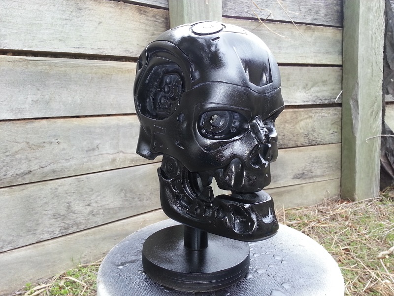

Yes I know I am supposed to take the jaw off to paint this, but I just needed a visualisation of it all one colour as the light grey jaw was bugging me. When it is ready for a 2nd coat (hopefully the rain will go away) I'll take the jaw off and paint them separately. I will give the inside a quick go over to make sure I got everything.

He is touch dry now, so back in the cinema until tomorrow.
attachment.php
If after the 2nd coat of black and the silver goes on, if he is this shiny, I'll be pretty happy given all I have to work with is rattlers.

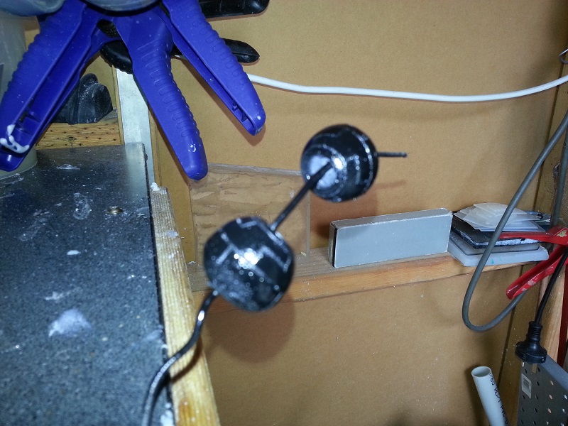

Crappy weather, so just gave the eyes a quick trim and coat of black.
attachment.php
