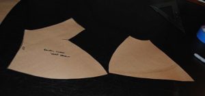

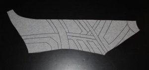

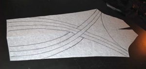

I drafted a basic pattern based on the client's measurements and then, using Swedish tracing paper, I mapped out the style lines. Here are the front and sleeve patterns.

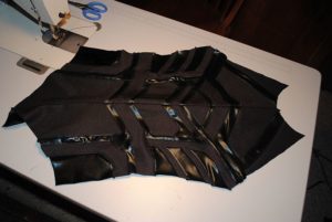

I began with the body of the suit. The details sections are made out of a metallic coated spandex and the base is made of black jumbo spandex. To create the pieces, I worked in sections cutting the paper patterns apart, transferring them to the fabrics and assembling them like a puzzle. Here are the front and one of the sleeves assembled.
I then assembled the back pieces, added the collar and finished all of the edges.

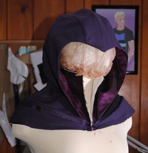

At the same time that I drafted the yoke pattern, I also drafted the hood based on an Assassin's Creed hood that was scaled to the client.

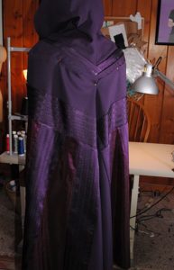

The inner yoke was made of purple taffeta, the main cape pattern is a lightweight suiting blend and there's also an accent fabric with a geometric jacquard pattern. The yoke was assembled first, the hood was added to that and then, to create the effect of the drapes around the shoulders, I used strips of the main fabric and the jacquard and applied them in a similar fashion to the pleated/woven sections of the Loki costume. Here is the upper part of the cape assembled.
The rest of the cape was cut in interlocking stripes that were designed to, when spread open, represent a bird's spread wings. I built the cape from back to front and then attached it to the yoke.

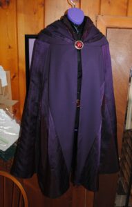

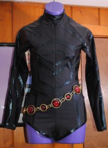

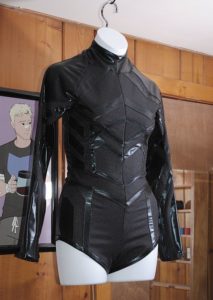

The last things to do were to finish off the cape yoke with a taffeta lining and line the body of the cape. The cape is lined in taffeta with some accent stripes of the jacquard to pull all of the elements together. Here are pictures of the finished components of the costume.
