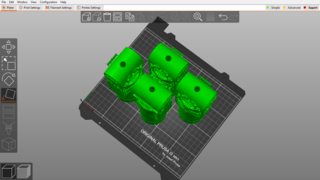

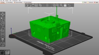

Here are the sliced pics;
Just a thought... you may want to model in the engines "hollow" to save on resin/weight as well as allow for lighting (looks like you may have done this in the slicer pics). You may also want to "key" the Engines to make alignment during construction easier. getting all of those engines to line up properly while glue is setting is a bit nerve racking and a PITA while they are all kind of "floating" where they are supposed to go... just sayin
Jedi Dade
Thanks for your input dude...yep, the engines are hollow and ready to accept an LED fitting. I was thinking to use a conduit tube to lock the engines into the manifold housing but I'll see how they are when I've printed them
