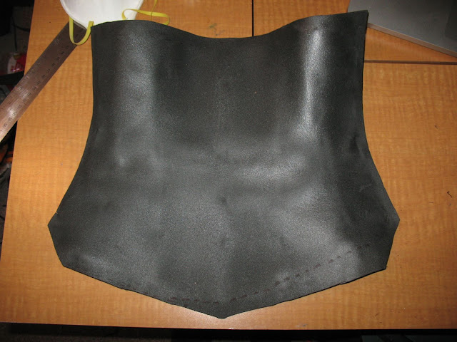

Finished carving
pattern drafting for the bodice/breastplate's corset understructure
finished understructure (its not my best work, but it will all be covered up anyway)
