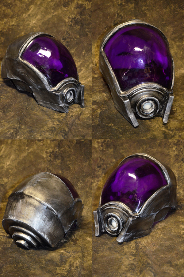

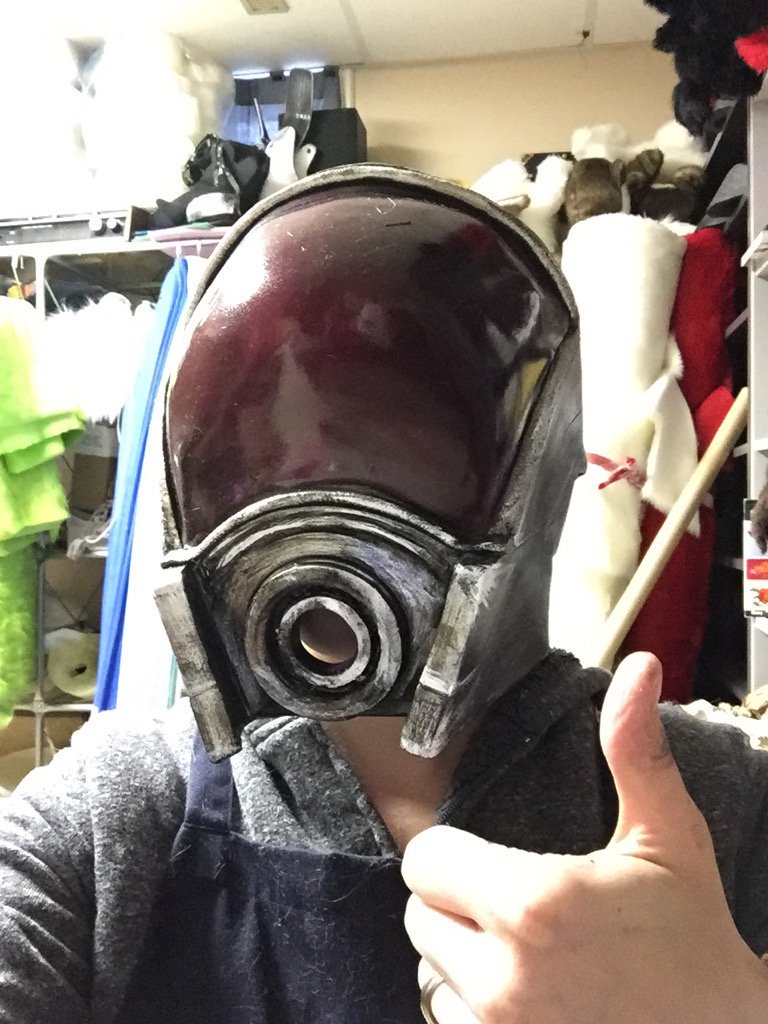

I cast the base in silicone and slush cast a resin copy. The visor was dremmeled out and I vacuum formed a clear copy with some PETG .04. The visor was dyed with idye poly.
C3ns6n3UMAAuFyF.jpg C53CvzOU0AAkszf.jpg C537DssUwAAG34y.jpg CyScdCbUUAATs9f.jpg DAYKkH6UwAApmgj.jpg
