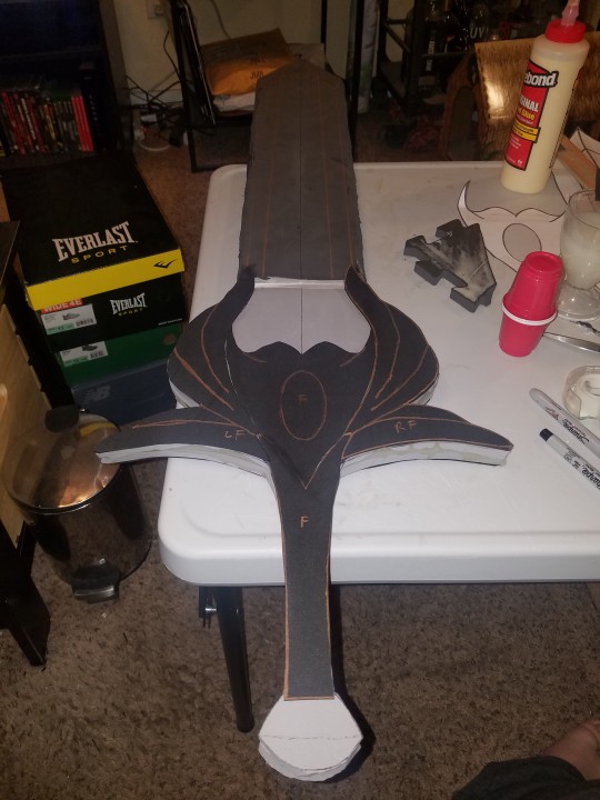

There you have it a work in progress sword of protection. I used a template I bought from a YouTube cosplayer and made it out of Eva foam.
Honestly this whole project has been a exercise in problem solving. You might notice the blade and cross guard are different materials.
That's because I normally use Eva floor mats in my prop building but forget tp the floor mates are the real thing stores are sold out of I cant find them any anywhere. Must be a lot of board cosplayers out there like me. Luckily I had a roll of this other foam to make the cross guard and handle out of. Problem is its slightly smaller then the floor mat foam. So instead of being able to carve the cross guard details in like I was I originally planning. I had to build them up out of thin craft foam which actually came out looking really good.

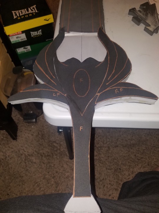

But I thought I only had to build up the wings on the side so I cut a glued those first. Then i realized I needed to bulk up the handle, and then the center piece as well. If I had know I would have saved myself a lot of head ache and just cut the whole sides as one big piece. Oh well were always learning as we go if that means i have a lot of seam gaps to fill in later so be it.

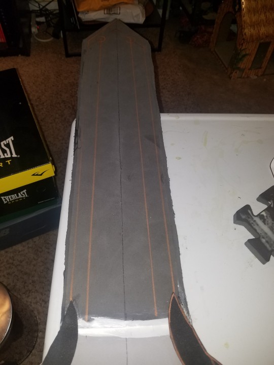

That's all I have for now sorry i don't have more pics from earlier when i was cutting the main body but it was really simple. just cut out the two halves cut a channel down the center to put in a fiberglass marking rod from home depo. honestly those things are my favorite new core for foam props there cheap, readily available and fairly strong for how thin they are.
next i just have to grind the edges and bevel everything tomorrow to refine the shape. I got a new belt sander to do that with which I'm super excited to use I'll post more as progress is made. may also have to make a jig so i can use the belt sander standing so i might post pics of that. if anyone has any tips or wants to point out something horrible I'm doing wrong please say so down bellow. So till next time peace love and death to the horde!

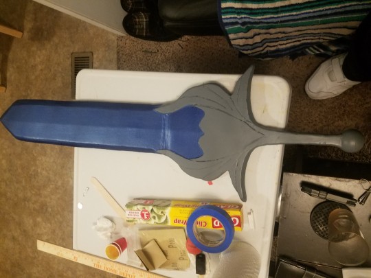

Anyway I then primed the sword grey and boy did that reveal some blemishes I had to fix with some quick seal. Which can I say is a God send love this stuff must have for anyone working with foam.

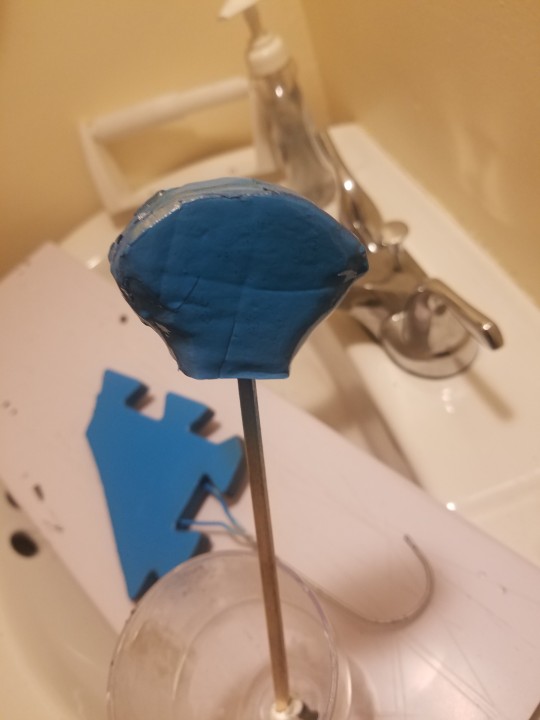

So hear the sword after the base coat and the sword blade painted with a sparkly metallic blue which I love but am torn about. It doesn't really match the show but I love it. For reference hers the sword of protection in the show.
Now I found a paint that matches that really well here it is on a test piece.
And here is an experiment with the lighter blue over the sparkly metallic.
Not great but pretty much what I will get if I cover the sword now. So I need you help guys what should I do for the sword blade? Should I go more screen accurate which it already isn't or do I go with what I have which is the awesome metallic?

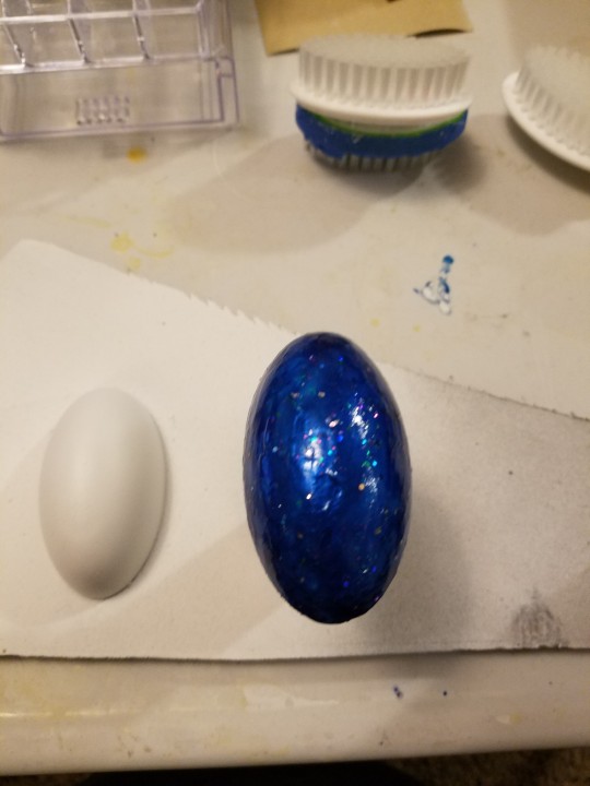

After that I gave the whole thing a few passes of clear coat and got to work on the rune stone in the center. Originally I was going to use an Easter egg like so many other people have done. But the stores were out of Easter stock by now so I thought I was out of luck till I found these vegetable scrubbers at dollar tree.
The back were the perfect shape even better then an egg. so I pried out the brush part and cut them down with a saw then got to painting.
So first I gave it a base coat of white primer and then painted it using a blue glow in the dark nail polish. Then went over that with this clear polish full of sparkles.
The end result is a beautiful opalescent sparkly gem stone the looks amazing once I glue it on the sword. And since I could find any where if the sword of protection had gems on both sides. Please if you know this tell me! I made a second one for the back of the sword.
