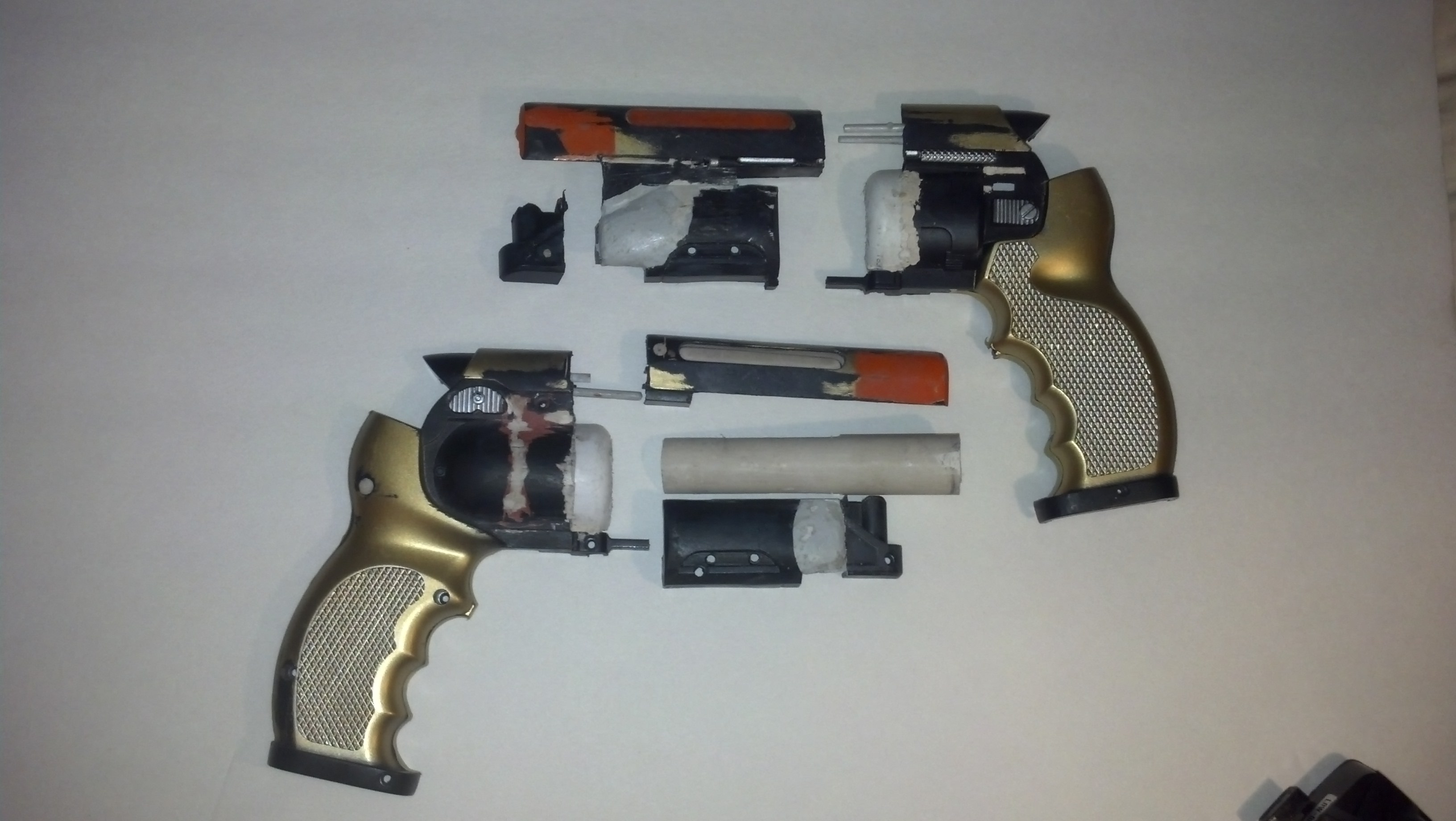

Cut up (quite) a bit more. The black boxy segment is getting slid back a little to help fill the gap in the middle. I'm going to use epoxy putty to sculpt something to fill the new gap in front of that. Then I decided the whole thing was about a half inch too long, so it got cut in half. I've also cut off all of the details that were in the wrong place, I'm going to have to make new ones to put back on it. There is an awful lot of epoxy putty and bondo in this thing's future.
The white plastic sticks are pieces from the sprue of an old model kit, they're there to give me something to attach the front end to securely. Also in this picture: one of the slots for the old speaker enlarged to fit the switch for the LEDs I'll be adding and the other slot blocked off and ready to be filled in with putty.
