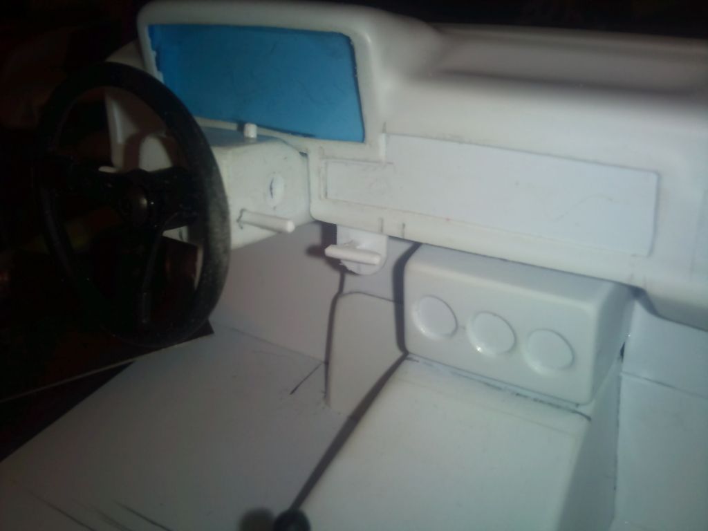

A few random unfinished examples of my work
Kindly ignore the bondene bottle thats what I used before I knew better.
