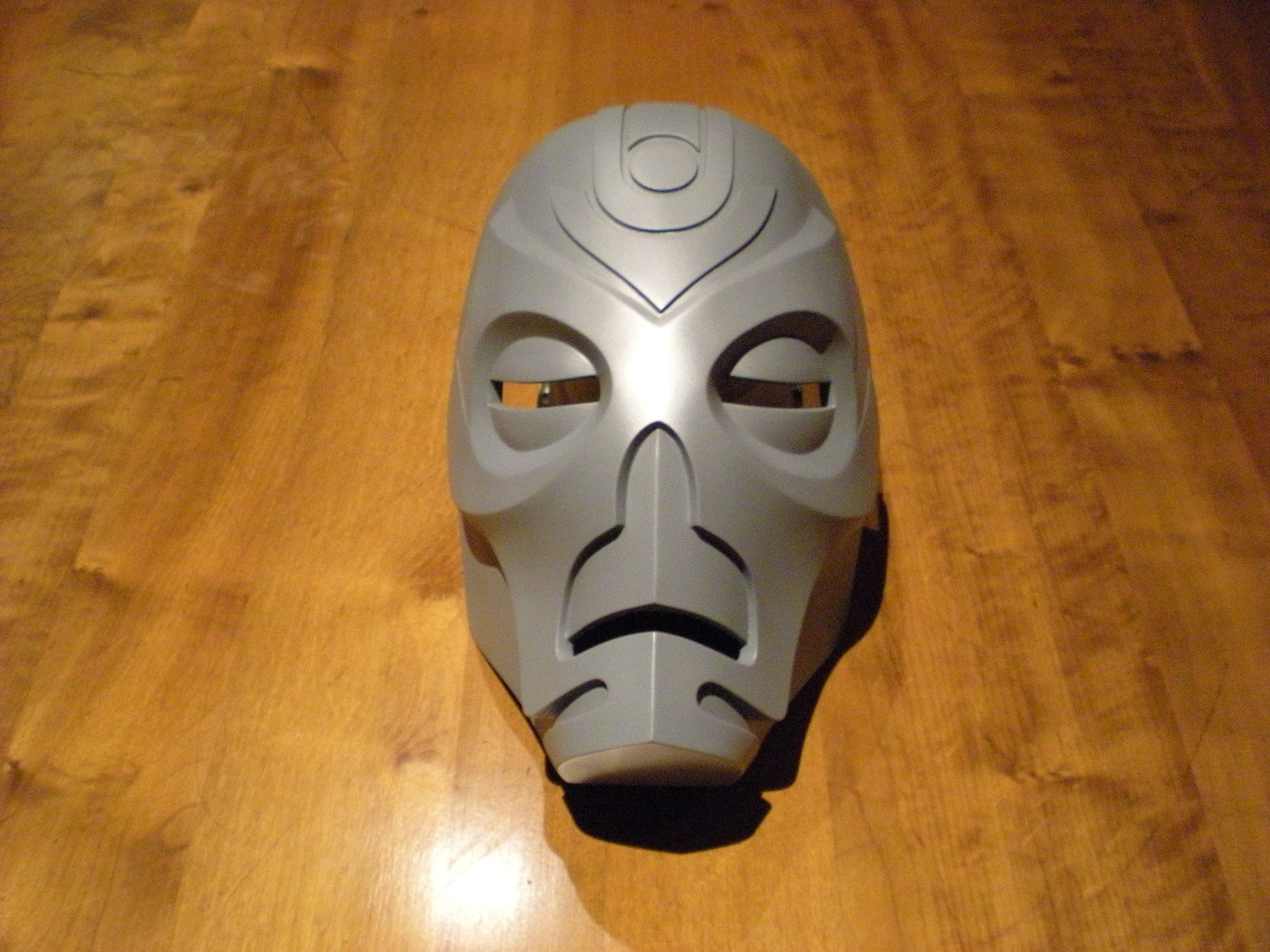

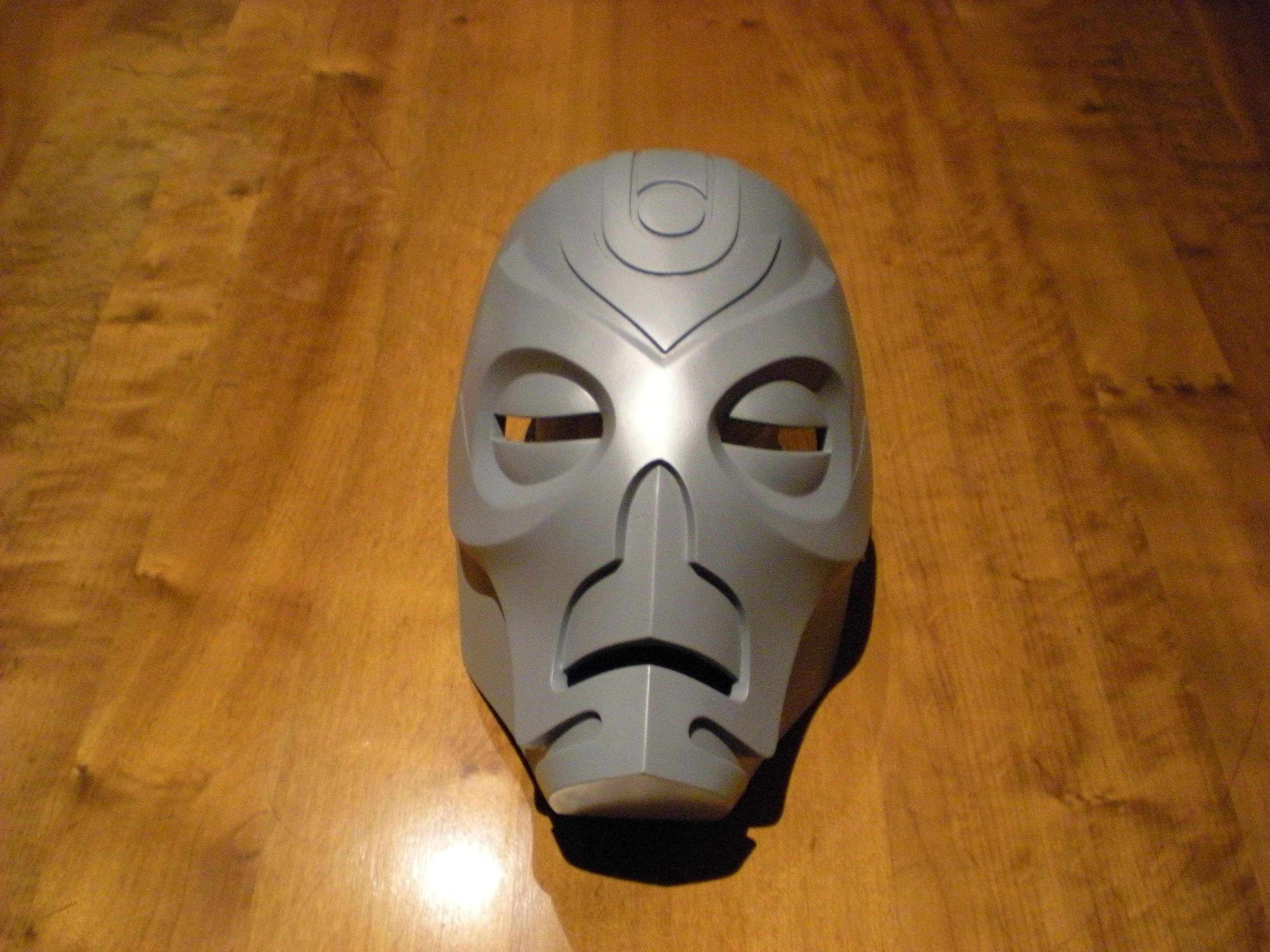

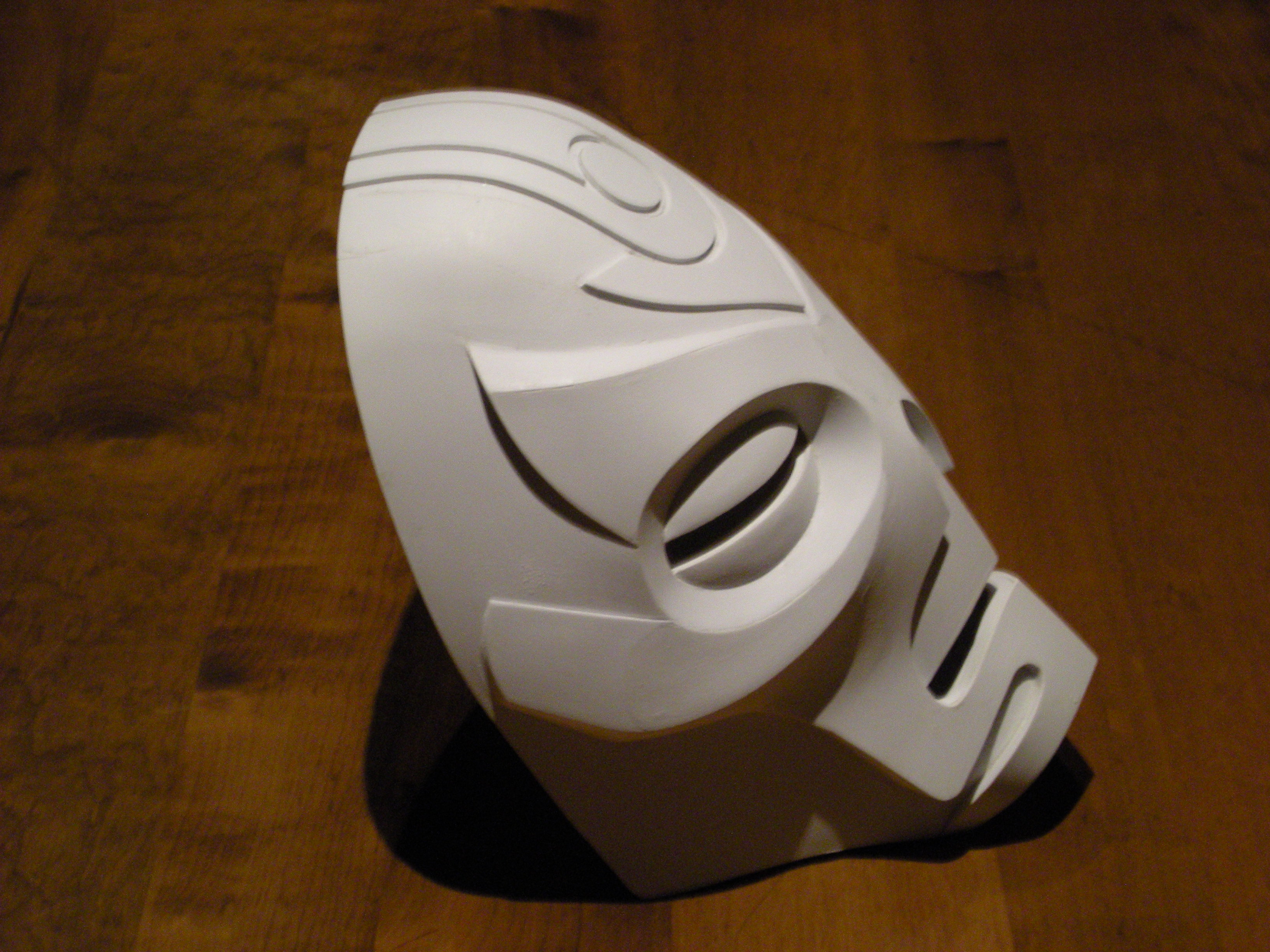

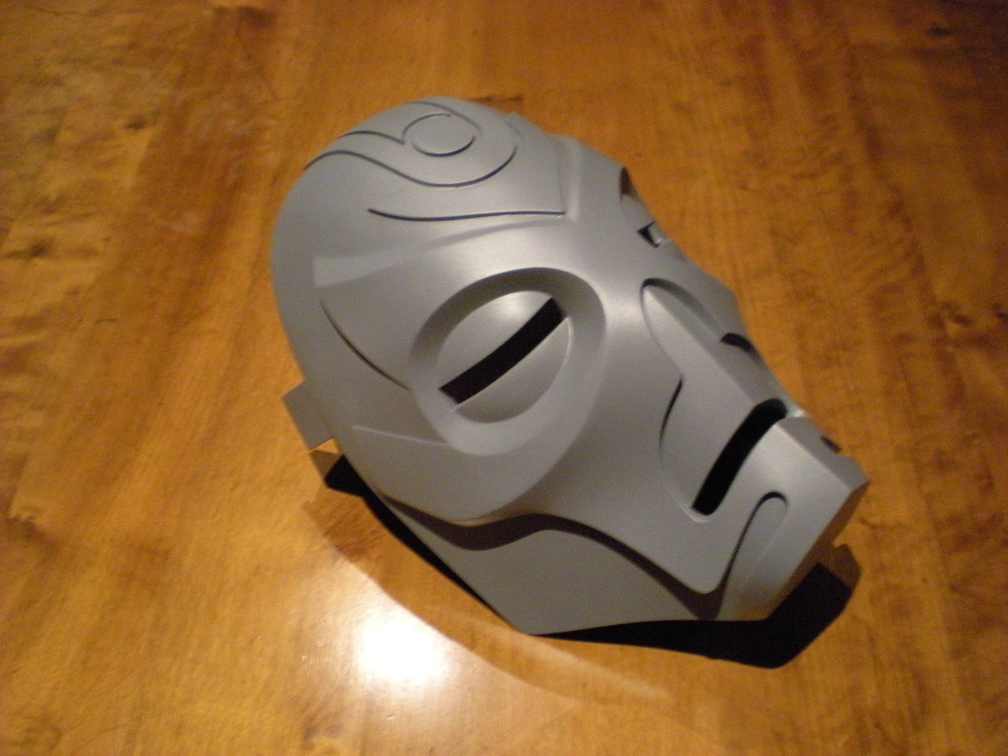

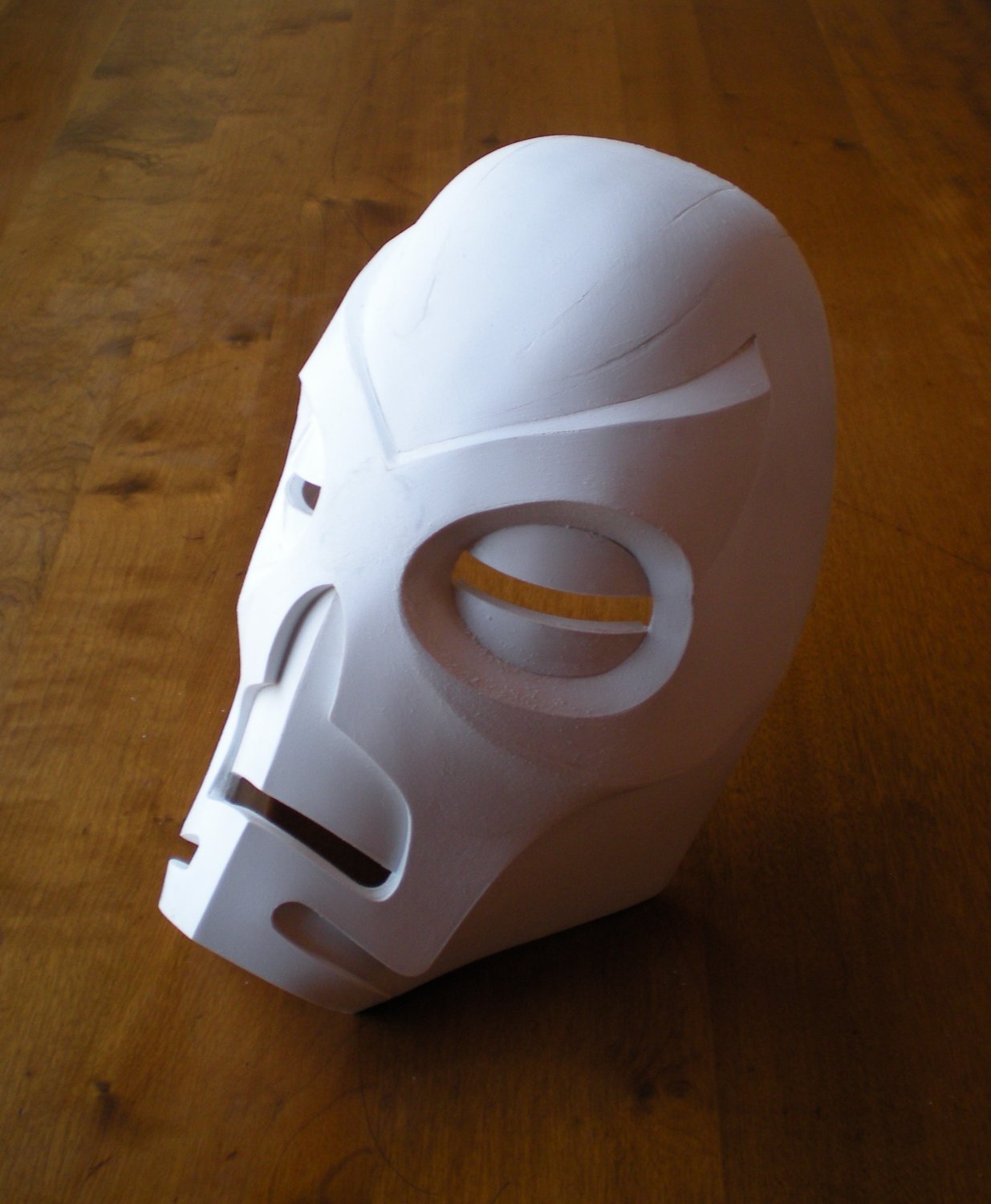

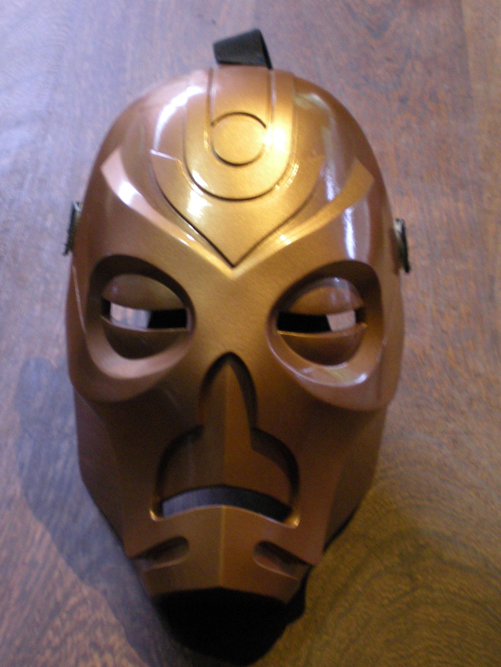

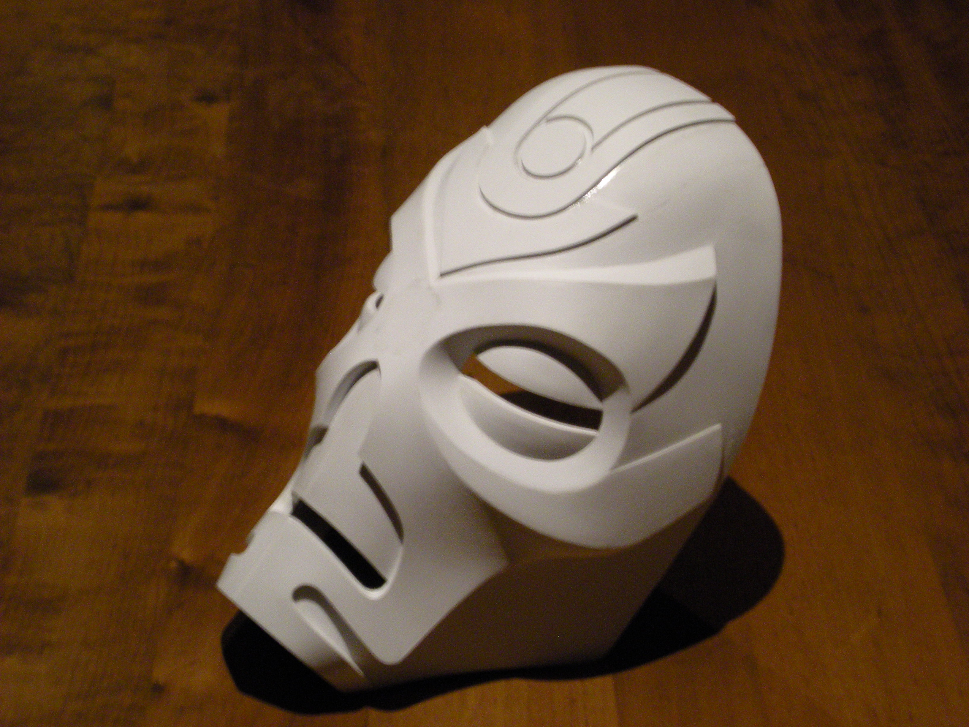

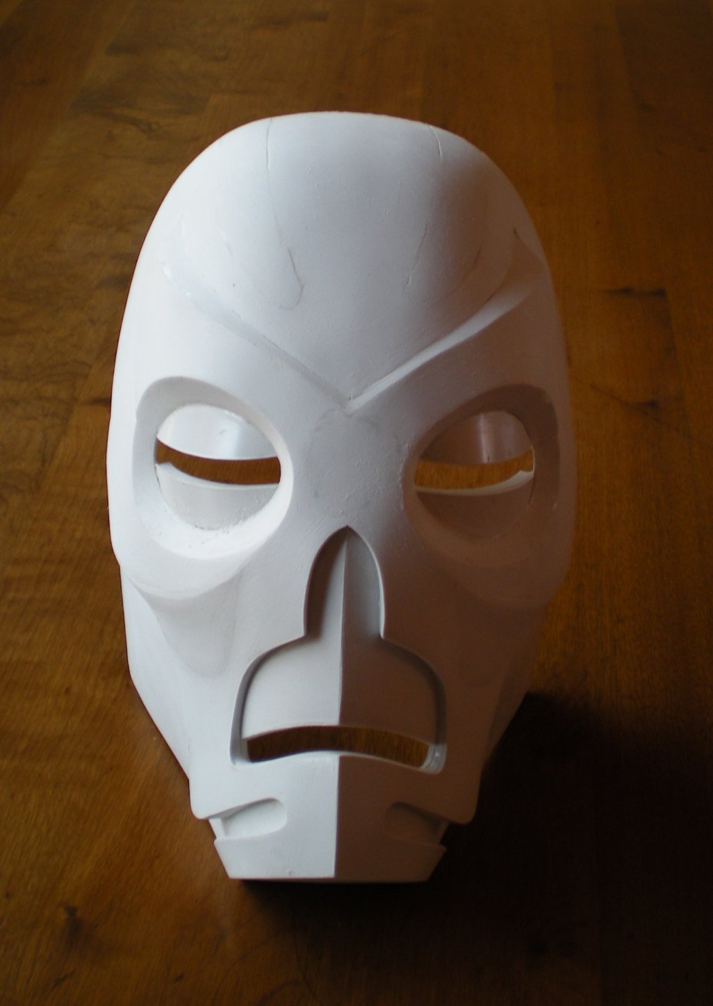

I was recently asked by a friend to make a Dragon Priest mask for her son for a local Con. I only had about a month from start to finish. Mostly made out of 1mm styrene sheet and painted with Rust-oleum Hammered Copper. For the amount of time I put into iti'm quite happy with the result.

Dragon Priest Mask 004.jpg Dragon Priest Mask 001.jpg Dragon Priest Mask 003.jpg

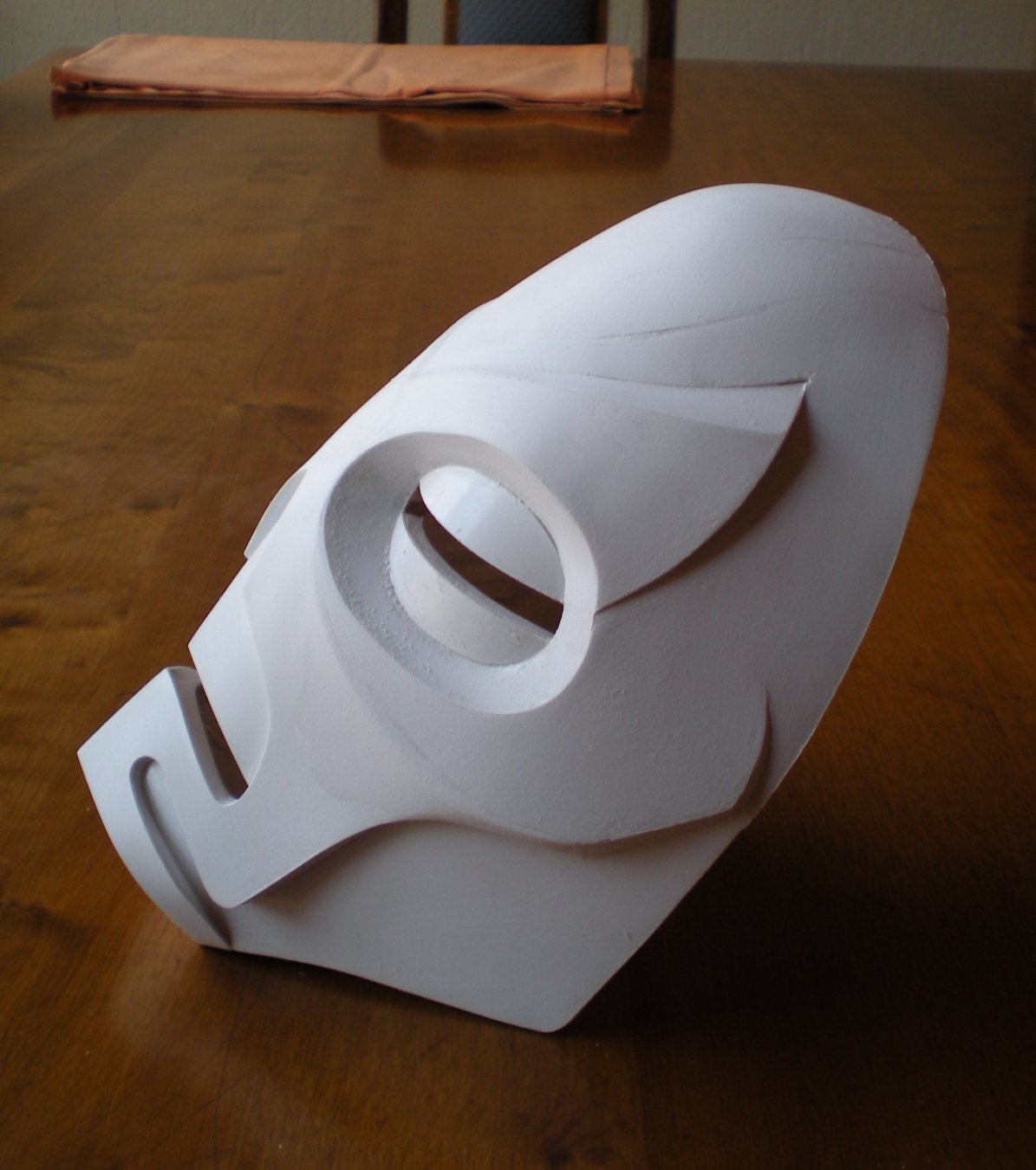

Dragon Priest Mask 011.jpg Dragon Priest Mask 006.jpg Dragon Priest Mask 007.jpg Dragon Priest Mask 008.jpg Dragon Priest Mask 009.jpg Dragon Priest Mask 010.jpg

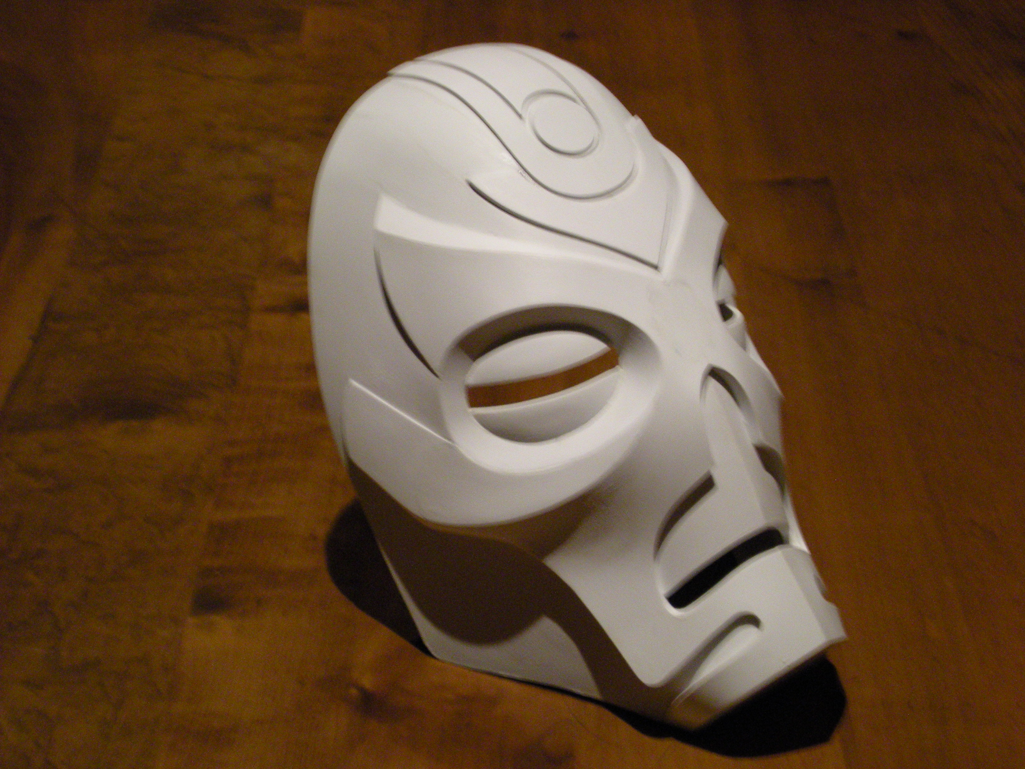

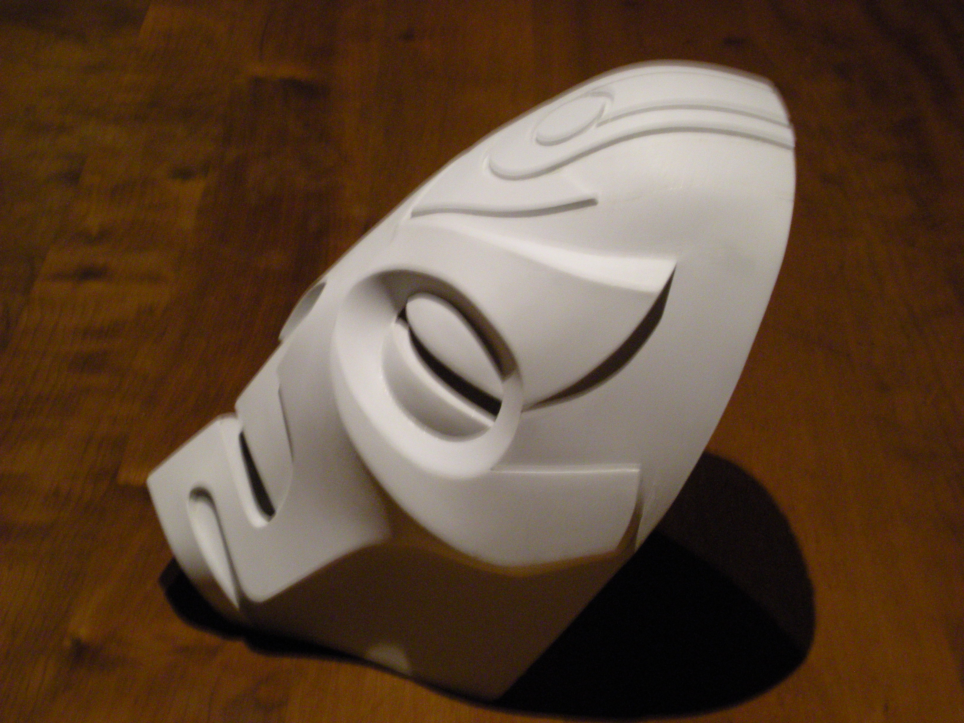

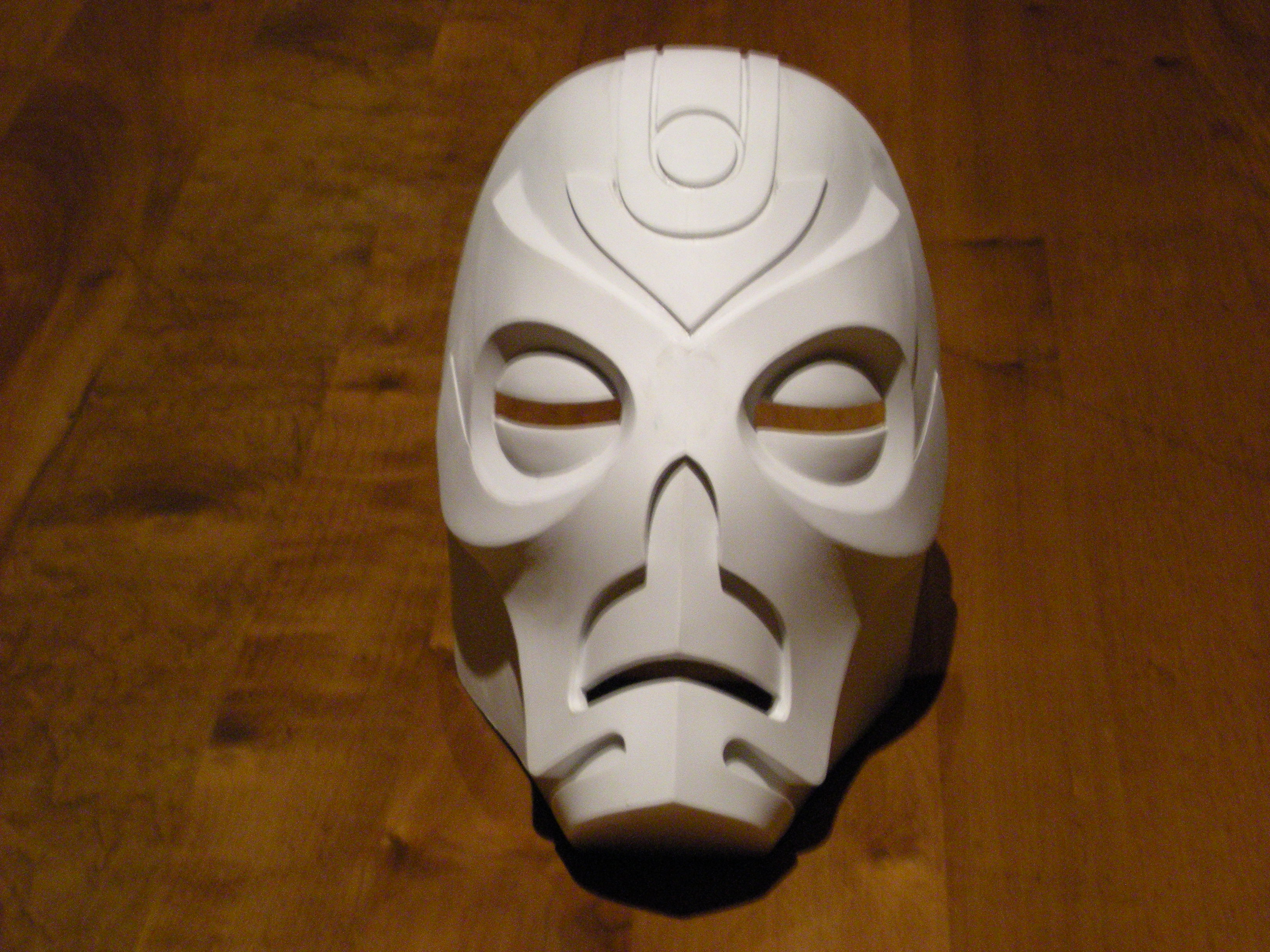

Primed with Rust-oleum grey Primer.

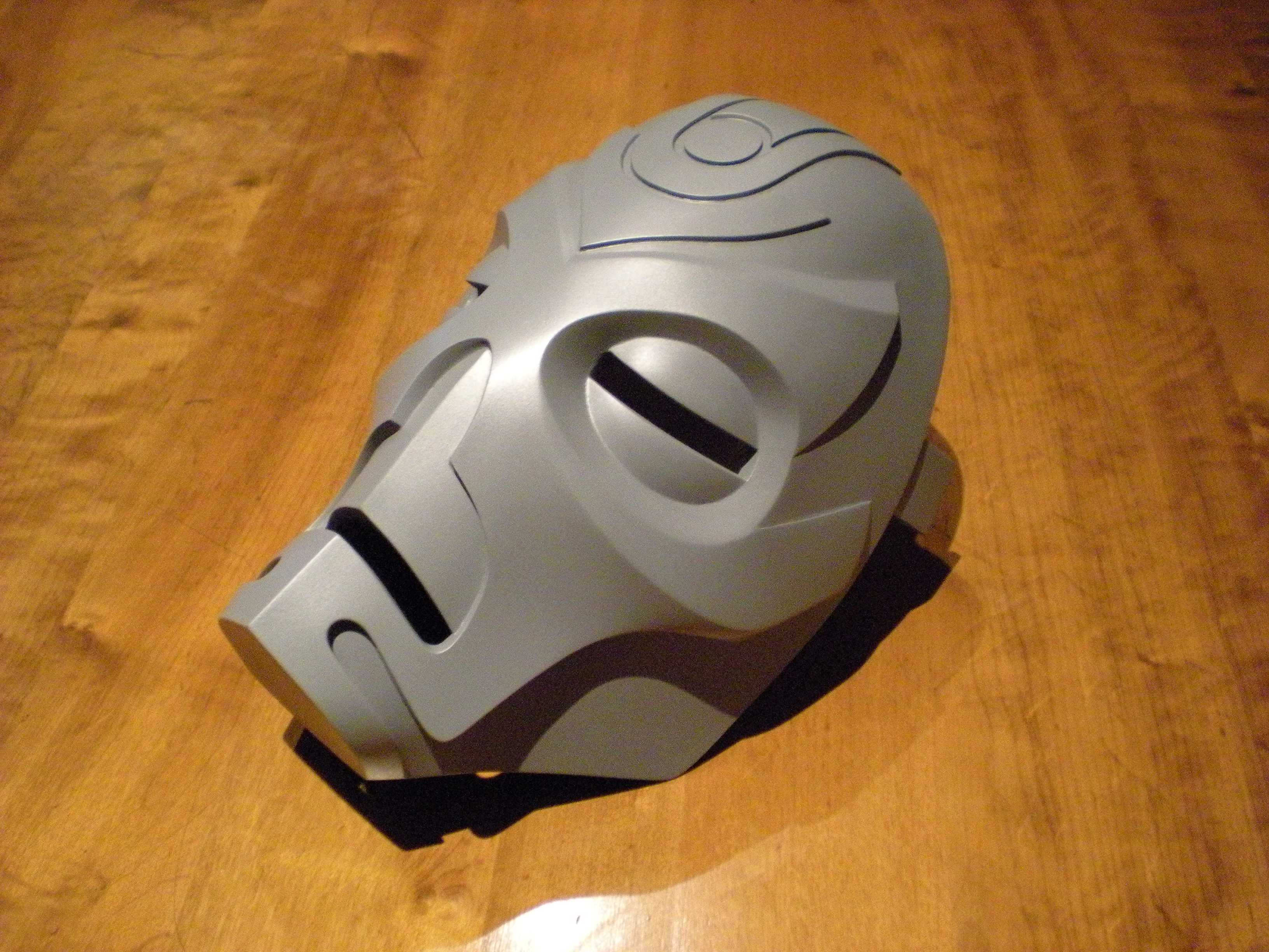

Dragon Priest Mask 014.jpg Dragon Priest Mask 013.jpg Dragon Priest Mask 015.jpg

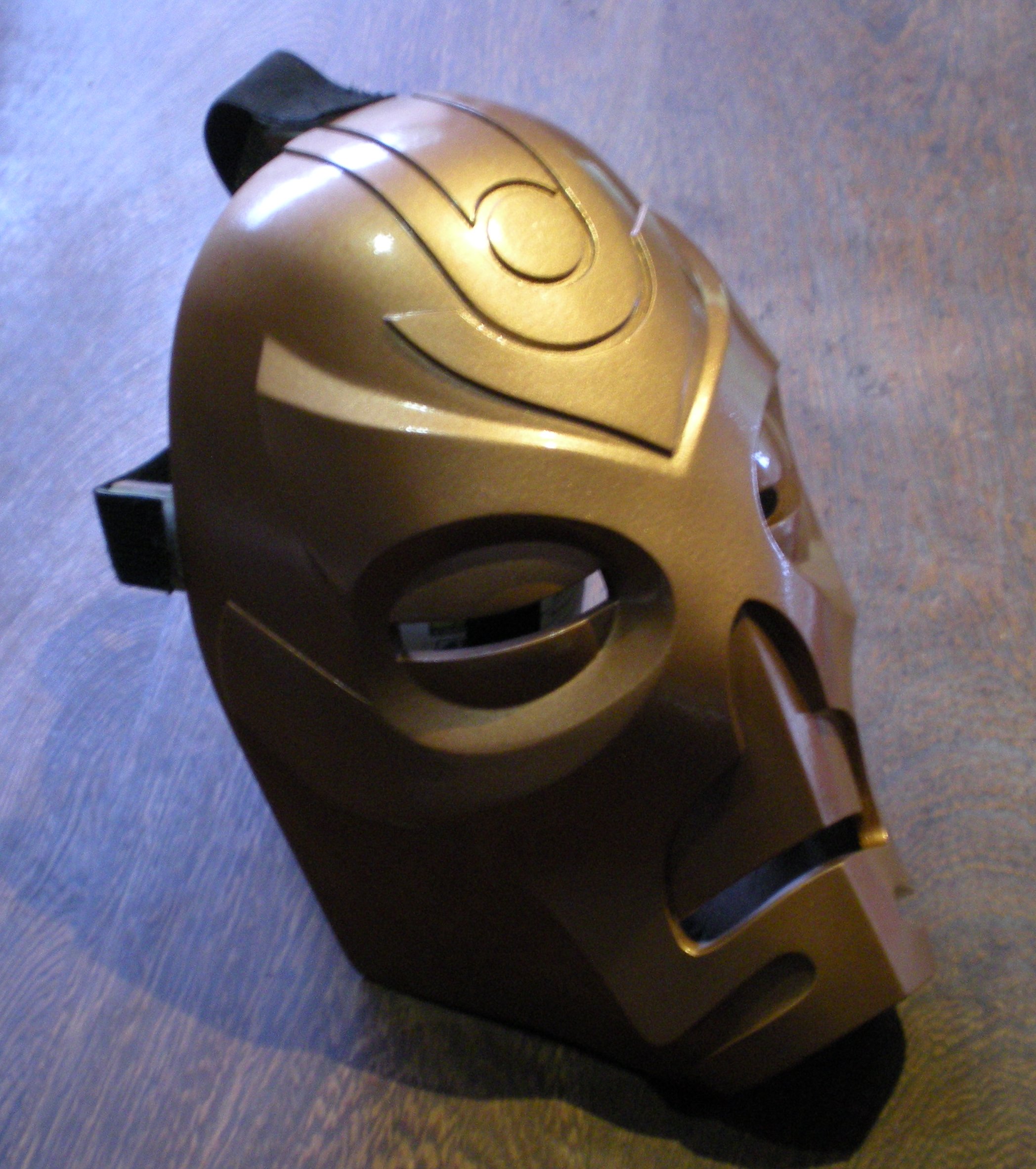

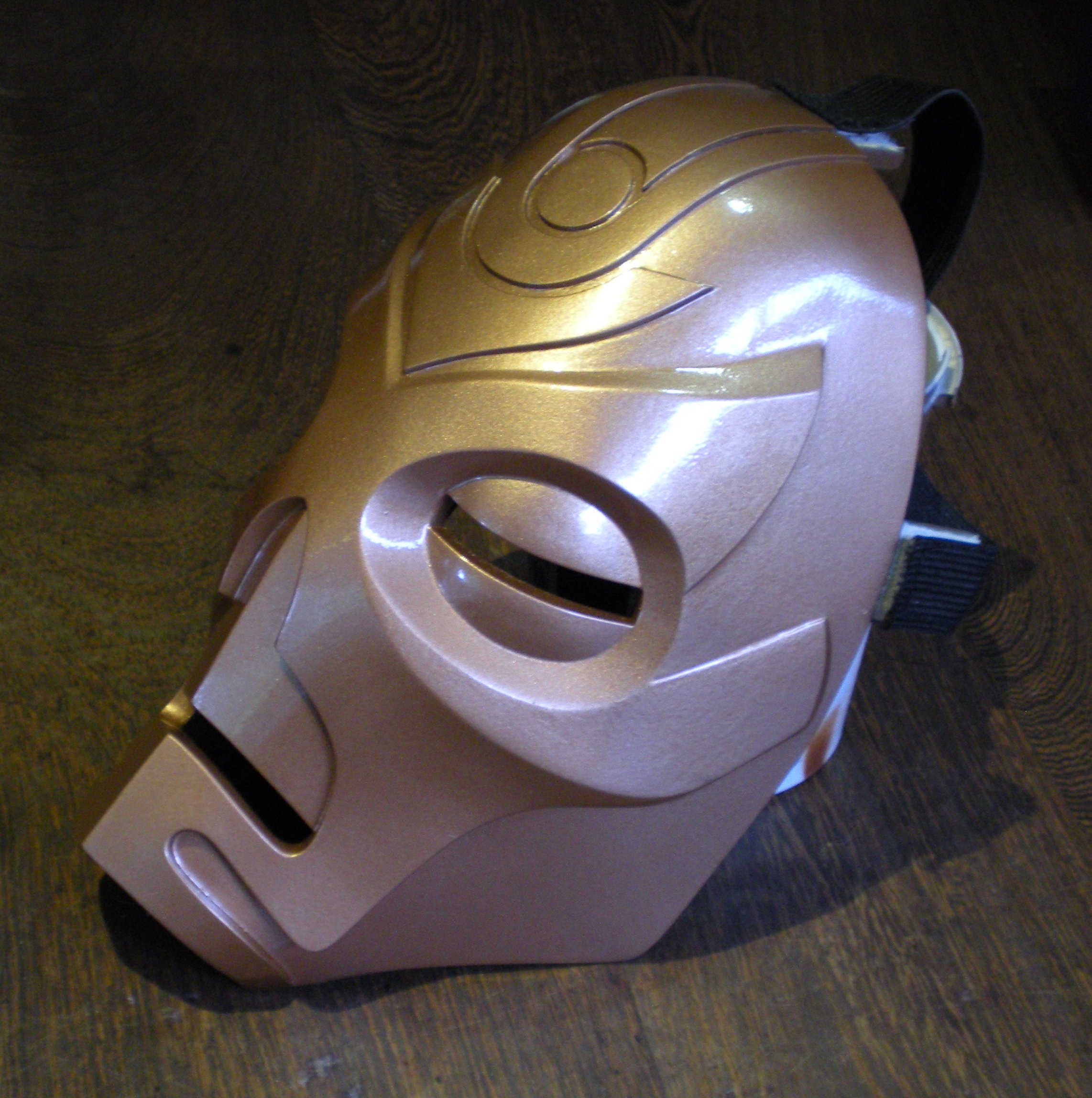

Finished mask.

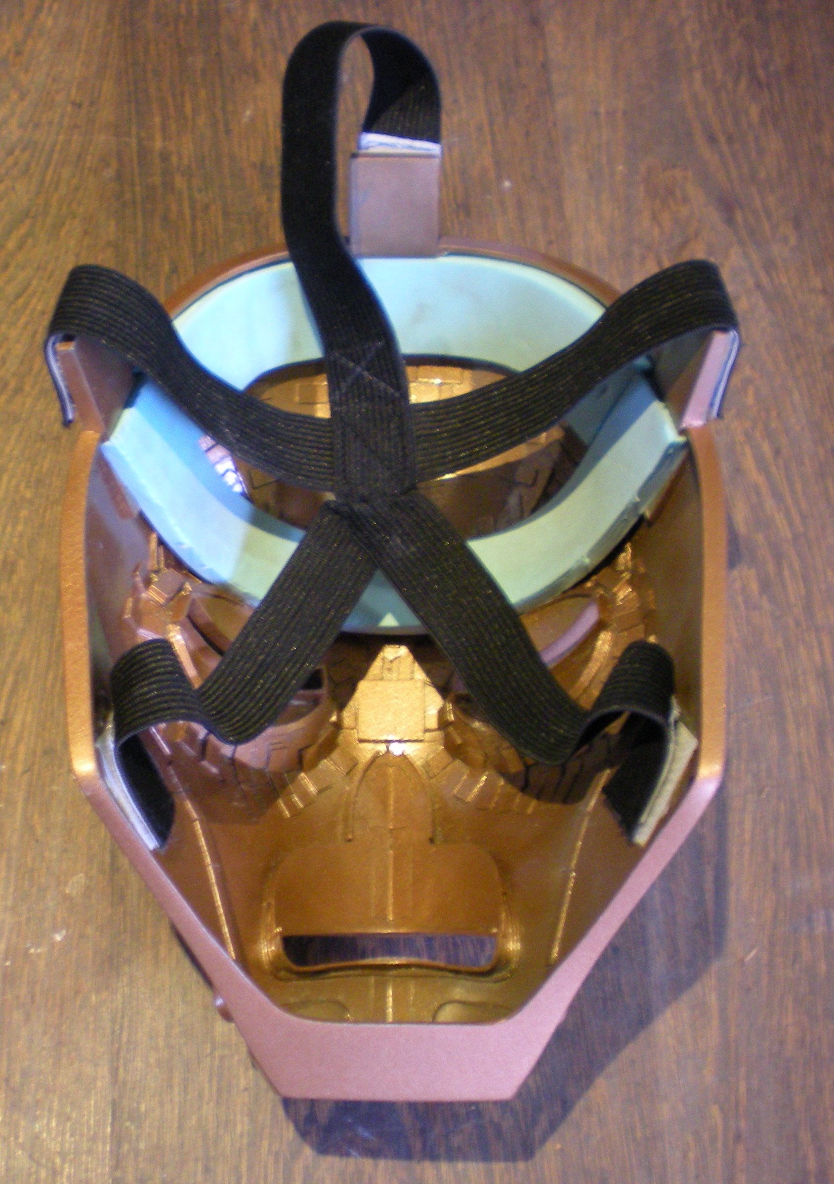

Dragon Priest Mask 019.jpg Dragon Priest Mask 021.jpg Dragon Priest Mask 018.jpg Dragon Priest Mask 017.jpg

Looks lovely. Are those compound curves composed of lots of thin strips of styrene then smoothed over with a filler/putty? I read your tutorial which was very interesting, but still a little unclear on that part.
ColKel
The compound curves are basically just a couple layers of 1mm styrene (2 layers of 1mm styrene as I can recall) and then sanded smooth. No filler was used except for modelling putty to fill the gaps between the strips.
