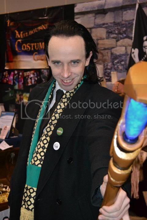

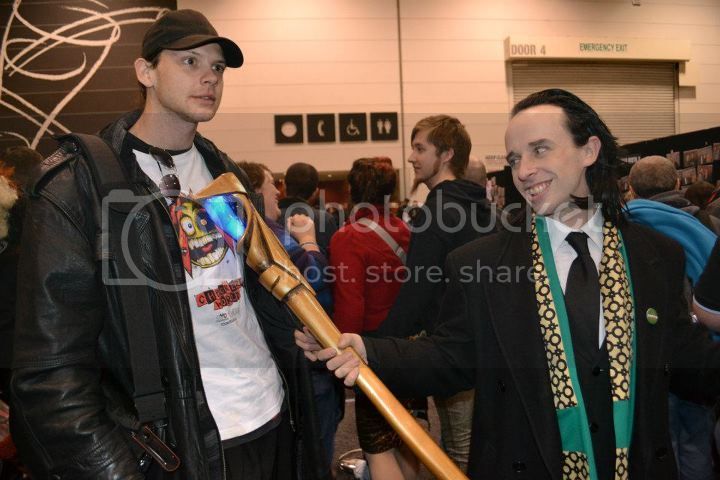

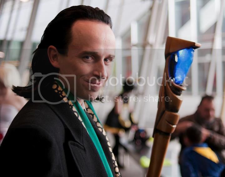

That I did, sir.
I poured 2 part polyurethane foam into an MDF housing that I made and let it harden and rise.
Once I had a large foam block to work with, I carved out the shape of the cane and reinforced it with two threaded rods for support.
I then fiberglassed the whole thing and sanded it, filling any gaps, etc.
Some automotive paint and dry-brush weathering later and the cane was done.
For the Tesseract gem, I happened upon a plastic, blue mineral water bottle that was a very close shape. Lucky!
I then cut the neck, heat-gunned it to shape a little, filled it with bubble wrap (for better light dispersal) and fitted an LED into the top and bottom of it, with a discrete battery back hidden behind in the head of the cane.
The 'gem' pulls forward so I can switch it on and nest it back in the cane. :)
As I said, I plan on doing a much more accurate cane in the future as my skill level improves.
Aside from assembling a pair of Han Solo DL-44s, this is one of my first prop builds. :)
