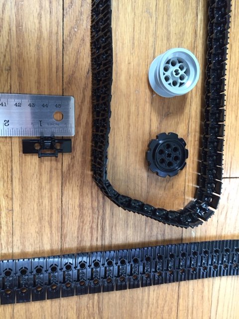

The real fun will be the steering, which will have to be proportional, with the treads on the inside of the turn rotating more than the outside treads.
Here is the photo of my track pieces idea. Lego track pieces.
According to my calculations, 1 1/2 inch width is perfect for SS. Any input? Am I off on the sizing?
Well I like going precise on my builds, only allowing some artistic liberty with straightening some things out. So I'm actually still on the fence about using another kit as a basis, which will probably only have small differences compared to the Tamiya Sherman.
Even though the sizing might be ok (haven't done any measurements on the tracks yet), the details will be way more of that i'd be comfortable with. Also note that the tracks had an addition to them so were wider than the kit parts themselves.

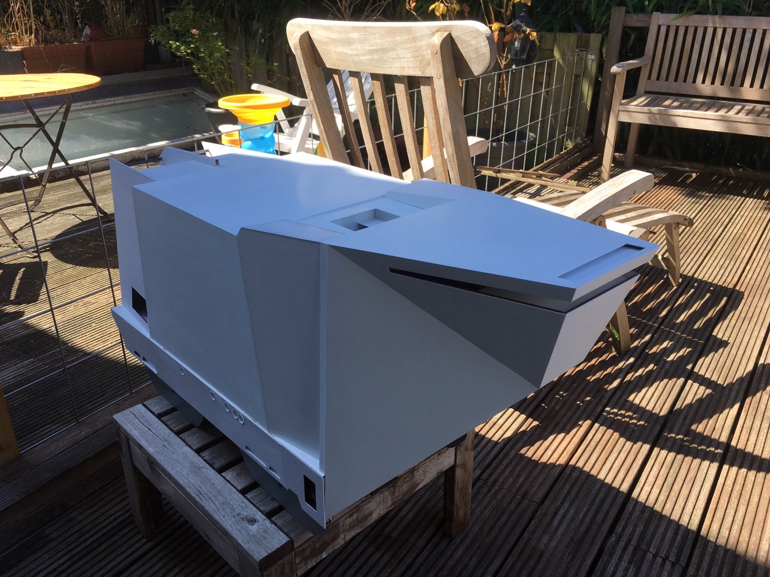

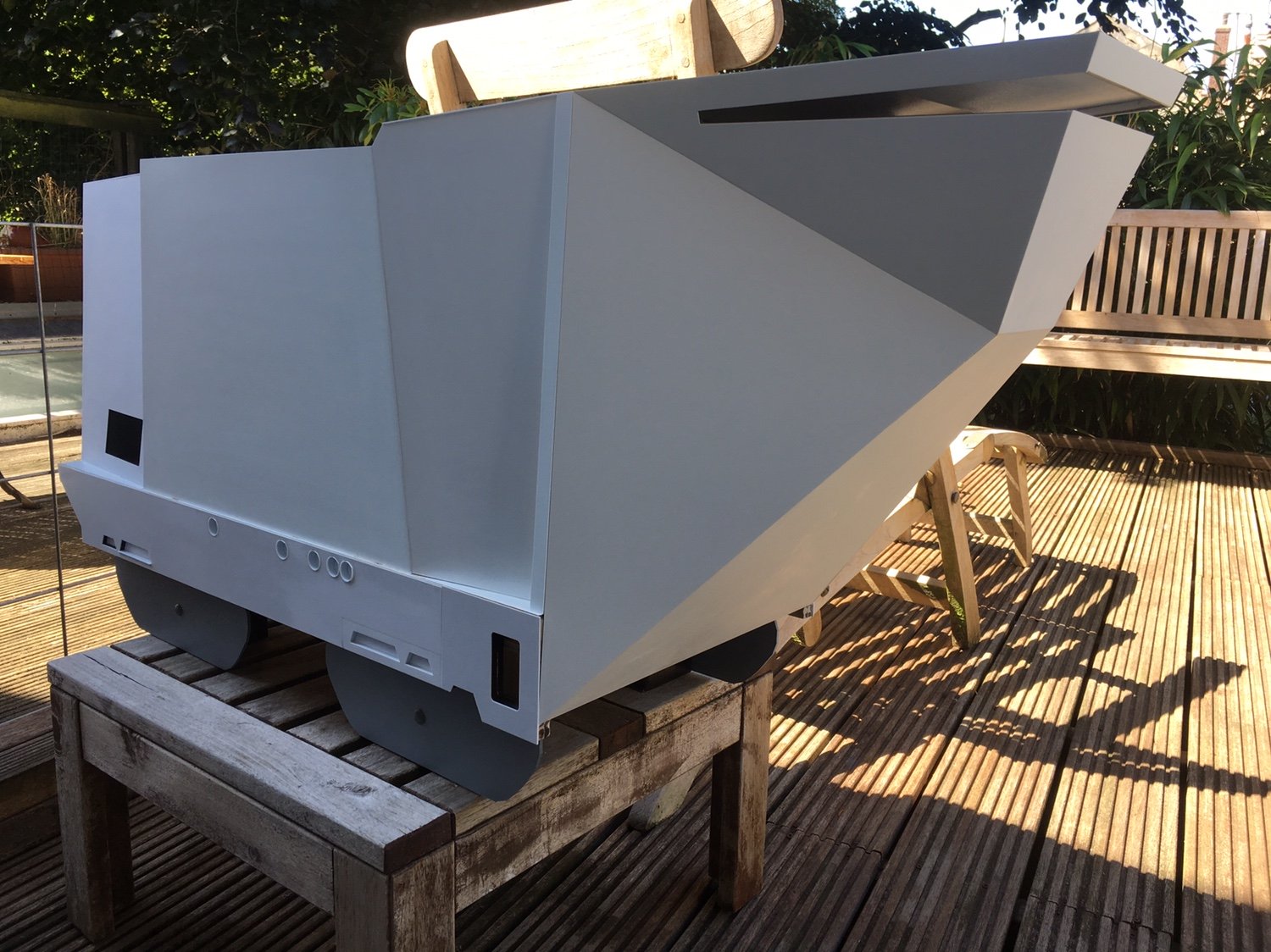

An amazing start Marvin, looks the business. :thumbsup :thumbsup What sort of glue are you using to stick the styrene to the MDF?
Thanks guys! I used a very strong two-part urethane glue that comes in two cans and has to be mixed 1:1. Rough up both surfaces and stick on. Very sticky stuff. Easy to clean up (while not set) with acetone. Only downside is it takes 4-6 hours to set up and 24 hours to harden out. But since its only needed for the first layer of skinning that's fine. I just did every surface so from now on i can just used styrene bonder.
Cool project and great start. Hope I'm wrong, but most everything Star Wars isn't easy. I would be surprised if the Lego track works. However, did t Tamiya make larger scale motorized tanks. I would think ILM used something off the shelf for the treads.
