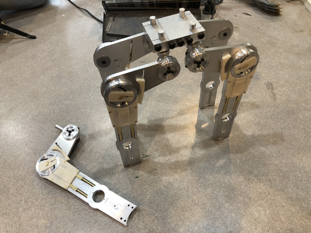

Thanks joberg! Having a CNC mill really helps with having stuff look perfect. Even though these parts were made the same way on the originals, I still sometimes feel like I'm cheating CNCing it all.
I'm looking forward to the body and head modeling. I haven't done that kind of hands on model making in a very long time. Keeping that work up to standard will be challenging and fun!

And here is the knee plate rotator mechanism mockup! Tan parts are CNCed ABS. Grey parts are 3D printed. I thought printing the ring holder and ring would save time but the cleanup and fitting took longer than if I had CNCed 'em in the first place. Live and learn.
Gears are CNCed Delrin. I might do them in brass on the final parts just for fun. Some small tweaks need to be done but overall it works well.
I have no idea if this is how the mechanism was put together on the originals. With the exception of Phil Tippett mentioning in Light and Magic that there was a mechanism and two small clues from photos, there really is no other information I have been able to find.
I guess I'll just have to wait for George to invite me over with a bag of tools so I can dismantle one of the original models and see how it was done. ;)
Short video shows it working. Set to some funky music of course for y 'all's viewing enjoyment!
Now that this thing is working, I'll be getting back to making aluminum parts.
