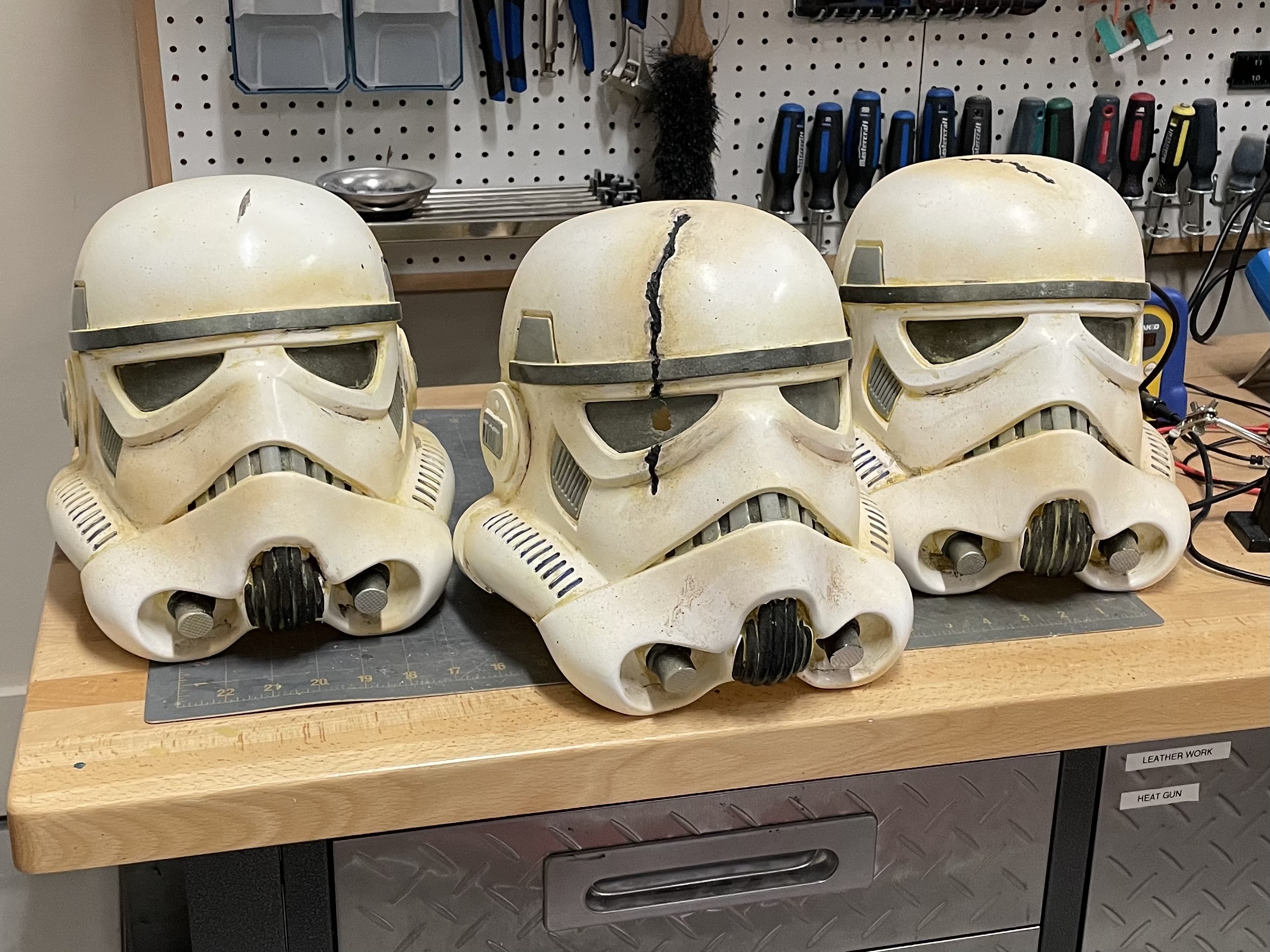

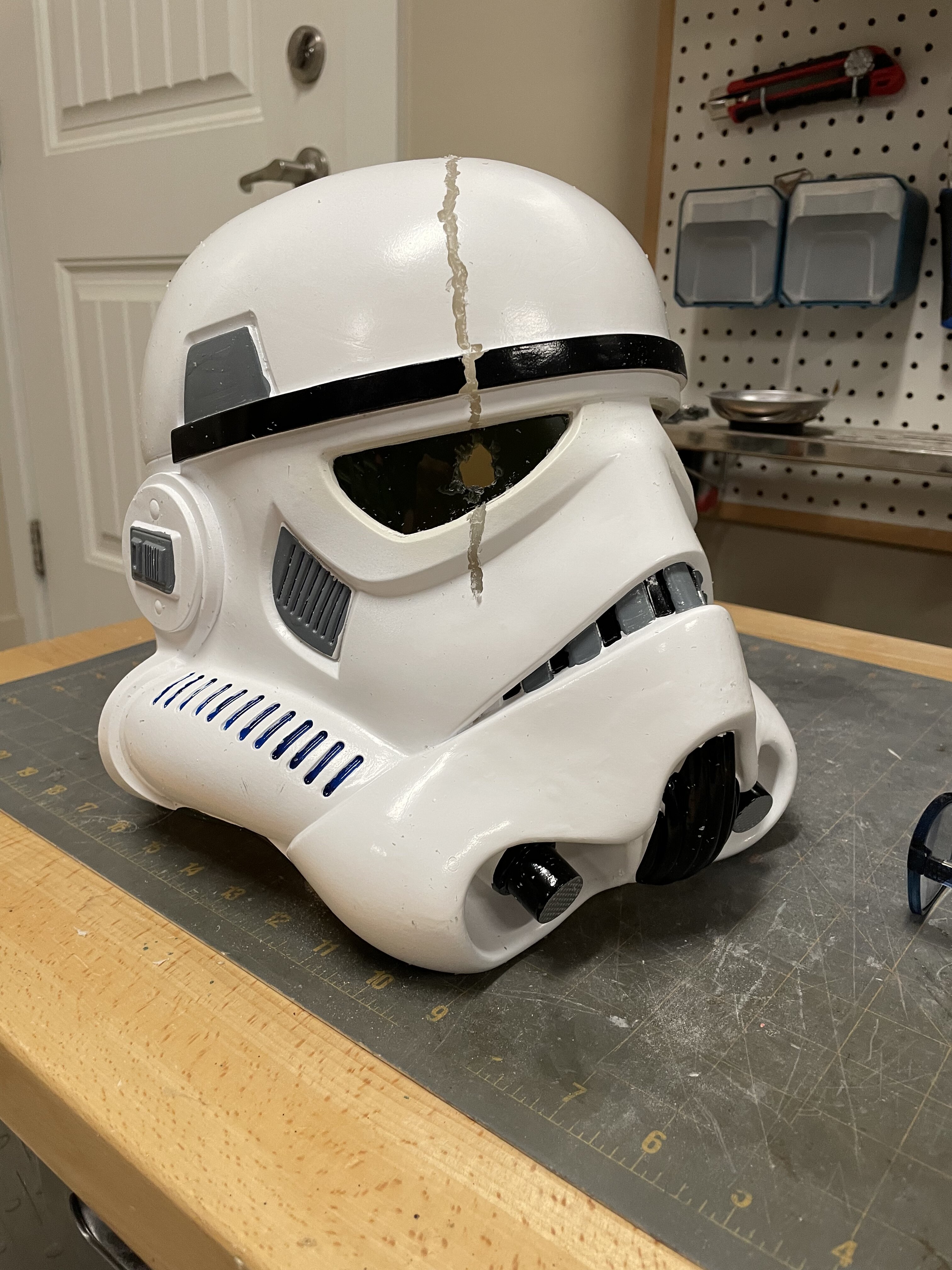

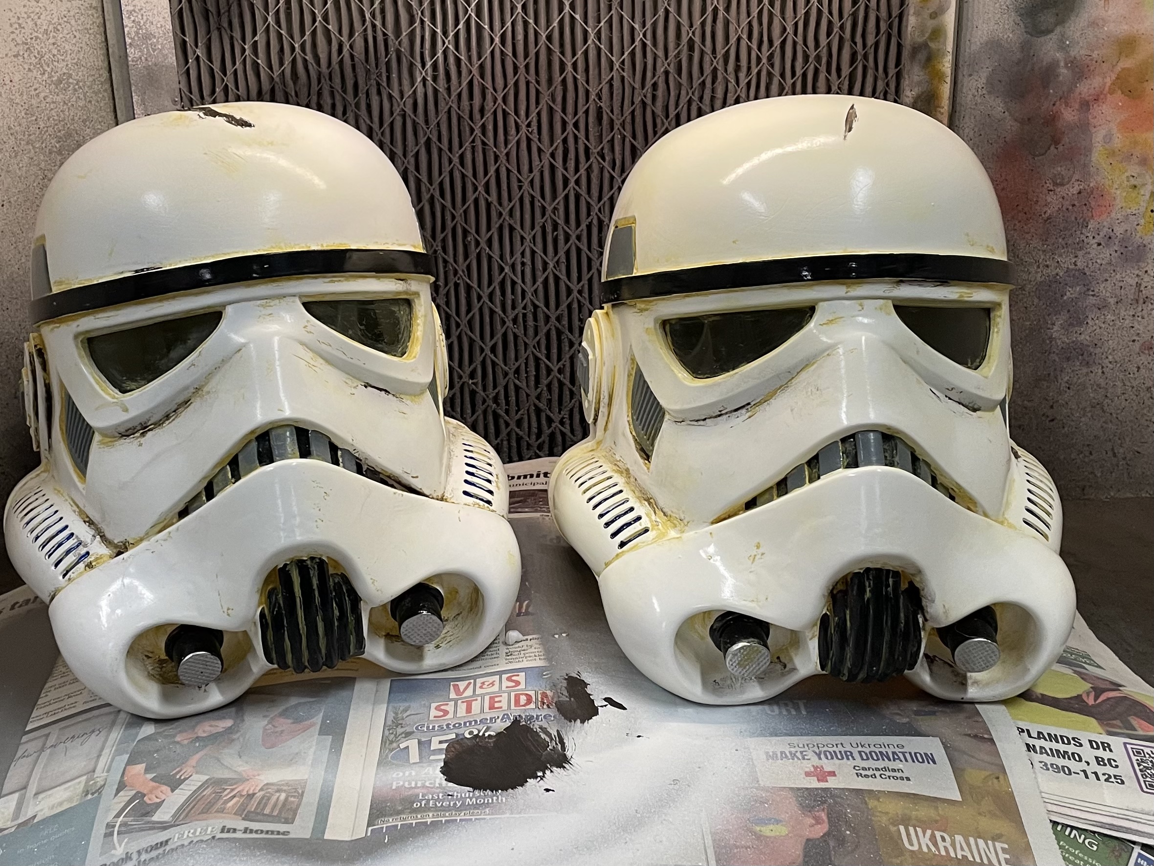

I dremmeled some damage into the helmets and added some acrylic brown and sand paint where I thought dirt would build up.
View attachment 1579174 View attachment 1579172
A couple of rounds of adding grime and removing grime with isopropyl alcohol until I was happy with the result and then I added some overspray with Montana Sahara Beige, building up heavy in areas that were more exposed. I added a few random brush strokes and paint splatter with a tooth brush and sealed everything with clear matte varnish.
This was a quick build, the lenses were done in an evening and paint work was a couple of hours.

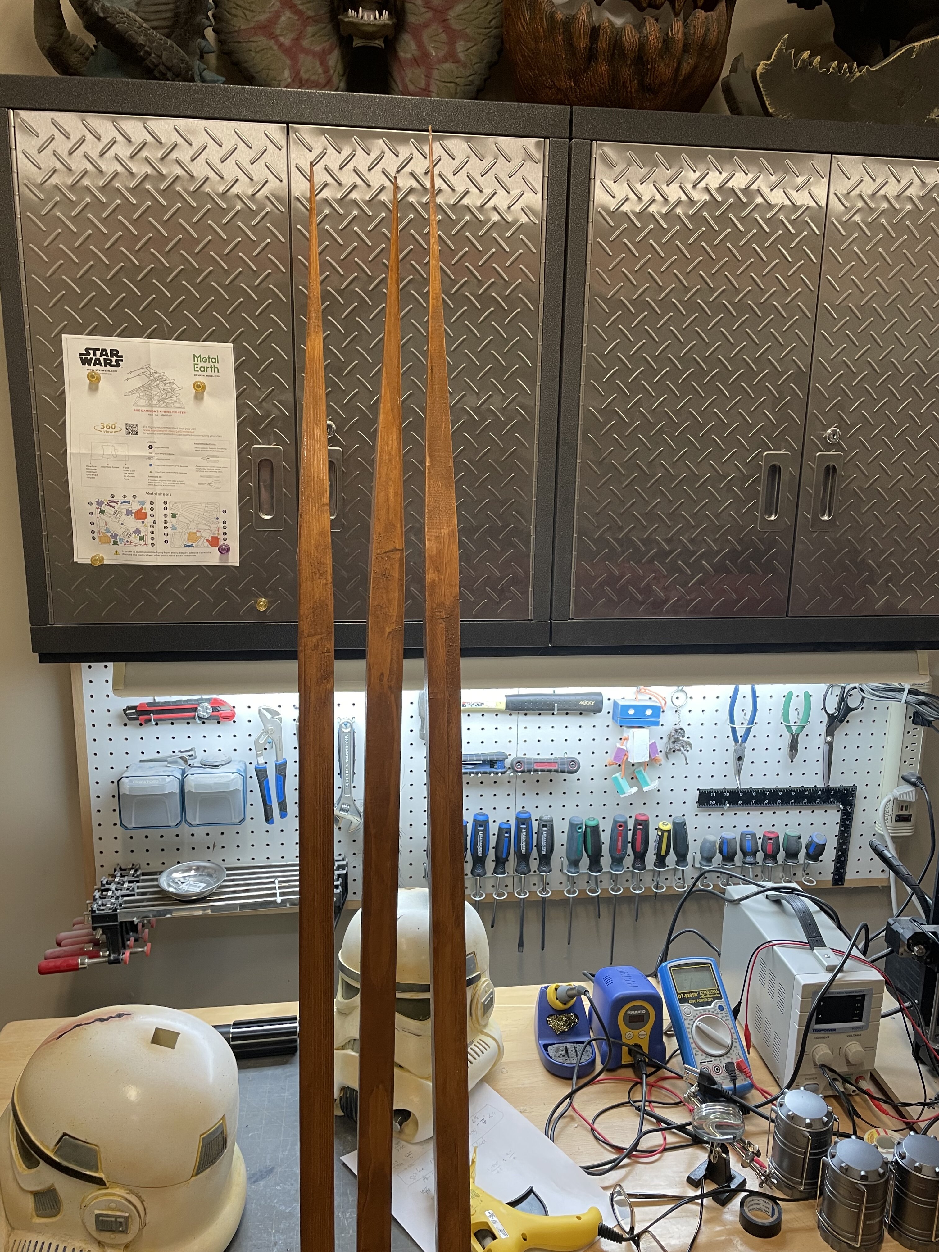

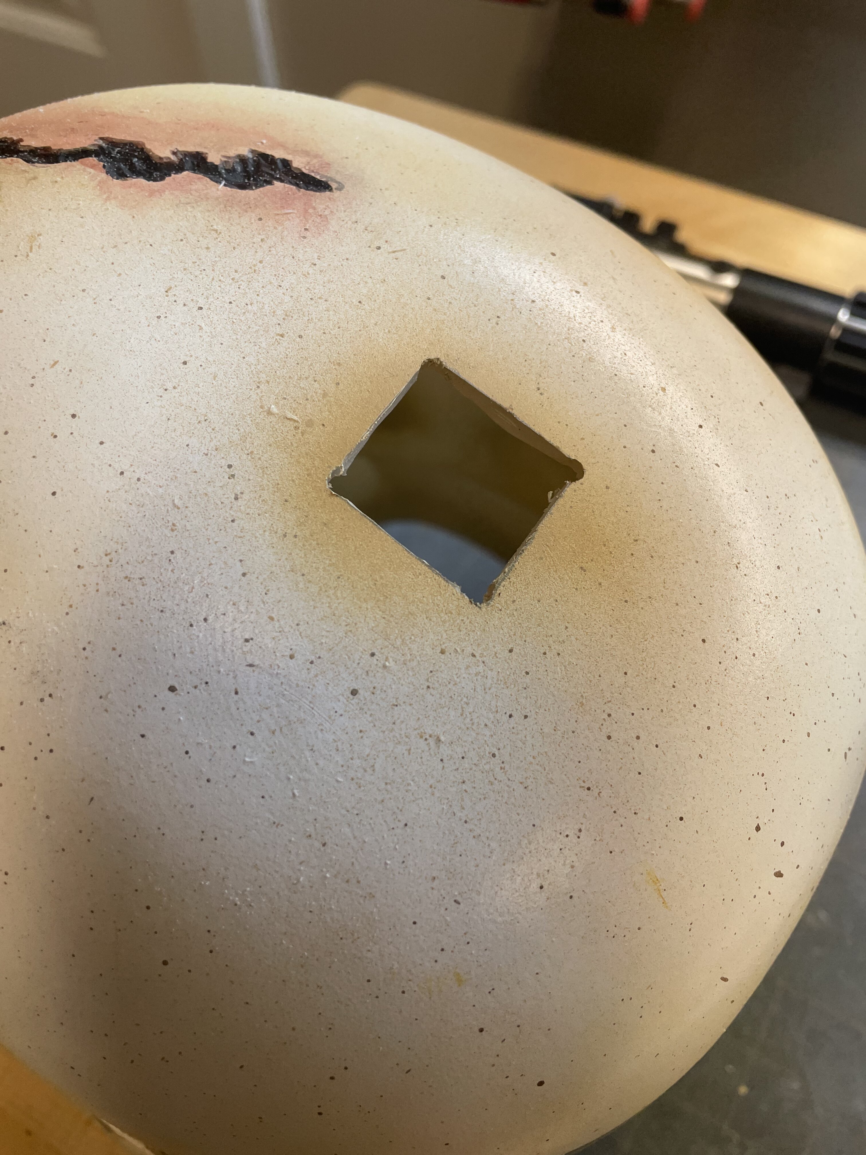

Ok so I couldn’t leave well enough alone. I purchased a couple of 2x4s and cut them down to 1 1/4” square and then tapered the ends on a bandsaw. I gave them bc a quick coat of stain and set them aside to dry.

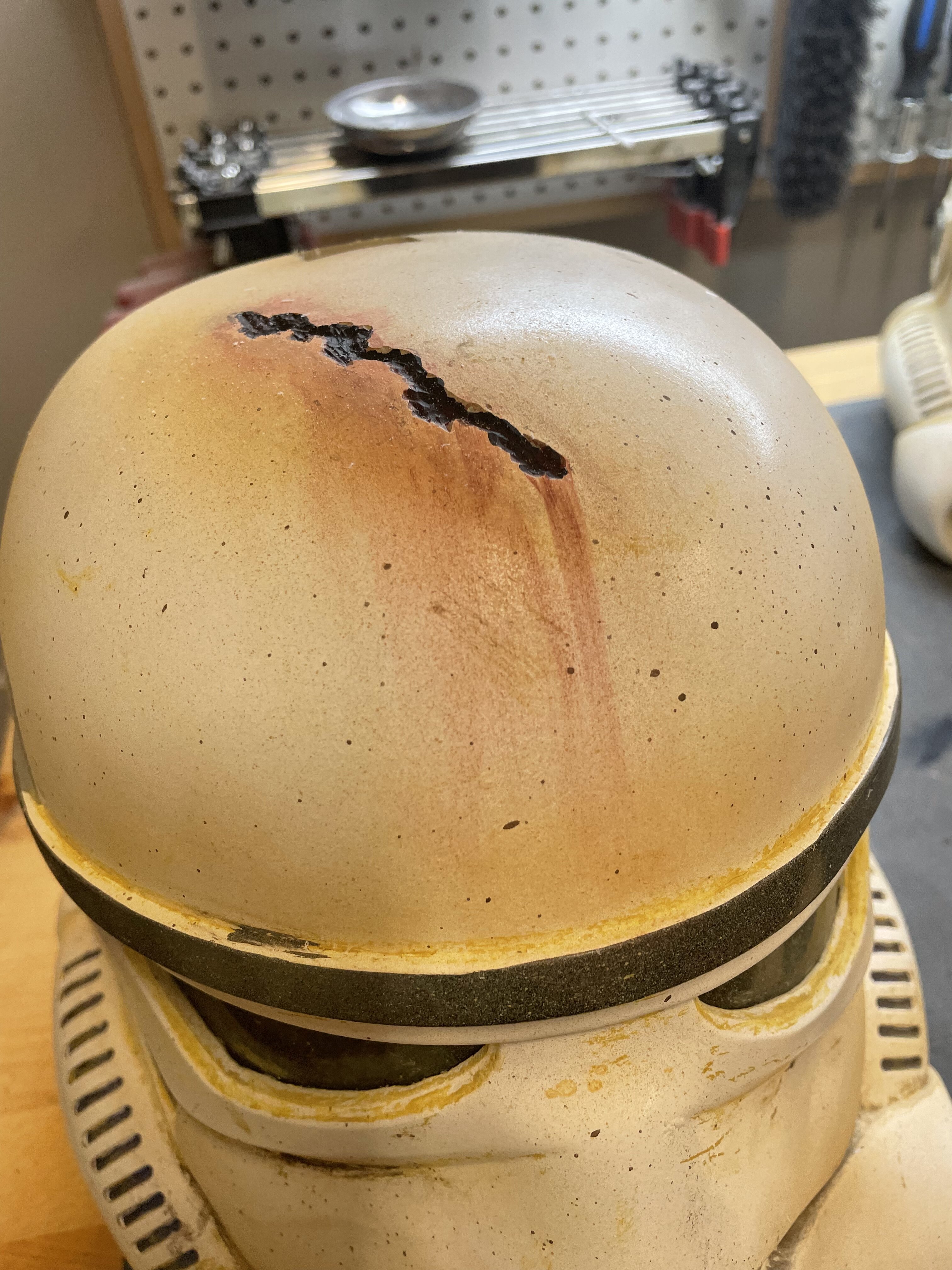

After looking at the reference pics from the Mandalorian Experience I decided to add a bit of a blood wash to a couple of the helmets. I just used some watered down acrylic.
I used my dremmel to change the holes I made to 1” square holes.

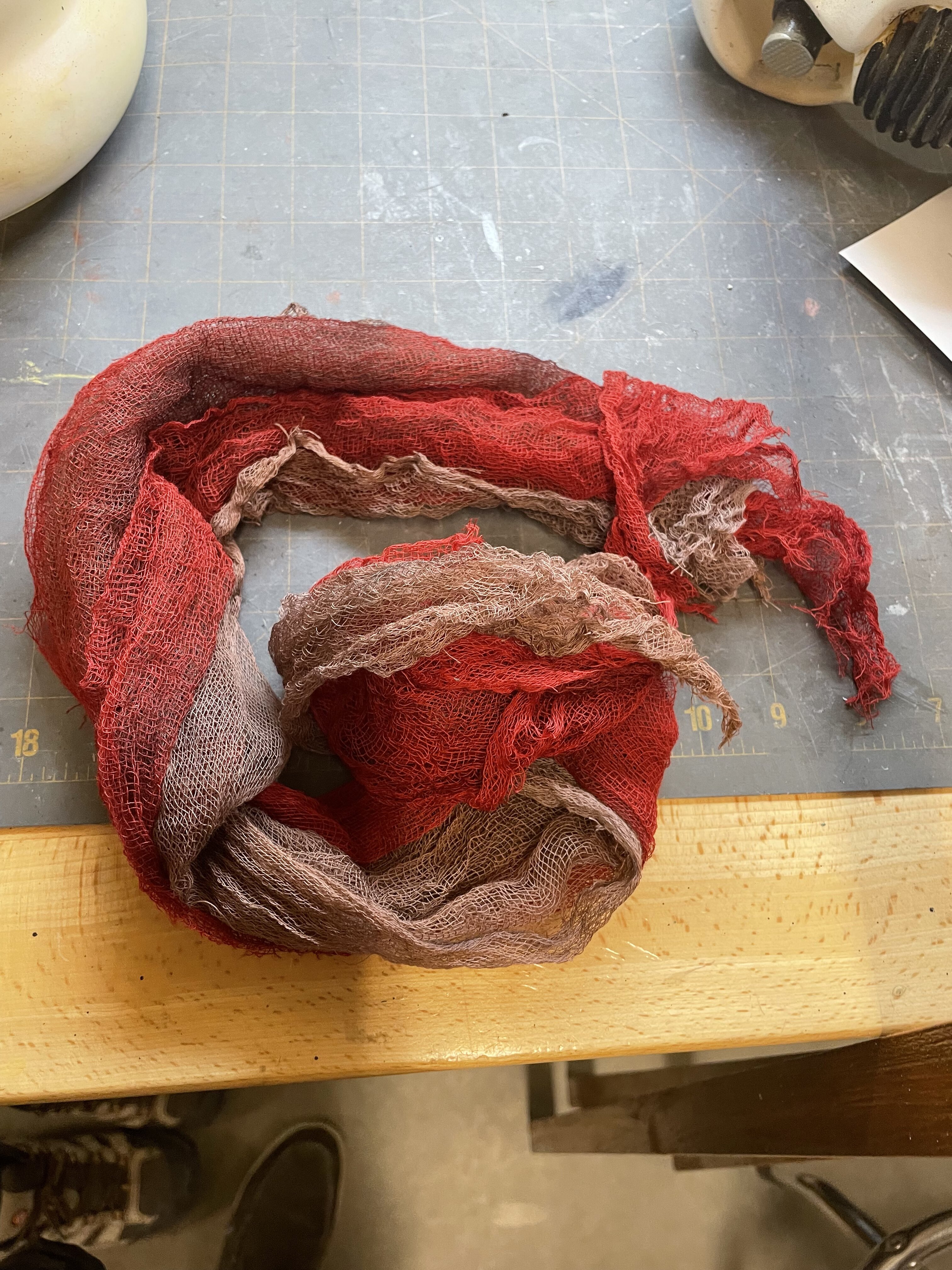

I dyed some cheese cloth brown and scarlet red. I used hotmelt and glued one of each color into the helmet.

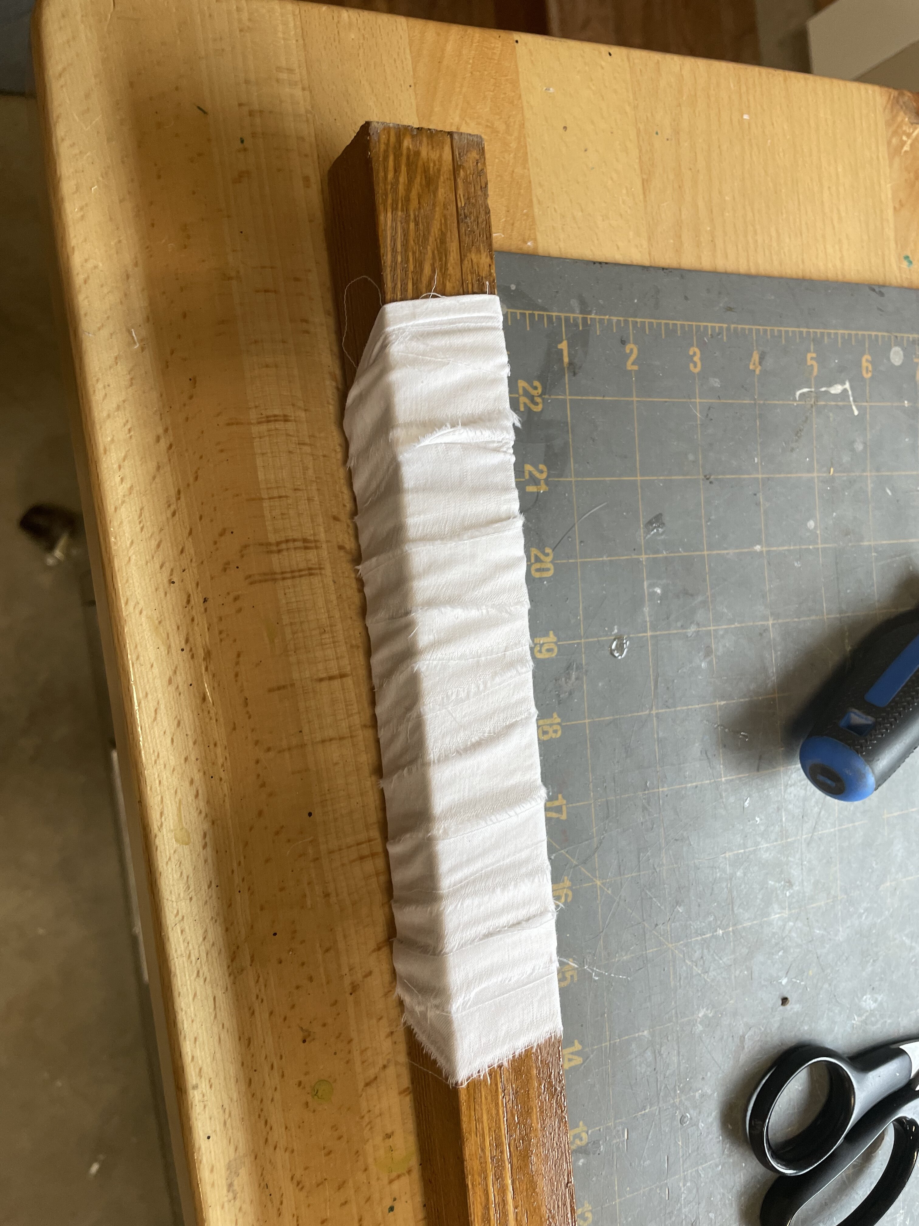

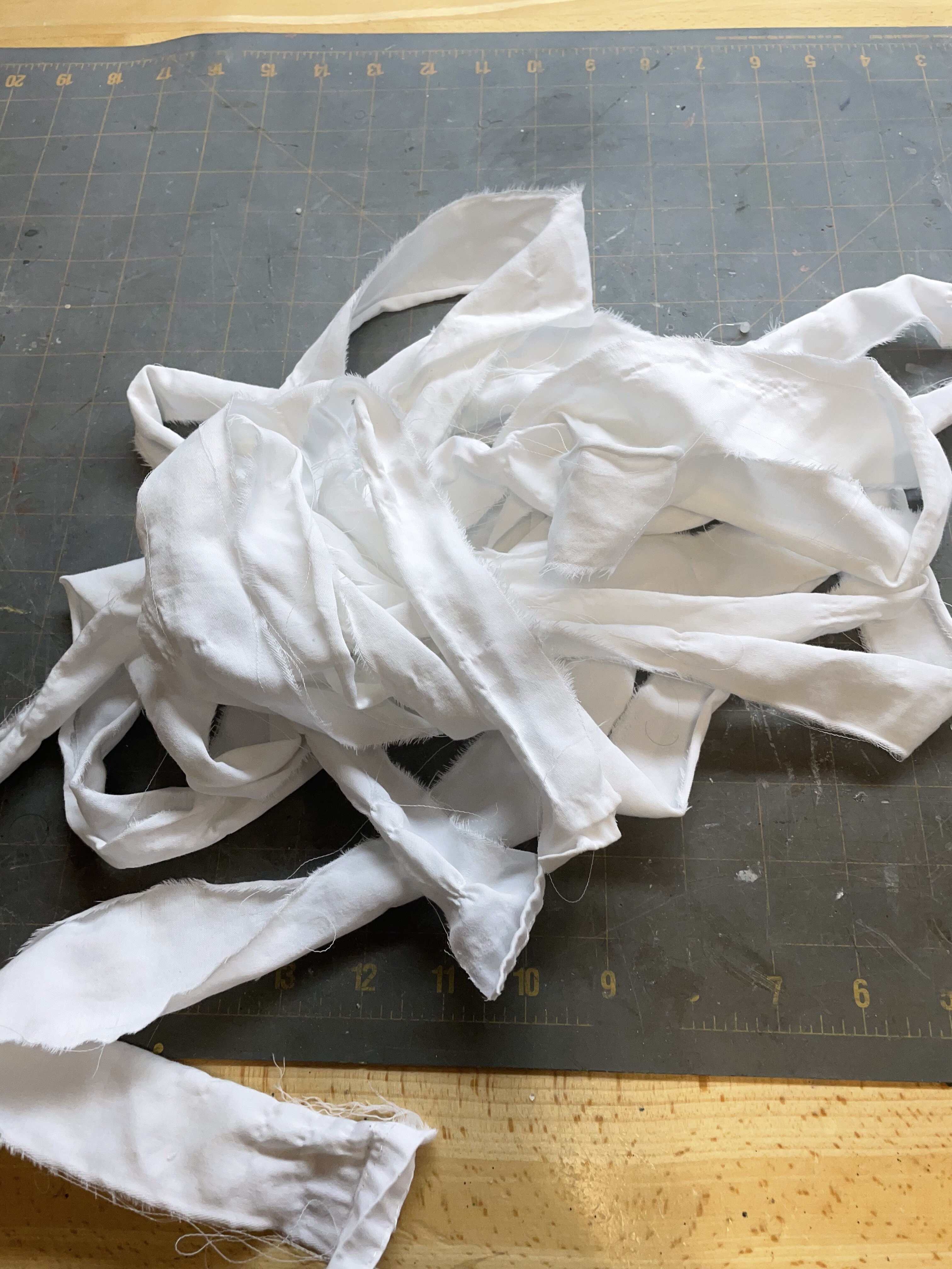

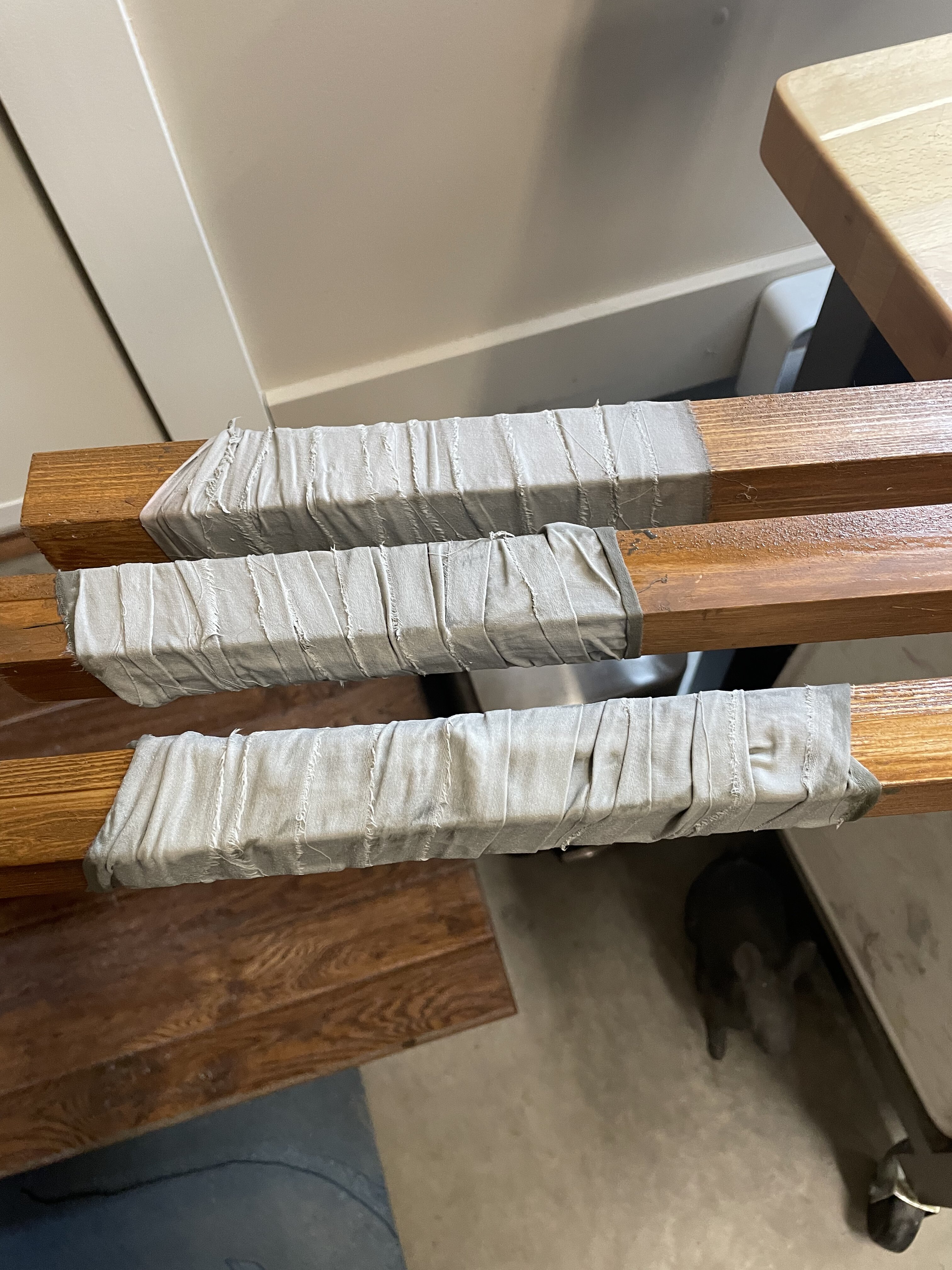

I did a dusty coloured wash on the spikes to take the newness out of them and ripped up an old sheet for the rags and wrapped the spikes.
938A86EA-9082-476F-B588-6F448010065B.jpeg 72741F81-587E-4226-A23A-03A8901CB7E8.jpeg
I gave the rags a bit of a wash to dirty them up and while they were still wet brushed a layer of modge podge matte to act as an adhesive so the wraps won’t come loose.

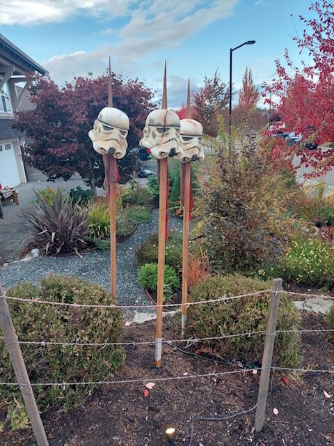

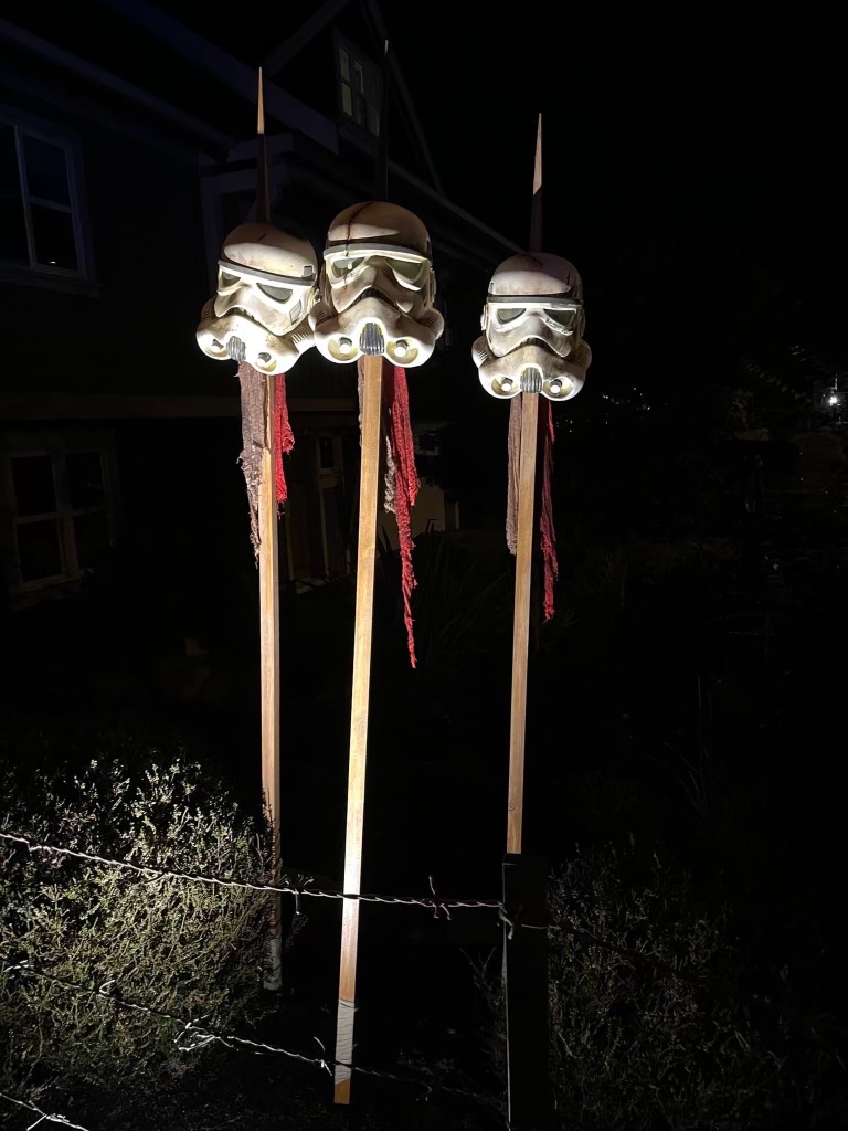

After looking at my posted pics and comparing with reference I could see my helmets looked too clean, so I did another round of acrylic weathering and went heavier than I normally would.
And I am calling these done! For sure this time!
