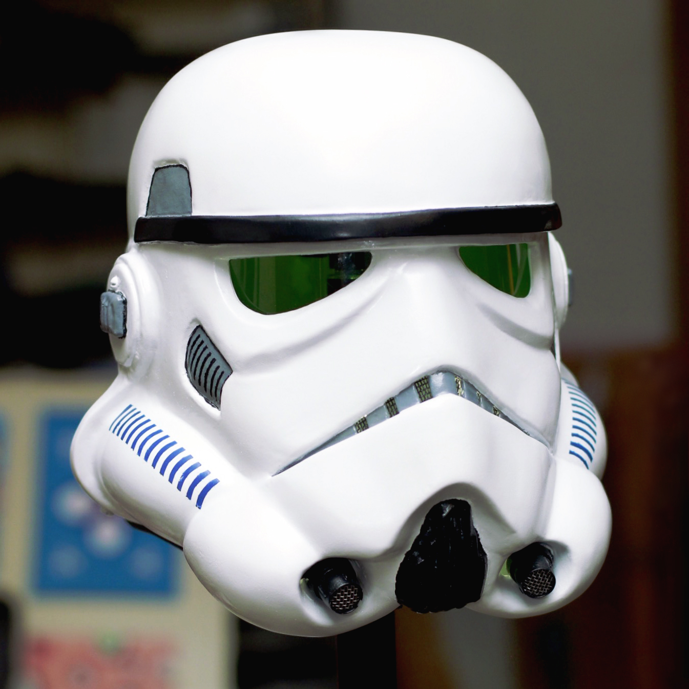

Here is the first finished helmet in case you can't wait (finished and sold to a friend January 22):

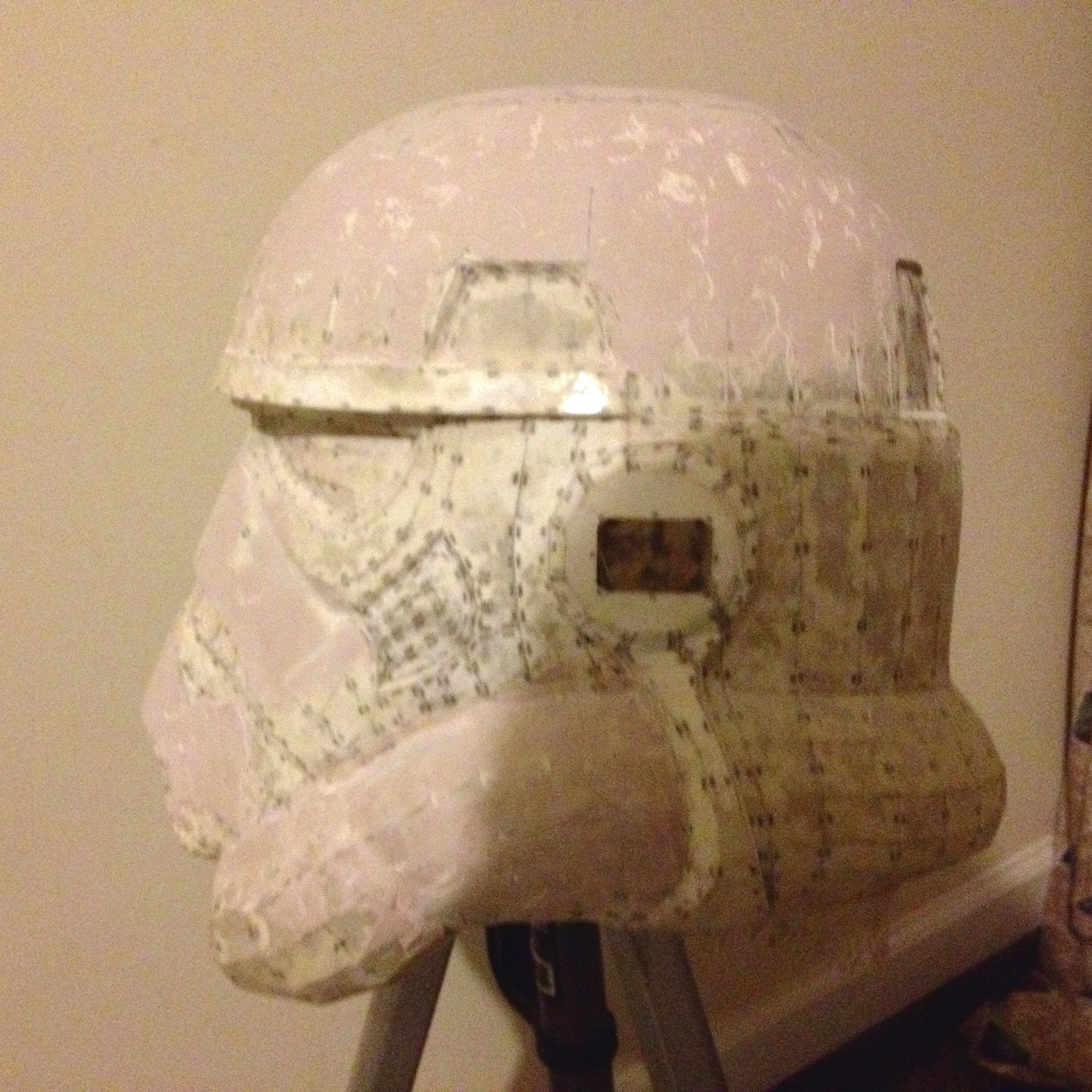

Resin & Fiberglassing ... yuck.
This was my third time fiberglassing a helmet so by then I was pretty accustomed to the process however no matter how clean I tried to be it was still a major PITA. I never mind the smell because I wear a respirator however I always seem to manage to get this stuff where it doesn't belong (skin, clothes, etc.). Thankfully it's only a 1-2 day process so it was over quickly.
It was at this point that I realized trying to pep and resin the vocoder wasn't going to work and that it'd be best to just improvise it myself later. To keep the lower end of the helmet's shape I just hot-glued a spare sheet of cardstock and fiberglassed under it. This would be the first original file detail I end up having to remove for the sake of an easier bondo workflow. (Also important to mention that I chose before hand not to pep the ear pieces (the bumps) for the very same reason)

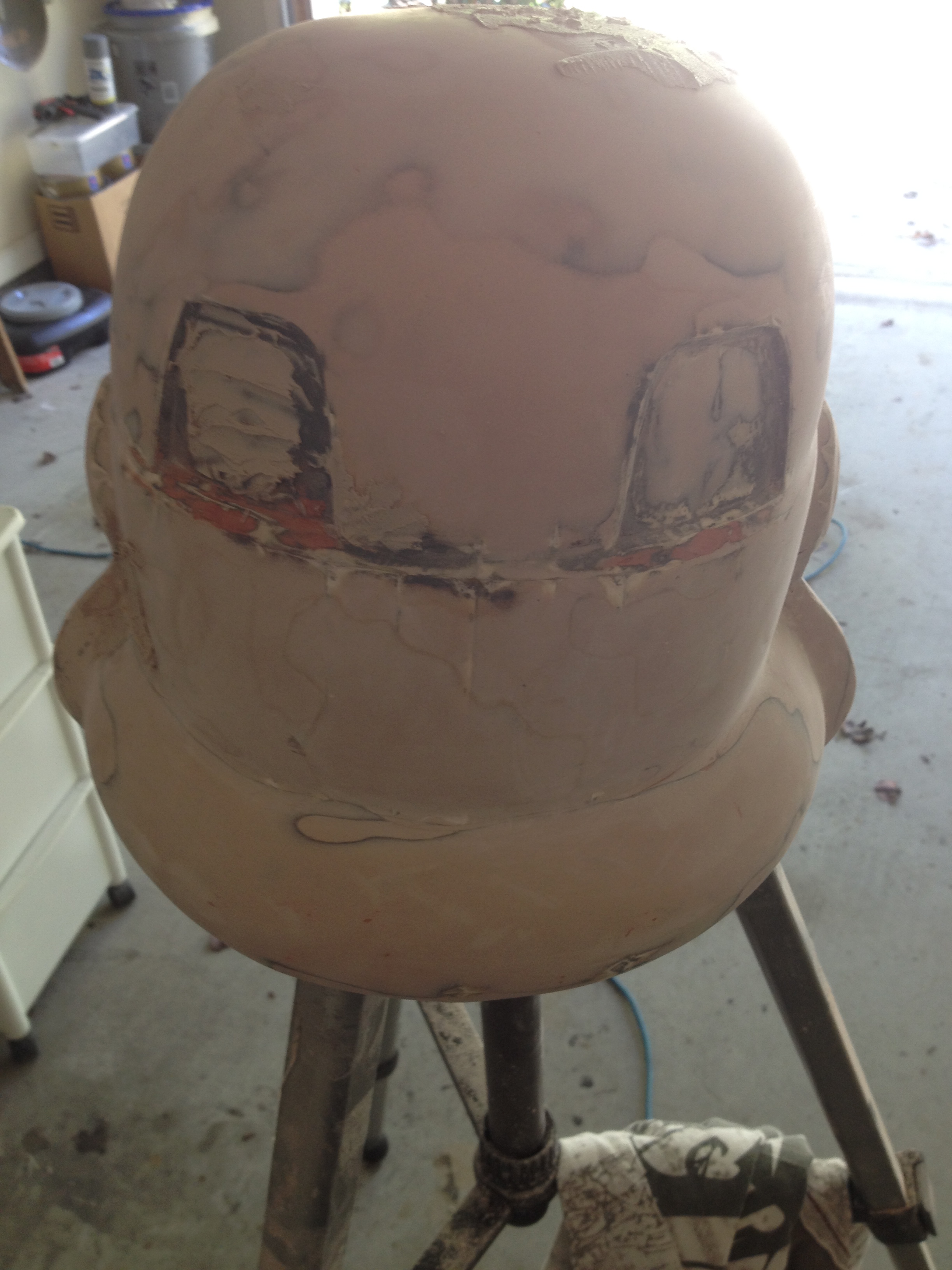

Finally the groundwork for the rest of the bondo work was done. I smoothed out the dome and it no longer looked polygonal! Make no mistake though, I was still far from being done with the bondo ... oh so far.

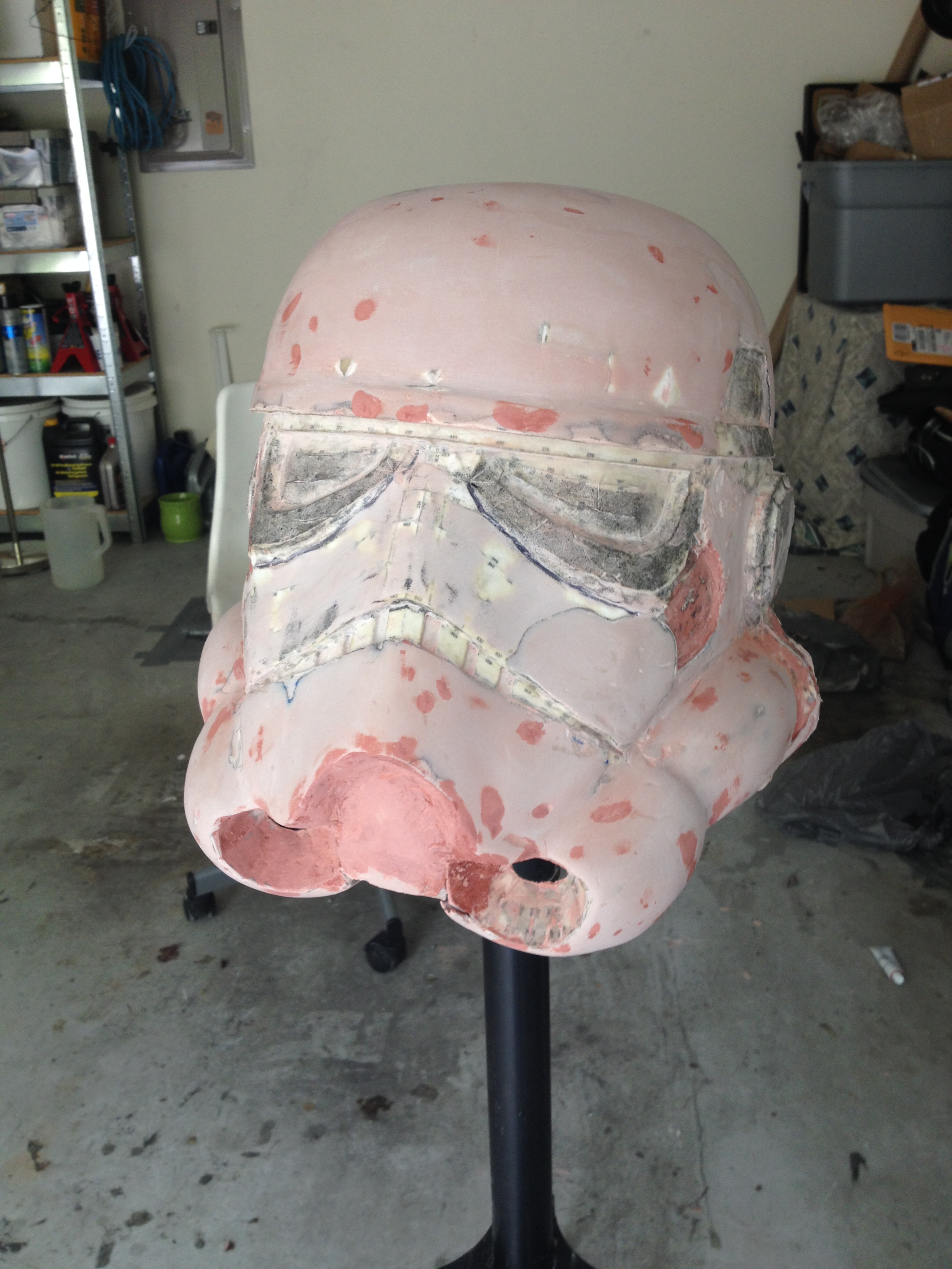

I had roughly finished all of the large flat and curved areas (dome, cheek tubes, back) so it was time to start smoothing out the difficult spots like the trapezoids and eyes. This seemed easy at first but turned out to be somewhat difficult due to the small angle each trapezoid is indented at. I decided not to continue trying to smooth out the eyes as I would just end up cutting them out later anyway so that saved quite a bit of time.

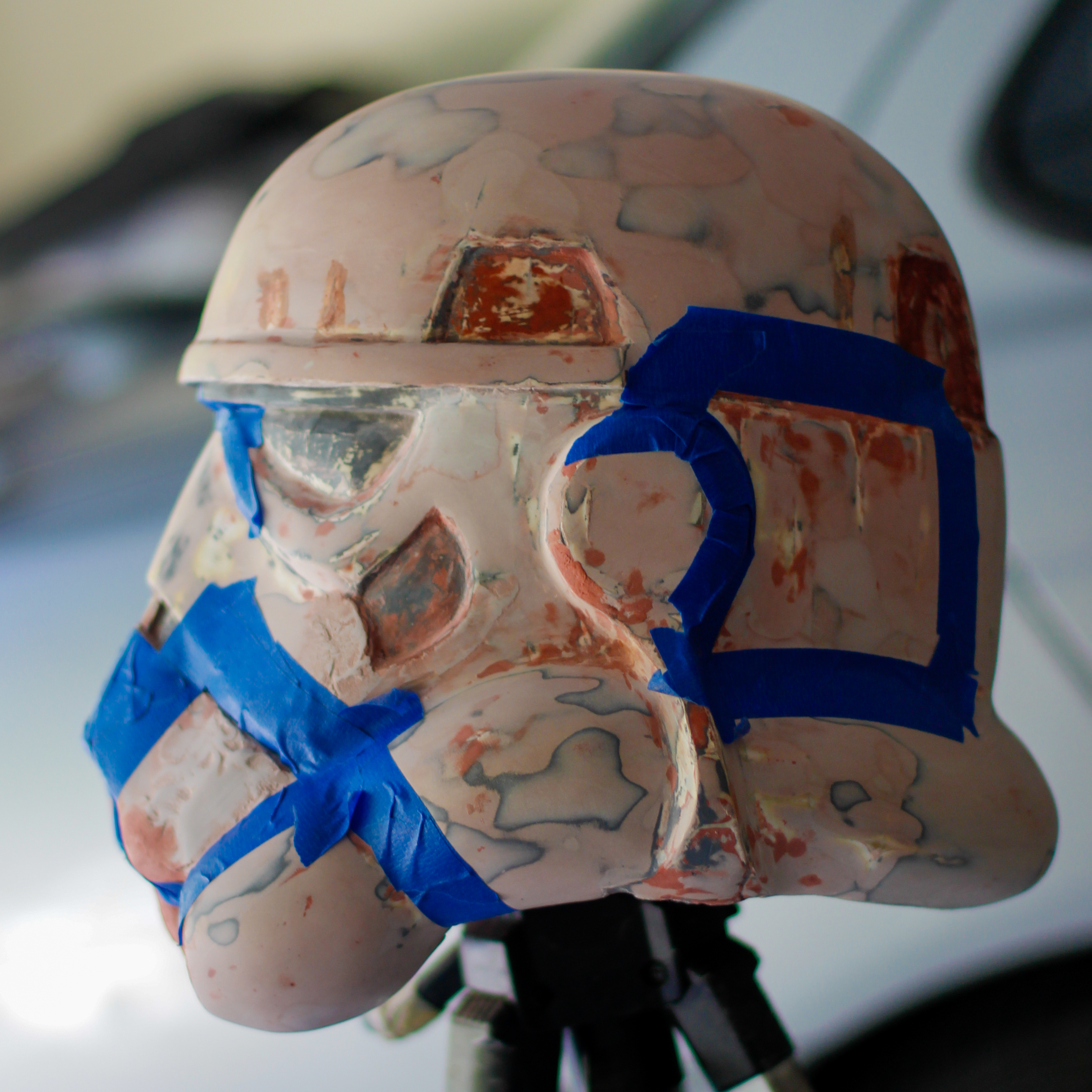

*I finally decided to stop being lazy and start taking photos with my actual camera. If you're anything like me you love seeing some sharp photos of a project build*
So I noticed that the area below the teeth was too flat and didn't have enough of a curve to it so I used painters tape to make sure I only put bondo on the areas that needed to be raised. After applying the bondo I would quickly remove the tape before the bondo set then smooth the hard raised edge in with the rest of the helmet. The same applied to the area behind the left ear, it was too flat and lacked the proper curve.
