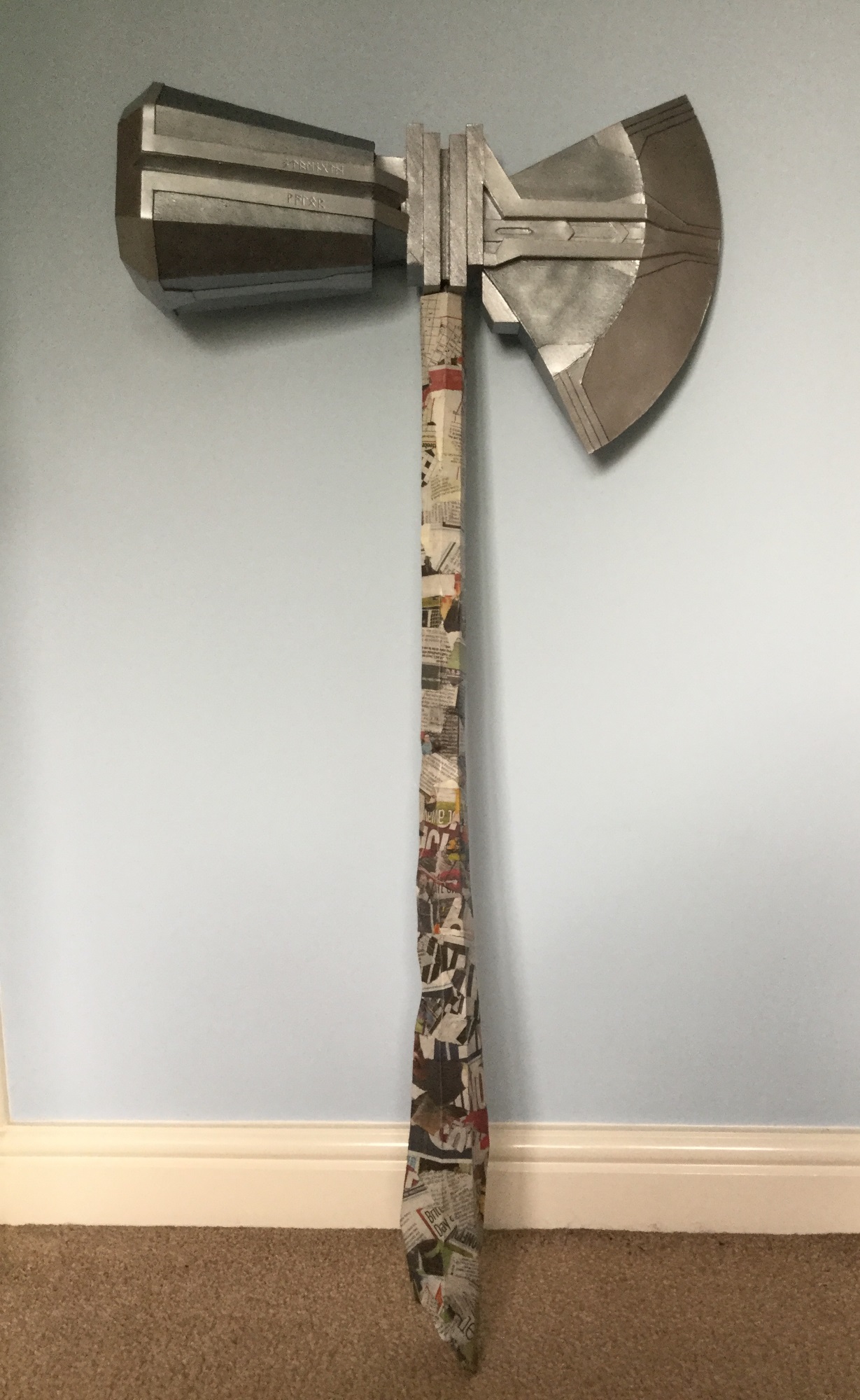

I absolutely adore Thor's not-so-new-anymore weapon and with Endgame just around the corner I knew I had to add it to my collection!
For this build I’m using the awesome Herban - Props/MasterMod Pepakura file as a base, which I downloaded from here. This isn’t the most detailed model but I plan to use the handle pieces for my build and the rest as a reference point for creating my own model for the axe head. Another brilliant resource that I will be using for this project is the MCU Wiki’s Stormbreaker Gallery which has some beautiful high-res shots of the axe, including behind the scenes photos that were great for working out the scale of the prop. Using these, I estimated that my replica should be around 120cm tall – coming up to the middle of my stomach as it does on Chris Hemsworth.

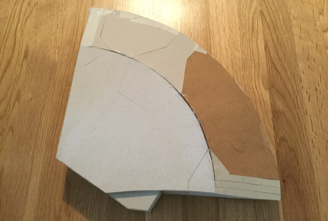

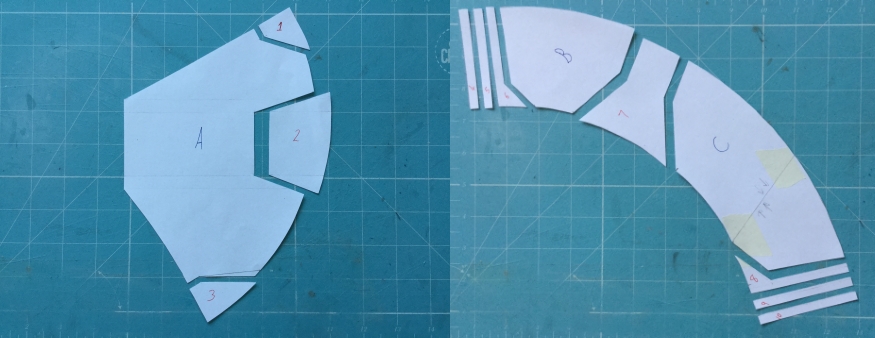

I decided to start by building the axe head because it takes up such a huge portion of the prop but also has the least number of parts so I figured it would make an easy starting point. After printing out the Pepakura file, I began drawing on the various detail and panel lines before transferring the templates onto cereal box card. I love working with this material purely because of how versatile it is – it’s thin, flexible, available for free in abundance and with the right reinforcement it can be really hard-wearing!
Speaking of reinforcement: to strengthen the card (not to mention give Stormbreaker some realistic weight) I glued a piece of roughly-cut hardboard to back of the large side panels, then coated the inside of the blade with paper mache. I also glued a series of cardboard “ribs” into the axe blade to help maintain the shape and curve.

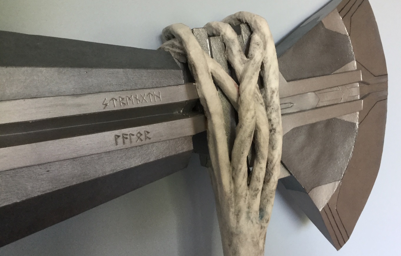

Next, I shifted my focus to the finer details. Purely by chance I stumbled across the Original Prop Blog which has some amazing photos of Stormbreaker on display at SDCC last year. For the thicker details on the axe I used cereal box card and assembled them from (complicated!) 2D nets, followed by pieces of foam and card for the thinner details. For the raised details on the counter-weight I used strips of craft foam before etching the Norse symbols into the sides using a pencil. (Fun fact: these symbols actually spell out the words “strength” and “valor”!)

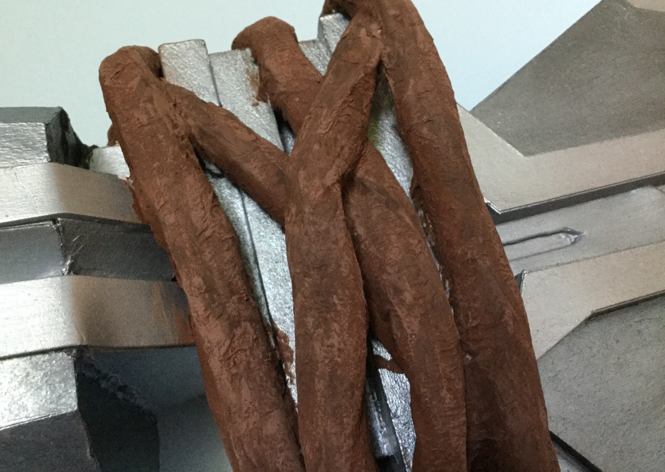

To recreate the vines for Stormbreaker, I rolled up sheets of newspaper and wrapped them around the head of axe, before coating them in paper mache to strengthen and blend the vines into the rest of the handle. Then, to give the handle a rougher, more tree-like texture I gave it another coat of paper mache (this time using kitchen towels.)
To paint the handle, I began with a 'cinnamon brown' undercoat - followed by a heavy dry brushing of lighter brown, followed by a much gentler dry brushing of darker brown. Overall I'm really happy with the mottled effect of all the different shades combined with the rough texture of the paper mache; it actually has the look and feel of real wood!

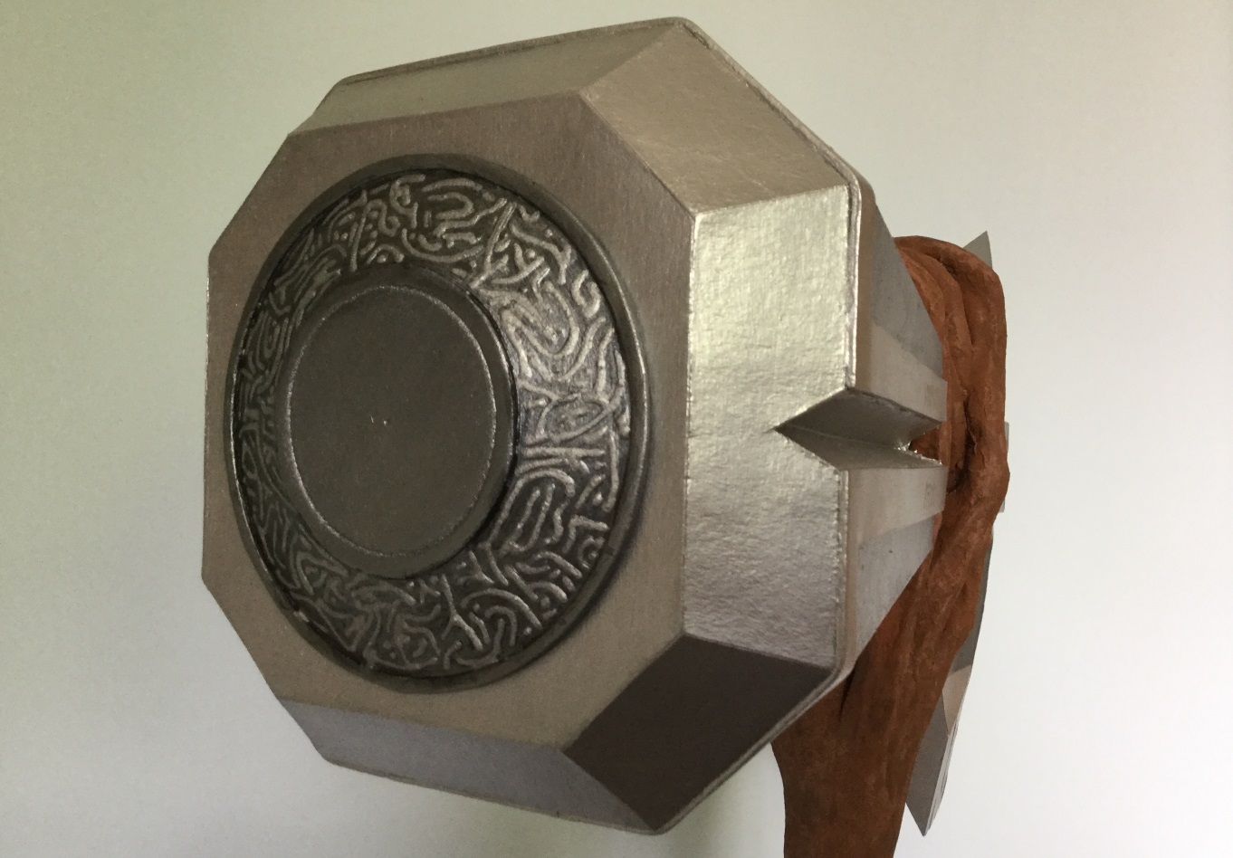

Finally, for the "impact disc" on the back of the counter-weight, I built the Pep file from my first post using more cereal box card (only using foam for the centre circles and the outer ring.) After sealing the foam and painting it dark silver, I began drawing on the raised Norse patterns using silver 3D paint - tracing over the designs twice to get what looked like the correct thickness.
I then brushed over the disc with a black wash to accentuate the raised patterns before gluing it onto Stormbreaker.

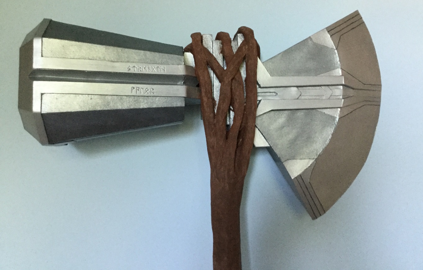

And that concludes my Stormbreaker build! I'm really, really happy with how this turned out especially considered how I managed to build this completely for free and in just 2 and a half weeks! I'd love to know what you all think. ;)
