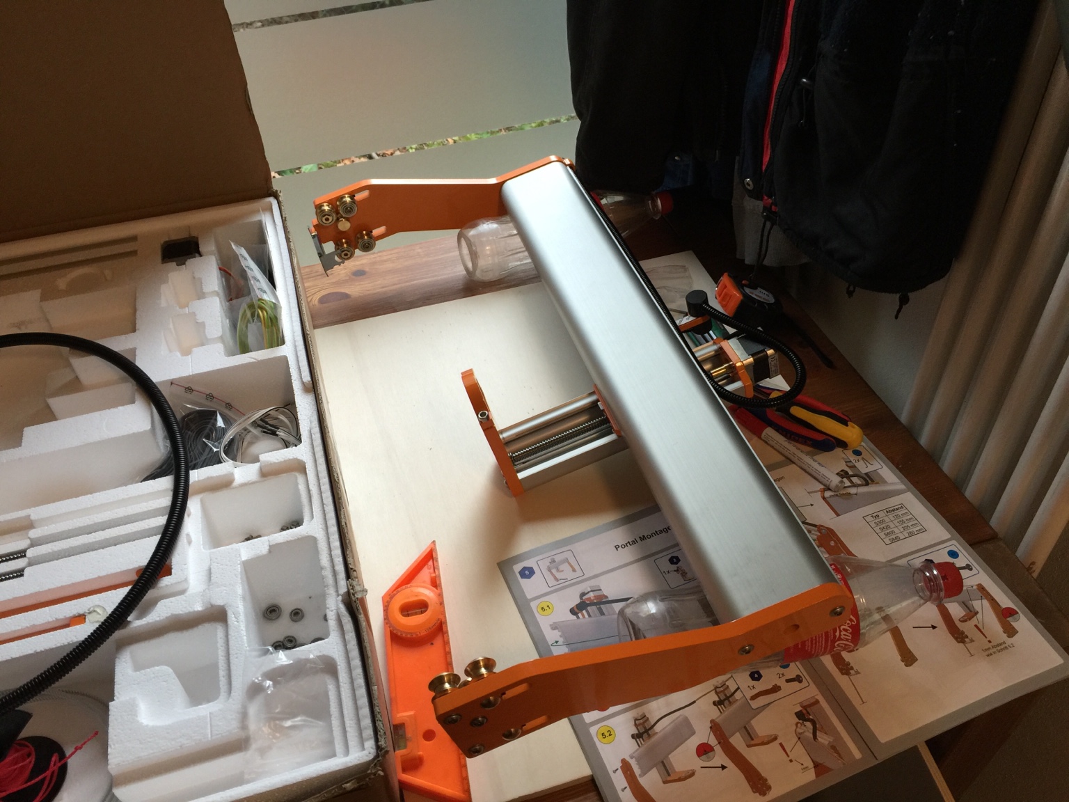

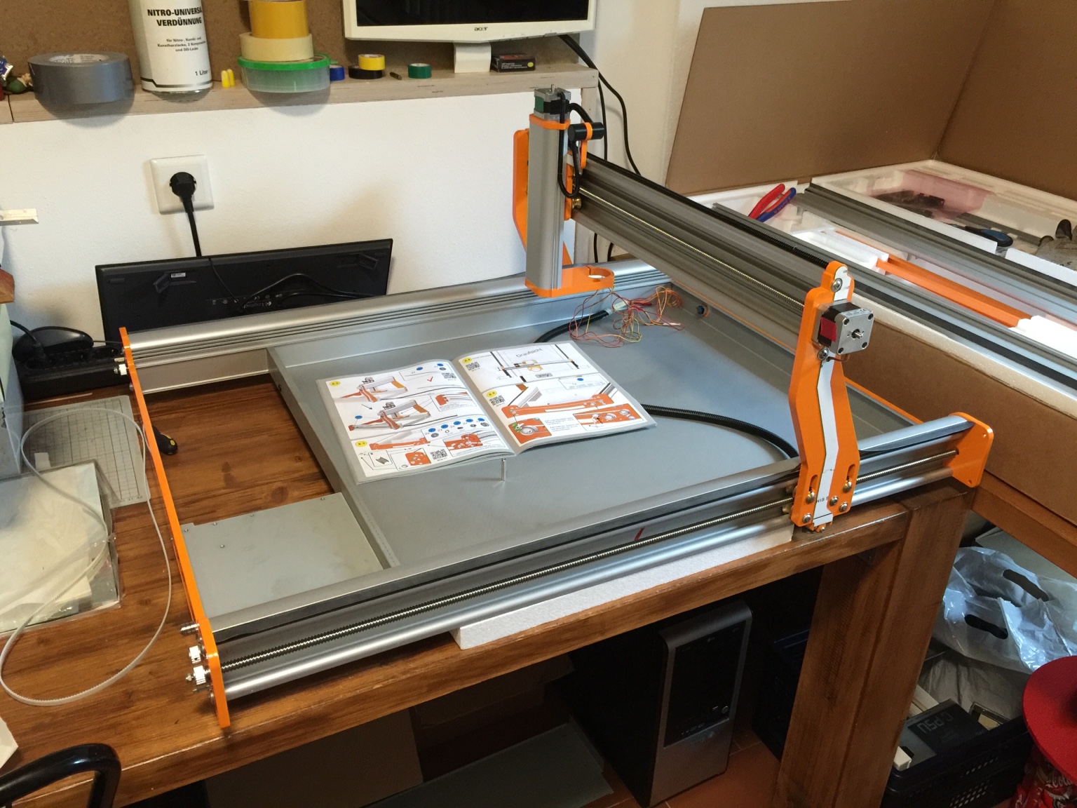

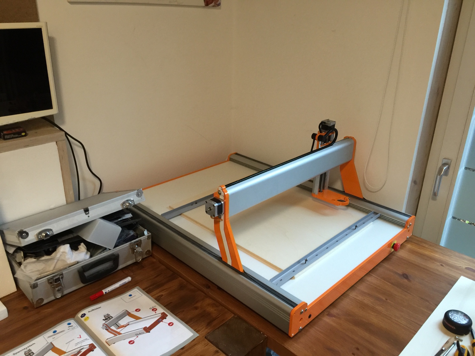

I try to document every step. Maybe it's helpful for someone who also wants to join the CNC fun ;)

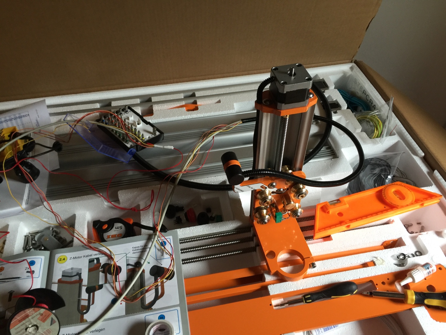

So, I tested it and run into a few problems. First the cabletube gets stuck every time I move to the front left side. I need to find a solution for this, otherwise I'm afraid I can't build large object without worrying about ripping my cables out.
Second my reference Triggers are always "triggered". When I manually trigger one, it gets untriggered. I googled the problem and found that in the Shareware WinPC-NC USB (199€) you can invert the signals. I think I'll buy that software anyways to get more than just 2D milled. So yeah, I bit frustrated about the little issues, but I hope it'll get better tomorrow. It's quiet a learning curve if you haven't worked with similar technology before. What Import and Export Formats to choose...what programs to use for what...what tools to use etc.

The aplied free version of winpc should let you change the switches too.
I run a simular gantrymill with linuxcnc wich is free too. Takes a bit digging into the software settings though. For testing just get a old pc and download linuxcnc and install so you dont have to use your normal computer.

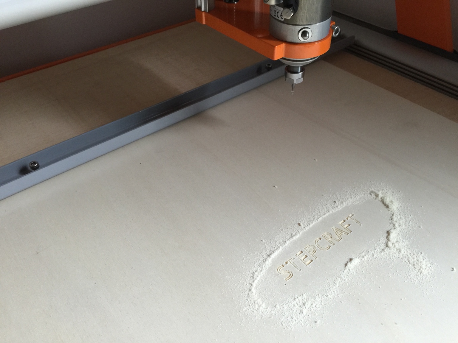

Thanks for the advice. I bought WinPC-NC USB today and voilà everything works like a charm :)
Now to the cable tube :)

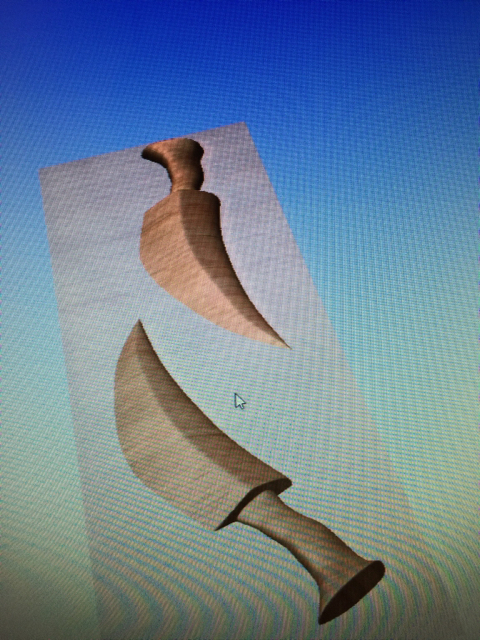

First up the 3D model:

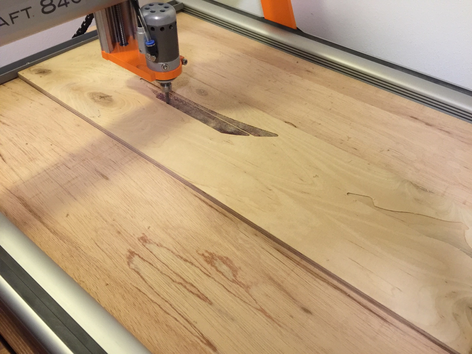

I cut it in half so my CNC router can work with it. Now I need to make rough pockets :)

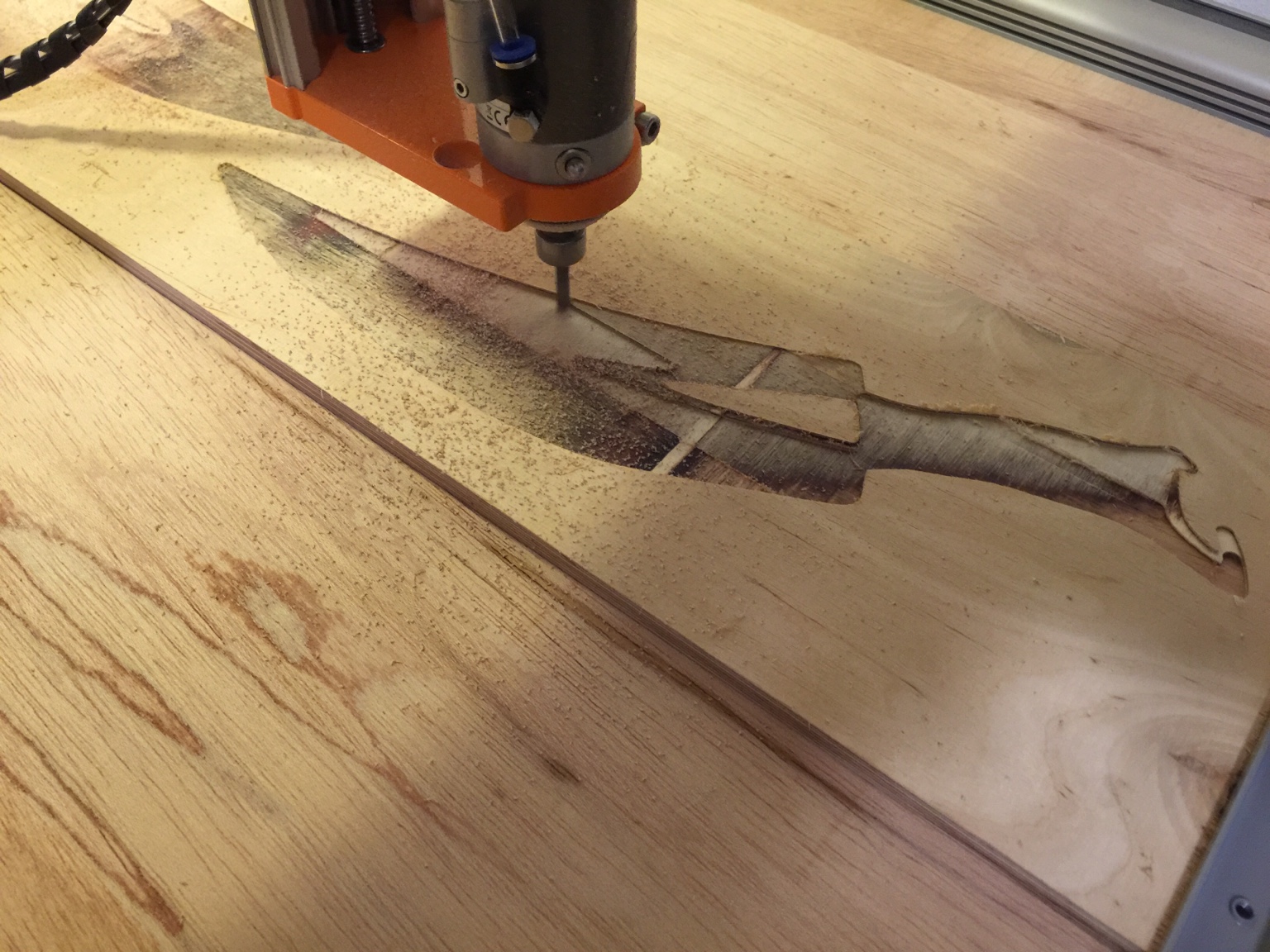

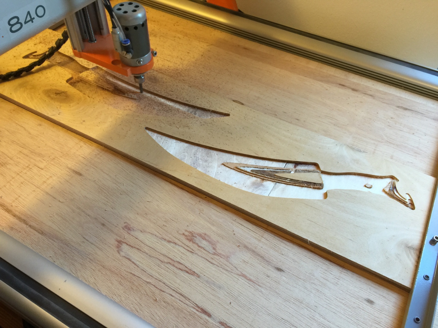

I decided to make the rough path with a 6mm flat end mill and the fine path with a 3mm radius end mill.
Mill is set to 20000 rpm
Here we go:
So far so good
