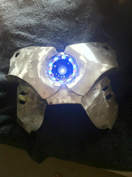

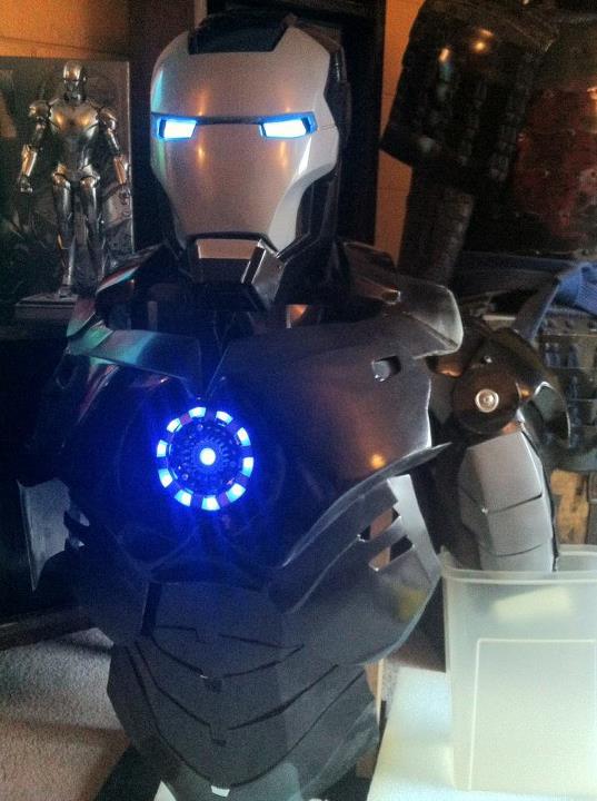

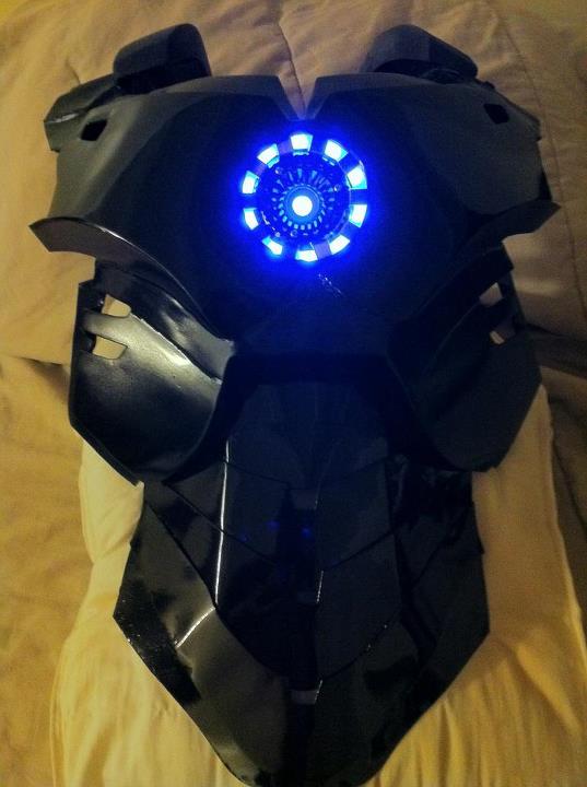

just wanted to share my ironman project with everyone. this suit is made from steel by me. it is a work in progress but is fairly far along.

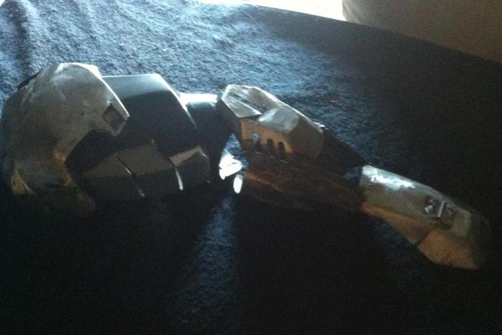

the helmet is a war machine. the main body legs and part of the arms are mark iv the forearms are mark vii. I bought the arc reactor off ebay actually. I plan on making one for my next suit and yes it will be steel and copper and everything nice.
samurai169
Re: my steel ironman project
oh and as far as the paint this one will remain black and grey my next will be red and gold unless i decide to make the mark viii from ironman 3 the red and white suit. I have some plans I am working on to make that after I finish this one off.

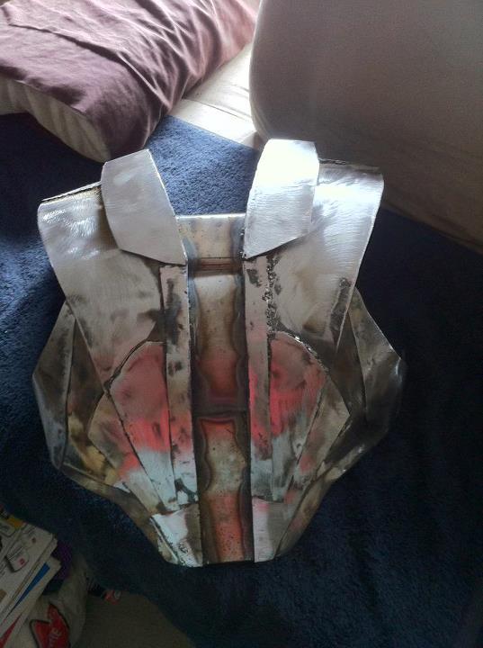

Does anybody have any suggestions as to flexibility for the abdominal/sides and lower back area? I've got an idea for my abs lets call it version 2.0 but just wanted to see if anyone else had any brilliant ideas.
Tigerblood
I actually do. My friend is a mechanical engineer and we had a discussion on how those parts can be articulated.
Pestilence2010
Look up how to build bannded armor, basicaly something similar to lorica segmentata. Each plate would overlap the one below it, and sliding rivets would attatch the plates at the sides while one or two leather or synthetic straps would be riveted along the belly of the plates to keep gaps from openning up in the armor. For a more detailed look at this type of articulation I suggest checking out The Armour Archive , and searching around there. They have a lot of good build threads and even some great essays on armor smithing. The suit I had been planning months ago was going to be 16 gauge steel, and SCA combat ready. Love the build so far, would like to see some more pictures detailing the construction.

Thanks darkside lover your work. That would work but not really what I want if I'm right the ab plating are not connected together as one unit. I have some ideas I'm going to try out of plastic before I commit it to steel. If I'm right the abs and lower back and lower sides will be able to be one complete piece that will be fully articulated. I'm not sure if it will be as flexible as that but we will see. I will update with lots of pictures if it works.
