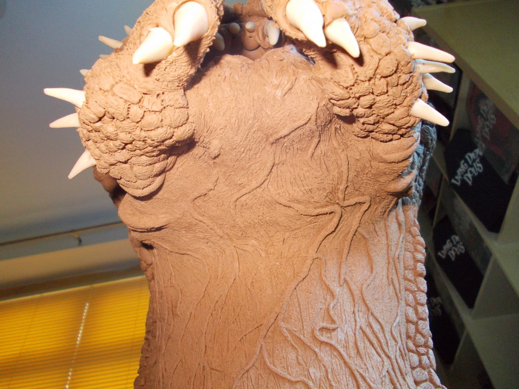

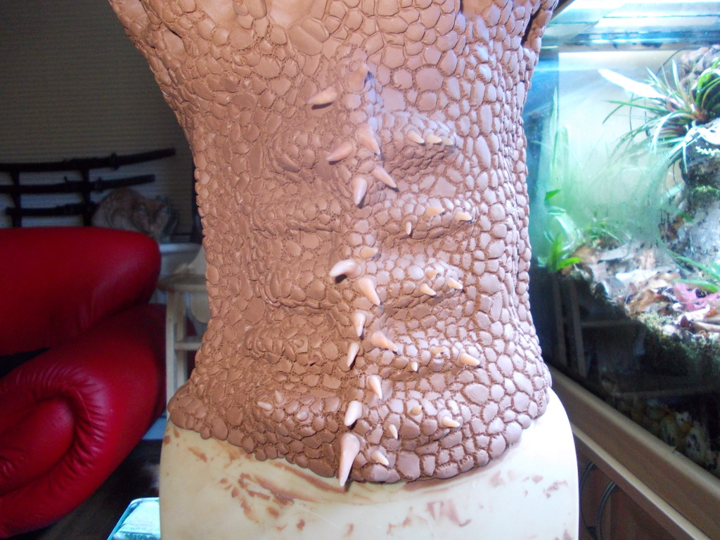

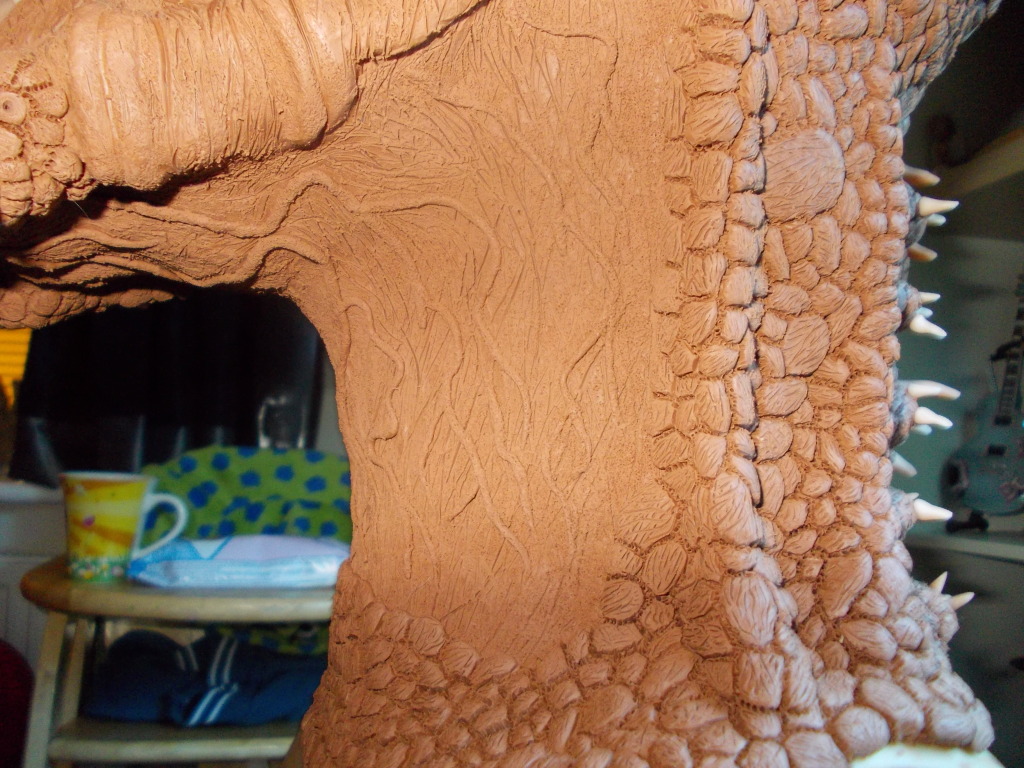

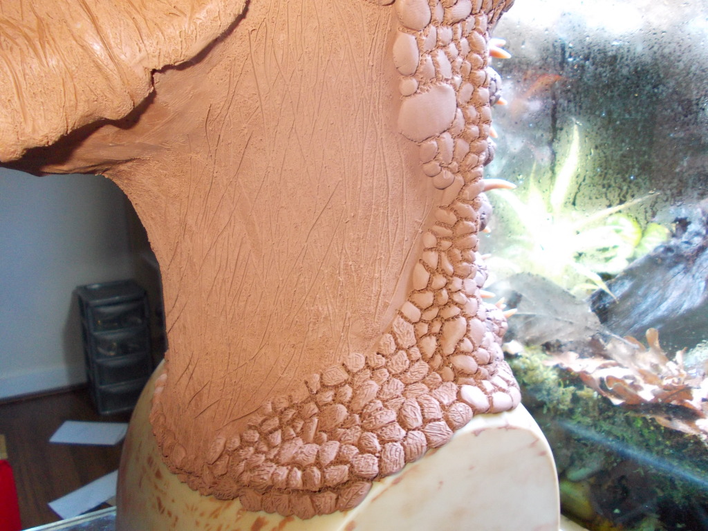

The texture is insaneee. How'd you go about the scale texture bits? Im just starting to sling some clay around but i havent gotten texture right yet.
Cheers ppl  I do the scales by rolling balls of clay then press them into place squashing them down then i have a metal tool that
i press in between all the scales after you get a big area down at this stage i get a cocktail stick and dab it all down the little channels hope this helps

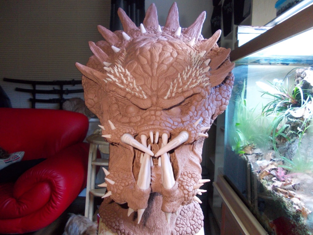

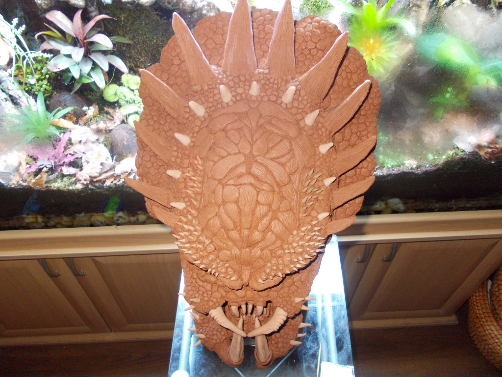

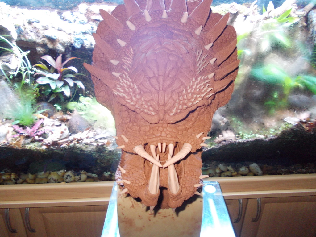

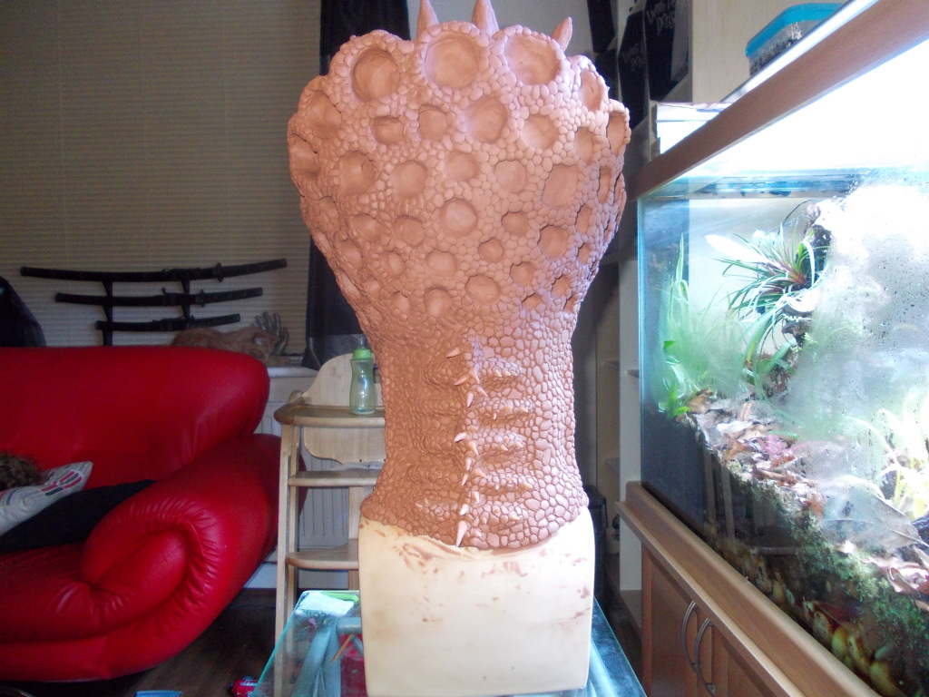

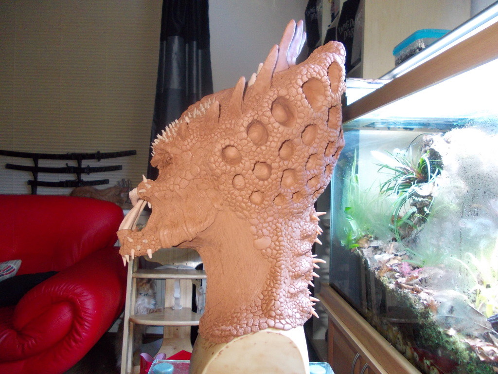

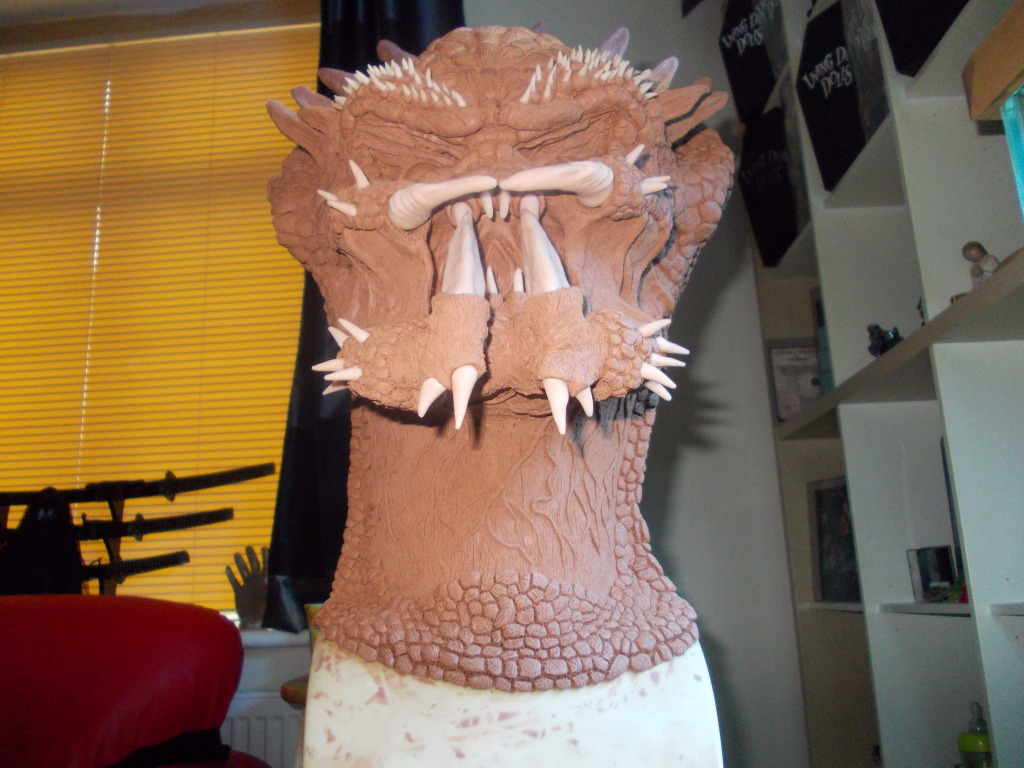

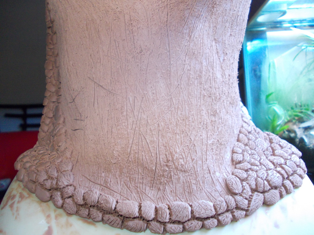

Ok not alot of progress but there is few bits done today more work on the scales really.  Heres the pics

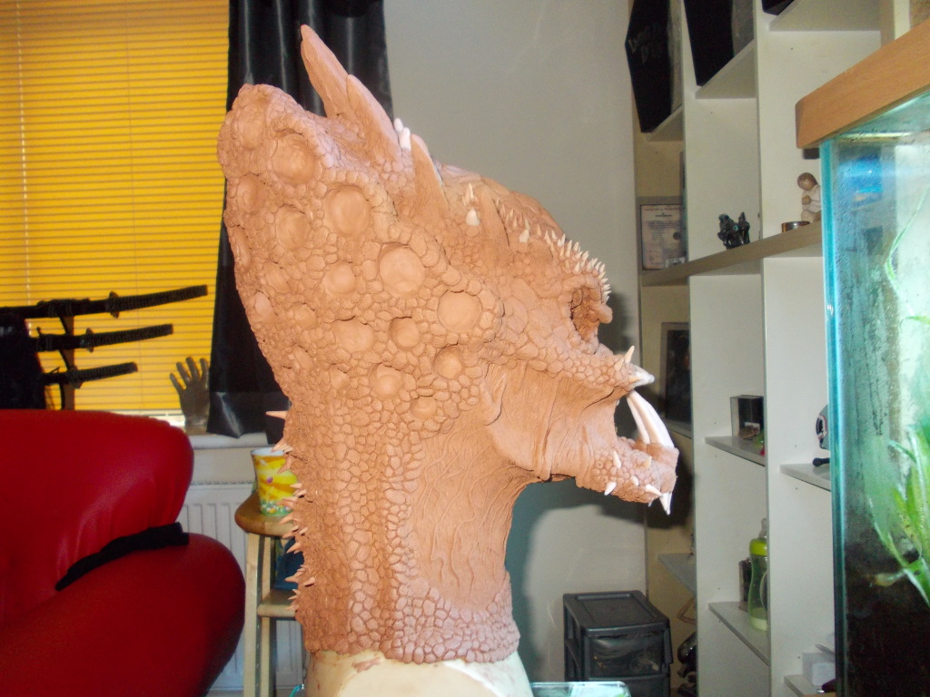

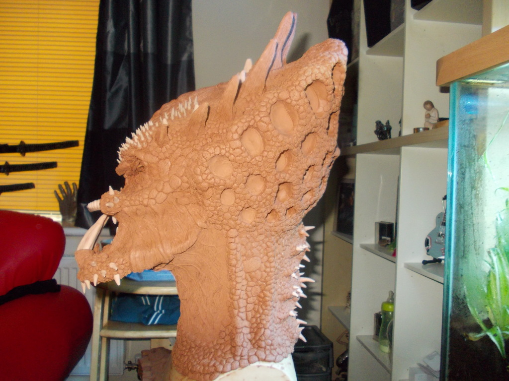

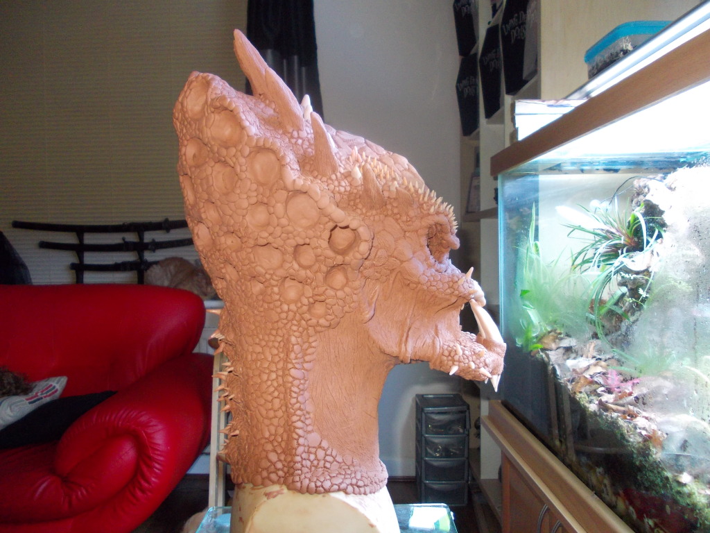

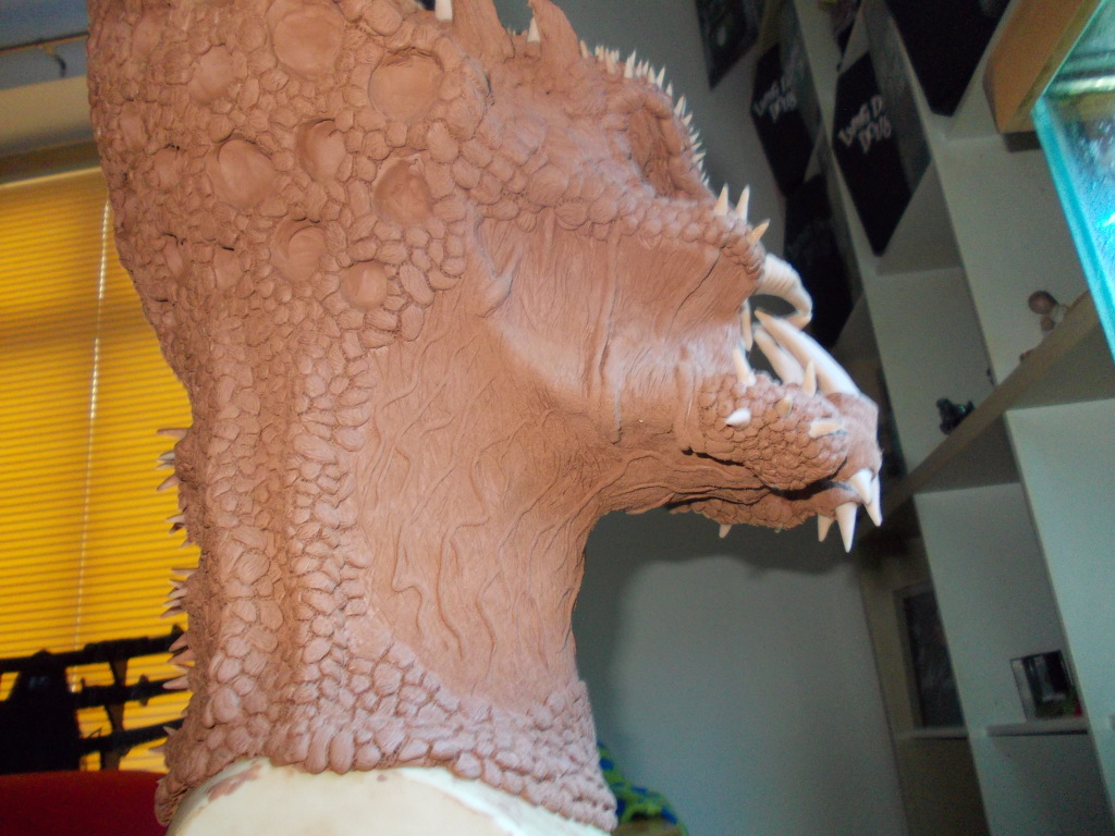

Ok im saying this is done now well sculpting anyway.  Will make a start on making the mould wall tomorrow.  I like the side view
on this looks pissed and badass lol need to get some burlap for the plastering.

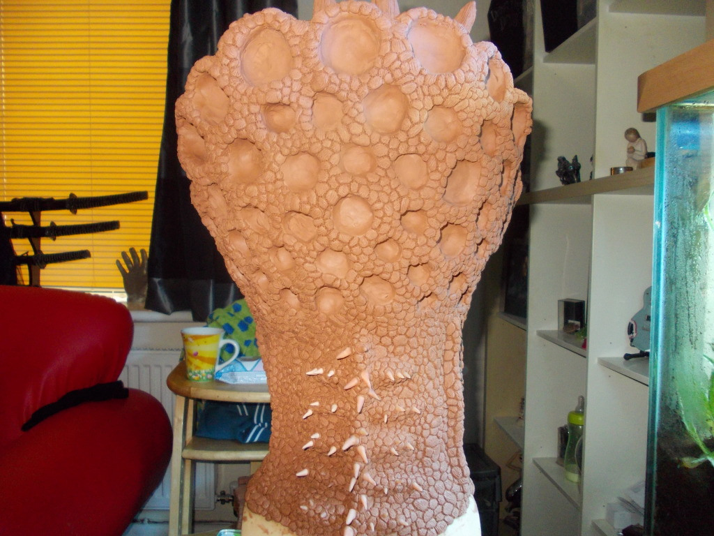

I thought i would of had this done days ago but those scales all round the back where a nightmare to do im dreading the torso lol.

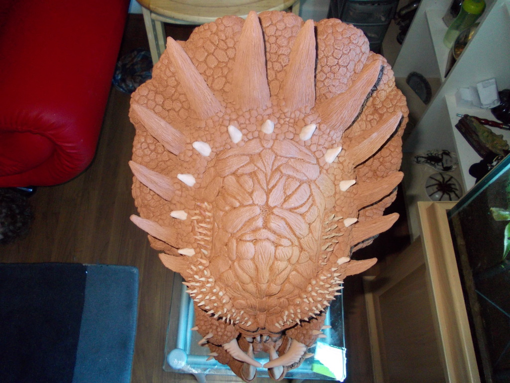

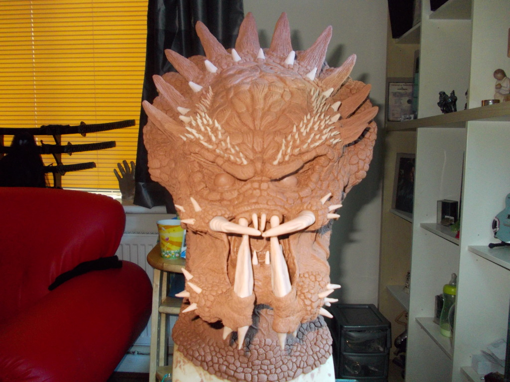

Anyway heres the last couple of pics before it goes under plaster.
