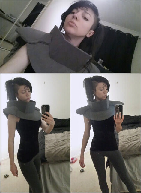

So I'm in the process of building a serpent guard outfit for Oz Comicon in September as Richard Dean Anderson and Amanda Tapping are going to be guests. I thought that this was a good opportunity to tick this costume off my list of things to make.
As usual I'm too impatient for pepakura argh, so I'm just using references and free handing my templates as I go.

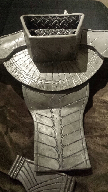

So far I've done the neck/shoulder piece and started on the chest piece. Using my favourite weapon of choice (impact foam) I've shaped, dremelled, sealed and painted and so far I'm happy with the outcome.
Currently working on drawing up and cutting out the arm guards and shin guards.
Anyway some photos below of my progress!

The picture angle of that neck section makes it look like a grinder....

Did you do the detailing by scoring the foam? ive never worked with EVA but I'd like to

this is duplicating IcedJemz but I'm also curious how the recessed detail was achieved.
Thank you! Yes I am building the head, however it isn't for this convention, it will probably be next year sometime as I want to motorise the head (I'm an auto electrician by trade so I want to take my time into rigging something special up for it)
The foam I used a dremel to freehand the linework in, they are pretty cheap tools and come from Bunnings with lots of head attachments. EVA is fantastic, it's my favourite material to work with!

this is duplicating @IcedJemz but I'm also curious how the recessed detail was achieved.
Thank you :) The indents were made from a dremel tool (rotary tool) ;)

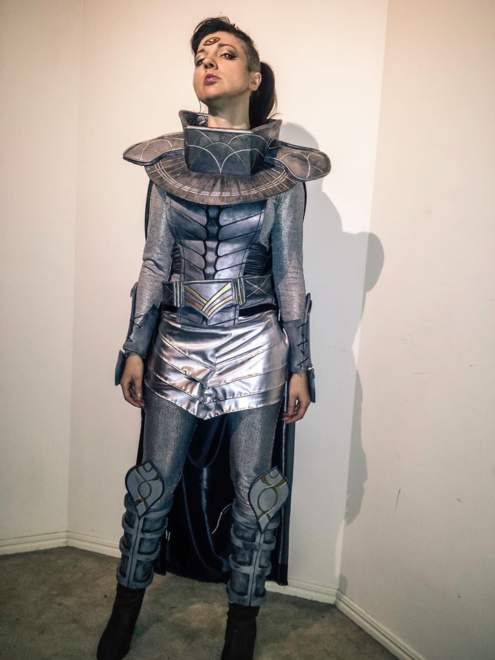

Okay so my latest update, I finally picked out the fabrics for this, it was a little tricky deciding but overall I'm happy with my purchases. I've cut out the fabric and need to tack it up and test fit then do a final sew up.
Completed most of the armor as shown, coming along nicely and enjoying the build which always is a bonus.

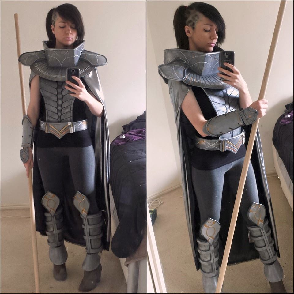

Okay so until the con this is where I'm at currently nearly all complete. Will post up photos when I've done a shoot for this one :)
