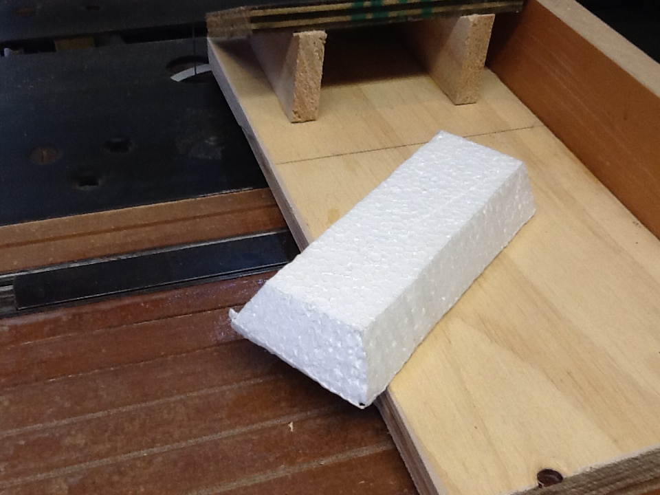

Making progress with cutting out the bevelled styrofoam strips for around the inside of the door.
Bodged up this foam cutter with a 12V power supply, a garage sale saw table, a length of nichrome wire from an old clothes dryer, a spring to tension the wire - stretched between a shed rafter and a work table - plus a temporarily-glued cradle to hold the foam bits. Total cost - zero dollars.
Foam Cutter (6).JPG Foam Cutter (4).JPG Foam Cutter (2).JPG Foam Cutter (3).JPG
