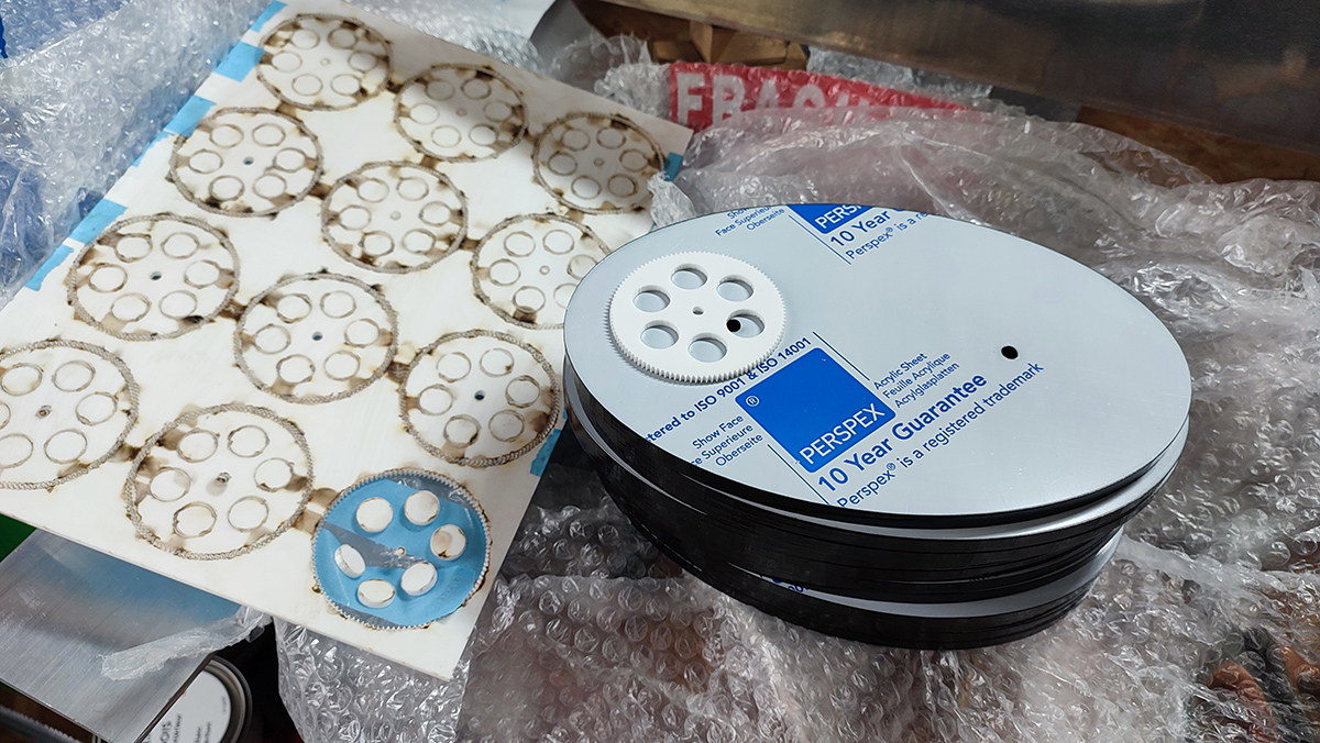

so, I received the laser cut acrylic bases today :) I haven't removed the protections but I'm sure they are great :)
so, the little "surprise", since I was cutting some acrylic parts, I had the opportunity to also cut accurate gears without adding too much cost for this project, so I thought I would give it a try :)
Tsophika kindly gave me some great refs a few weeks back that I didn't have myself, it not only allowed me to go a bit further in accuracy for the whole thing, but a ref was also showing the gear at the bottom clearly :) so, I drew it accurately and had it cut from 3mm white acrylic. Those won't be functional and they are not perfect, but that was a great way to have an accurate additional detail for not too much money, so I took the chance.
I'm pretty happy with the result, that will make a nice little detail at the bottom of the box. And If someone wants to make the box functional, you can try and find a functional gear that is correct, 66mm diameter, and I think between 108-120 teeth, idealy looking like the one I cut here with the 6 holes.

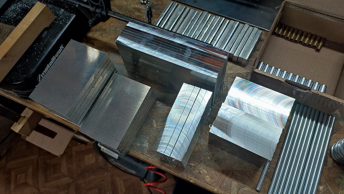

flat aluminium stock for things like this can be found in two different kind of types. One is extruded flat bars, and the other type is rolled (I think) plates (or maybe cast, I don't know. But they are plates). Looking at the references, they used aluminium plates for this prop. Those are a bit more expensive and more difficult to find in the size we want, but I decided to go for it for that extra bit of accuracy.
here is a comparison between extruded bars and the plates I used. The extruded bars have very visible lines on them. The plates have more of a thin short grain to them and have a flatter/smoother look.
final word on this, the plates are pretty clean, especially the thick ones as they came protected on one side, however, there are some scratches on the thin ones, I will orient them the best I can, but I'm going for a realistic replica of the box, and it will have some weathering. It's the game when using raw material that you don't machine, you get what you get from the supplier.

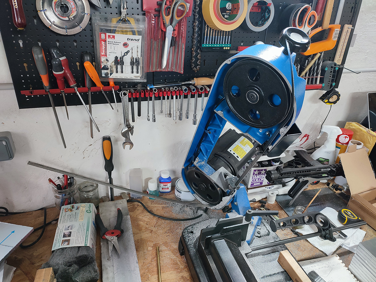

a bit the same photo than yesterday, but this is the 15cm plate in the machine this time:
and of course I was telling my wife only yersterday that it had been a little while since I changed the blade. And also explaining that I never really broke a blade. You can always feel it when it will break and it takes time. well, there we go! broken blade without warning! nice!
(no worries by the way, this machine is really safe, the protection is removed here to change the blade, when it breaks, it just stops right away)
takes time to change it, and when I say it was a painfull day, i don't know, the blade jumped from its wheels twice after I changed it. really didn't like those 10mm plates it seems.
anyways, this is now all cut and can move on to milling!
fun fact just to get an idea, there are 6 meters of length of aluminium plates cut for this project, the box is pretty small but it adds up quickly.
