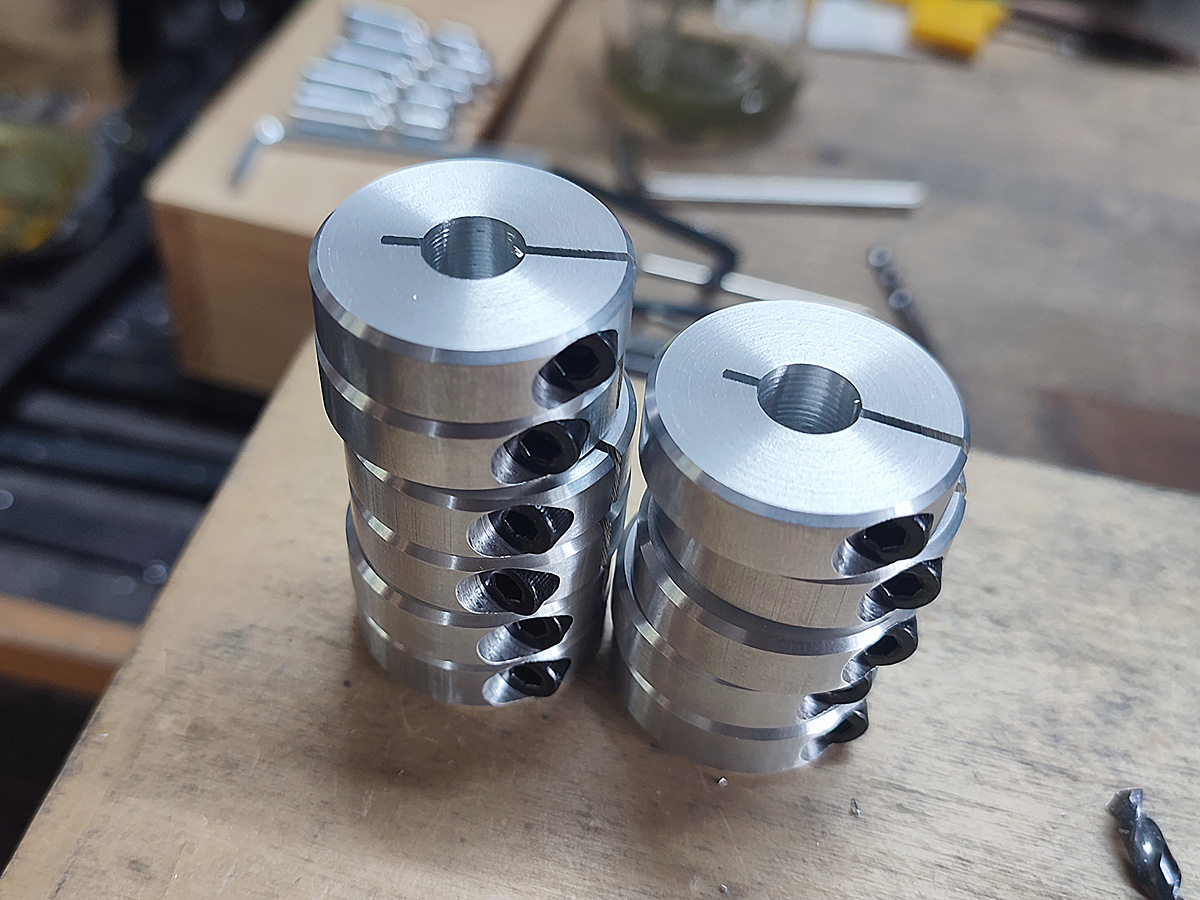

Hey there,
I got started on a few parts today:
those are pretty cool, with the integrated ball bearing. I don't see any screws on the refs, so I did large passes with the lathe so the part would heat up nicelly, then pushed the ball bearing with my mill vice. that way, they are heat pressure fit and hold by themselves :)
this is the top ball bearing by the way, it's not really visible in the refs. The bottom one will be flush like the refs, no worries ;-)

Today's work!
bottom ball bearing rings are done. Heat pressure fit as well here, very precise work to do correctly. The two in the front, I'll have to redo as they were a tiny bit too large to be pressure fit.
feet of the boxes and WIP brass lower fittings
started cutting the material for the boxes. i'll discuss this more in length in the next days, I was cut short at 7 tonight when my wife got back and I didn't take as many pics as I wanted to explain.
