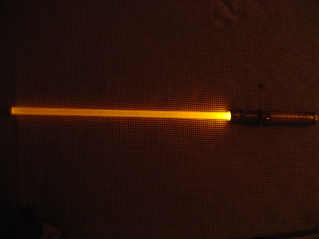

"Muur's Revoke"
"Muur's Revoke" My 2011 custom saber comp entry

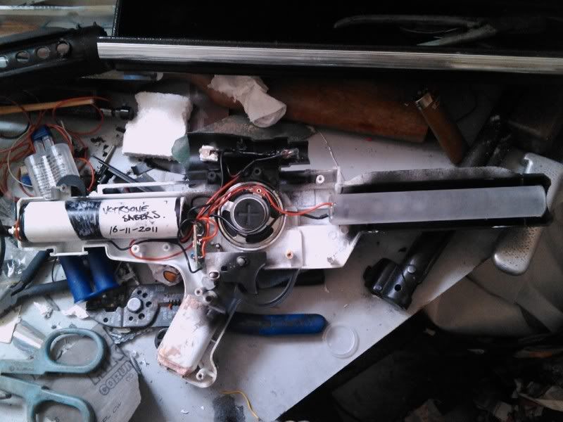

So I opened her up rewired the board,replaced the speaker and then gave her some juice..and to my surprise she fired straight up!
I then got to work building the rest of the circuit which includes a 4x AA 4.8v in-blaster rechargable battery pack (built into the pvc pipe) with a 2.1mm recharge port located in the end cap, a new .25w speaker which i glued the old rubber too, 2x 3mm red leds in the scope and one Lux I 1w red led in a lightsaber style set up for the core.
heres the internal pics:

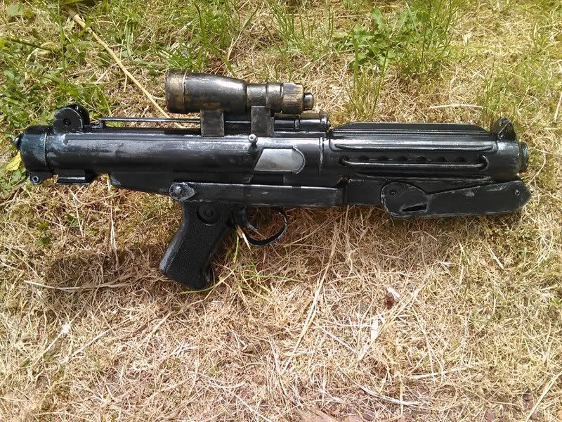

then it was onto its chrome under coating of which it got 3 coats I then gave it 4 coats of satin black and started attacking it with the sand paper while looking over the "bapty" hellishly beaten props....I decided to go with the really worn look...after Id scratched and worn some black paint away I took a small bit of foam with some silver on it and used it to highlight the harder to scratch areas...next up I got out the gold arclic and mixed it with a little black for a bross type color and added detailing to the scope...I even wrote "telescope m40" around the cap but I made it hardly visable and sanded it off mostly..you can still read bits tho like in the real props.
I ended up deciding i didnt like the trigger guard so i chopped it off and I used knead it epoxy putty to make a new trigger and then replaced the guard with one off a stuffed slug gun , I got my hammer and beat the metal guard into a new shape to fit. I used some 2 part epoxy to glue the trigger guard on.
Ok sorry for the huge story but it was a huge build! All finished now so heres the updated pics!
I went a bit over board with the weathering but in the end it has quite a battle worn look to it which i like.

I love your modded Hasbro E-11! It looks fantastic. I used a widley available resin upgrade kit on my Hasbro a few years ago, but never added any extra lights. Using a Luxeon in the barrel is awesome. I may have to rip mine apart now.

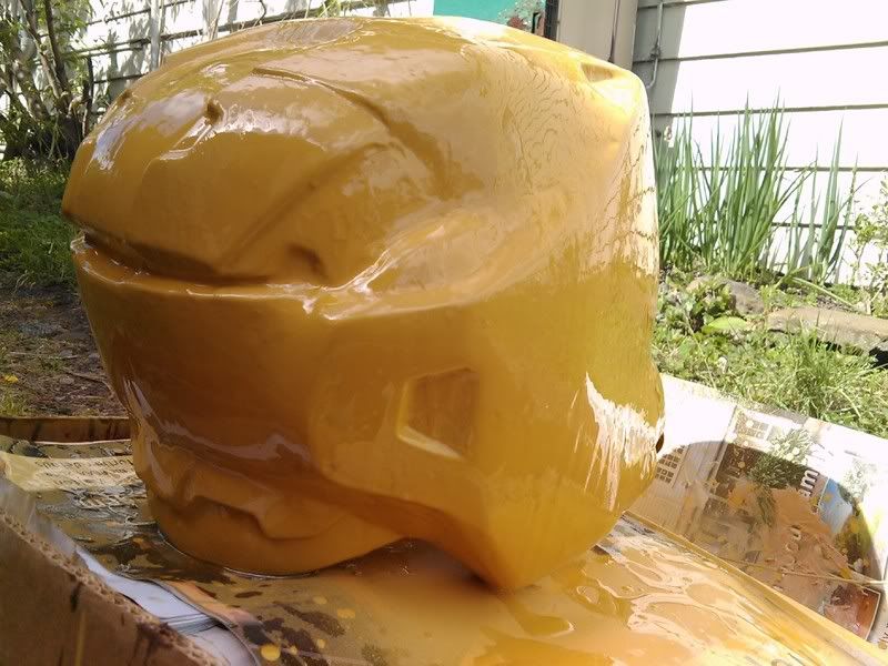

hey guys ive been working on a cheap 2 peace halo helmet the past few days..it was a 2peace thin plastic jobby which i glued together,filled with foam and then cut all the details off. I then went at it with a lot of bog and sanding. 5 days filling and sanding later I was ready to apply my resin.
and here she is with a fresh coat of resin on (the mustard color is just primer to stop the resin melting the the foam)
so this is a major work in progress...for starters it has a boba fett style face plate that goes over the front part....all will be revealed in time
little update..ive glued and resined on the base for the side details,the face plate,rear control panel and the little mohawk thing.
down and glued to the top. I sat them on the helmet for the photos, they will be glued on once the helmets painted.
Updates: I cut out a bunch more abs plastic for the mohawk tops, side panels and range finder. I took the hand nuts and washers from a welding mask and decided they would be my extra rear details and then I gorilla glued it all on, filled the gaps and sprayed it metallic silver. I gave it a good sand to remove the major lumps before applying two coats of Epiglass over the top.
as you can see shes looking a little rough in the photos because of the two new resin coats yet to be sanded and filled.
the range finder folds up and down but I still need to do some shaping on the lens peace.
