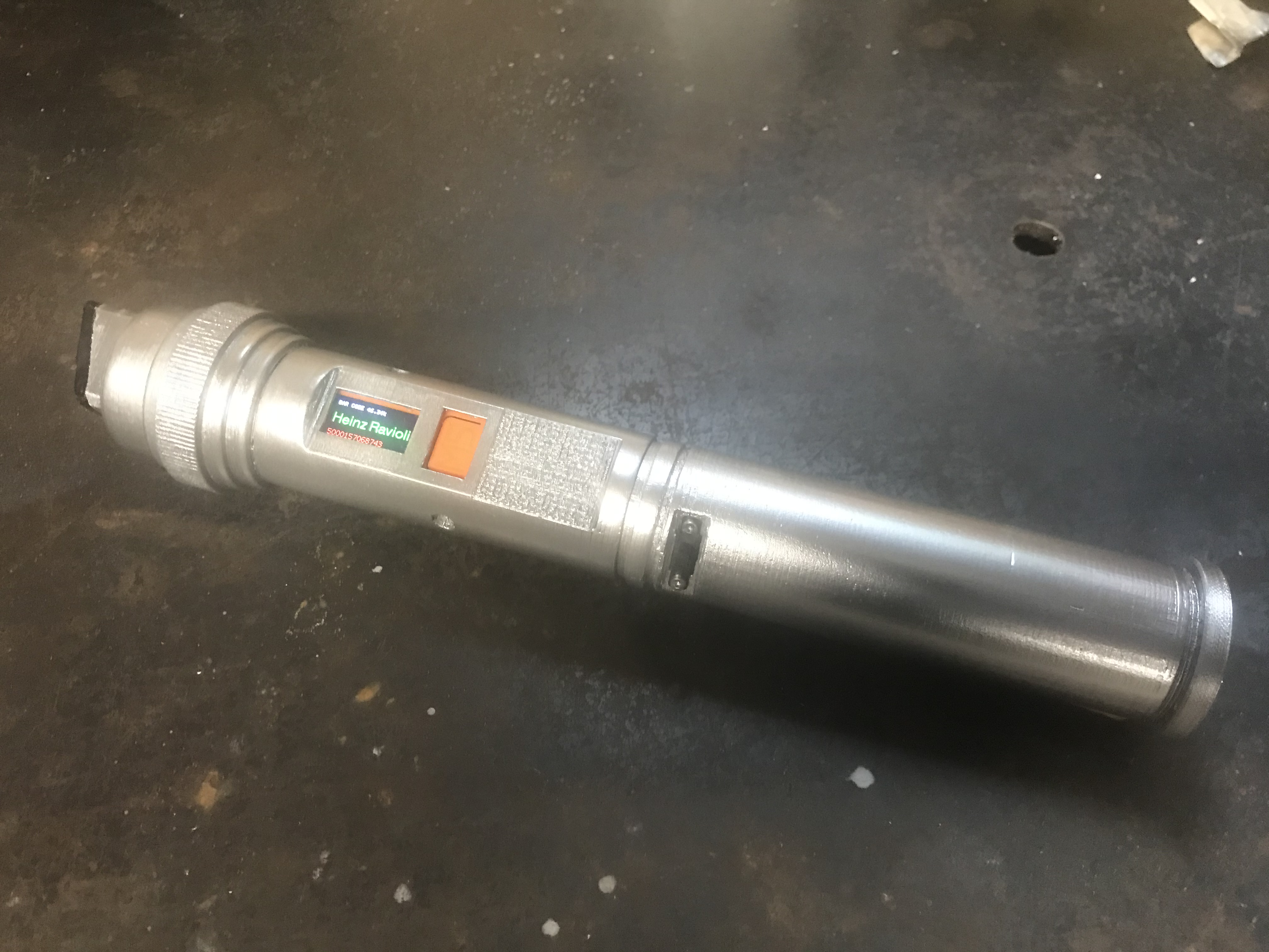

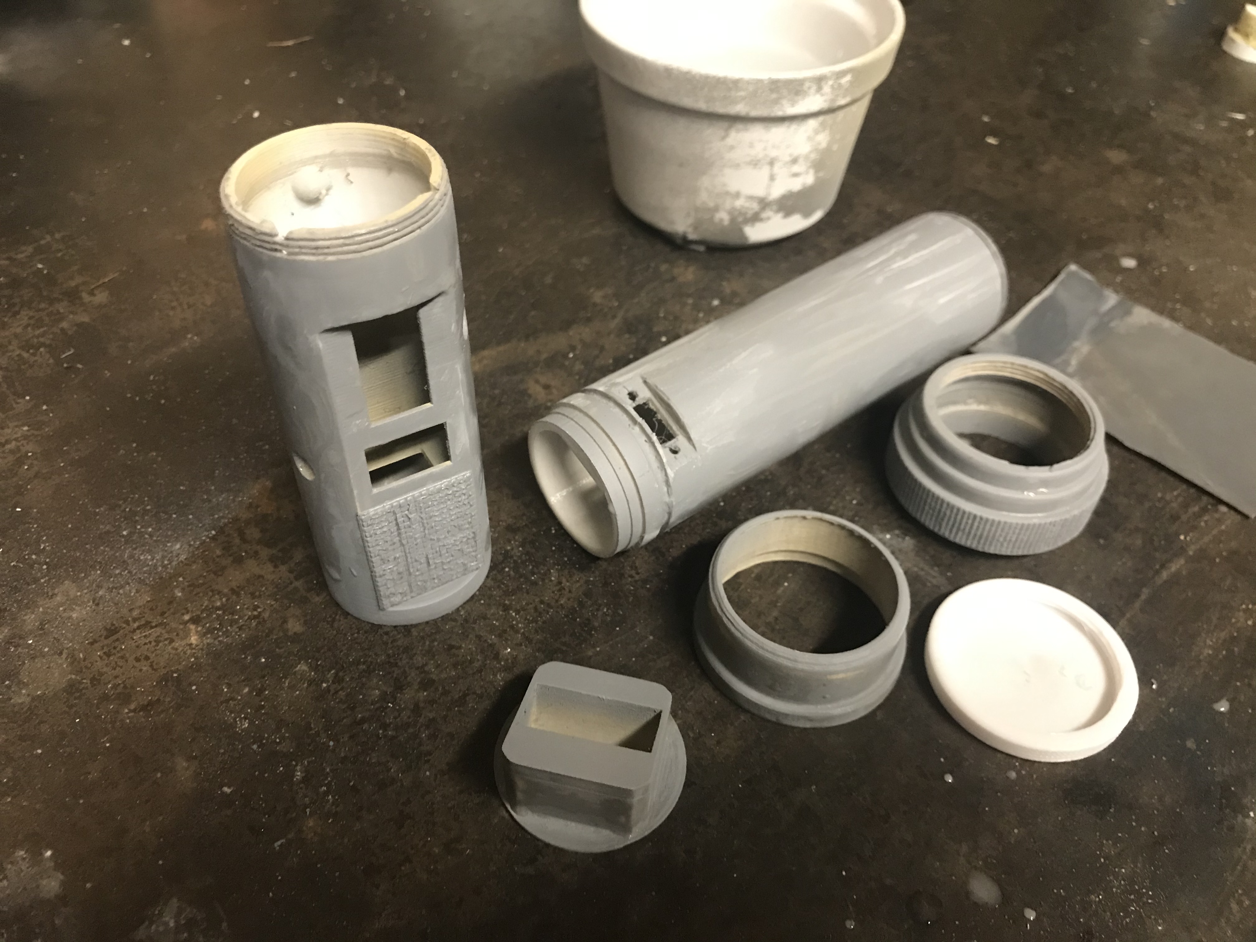

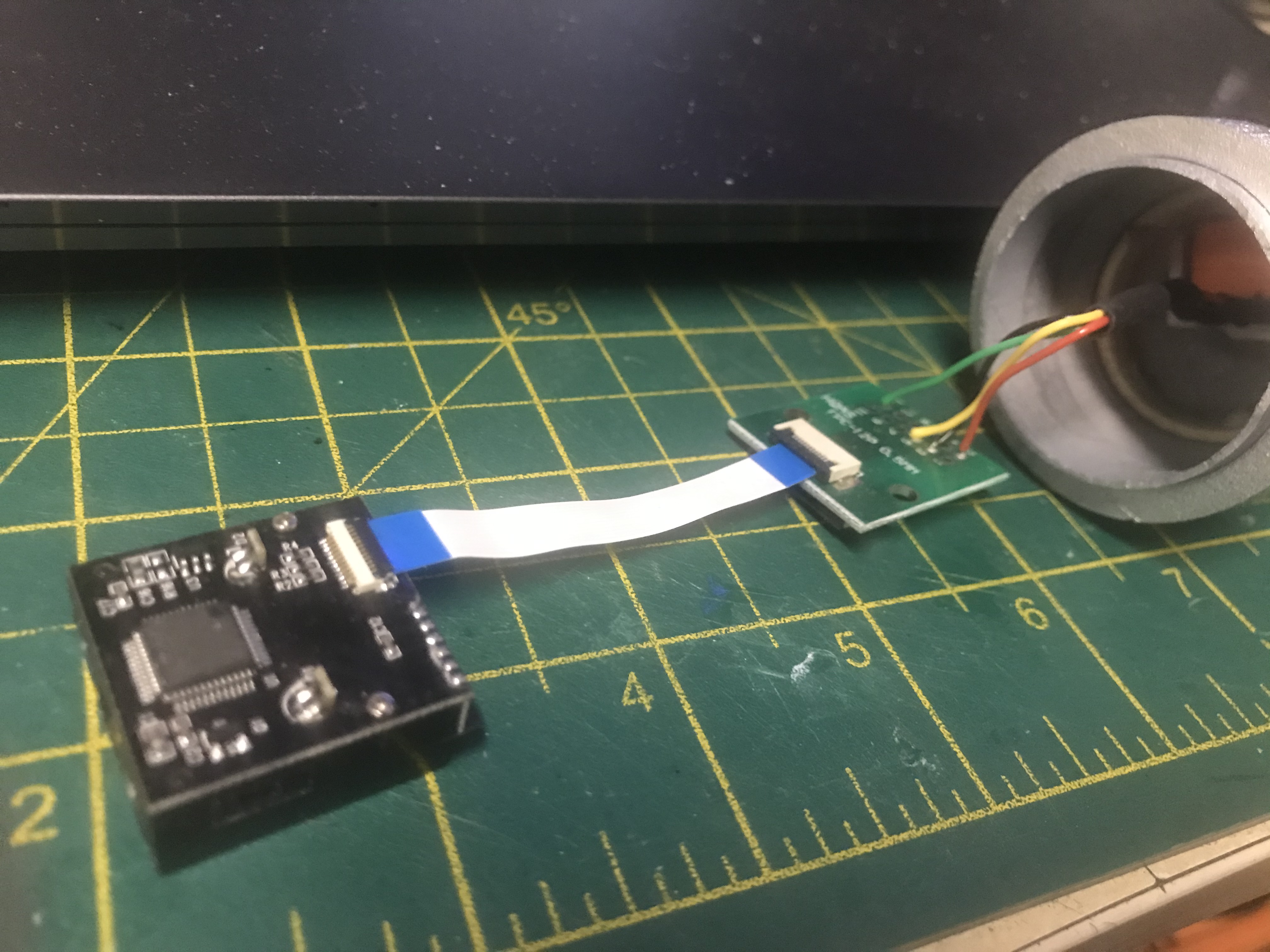

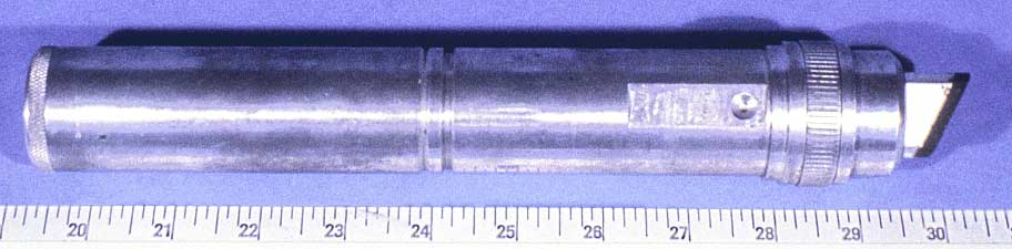

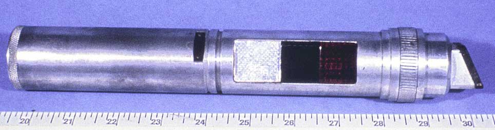

The piece I'm making is actually a bar code scanner, but rather than housing it in a non-generic holder I'm going to put it inside a copy of the Star Trek Universal Translator. Started with a 3d model and sculpted in a holder for the electronics and a port for the scanner. I guess it translates bar codes, so it has an element of truth about it. Also added in the flattended piece and dimple on the back as I seem to be able to see that in both the the screen shots and some prop that came up for sale.
So far its just printing and glueing time and sanding to get it ready for some paint

Great idea and a nice looking model so far, love it! I've been on the lookout for a functional metal version for some time. I'll find one when I put my mind to it. Your dimensions look excellent too

The base ring/cap looks a bit off but I can live with it for the purpose its for. Just sprayed it all in Molotow , I wish I could do that for a full time job :)
Patience now to let it dry before a coat of varnish and then assemble.
