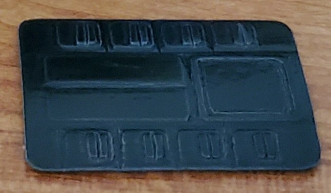

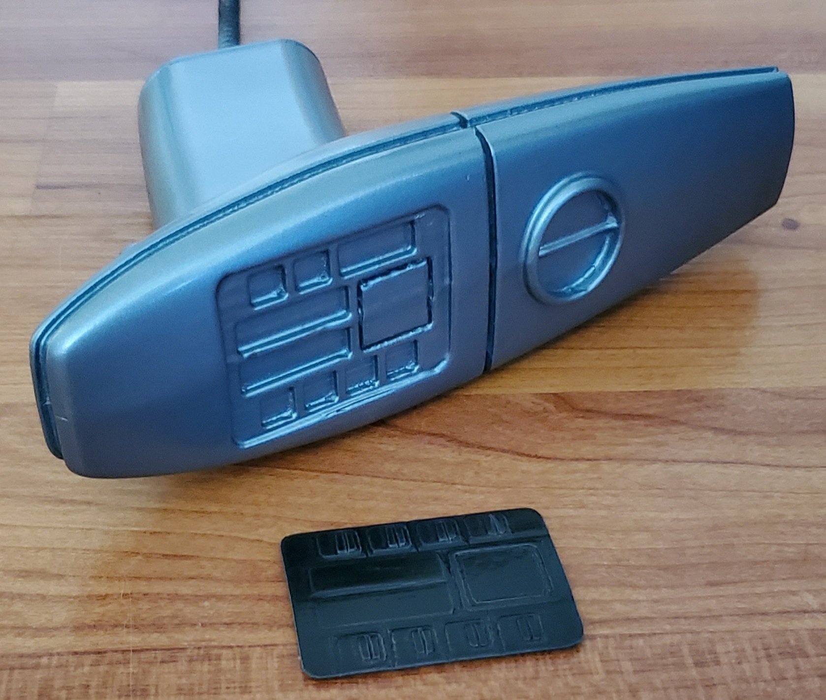

It has a few issues. The size was a little large, so I had to scale it down a little. The trigger is supposed to be a cylinder. The back of the PHASER is supposed to be beveled. I just did that with a sander after the print. It took 10 minutes including filling back in. I also had to make a new button control panel on Sketchup and print that up. I think I spent more time working on that stupid little piece than anything else. There are some other little design things, but overall, the shape is pretty good.
The colour is supposed to be a light metallic blue. I just happened to have some old toyota blue metallic paint that is pretty damned good for this.
I still have to make the acrylic crystal on the top. Fill in the front emitter groove. And fill in the side groves with multi-colour metallic reflective pattern material of some sort.
I know it's not perfect. I'm no painter. I tried though. Sanding. 3 coats of primer filler. Filler. Lots of sanding. Base coat. Sanding. Top coat. Wet sanding...
