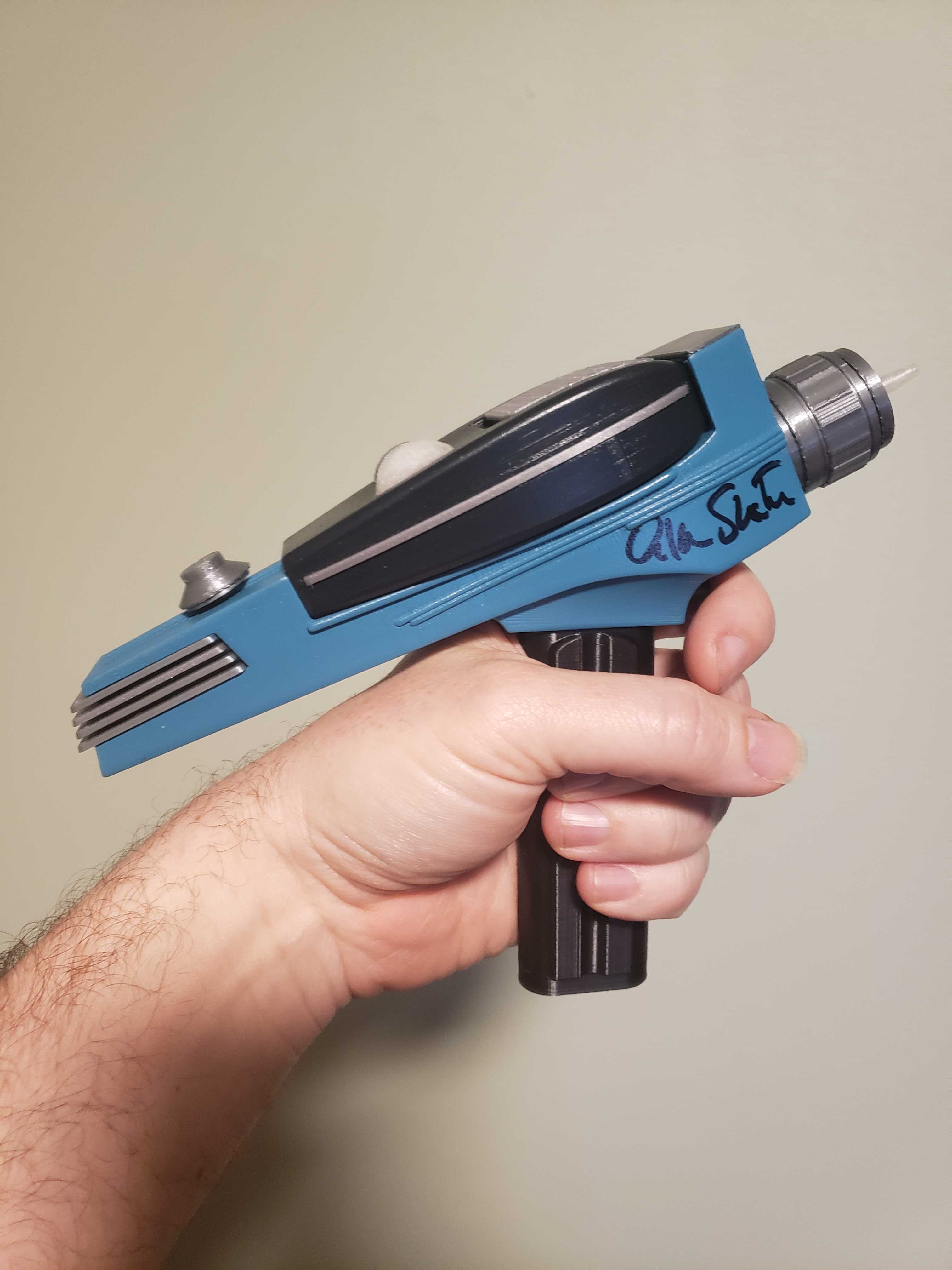

Scrambled a full prototype together, had a chance to get it signed by the man himself, can't pass that up! Nothing's glued on, I'll fix the dial and other features this week, aiming to publish the V1 of this by the end of this week on thingiverse.
That's what I thought. When did he sign that for you? Nice...
Fan Expo Vancouver, I got a booth there last minute to show off 3D printing, I ended up getting the phaser put together about 20min before he started signing, half the parts are just friction fit.

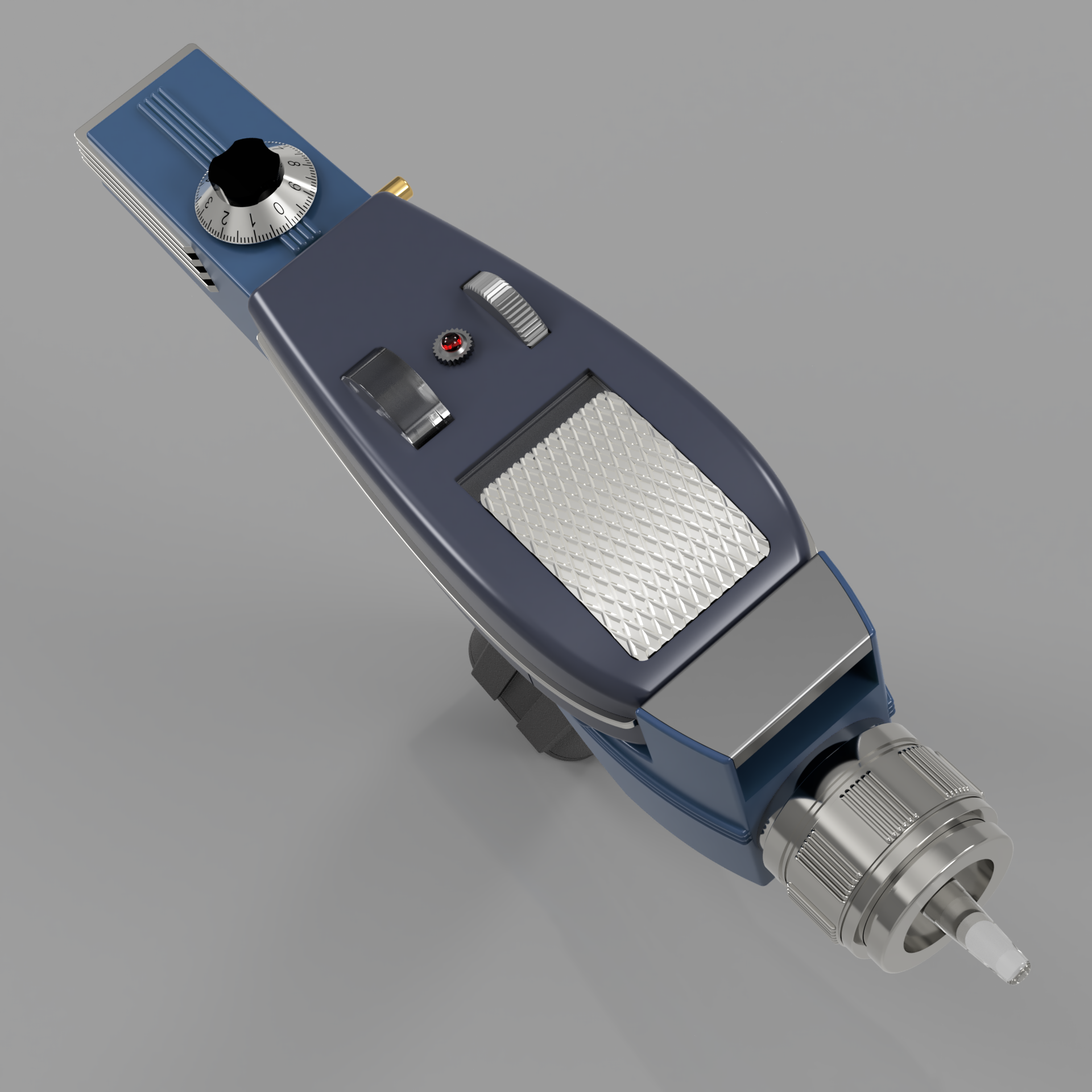

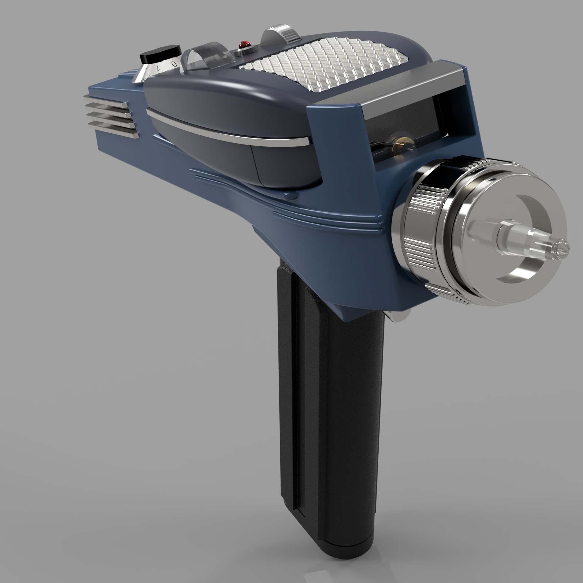

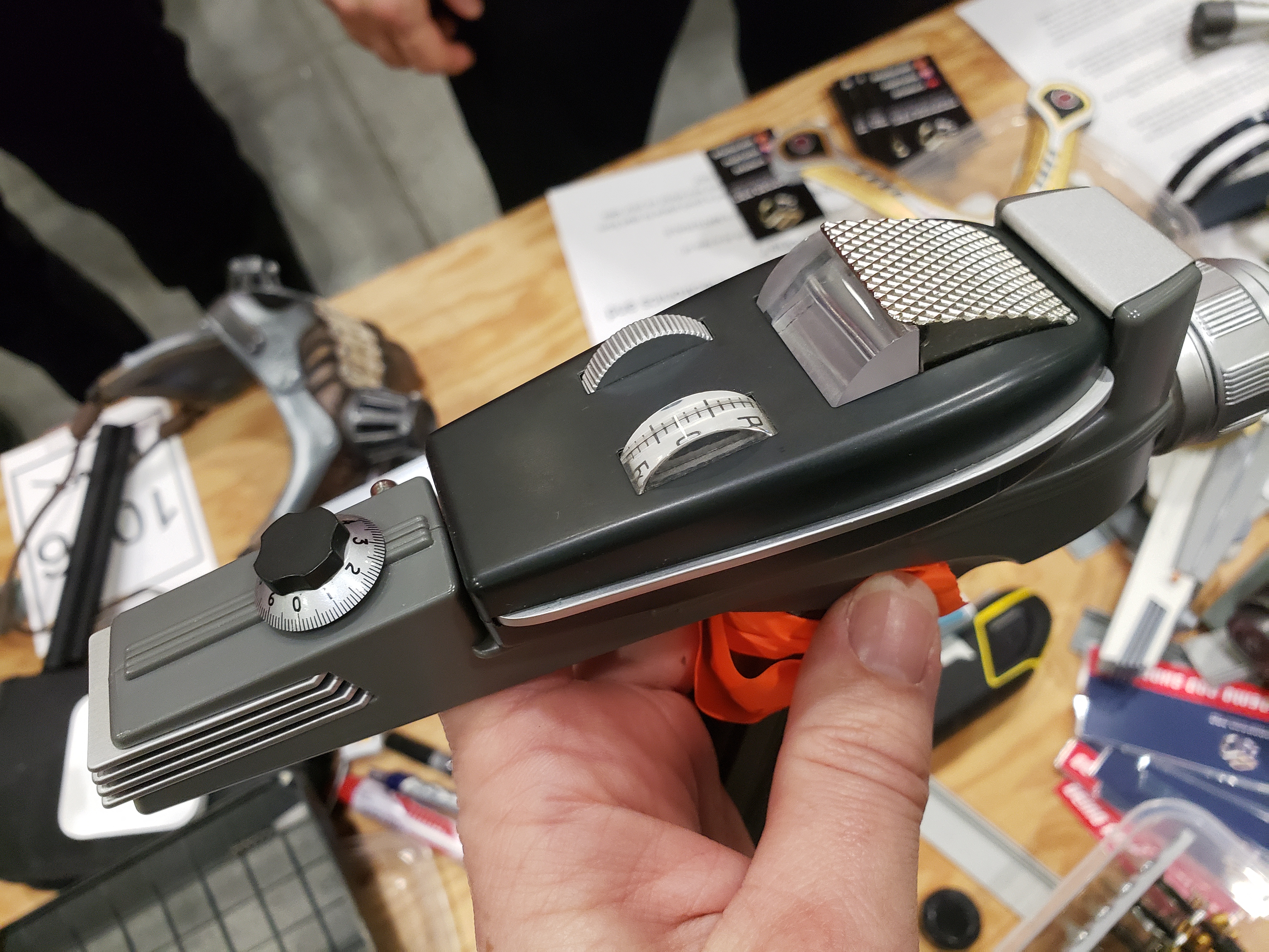

Apologies, been a long few weeks at work. Thanks to Jlewis and Dsimdude for pointing out two major issues, I got to play with a Master Replicas version recently and the same two issues stood out: The 4 ribs at the back and the knob:
20220219_122359.jpgStar_Trek_TOS_-_Type_2_Phaser_Crash_Fix_2022-Mar-08_02-13-08AM-000_CustomizedView18740400302.png
Both issues hopefully fixed, on the plus side it was an exact size/dimension match, so much so that I really can't find any other big fault.
So I submit it one more time for scrutiny, this model has become way better thanks to the awesome feedback from here. If it passes the test I'll publish on thingiverse :)
  • Star_Trek_TOS_-_Type_2_Phaser_Crash_Fix_2022-Mar-08_02-13-24AM-000_CustomizedView203083500.png

An apology to you! I just went back to the thread and you posted an amazing breakdown of all the issues, including those 2 noted above. I'll see about fixing those asap. I feel like a heel considering the time it must have taken you to do the breakdown, I'll fix or address every issue asap.
Here's the play by play copying your list of fixes and working through them (compare from Dsimdude's P1 list of issues on this thread):
Phaser_Fix_001 [DONE]
1. Addressed: The inset is for printability, it's as thin as it can get. The final print has it raised a bit matching the screen
2. Fixed
3. Fixed
4. Fixed
5. Fixed
6. Addressed: Won't show up in a print unfortunately
7. Fixed
8. Fixed
Phaser_Fix_002
1. Addressed: It doesn't butt up in the printed version, this is more of an artifact of the model
2. Fixed
3. Addressed: The cap is there, it's set in the stand, you can see when you remove it.
Phaser_Fix_003
2. Fixed (small inaccuracies maybe, it's pretty close)
4. Adressed: Thicker than it looks, balance for easy printability.
5. Fixed
5A. Fixed
6. Fixed
Phaser_Fix_004
2. Fixed (and there is a seam, it's a render issue)
3. Fixed
4. Fixed
Phaser_Fix_005
2. Fixed
3. Addressed: It's the 90mm lens from the render, no effect on the models
4. Addressed: Render issue, the 3D print is the goal, render is just for reference.
Phaser_Fix_006
3. Addressed: It's a 3D print, it should be 'too perfect' since 3d printers aren't very accurate, crisper the model is the better, it can be formed later.
[NOTE: THIS IS UPDATE 3 OF THE LIST]
Dsimdude Amazing list of change suggestions and I've addressed and/or fixed every one. But it's caused a whole whack of downstream and dependency errors (when one change impacts another). So I can't post renders/models for a bit while I sort it all out . Coming soon!

It's a 3D print model, so you can just paint in whatever. The one I compared it by IRL was the gray master replicas version. (pic is of Master Replicas gray version)
