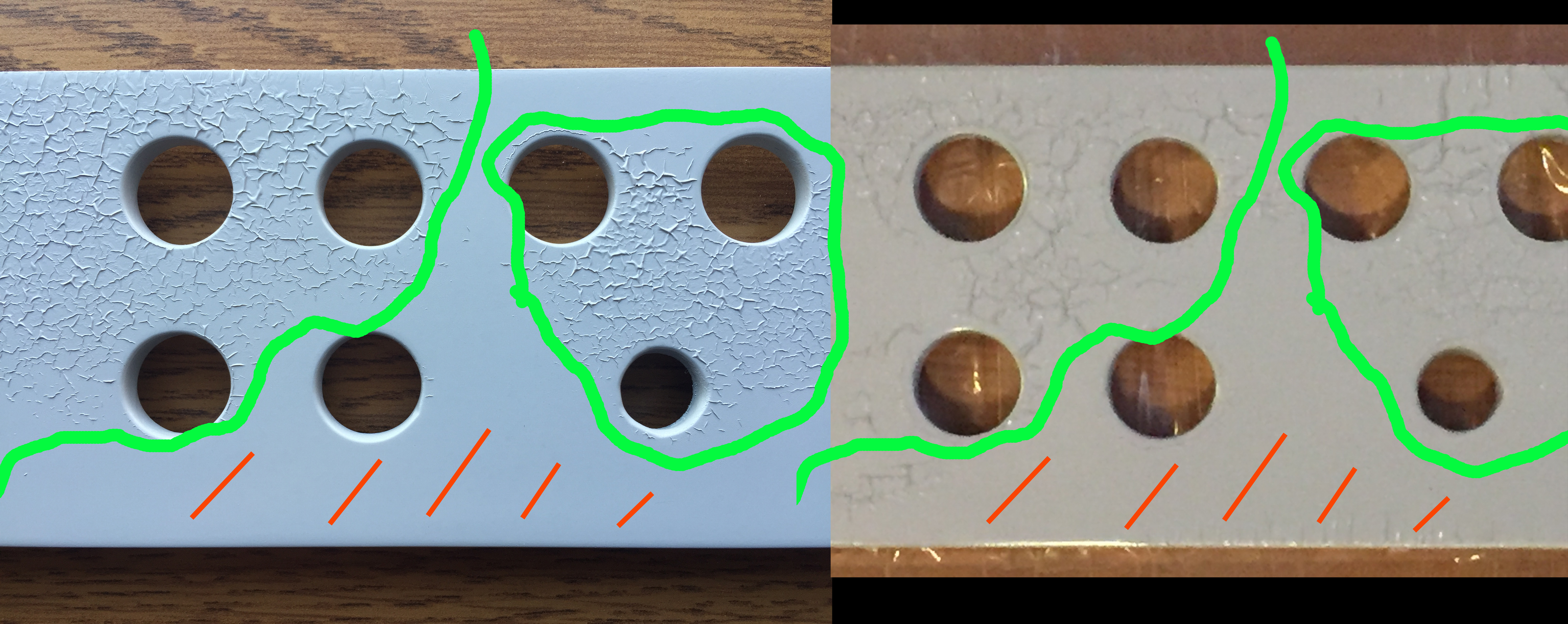

It is MDF, with a primer coat, sealer primer, then another primer coat, then the gray color coat, and everything is fine up to that point - no cracking. It is the satin clear coat that is cracking up when applied over the gray paint, same painting conditions as when applying the gray paint. It is cracking all over the board, I simply photographed the same area. I had no problems with the cabinet and the backsides of the door and buttons face, it's just the front sides of these last two pieces that will just not take the clear coat as all the other surfaces did. They are sanded down again and drying in the house near a furnace vent for applying gray paint again tomorrow.
Jintosh
The green areas crack, the red areas don't crack. This may be coincidence based on limited sample size. ;)

There is cracking in the red marked area of the second image, along the edge.

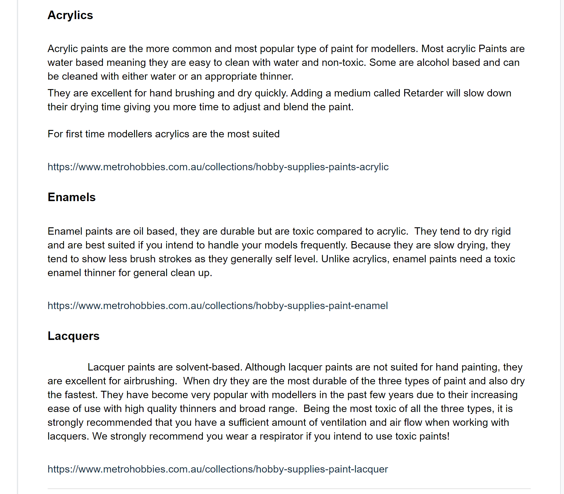

Jintosh
Good call. It has to be some interaction between the paints.
If lacquer is solvent based, and acrylic is water based, then the lacquer undercoat with it's solvent may be eating up the above coats of acrylic paint. Really, even if that didn't seem likely, it still seems to be the only explanation.
