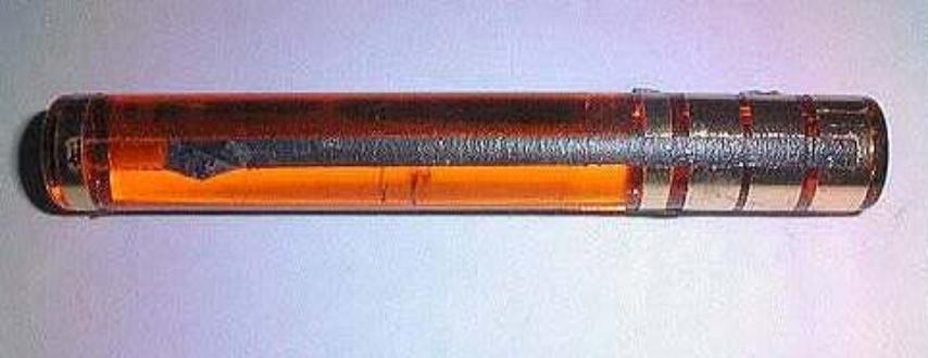

These rods have 4 bands on the top, 1 thinner than the other 3, another thinner band at the bottom, and a black stripe down the middle. These can be seen clearer here
And here is one of those original props.

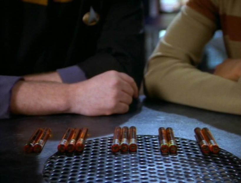

The lack of a bottom stripe can clearly be seen in these two screencaps. The first is when he is taking Vic Fontain’s rod out of the box to give to Odo, and due to the angle, the light reflects only on the bands.
As can also be distinguished when the rod is taken from Odo to be put back in the box

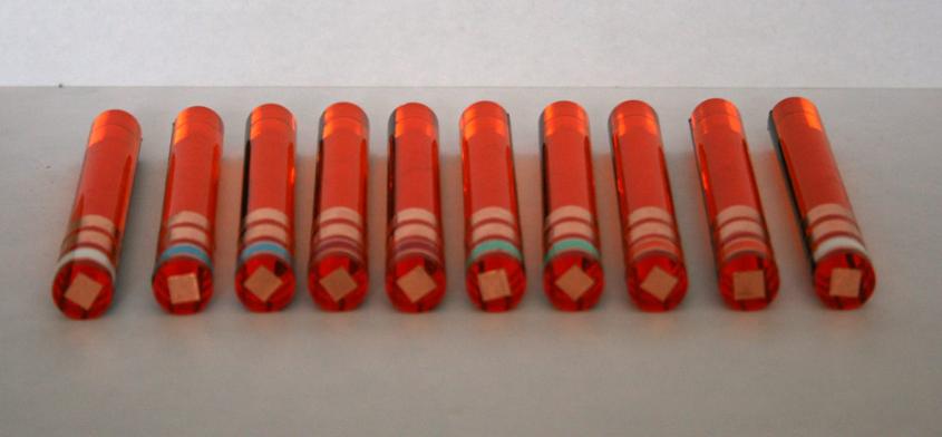

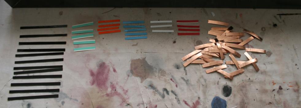

Since I was going for the rods as seen in Quark’s box, I needed some of these, cut up …
… and plenty of these ….
… et Voila ! Quark’s Isolinear Rods.

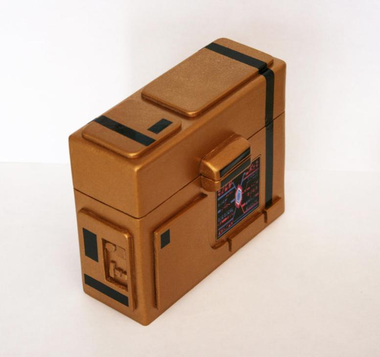

So let’s have a good look at that first
As confirmed by HMS Mike, the box was scratch built. So, here goes.

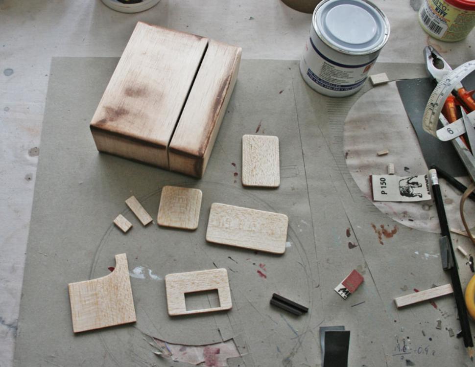

I didn’t take many ‘build’ images, as there was not all that much to show. Precise and detailed, yes, but not warranting a ton of images.

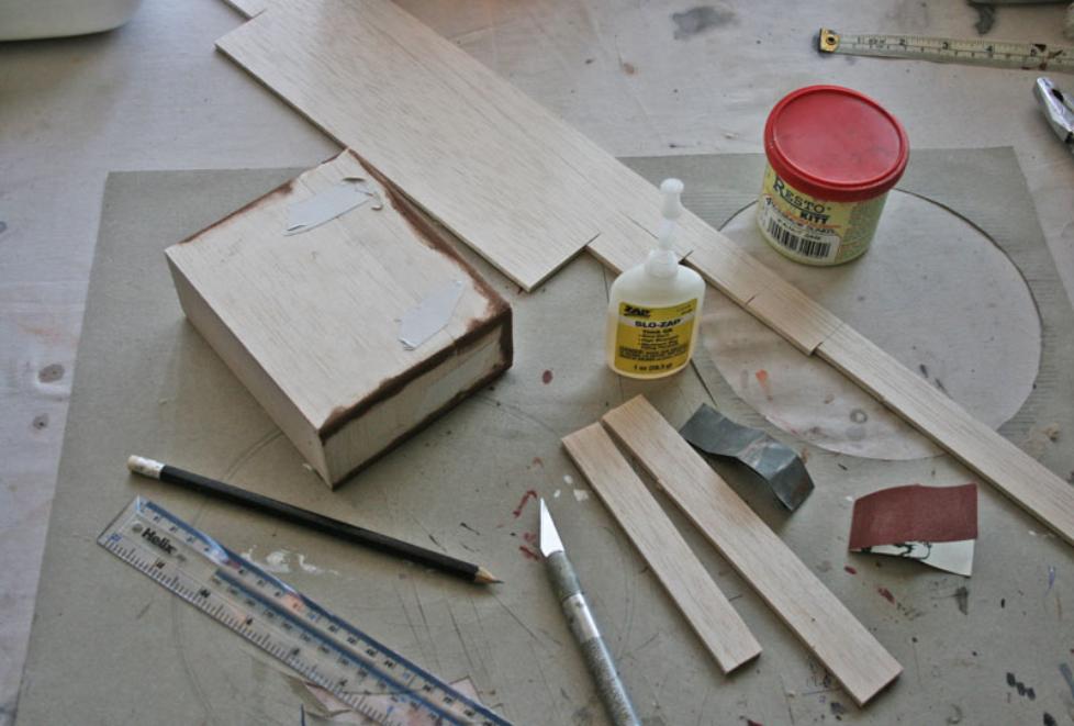

A medium I love to use is balsa.
So I made the basic box and its lid, sanded down the edges to make them round, and used filler and sandpaper to smoothen.

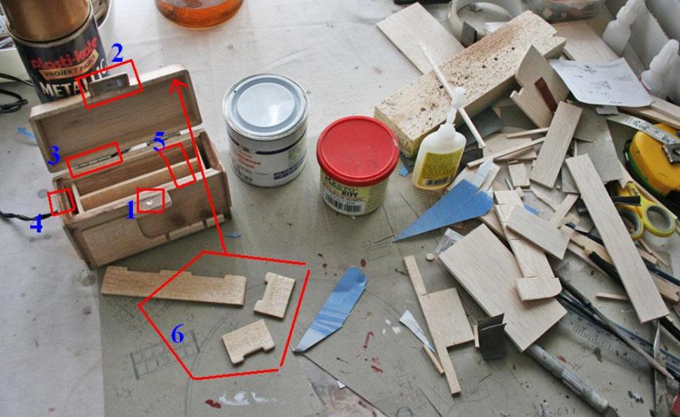

Next, I made the external ‘panels’
And added .....
1 - Small magnet
2 - Sheet of metal
3 - Hinges
4 - Internal ‘panels’
5 - Divider box
6 - Internal lid panels
Now, for my personal touch :lol

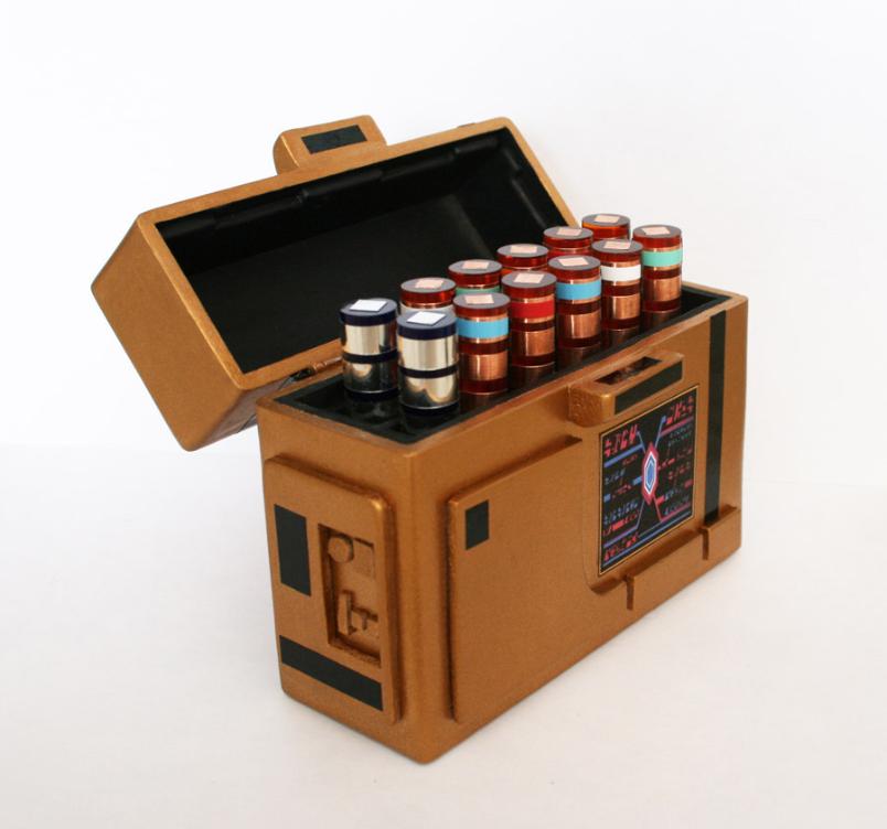

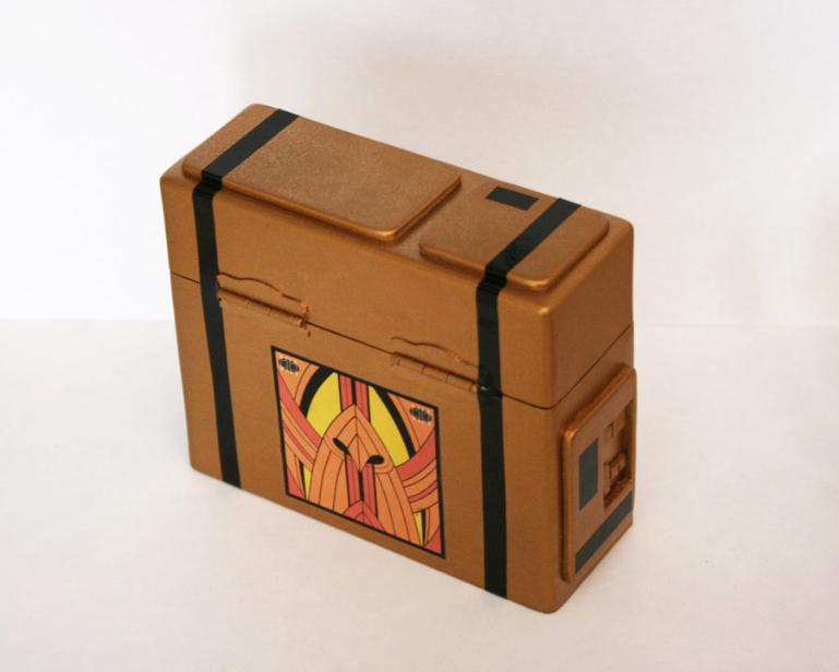

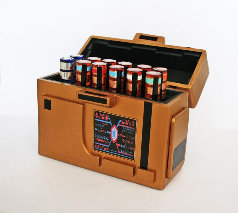

To round it all up for the box, some paint, graphics and decals later, and here it is finished :
Quarks’ Isolinear Rods and Box :)
And on display.

Thanks :) & sure thing :thumbsup.
Then rods are 1.3cms X 9cms.
The box is 13 W X 10.5 H X 5 cms. (height is 7 for the box and 3.5 the lid)
EDIT : My mistake. It's 5cms, not 4, wide.
The bands are copper tape, available from your local ironmonger. Rest cut are acrylic stickers :)

Yes, they are extruded acrylic rods. The biggest mistake people make is cutting acrylic with a saw. It is surprisingly difficult. The easiest and cleanest way is by attaching a flat grinding bit to a hobby drill and do it by heat - knife through butter and clean cut.
However, I had these cut at source myself.

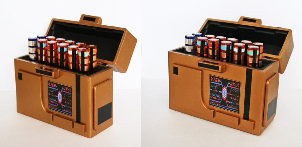

48 hours of knocking my head against the wall, and I just COULDN'T put my finger on what was 'wrong' with this replica.
It finally hit me while ... well, never mind :lol , and I fixed it in 2 seconds flat.
The darned rods were sitting a couple of millimeters too high in the box, making it look totally out of proportion !
I simply removed a sheet of balsa that was lying down under the divider box, and that was it !
Pics in first post replaced with new ones, but you can see what I mean so much better with a side by side before and after.

They are 9cms X 1.3cms (3.5" X 0.5")
