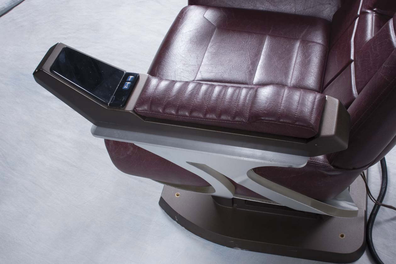

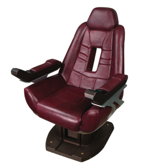

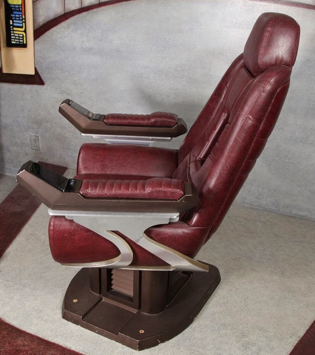

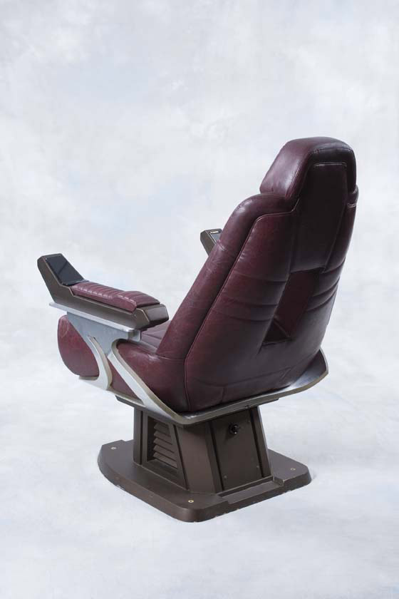

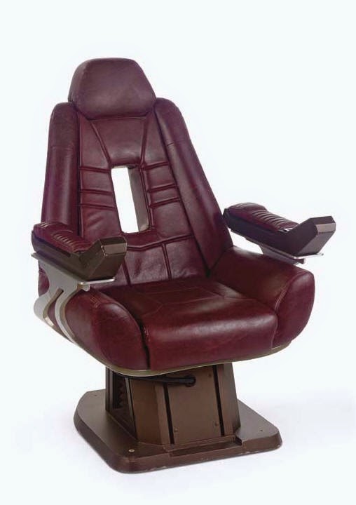

I'm working on building the captain's chair from the Star Trek TNG movies. I've got great reference shots from the 2006 auction.
EChair.jpg gallery_5162_104_32279.jpg gallery_5162_104_35019.jpg P507_6.jpg P507_1.jpg

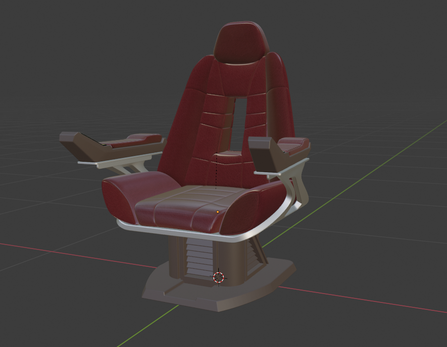

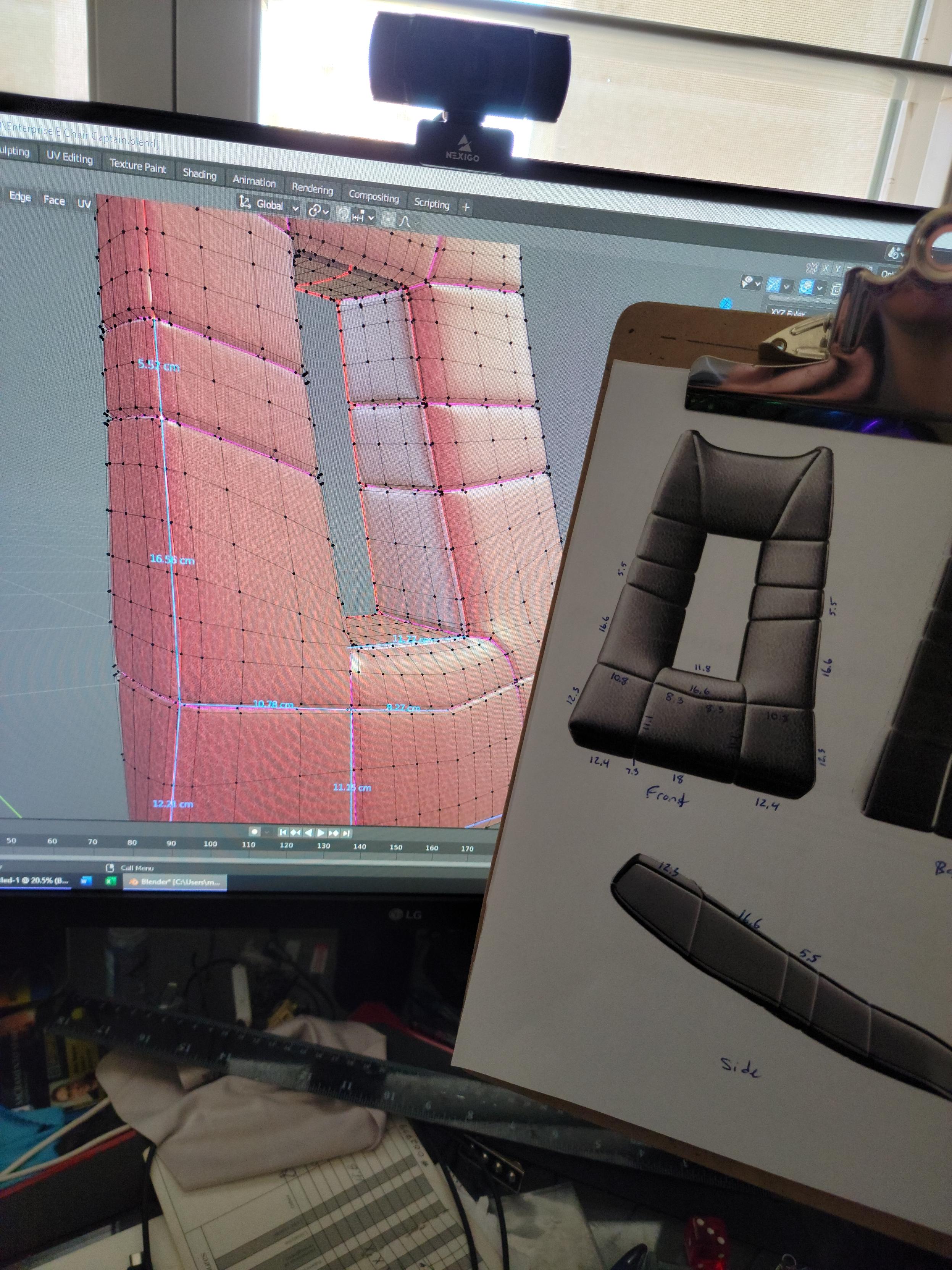

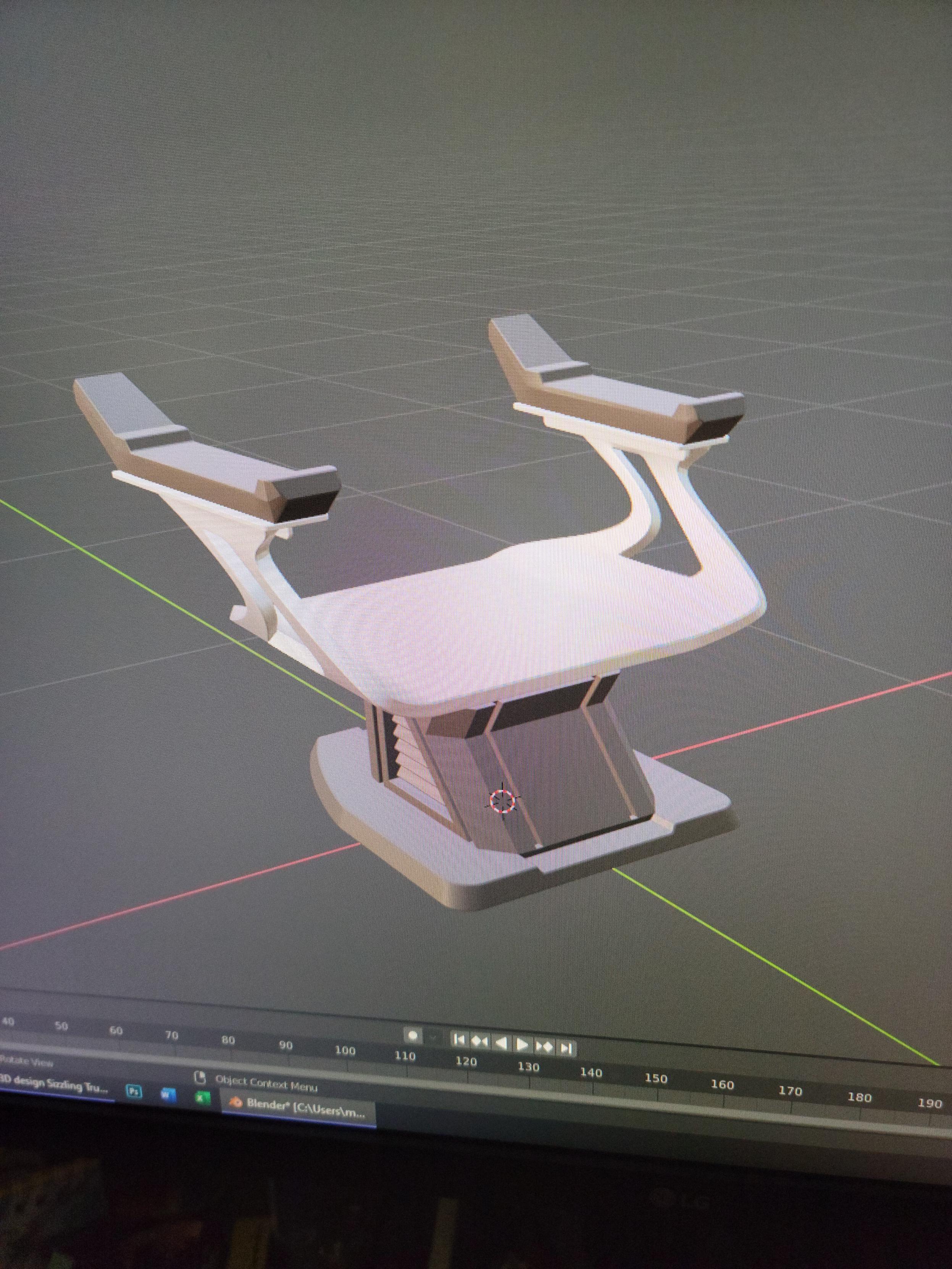

I have the chair modeled to scale in Blender and have exported the model so I can 3d print the base and armrests. I will be using traditional upholstery methods for the chair.

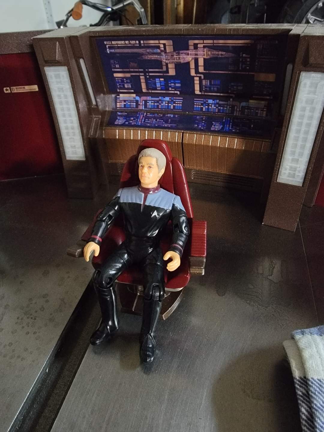

I started by printing the chair in its entirety at Playmates figure scale so I have a physical example to model the full size chair from.

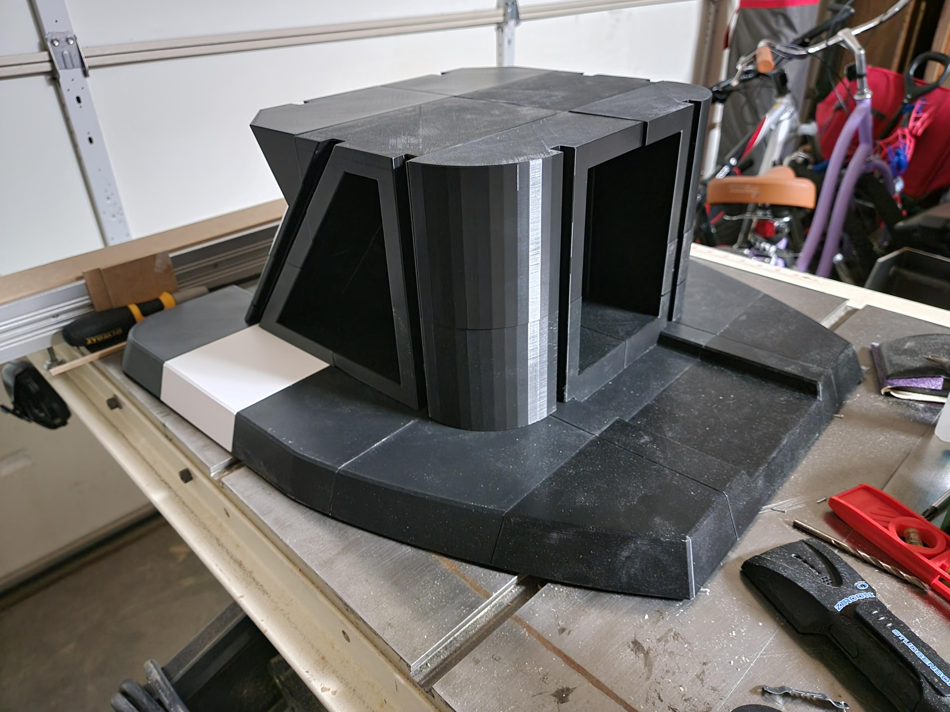

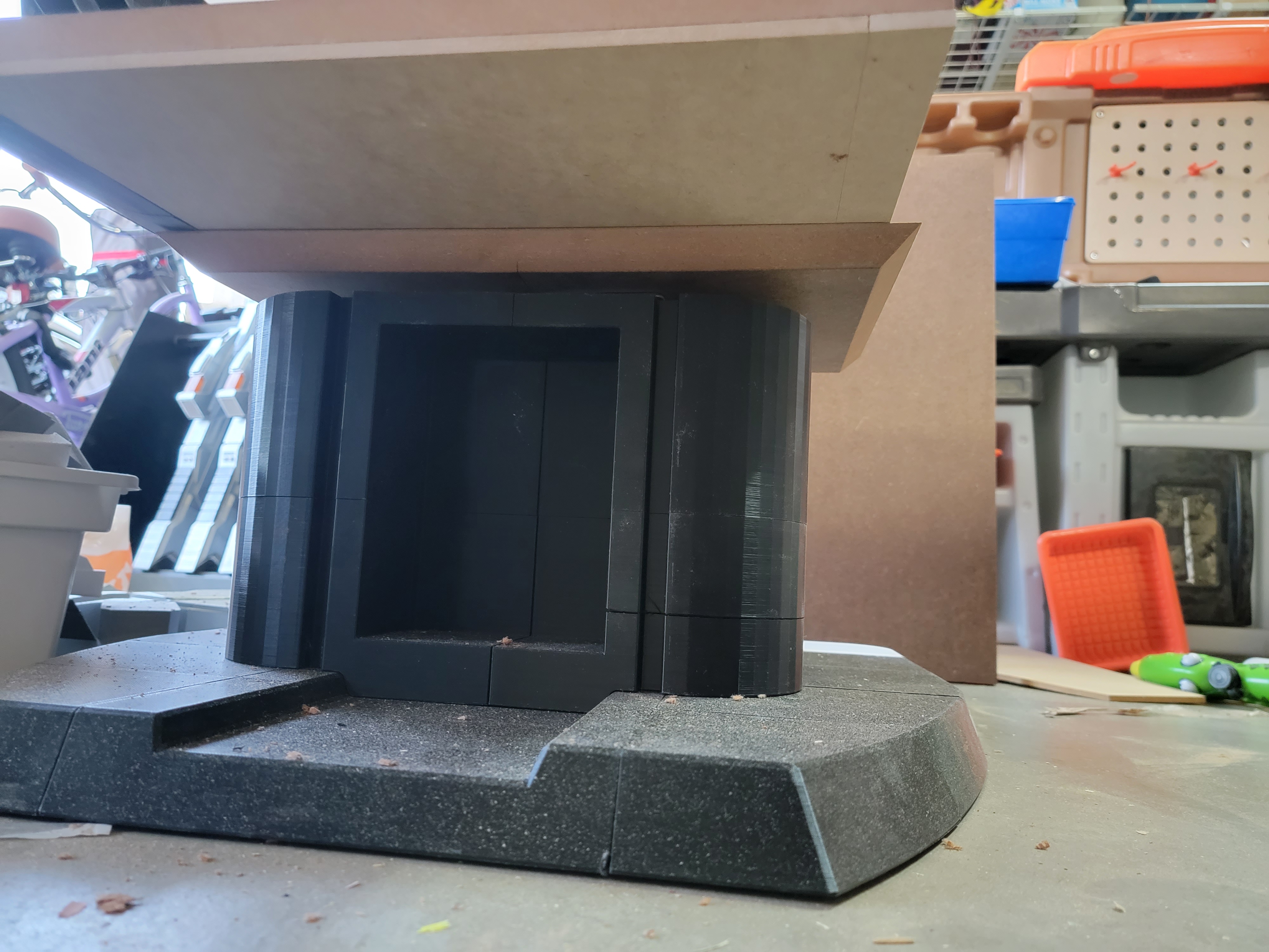

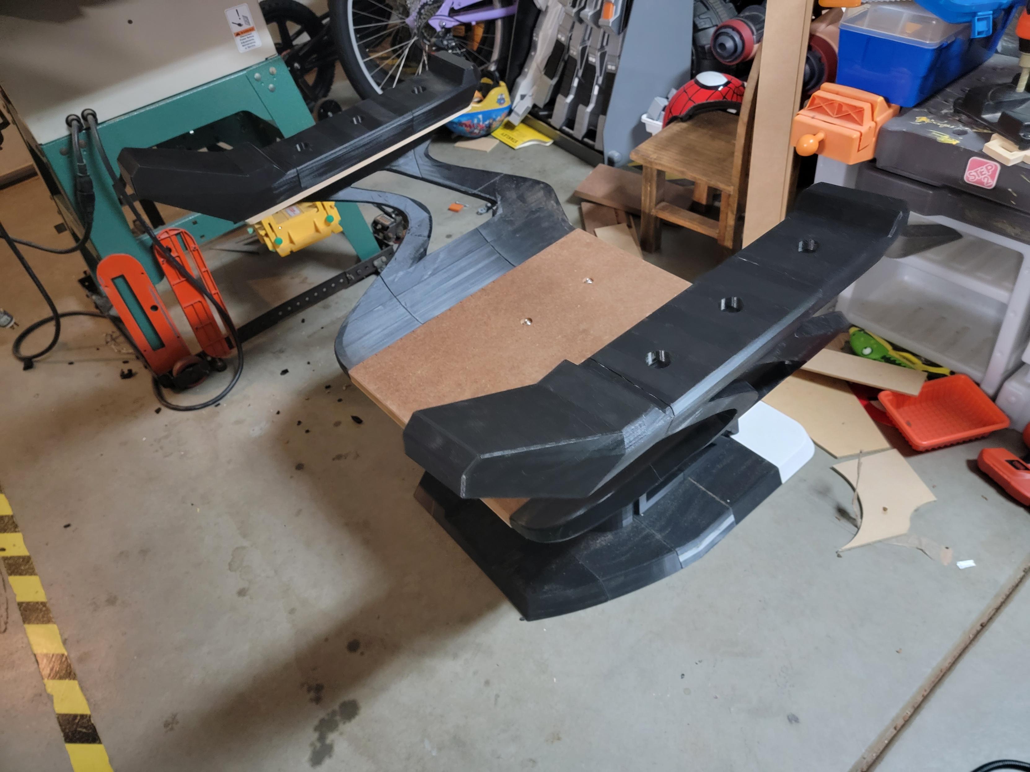

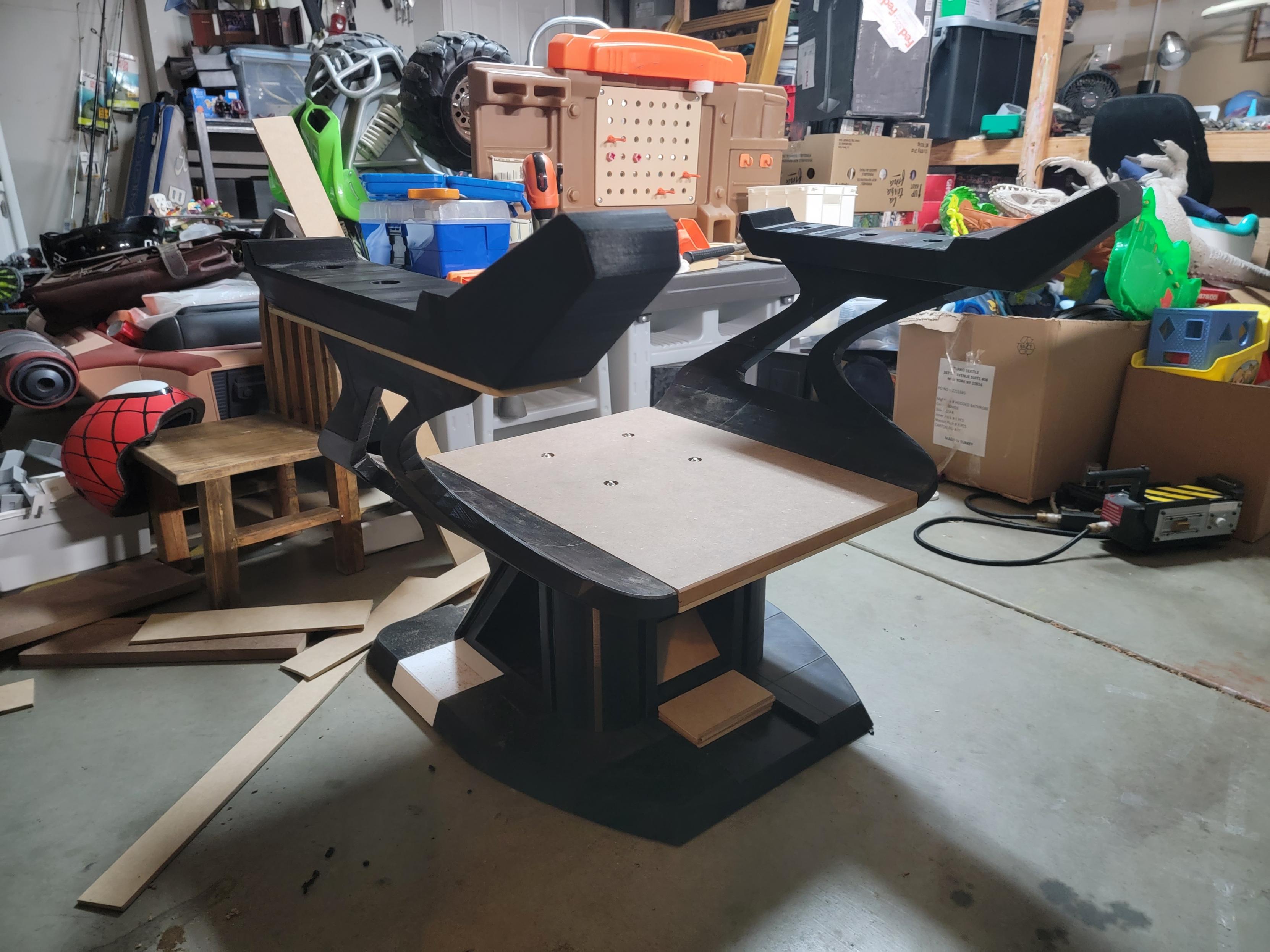

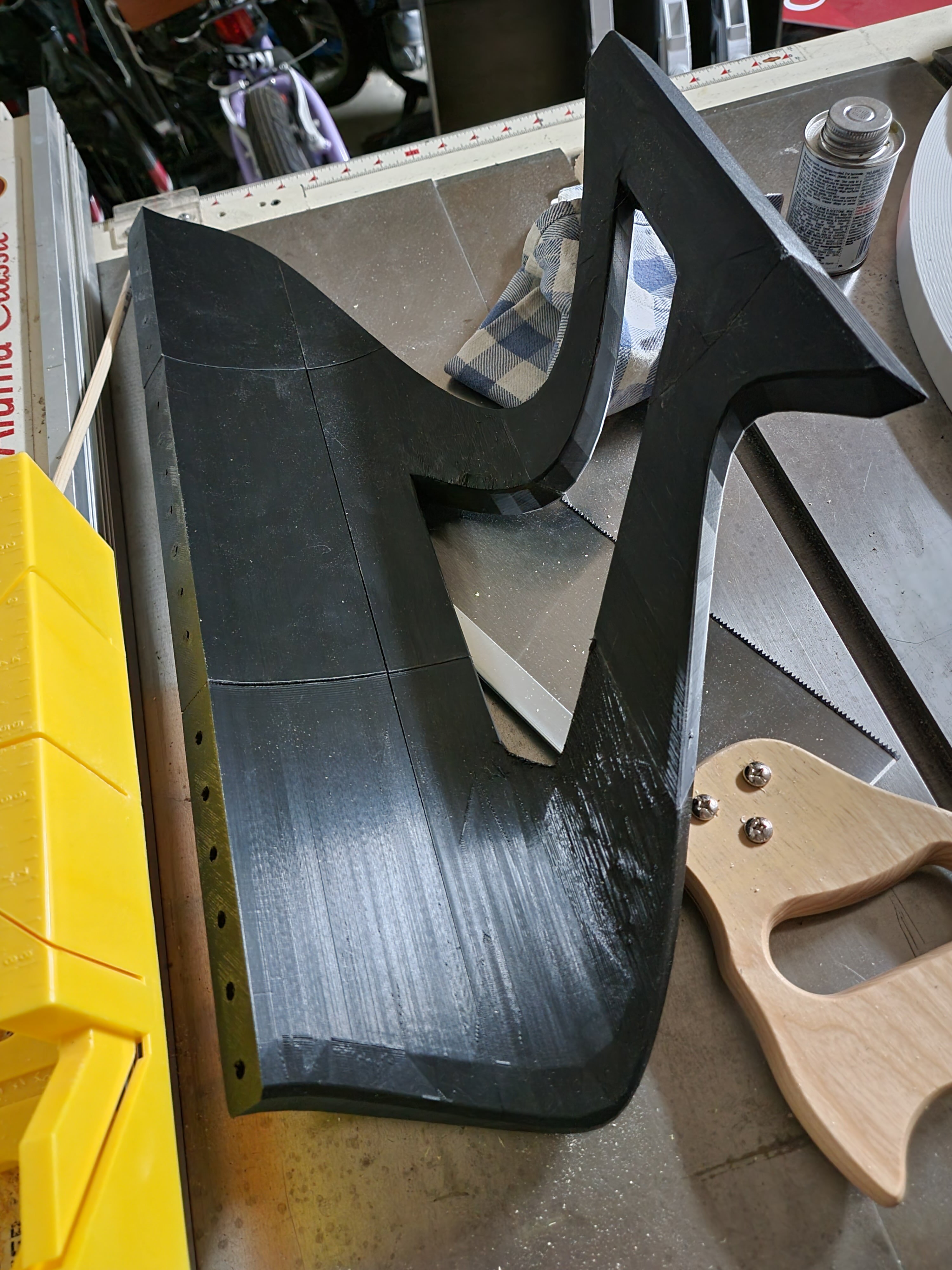

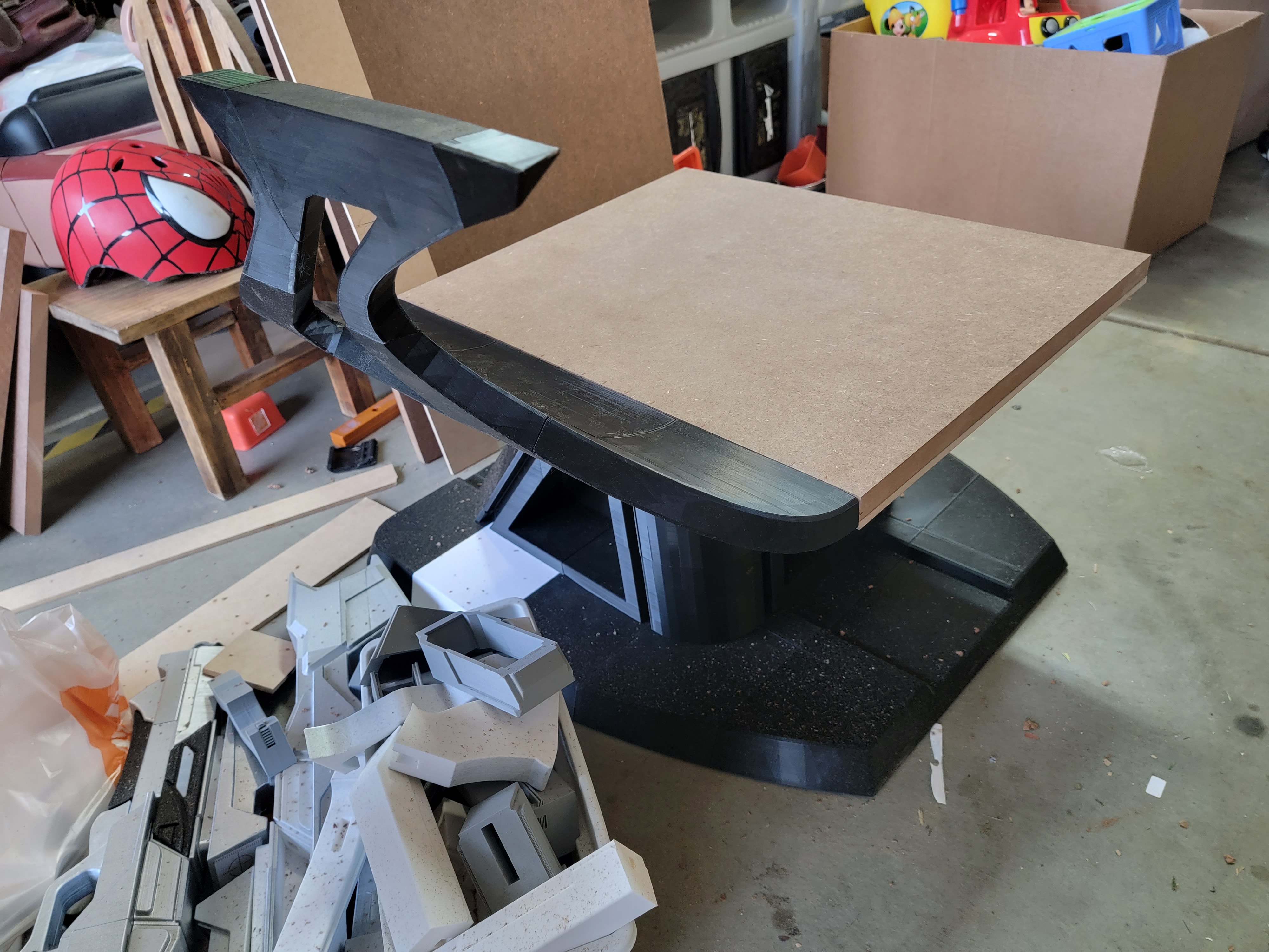

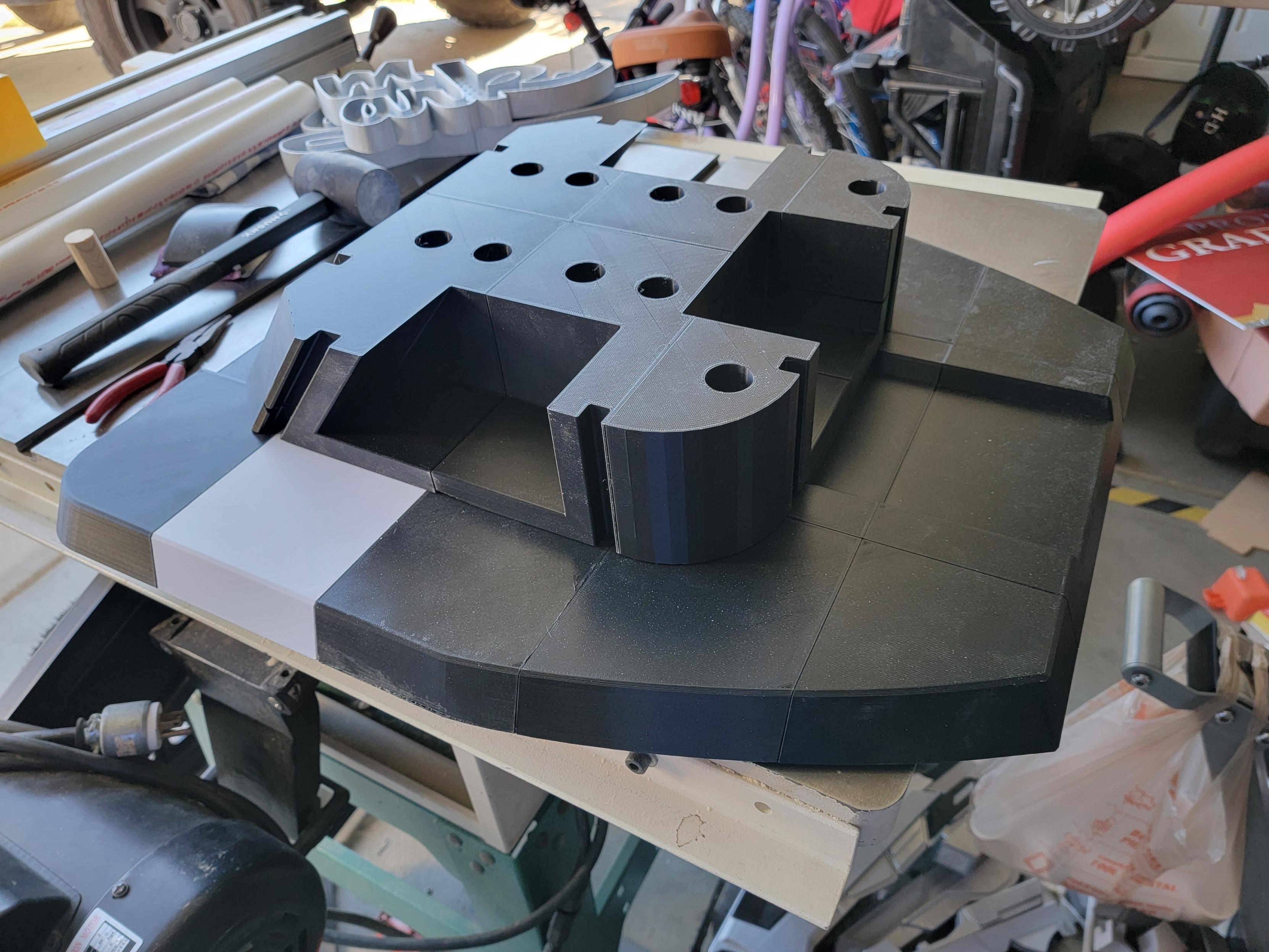

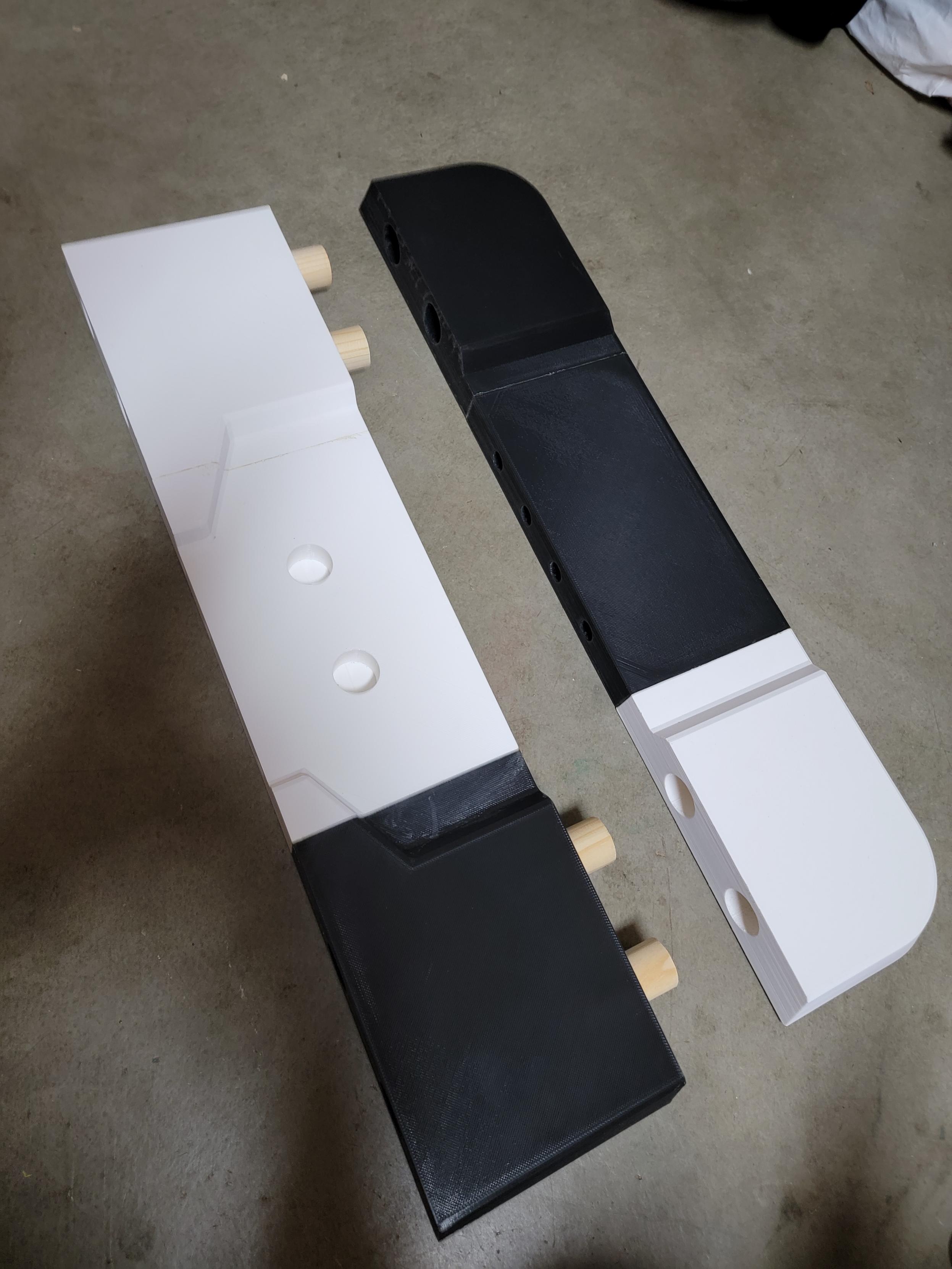

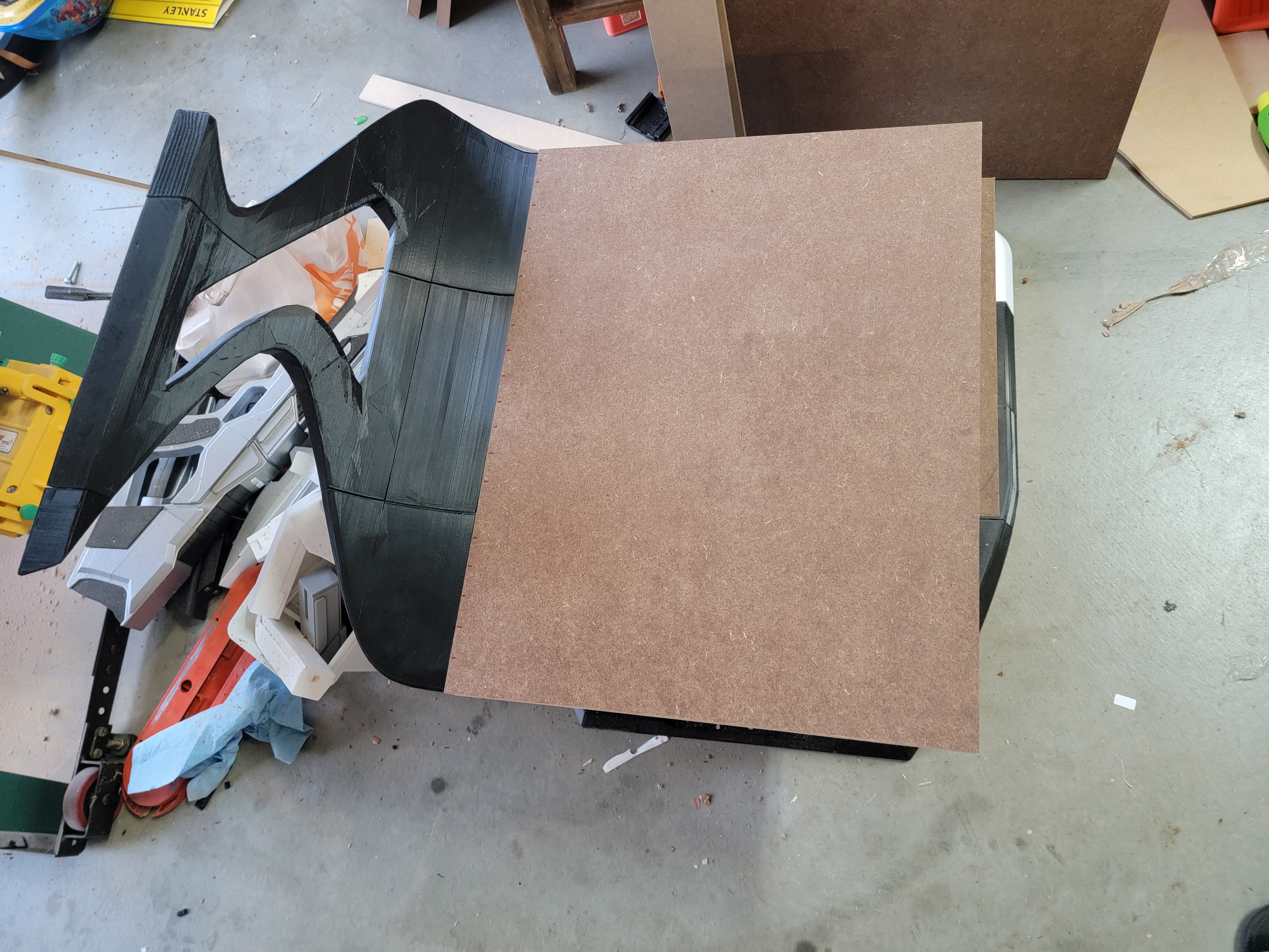

Progress on the base. I'm using wood dowels to connect the parts and add strength:
processed-588cf97d-a8d1-49d8-9a82-c19eadad9261_Q2kPiqUL.jpeg processed-b2880201-1ae1-4d38-849e-e29b1a26987c_HwsDhYkg.jpeg processed-4562e38b-24f9-413d-8f4d-bafa361b17d0_sK1SkB0t.jpeg
You may know this, but for the record, that's the second version of the E chair. The original was stolen near the end of filming Nemesis. They had to make a replacement quickly and they aren't identical. Most obviously, the headrest and hole are not the same. You may want to tweak your model if you want replicate the one we see in 90% of the movies.

Yes I am aware of this change.

Looking great, but I have one issue. You 3d printed the arm rests... Are you going to use that to cast them in aluminium?
The 3d printed parts wont be able to handle actual use. IE wont take the weight if you lean on them or like me... Use your arm rests to hoist yourself up to sitting cross legged in the chair :D
If they 3d printed. Maybe think about having internal steel suport?
