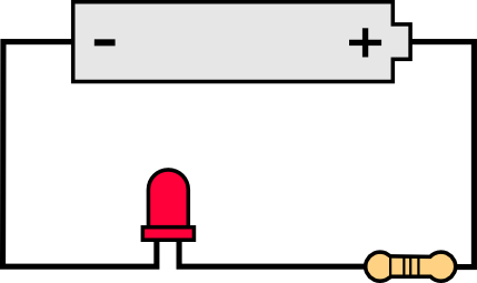

The red wire from the battery holder is the + on the battery and the black wire is the -. Attach the LED long wire to the resistor and attach the LED short wire to the black.
Since you'll need 2 LEDs, you can put the 2nd LED right after the first one. Just connect the short wire from the first LED to the long wire of the second LED. Then you can take the short wire from the second LED and connect it to the black wire from the battery holder. If you need to space out the LEDs a little, you can put some wire between the LEDs, but still connect them in the same order.
Once you have all the connections made, wrap electrical tape around all your connections and any exposed wire. You don't want them shorting out on each other or shorting out on you!
