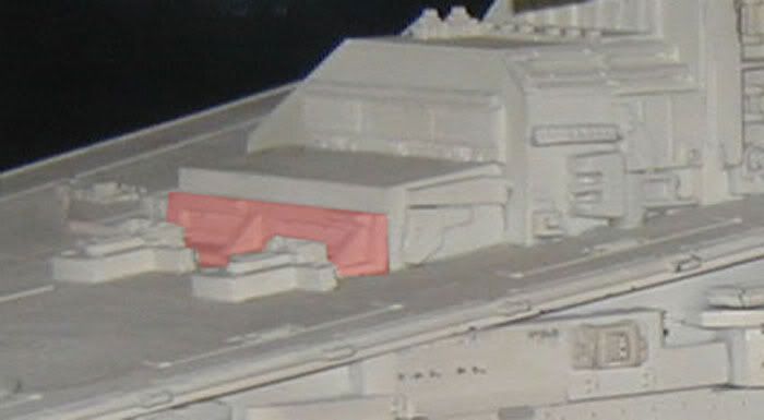

Any idea on this part colored in red ?
That's the part on which sit the Scharnohorst and Karl part, thanks !

Hey,Julien.
Light Blue : Scharnhorst or Gneisenau
Light Green : Junyo ( already you know )
I'm looking for other part colored in red.
I announce it as soon as I understand this.
Thanks
BlackPig
Hey Blackpig,
Thanks, yeah I already know for those parts, the red part looks a bit like a M5A1 part but it's not the right one. I notice that there is in this assembly one part which is the part glued on top of the M5A1 part which is between the 2 croc parts on the left side ! I dont know what it is though :/

Well here's what I think :
It looks on this pic that's not a plate but a styrene strip :
I dont think the mobelwagen is glued onto a styrene plate (the gap is probably a shadow because there is no gap on other pics... and this illusion can be see on some parts which dont have any gap).
Plus, you'll notice that the mobelpart is thinner on the side edge than the actual kit part so my guess is that they cut to hape a styrene plate (like I did on the left side). I dont know the exact shape of this one though :

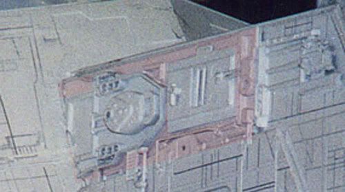

Now a pic with what I think being styrene plates :
I dont know if the part on the left is from a kit of just a styrene plate...
Ive started the plating but ran out of styrene :
Please let me know what do you think !
Thanks :)
Hi, MonsieurTox
O.K. I agree with you. You are right.:love
And I added some small strip on your pic.(Blue Line)

Hey Blackpig,
Thanks you very much ! That's right Im missing a lot of styrene chips and strips, they are really hard to see !

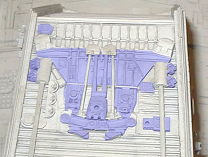

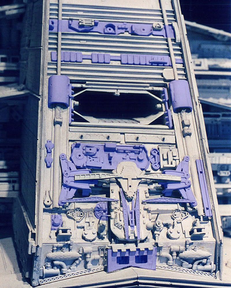

Ok so lets take a look at another area... the back of the neck :
Parts colored in blue are known parts... All other parts have to be identifed (I know that's the 2 cranes in the middle are on the 3 Footer ISD bridge).
Does anyone know from what kit come the red part ? I thought it was from the Croc but I cant find it, I was wrong :
Thanks !
Hey J I will take the easy one :$... oval parts on the bottom of the neck are R75 mufflers (part 19) with trimmed exhausts
