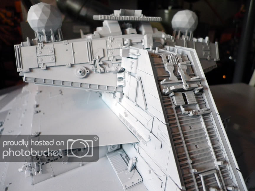

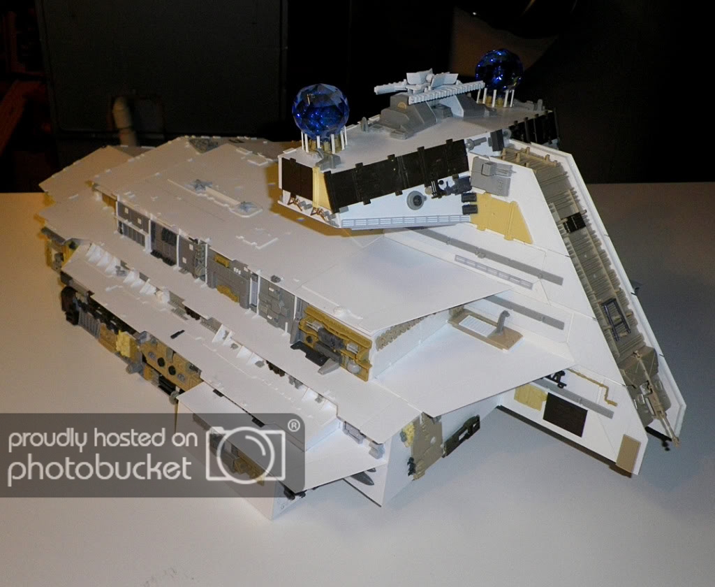

I actually started the bridge in 2008. I was determined to use as many original kit parts as I could find. After I built that much, it sat in a display case for a couple of years. Then earlier last summer I decided it was time to continue by creating patterns for the superstructure.
I started detailing it with the few parts I had.
Realizing that it would never get finished if I searched for every last part, I decided to be creative with kit bashing.
I decided that since this is my 3rd SD build, I wanted it to be much more accurate. However, I want it to be so in proportions more than detailing. So I call it A star destroyer, not THE star destroyer.
So, I detailed the sides with whatever parts I had on hand.

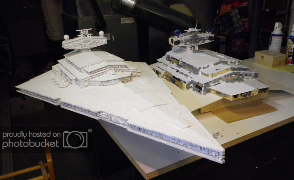

At one point, I set it next to one of my 3-footers for size comparison.
Seeing it like this makes me want to do this one right.

An interesting variation on a theme! Your wall detailing is more 'vertical' than the original, which is all lateral, but that's interesting as it gives the ship a slightly more sombre, grim look. Gives it a slight touch of the Nostromo texture.
I like this build a lot, and it was an honor to see it in person last weekend. It's clean and tight, has the correct proportions to my eye, and of course many of the signature original kit parts on the superstructure.
Glad you posted this here, Rick. Really looking forward to watching your progress.
The way I've been explaining it is that it can be thought of as a ship of the same class as the Devistator––same fleet, different ship. However, I would like it to have enough of the look of the original so when observing it from across a room one wouldn't know that the details are different here and there until seen up close. I did go for more vertical orientation on the walls, as this is, to my eyes, more similar to the ANH version, whereas the details on the larger ESB model are mostly horizontal.

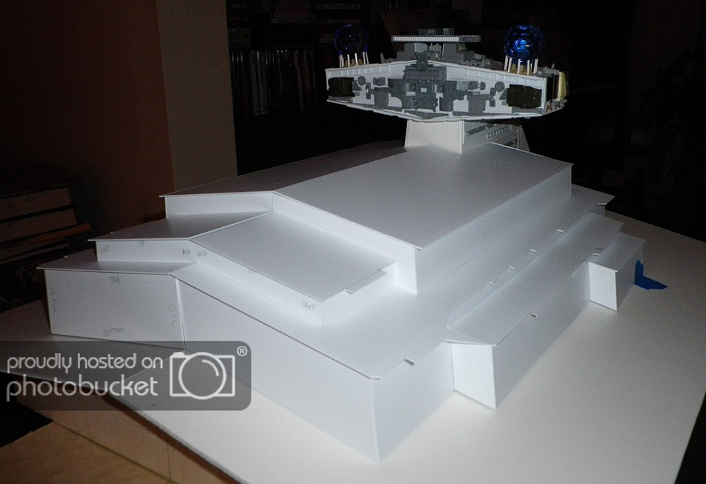

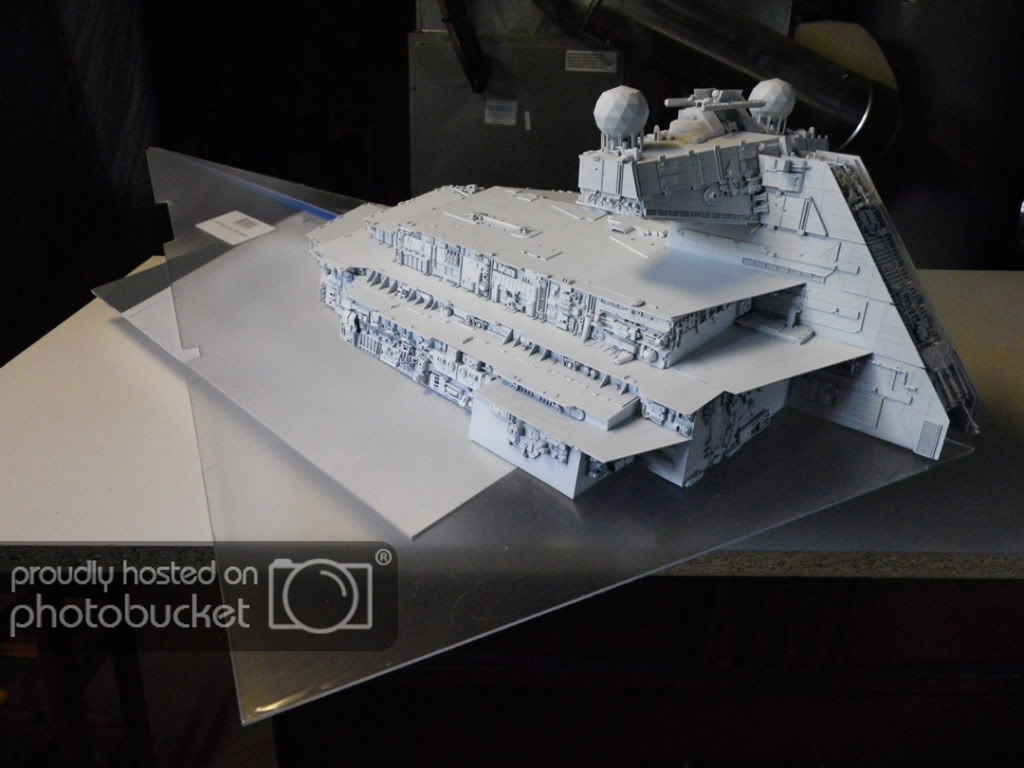

With the superstructure nearly complete, I moved on to the hull panels. I was thinking to have these laser cut, but I've never done that before, plus I didn't want to wait. Instead I chose to do the old score and snap. It works very well, as you can see, only some minor clean up with the sand paper. Soon I should be ready to build the wood frame.
That looks really good for being hand-cut. But, I wouldn't want to scribe it. . .
Fantastic job BTW! As good as it looks here, I know it looks even better in person. :)
Damn Rick she's coming together now. Your btave with score & snap on the acrylic but seems you have done a good job. Thers some very talented modelers watching this thread now & am sure your in good company. Keep it up buddy.

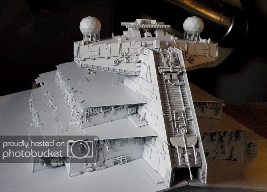

Here are some progress pictures. It's starting to take shape. Of course, nothing is attached to the hull panels yet, I just wanted to see it all together. The guns are not going to be on the final model. I just threw them together to fill the space for now.
Thanks to our good friend Jason Wright I was able to acquire more original parts for the bridge! I was able to replace the lunar module landing gear parts on the side of the bridge with the correct Airfix parts. I completed the back with the original tooling Shinano parts, also located under each side of the bridge. There are only 2 parts left to complete the superstructure.
I started making detail parts for the top of the hull. The inner frames are in the works. Mounting is going to be addressed, which will affect how the frames will be built. Lots more to do. My first two destroyers were completed in 2 months each. This one has been going on (and off) for two and a half years. I want this to be far better than the first two, and I am pleased with the progress so far.
