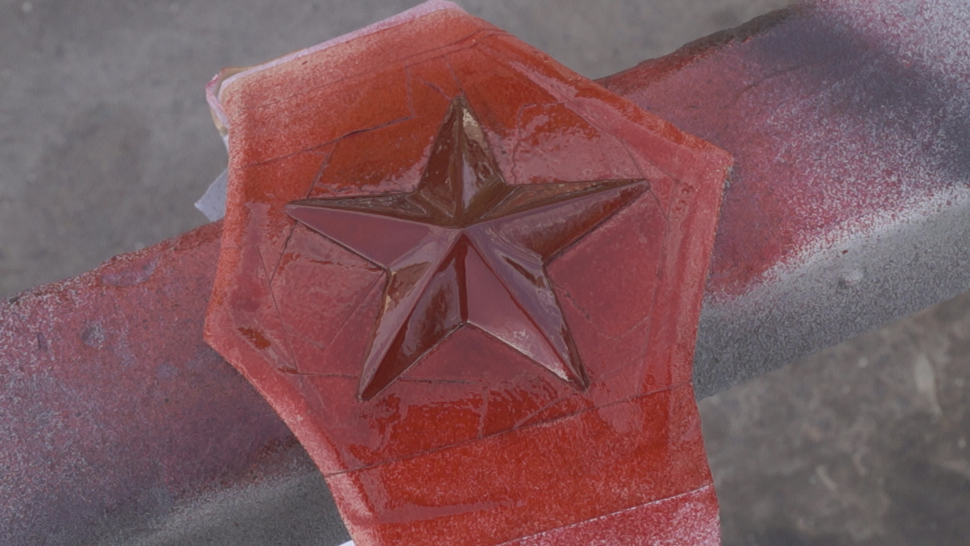

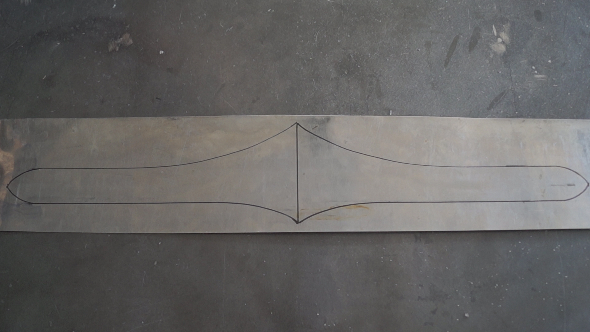

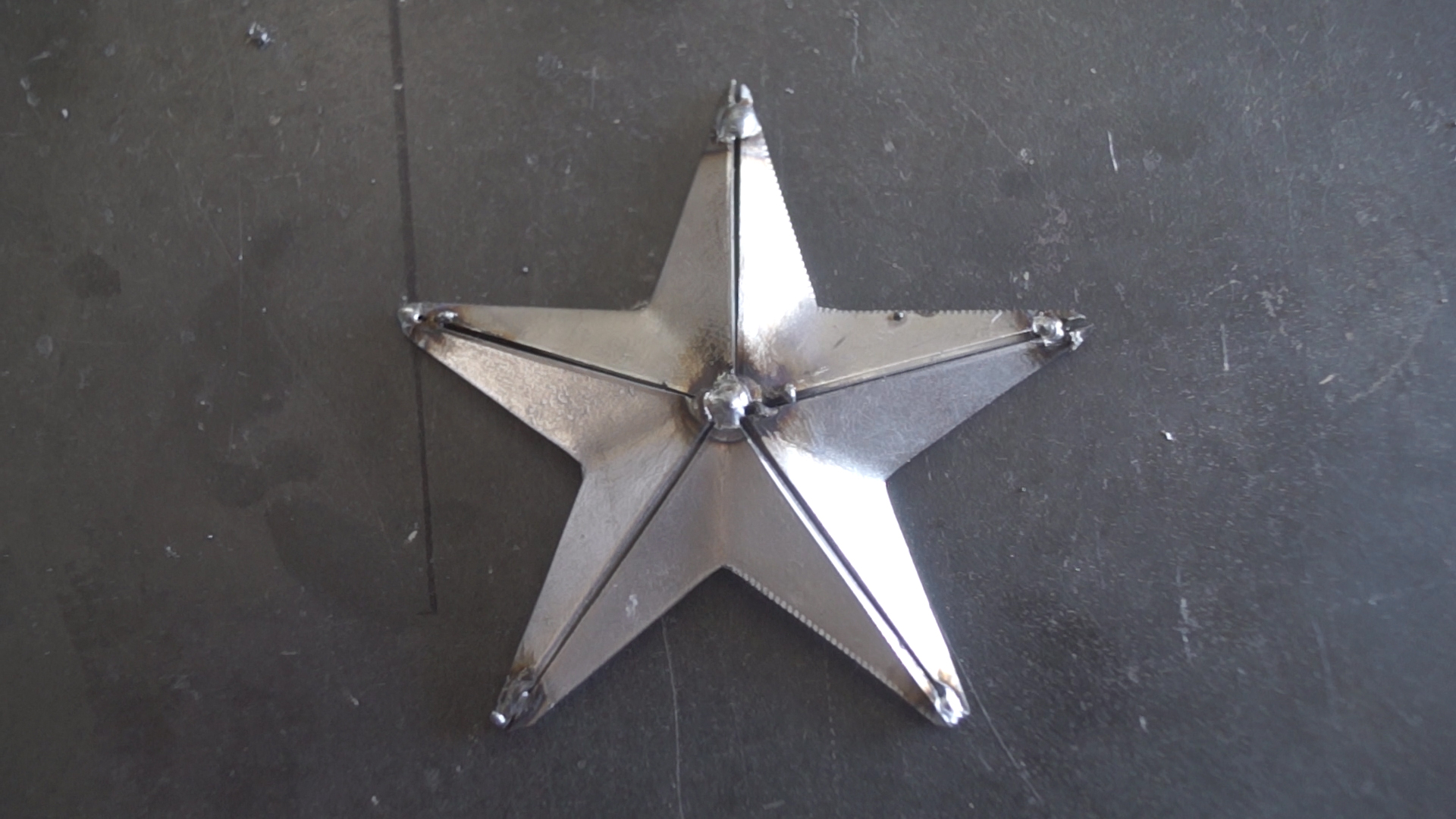

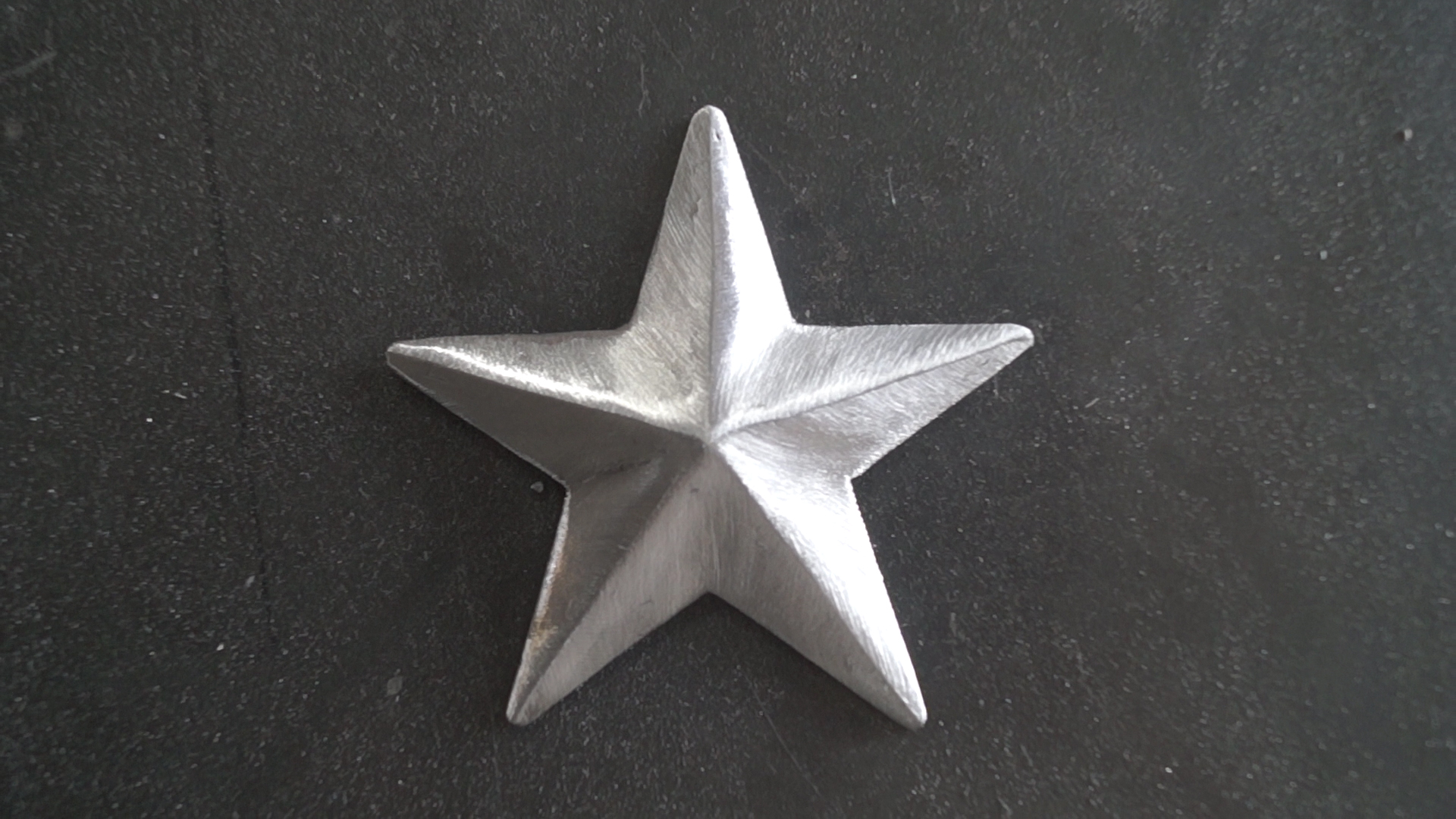

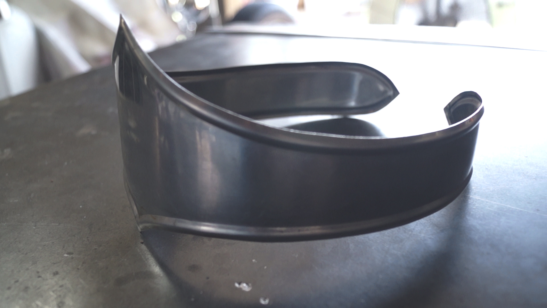

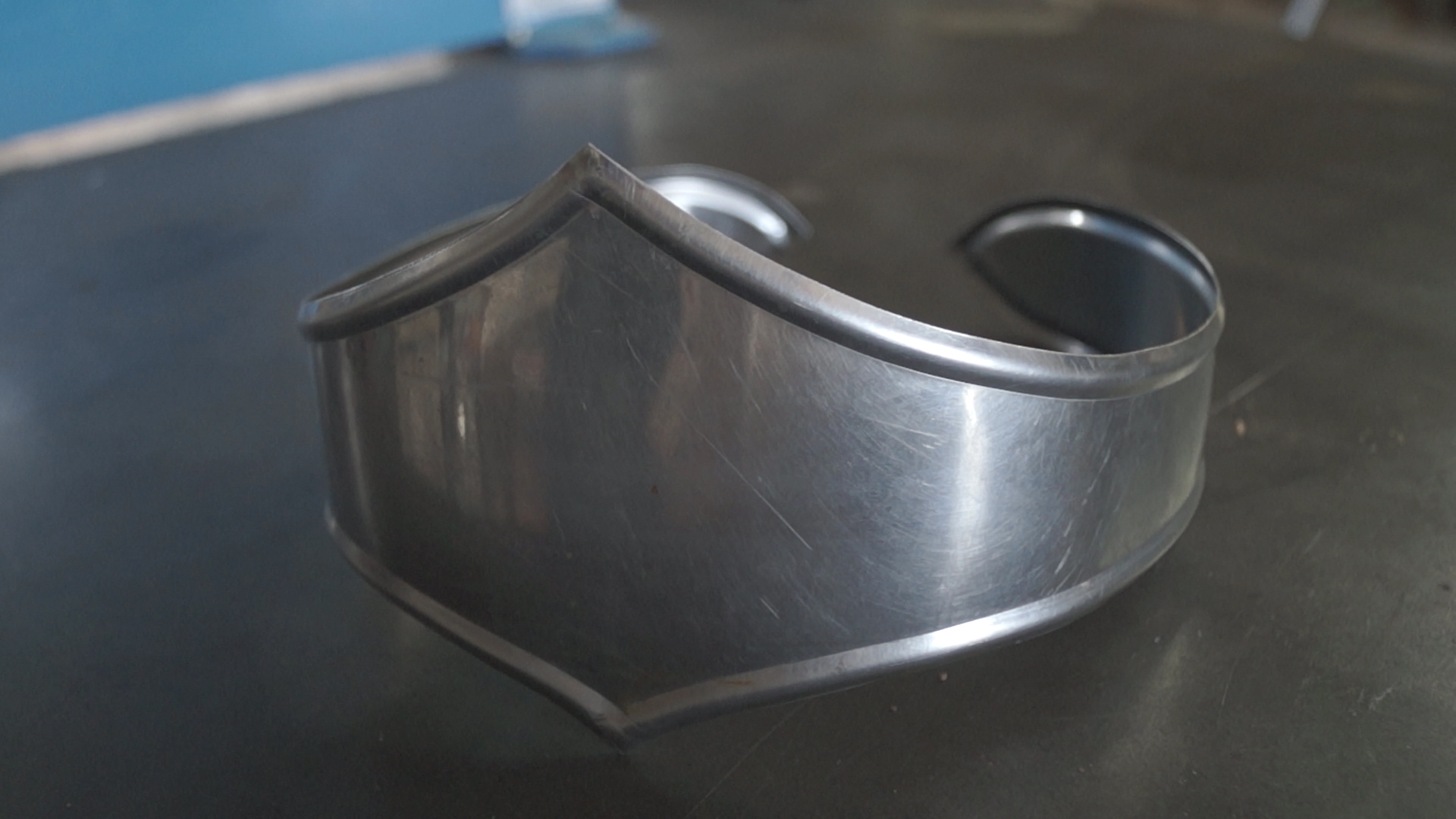

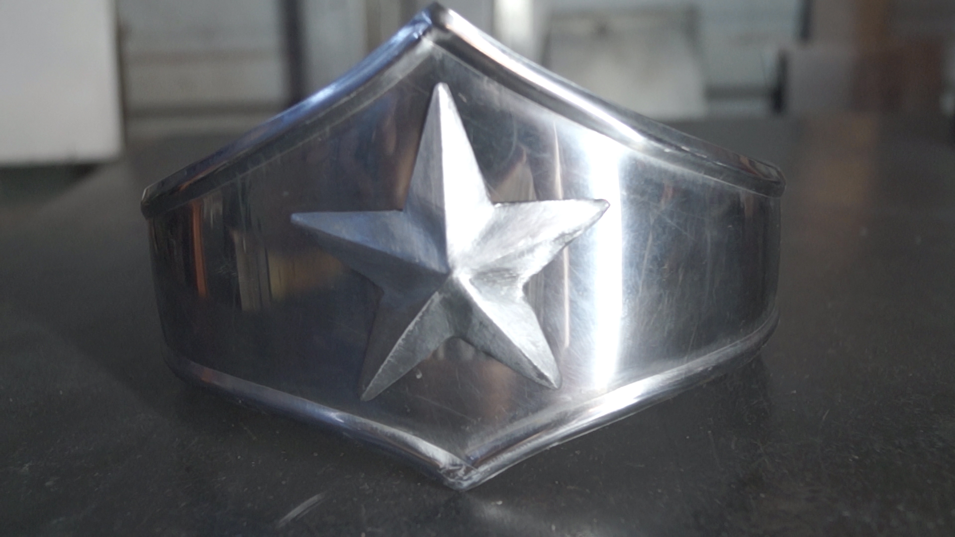

hello, I'm building a wonder woman tiara(new 52 version) out of stainless steel. Its just a quick little build.im using 20 gauge stainless for the tiara itself and the star is made out of 18 gauge steel.im going to paint the star a metallic red and put a nice polish on the tiara.to rais the edge of the tiara I used a bead roller. I will be making a video of this build as well showing how everything was done
Very nice. Do you have a finished picture after removing the tape?
Are you going to line the inside because of the sharp edges, or is this a display piece?

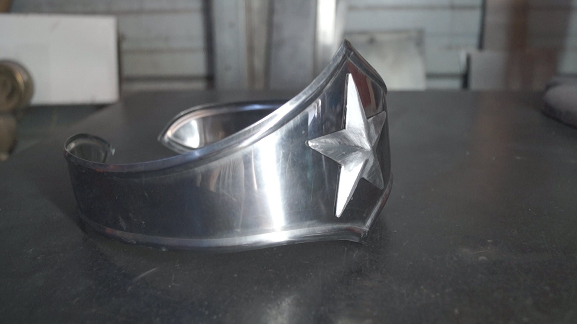

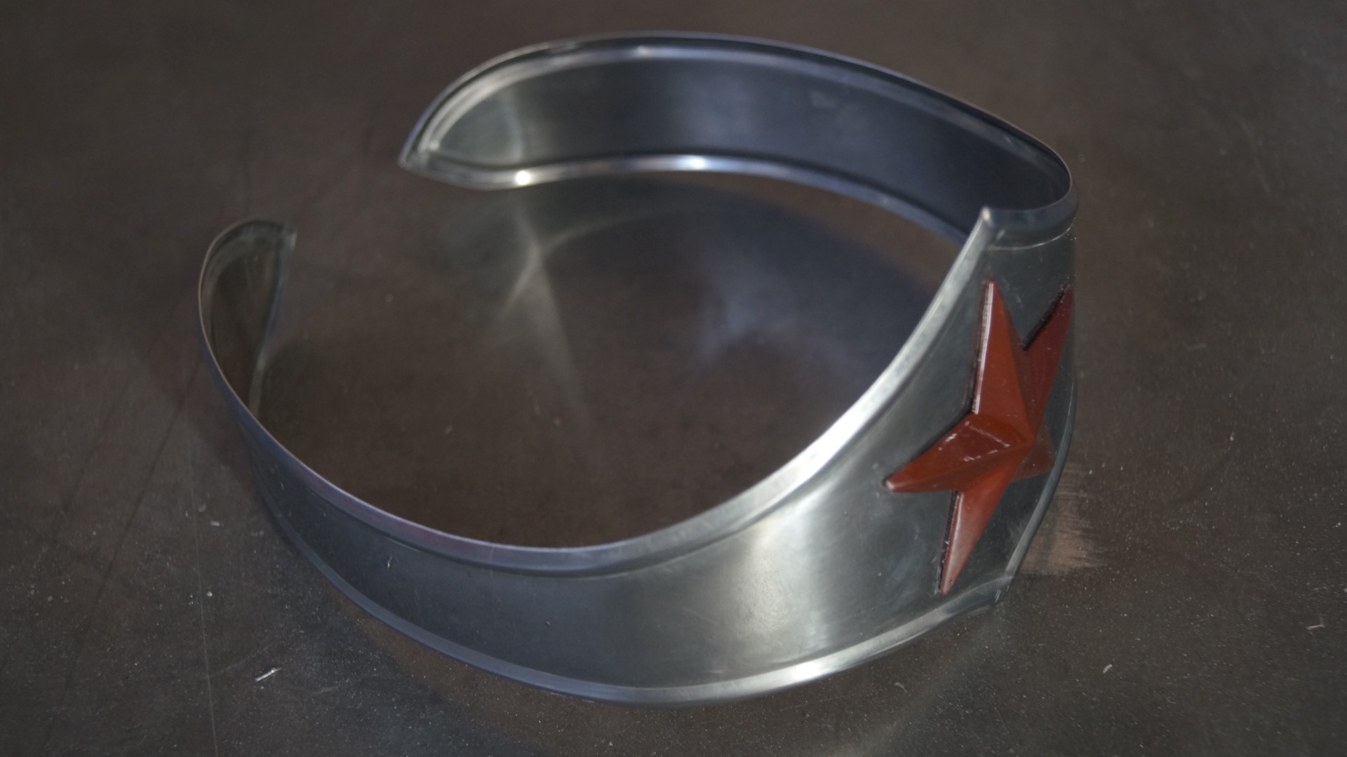

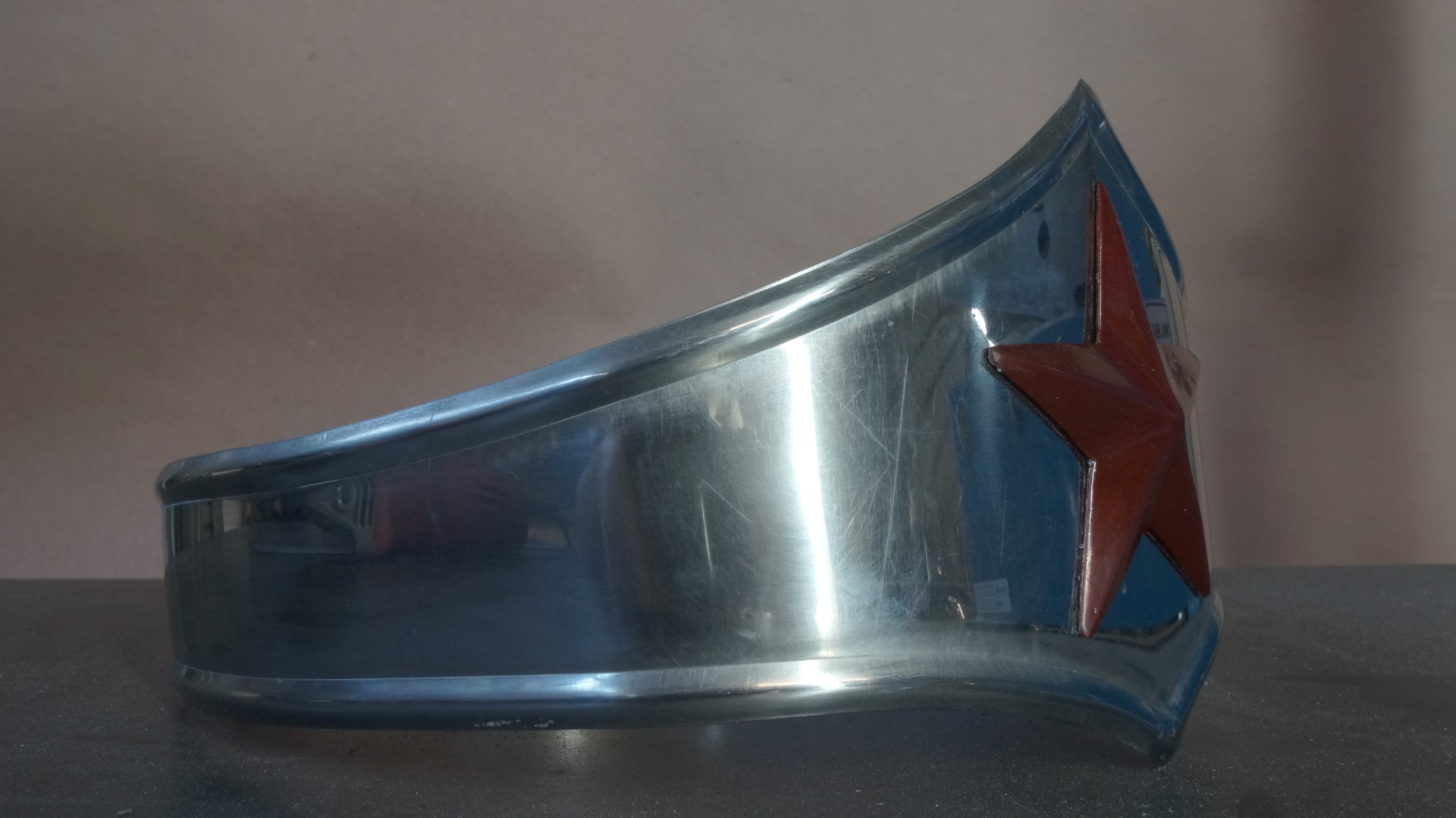

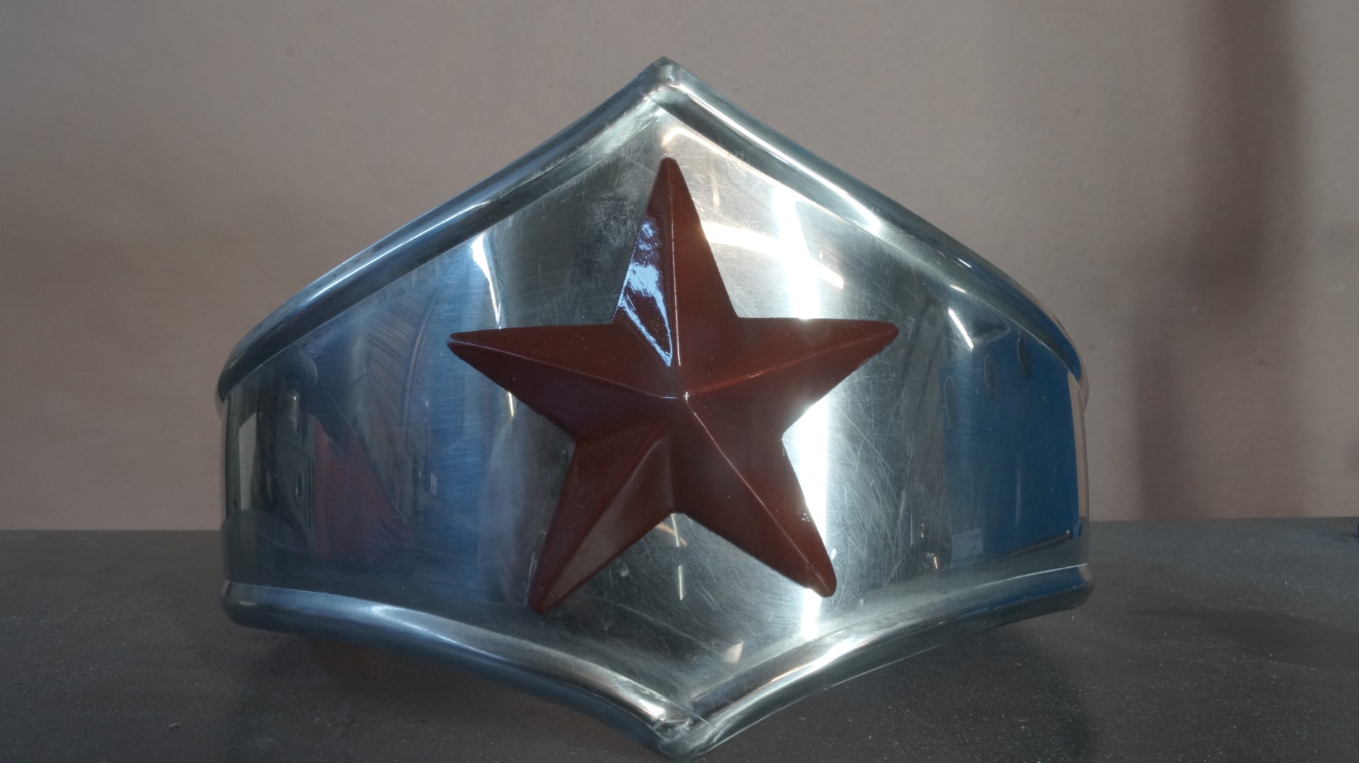

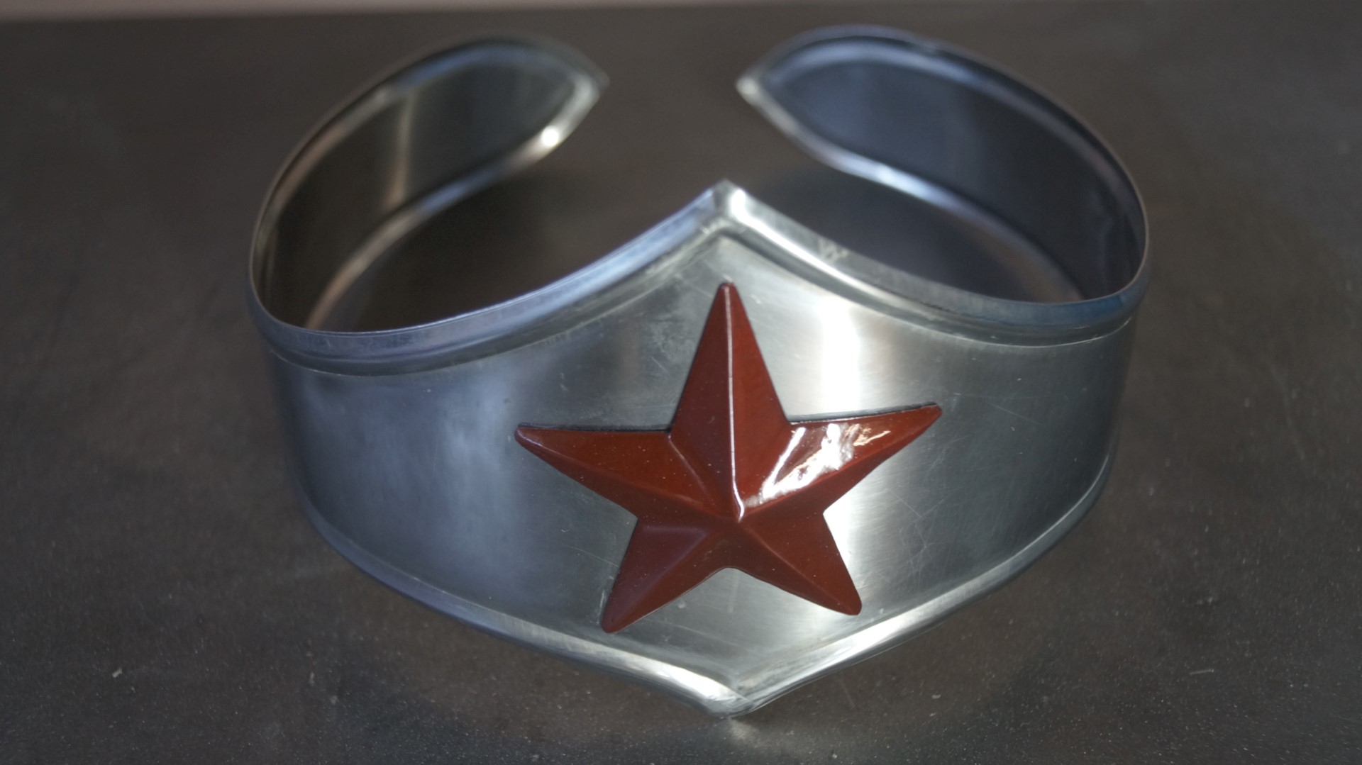

ok the tiara is basically done I did a real quick polish to get some pictures.and I will do a final polish soon.

woah ! what a job !!! congrats !
thank you!
thank you . I filed and sanded the edge so its not sharp you can wear it with no problem. but ill probably add some padding to the back just to finish the back off
