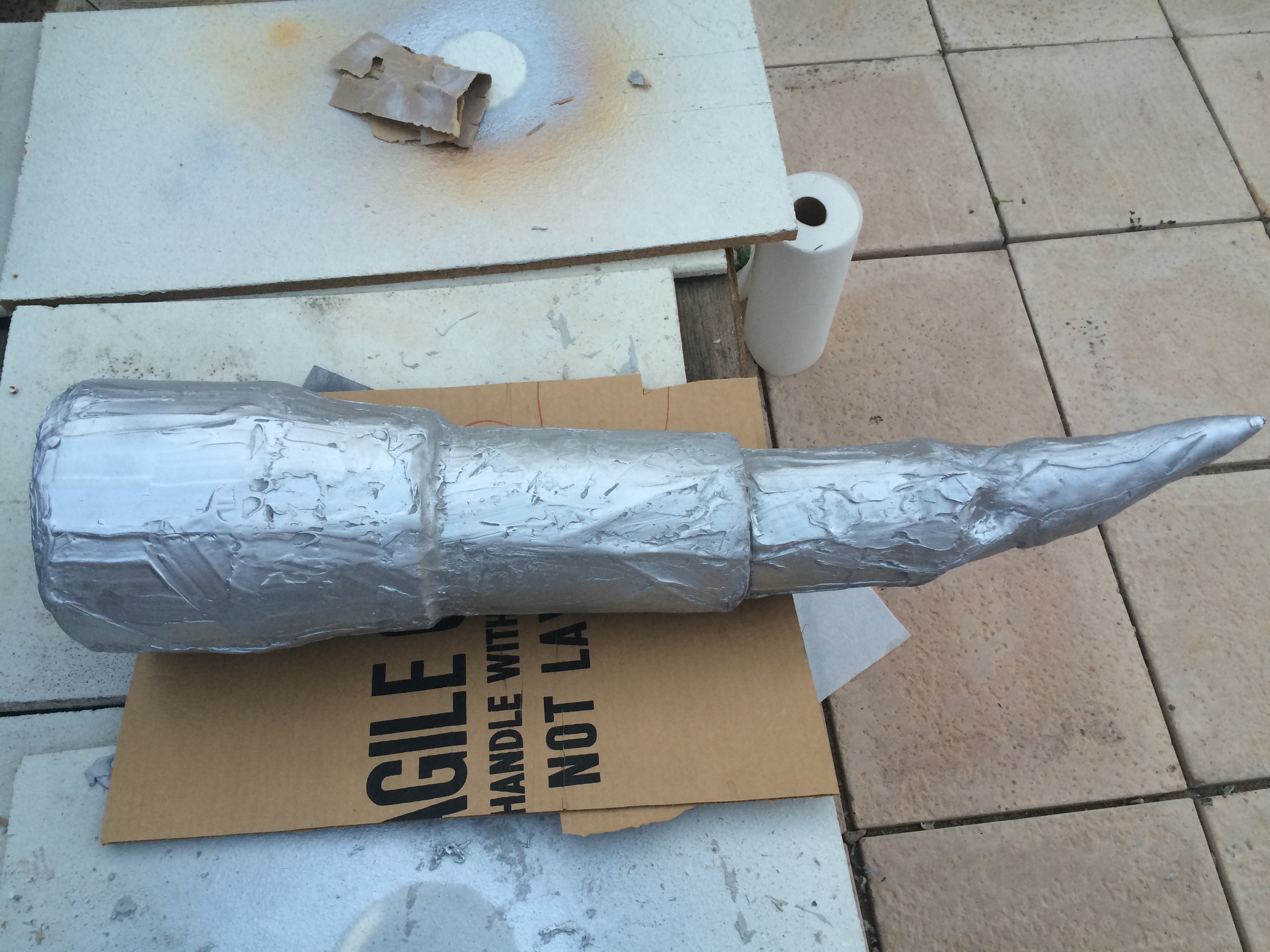

Texture was achieved with All-Purpose Bondo applied with a paper towel or piece of cardboard. Quite a bit of sanding. Tail was Smooth-On 2 Part Air Epoxy formed to a cone-ish point.

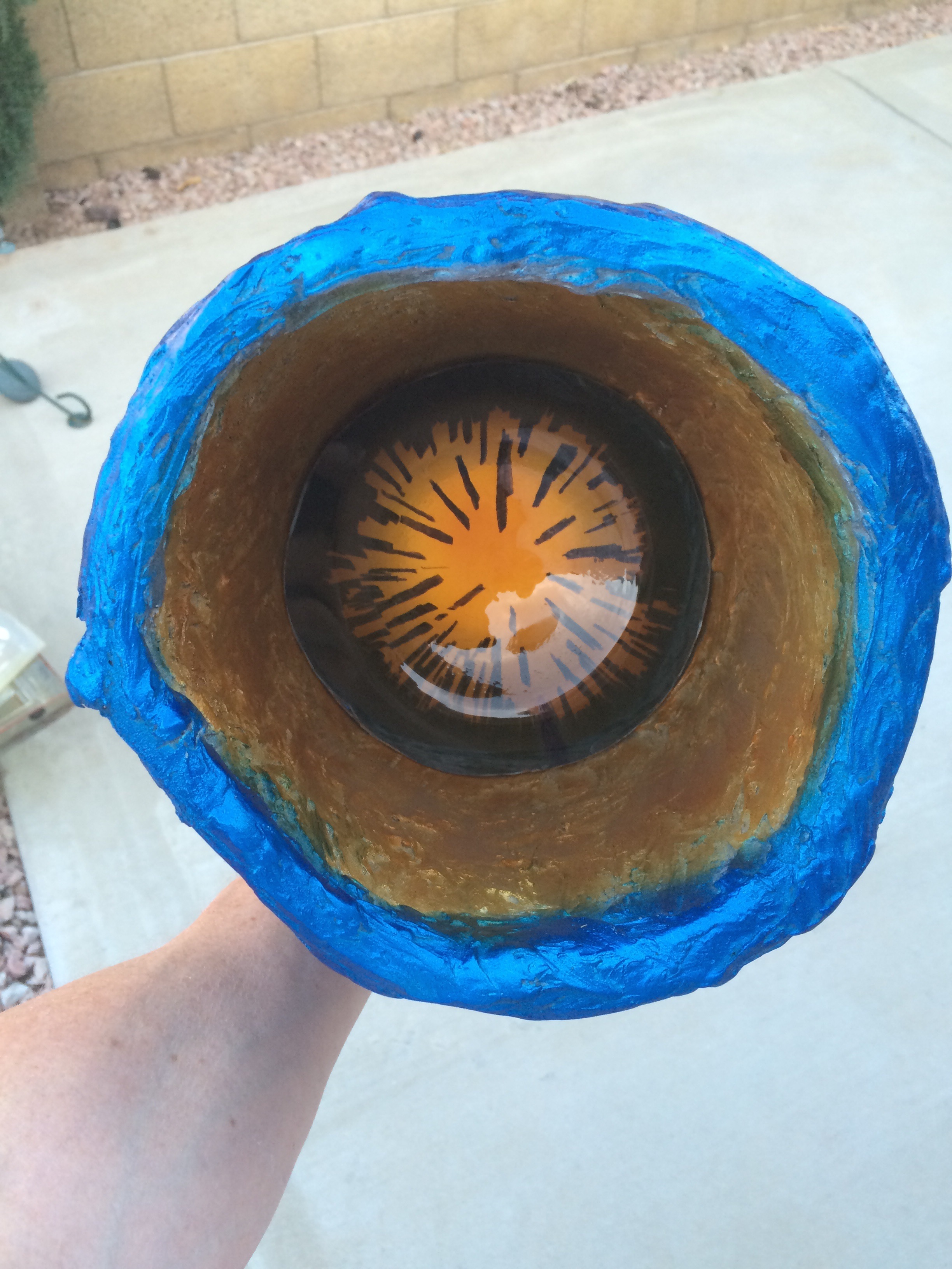

Painting was a primer layer with Rustoleum Mirror Silver, then the PS-19, accents with the darker PS-59, then 'line/ridge' highlights with a Sharpie Silver paint pen. Used the PS-43 to paint the 'lens' inside the maw the yellow/orange. I shaped the transparent lens by heating it and pushing it into a bowl shape. . .with a bowl.
